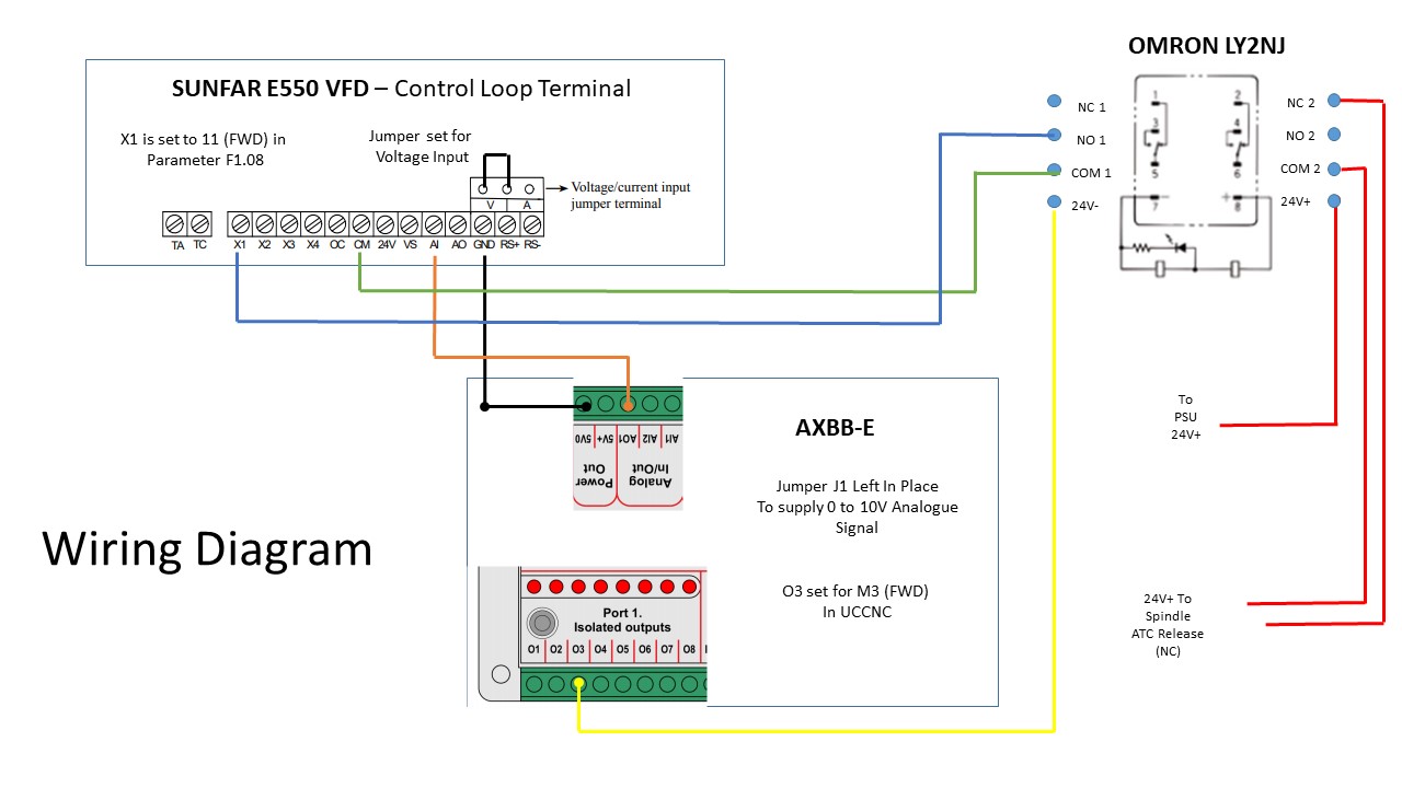

I am a CNC enthusiast in Canada and am building my most ambitious project todate: a 1.5M X 3.0M CNC Machine with ATC Water Cooled Spindle.
I have come across a problem and hoping for some guidance through this forum.
I have wired up my CNC Spindle and it operates fine through the VFD panel. I also have wired it up to a potentiometer and again it operates as expected. I am having trouble operating it through the AXBB-E via UCCNC.
I am able to operate all three degrees of movement (X, Y, and Z) via UCCNC and have also tested all limit switches. Only the spindle is yet to be automated

- I have attached the VFD to AXBB-X wiring diagram
I need guidance on how to wire the VFD CM terminal. I believe this is the digital ground. On my system 5V0 and 24V0 are interconnected. When I check the VFD there is no continuity between the analogue ground (GND) and the digital ground (CM). In some tests I've tried connecting the CM to 24V0 ground and UCCNC does not like this (it creates a limit switch alarm even though the machine is not close to these switches).
- UCCNC Config for this arrangement.
On Spindle Configuration Screen:
- PWM is active
- Spindle relay output is enabled with M3 (FWD) to AXBB-E O7 and M4 (REV) to AXBB-E 08.

Re: AXBB-E to Sunfar E550 VFD Terminal Connections
JohnnyCimino
For this test I connect as follows:
- VFD 24V to Relay port 8 (coil power)
- AXBB-E Port O3 to Relay port 7 (coil power)
- VFD CM Port to Relay port 1 (COM)
- VFD X1 Port to Relay port 2 (NO)
Ok looking at your post again then think I see the problem. You are taking the 24+ for the relay coil from the VFD rather than the 24V PSU.
Connect the 24V+ from the PSU which powers the AXBB-E rather than from the VFD.
I changed the wiring to the Relay as suggested. Everything now works. The spindle spins clockwise when I put in a M3 command in UCCNC. When I put in a M4 command it spins clockwise as well which is not a problem as I do not want to run the spindle in REV (please note that I did not wire to the X2 terminal on the VFD for REV spin).
I think this is a great way to start/ stop the Spindle as the relay I used gives me another set of terminals to perform another function. In my case I would like to disable the "release" of the ATC whenever M3 is active. This is to stop me from inadvertently releasing the collet when the spindle is spinning (which would not end well).
What I am finding is that with my Relay wired per guidance the NO / NC terminals are not operating as expected when the coil is wired but there is no M3 call.
These are the three tests:
#1 No Power to the Relay COM-NO --> No Continuity COM-NC --> Continuity
#2 Power to the Relay No M3 Call COM-NO --> Continuity COM-NC --> No Continuity
#3 Power to the Relay M3 Call COM-NO --> Continuity COM-NC --> No Continuity
Test #1 and #3 are as expected. I was expecting Test #2 to be same as Test #1. Strange thing is that the Spindle still operates as expected (it starts when M3 is active and stops when M3 is inactive) but It is causing me issues in using the Relay second set of poles to lock out the ATC release.
Am I doing something wrong?
Once again - here is the wiring:
Relay 24V+ to PSU 24V+
Relay 24V- to AXBB-E O3 (which is configured for M3 - FWD in UCCNC)
Relay COM to VFD CM
Relay NO to VFD X1 (which is configured for FWD in the the VFD - P1.08 = 11)
John
Attachment 30452
This is the wiring set up.

One final question for
[email protected]: Do you usually install diode protection when you use the OMRON LY2NJ relay? From the diagram on the plastic case it appears to have an internal diode but I'm wondering if the lack of diode is what damaged pin 3. If the answer is yes can you please advise how to wire it? Output pins 2 is optically isolated but I'm not sure if that provide protection from voltage surges.
No never needed to fit a diode and never blown an output on the AXBB-E under normal conditions, I have fit around 30 AXBB-E in the last 3 months with each controlling 4 Omron LY2NJ relays so I'm confident this won't be why you have a faulty output.
