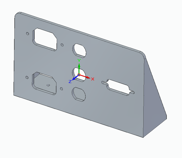

For CNC router work I have used LibreCAD, and EstilCam to generate Gcode, but as my machine has been waiting 2 years due to an office revamp, that may be subject to review when I switch on again.
Attachment 30538
