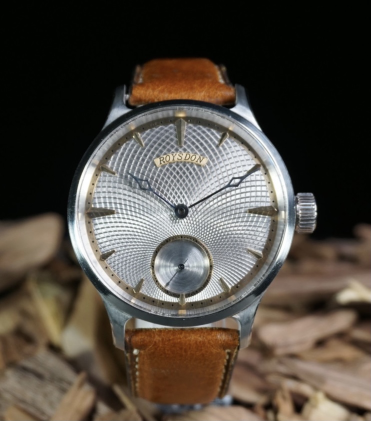

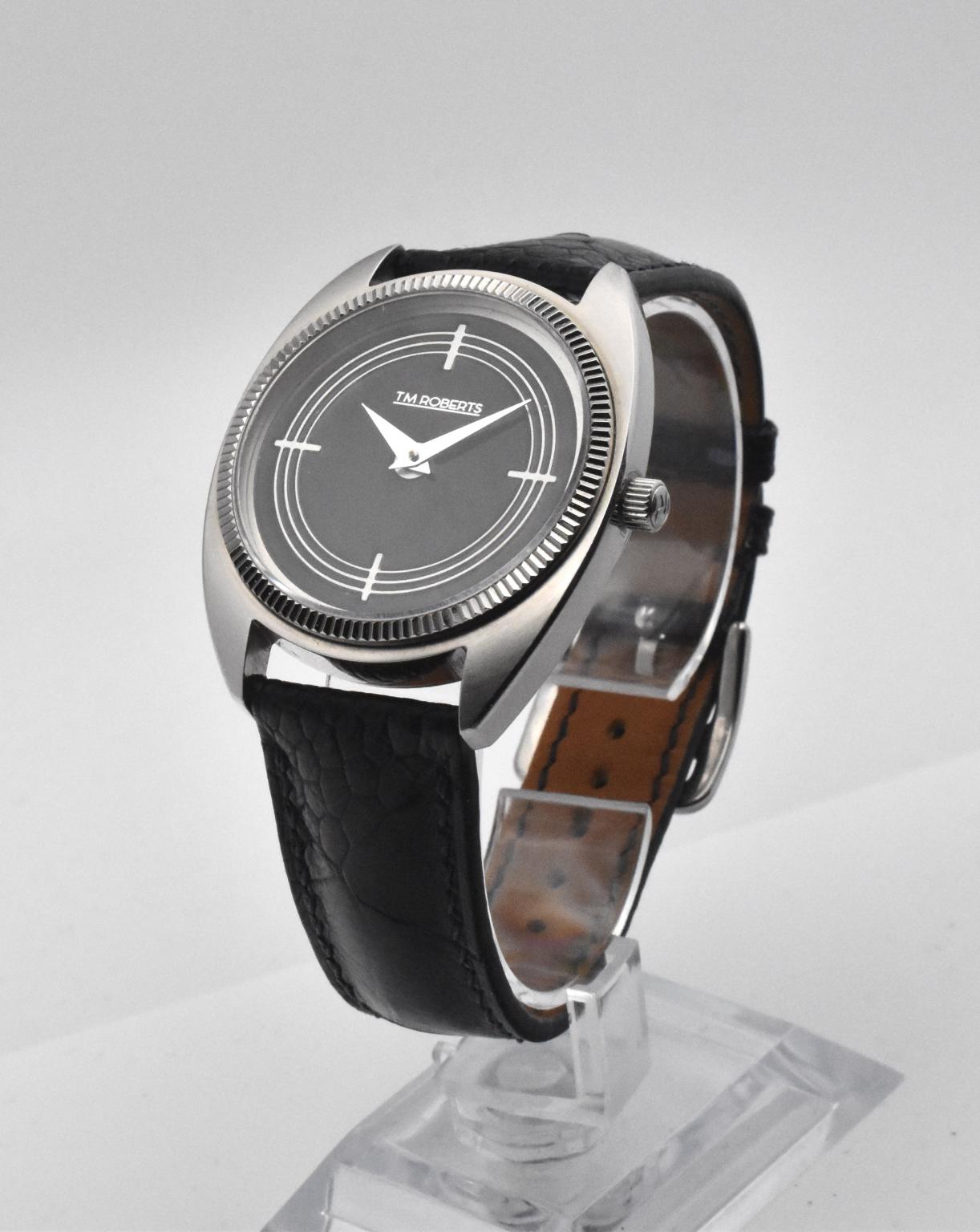

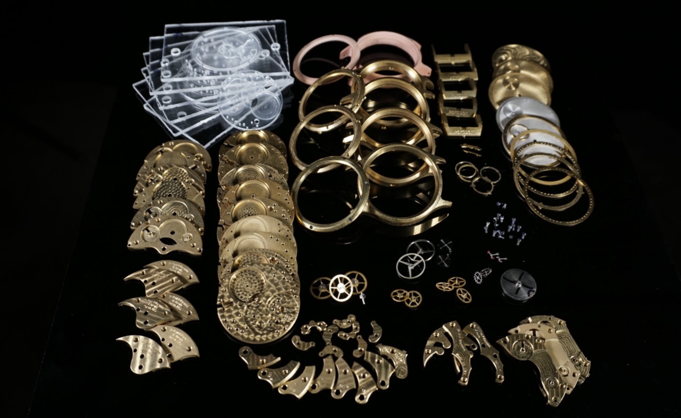

3 Attachment(s)
Re: Advice needed. CNC for watch dials and engraving.
Not sure how well this will be received, but I thought I would show you guys the sort of stuff I make. I know it’s not cnc related, but may be of interest to someone.
Attachment 31131
Attachment 31132
Attachment 31133
