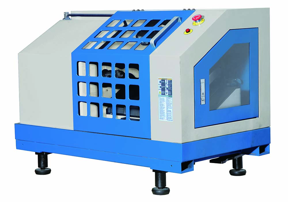

Before I make any suggestions, I'd like to see some photos of the lathe in question, and any information on the turret.
Personally, I'd say it's more likely to be some kind of electrical failure (what actually rotates the turret?), rather than the controller. It would be good to know what checks have been done to establish that it's a controller issue.

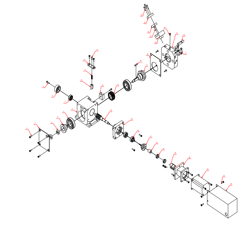

2 Attachment(s)
Re: SIEG iKC4 Lathe - ATC issues and refit
Here is a picture of the lathe:
Attachment 31141
Its an 8 position ATC driven by a Yako YKA2404MA stepper motor driver.

ATC Schematic:
Attachment 31142

If you remove the stepper motor from the ATC, does it spin unloaded? I'm asking because Sieg seemed to be suggesting you should play with the driver settings. Didn't work but can you get ANY life out of the motor when it is free to spin? Failing that, would it be worth spending a few quid on a generic Chinesium stepper driver to see if the Yako thing really is the problem? Changing out the CNC controller itself is a big move, so you'd want to be 100% certain the driver and motor are OK first.

I took the ATC cover off ready to remove the stepper so I can try it unloaded and there are no mechanical issues as I can rotate the ATC by hand by rotating the shaft with the machine/steppers powered off.

So things seem to be mechanically OK.
Next easy test, can you rotate the stepper motor with the lathe powered up?
This will tell us if the stepper driver is doing anything.

The stepper motor driver and stepper motor are definitely doing something as they can partially rotate the tool but stop after about 30 degrees at which point the lathe hangs and disconnects from the PC running the turning software.
When I get some time this weekend I was going to remove the stepper motor from the ATC to see if it can complete full rotations without load.
That does sound far more like a controller issue.
Do you have any kind of manual for the controller?
How do you home the Turret?

I removed the stepper motor and tried moving it unloaded - same problem
SIEG gave me some further tests to put the software in debug mode and disconnecting the motor from the driver - same problem in that the software hangs at the same point
Therefore it looks like a controller fault.

To me it sounds like the controller is hanging waiting for something to happen (and pretty rubbish programming, in that it locks up rather than timing out).
Are there any sensors on the turret?
And is there anything connected to the Origin terminals on the driver?
