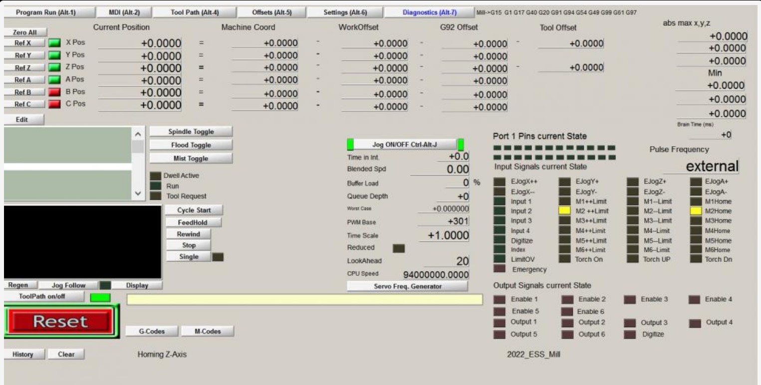

My new table cnc approx. cut area 20”x26” made all in aluminum with 7 limit mechanical switches, Mach3 register, ESS, C11G BOB, ASUS Laptop with Windows 8.1 was working very well and did my first 3 sample cuts until I decided to re arrange wiring for better looks

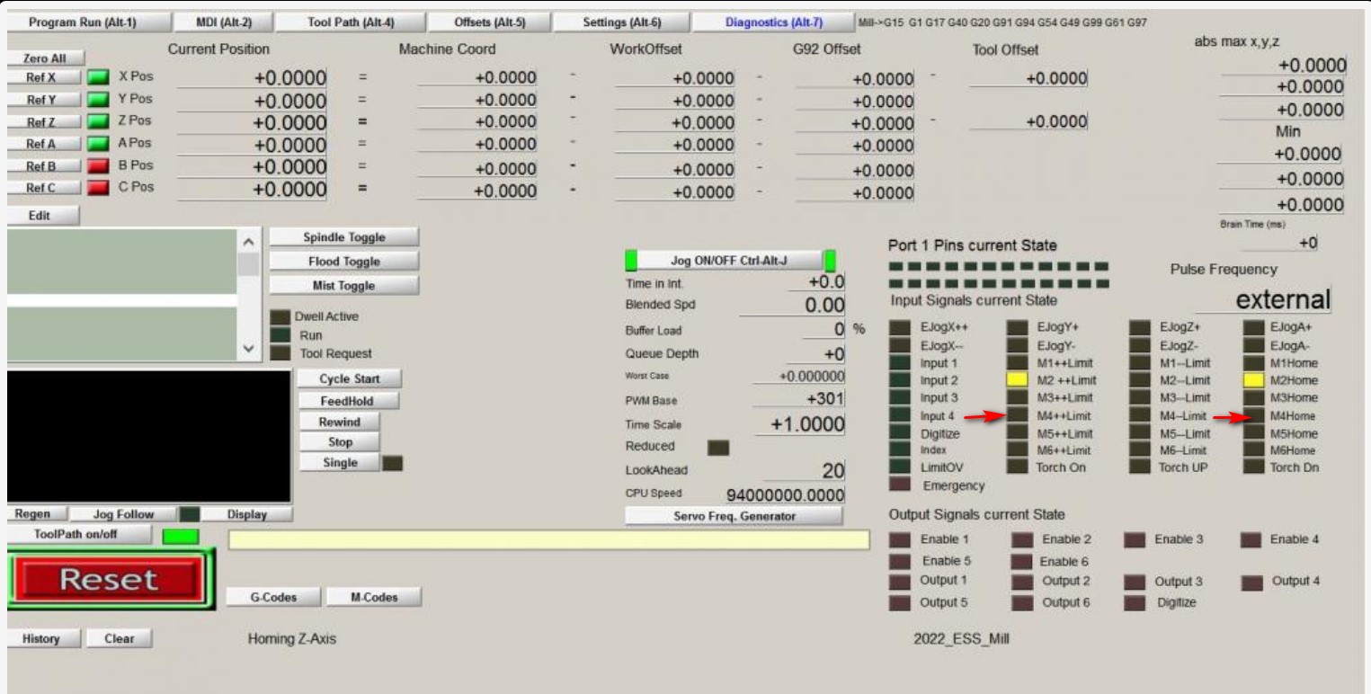

The attached snip shows at the top left of the screen the Homing of all axis is complete but there are two limit switches on the Y and A axis shown on the right of the screen which are triggered but at least I can back out my axis. Just wonder where to look for to solve this minor problem.
I reroute motors/limits wiring but when I connect the shielded ground to the star point ground and try to Home the Y axis it says “Limit switch is active, fix the wiring and try again”. Try again it says “Limit switch is triggered”. For now I left the ground wiring not connected,
I don’t know if the ESS has anything to do with it but reading on the web some suggest to install a capacitor to the limits wiring but I don’t know what size capacitor and where to connect the capacitor and besides I don’t know if it will help.

Almost finish checking the cables and will post results soon but I have a question which if I know the answer I may solve my problem
On the attached diagnostic screen where I have the two red arrows pointing what it means the M4++Limits and M4Home? Do they refer to a motor, axis or what?
When I try to Ref Y and the gantry starts to move, when the move stops this M4++Limits & M4Home is also lit but in a few seconds the 2 lights come OFF.

It’s difficult to describe what you ask Neale because when I click a switch I can’t take a snip so I made the attached sketch. The black cells mark from the top down the lights ON in the indicated axis on the left of each bank.
But in my notes I found that M1=X, M2=Y, M3=Z and so I don’t understand why when I reference the Y I get on the diagnostic screen the M4 lights as shown but only for a few seconds and then I get the message “Limit switch triggered…”

If someone can answer my previous post about what the M4++Limits / M4Home message refers to I may understand more and perhaps be able to solve the problem
M4 refers to the A limits. You can turn off the light by going into the Ports and Pins settings, but you are using slaved Y and A. Have a look at limits and home switches here https://www.machsupport.com/wp-conte...all_Config.pdf

Stevenson
Yes, they refer to the 4th axis or motor output. If you are slaving motors with the 4th axis then usually you would turn off the LIMIT++/-- in ports and pins but leave the HOME input so can home. In this case, the M4 will light up when homing and then go off after the axis as backed off the switch, which I think is probably what's happening in your case but you have the LIMIT turned on and using the same pin number so the M4++ lights up as well.
In which case this would be correct when homing if the Home SW. safety button is not set in the General config screen while homing. If the Home SW.safety was ticked you would get a Limit tripped error.
