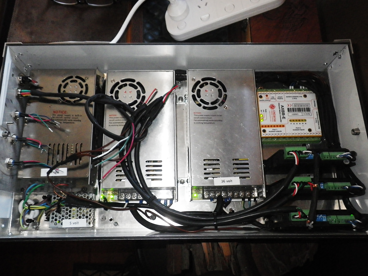

		I've made and wired up my electronics enclosure.
I need to activate my UNCNC license and get my computer to communicate with my AXBB-E unit.
I have a windows 10, 16 gig ram laptop that I will use to control my  60 / 40 CNC
It has an ethernet port. I bought a new crossover cable and apparently the AXBB-E unit is powering up correctly.
The laptop will not allow me to change the IP to 10.10.10.10   sub  255.255.255.0 messaging that more information is required
It indicates that the AXBB-E unit has an incompatible IP address.
Connecting to my (windows 11) office computer allows the IP address to be set to 10.10.10.10  sub 255.255.255.0
However UCxxx cannot recognize the AXBB-E unit. When I try the blue link led blinks which I assume indicates that there is a connection. Both the green leds are lit so the unit seems to be powered up and working correctly (see photo)
The UNCNC software wlll only open in demo mode and there seems to be no way to activate the license key.
From google searches other have encountered the same problem.
I've spent about 12 hrs trying various ways to sort this.
I've written to the supplier and manufacturer for advice waiting on replies.
Any solutions would be greatly appreciated.
Thanks Evans
Attachment 31277

 You don't activate the license, all you do is place the license file in the UCCNC root folder. Then, when you first start UCCNC it will do a firmware update with the new license info; from then on, it will just load normally.
Why the laptop isn't seeing it I'm not sure, but usually, it's straightforward. We use Laptops using all versions of windows from XP to Win11 and never have any issues with the Ethernet side.

		The default IP address on the board I believe is 10.10.10.10
So you have to have a different IP address in the PC
So you have to have something like this. 10.10.10.11
		Re: AXBB-E  - computer communication problem
		You need to set your laptop ethernet as 10.10.10.11.
10.10.10.10. Is the AXBB-E address. This is why you can't use this ip on the laptop, because it is an ip conflict.

		Some progress this morning UCxxx is recognizing the AXBB-E it gives the serial # as CAOED1 and IP address as 10.10.10.11
However not yet worked out how to get the license key installed.   Which exactly is the UCCNC root folder ?
I've tried copying the  license text to UCCNC exe.config and UCCNC but not getting any joy.

		The root folder is the folder where you installed your UCCNC program  probably C:\UCCNC
If you right click on your UCCNC desktop or start menu icon and go to properties   open file location   it should show you where your root folder is.

 The root folder is where you installed UCCNC, as mentioned by Waldo this is probably C:\UCCNC.
You don't need to copy the text just paste the whole file sent to you into the Root folder. This is why you are not coming out of demo mode as the AXBB-E needs to update it's firmware.
The 10,10,10,10 is another matter and often works for most PCs but occasionally network conflicts can happen and often 10,10,10,1 and 10,10,10,11 will work.

		Deleted then copied and pasted the license download into UCCNC on my computer then opened UCCNC and it has recognized the license and is showing as registered to me. Next is to see if I can get my laptop to behave but that is not a UCCNC issue. So at the moment all looking GOOD !
		OK so how it worked out  for me.
Made sure the AXBB-E powered up, connected with a crossover ethernet cable to my computer's LAN port. Changed the IP address on my computer to 10.10.10.10    sub  255.255.255.0
Once UCxxx scan identified the AXBB-E IP address and serial number. Didn't at first, perhaps where you open it from makes a difference.
Downloaded UCCNC software and copied and pasted the license to UCCNC on my local disk. I had to delete and recopy it to get it to be recognised
but then it worked on this computer and my laptop.
