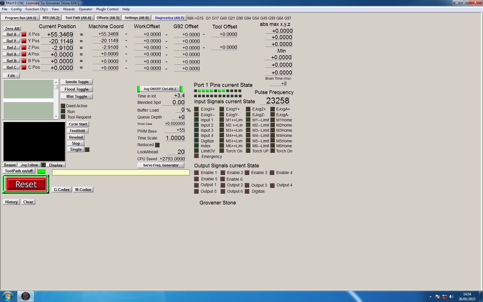

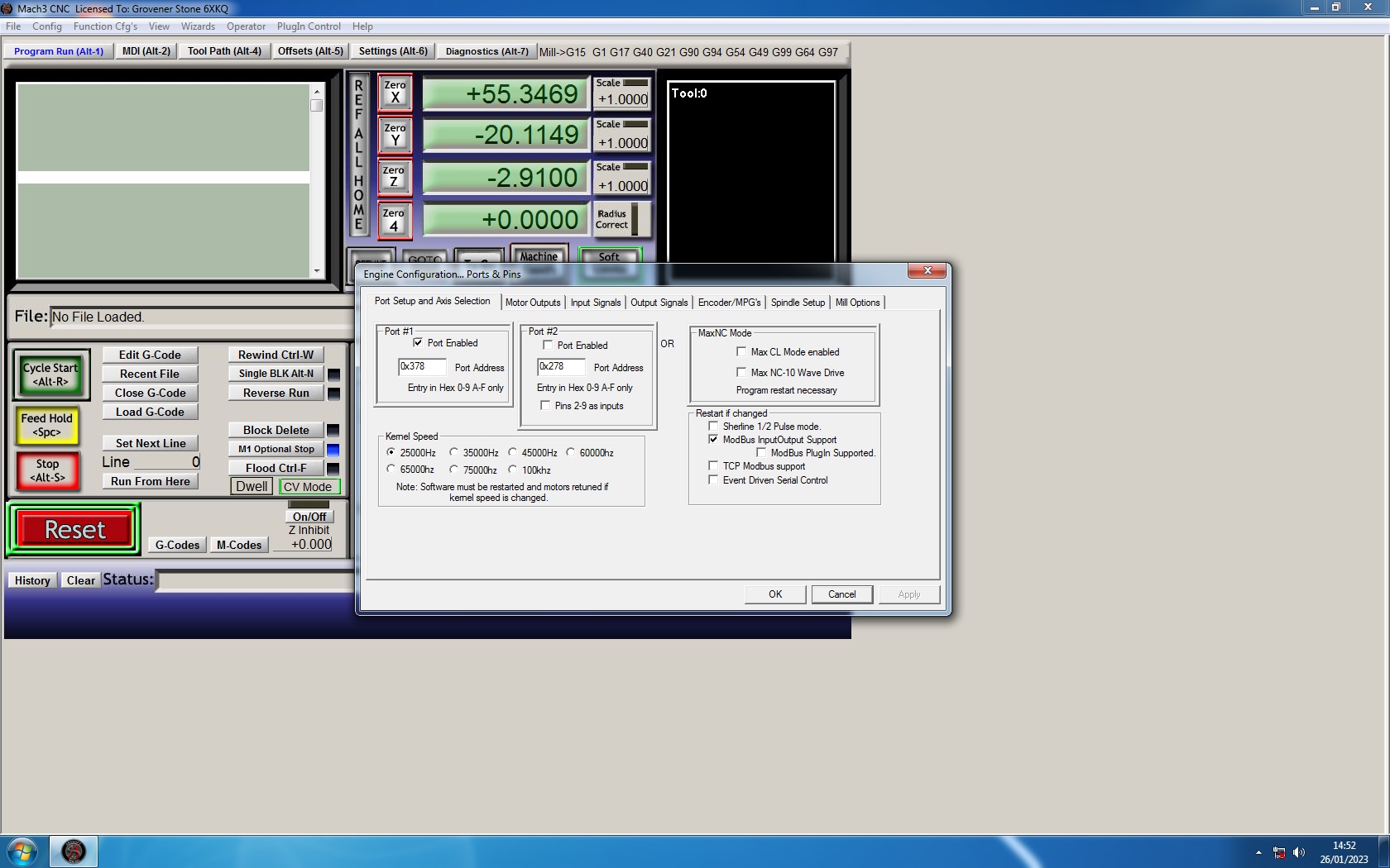

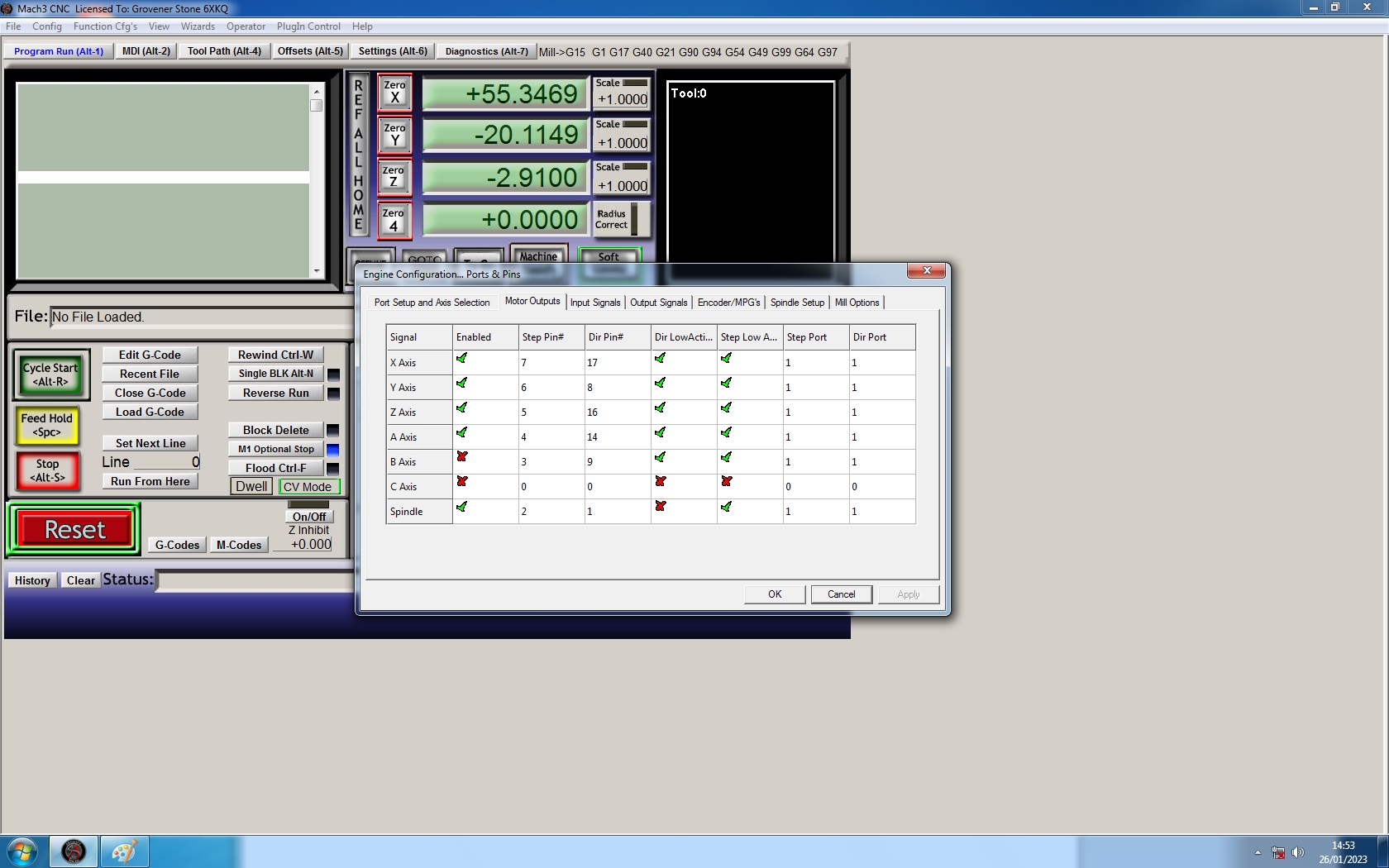

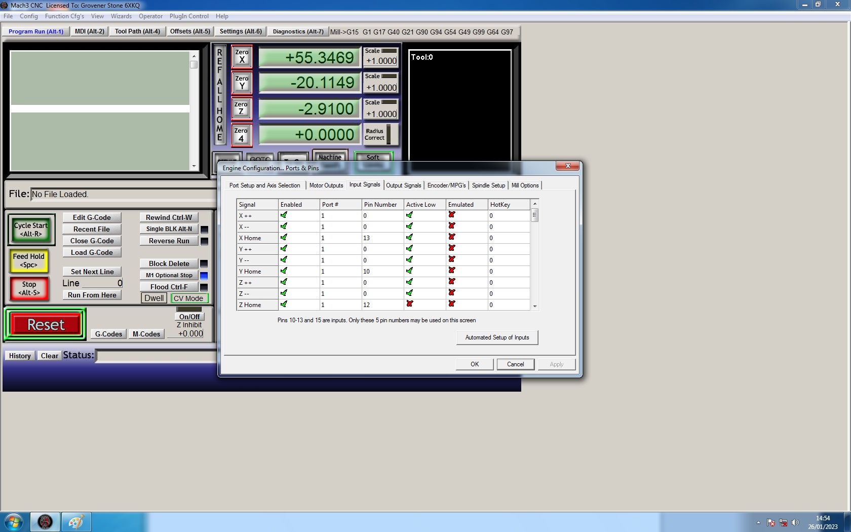

4 Attachment(s)
Re: MACH3 - Problem moving from XP to Windows 7
I'm having zero luck with this.
I've flicked through all the modes for the PP in the bios and tried each
The port address is definitely correct, the mach3 drivertest tool runs fine. I've gone through several threads and the fix is always something to do with the port address.
I've attached some screenshots of my stuff
Attachment 31675Attachment 31676Attachment 31677Attachment 31678

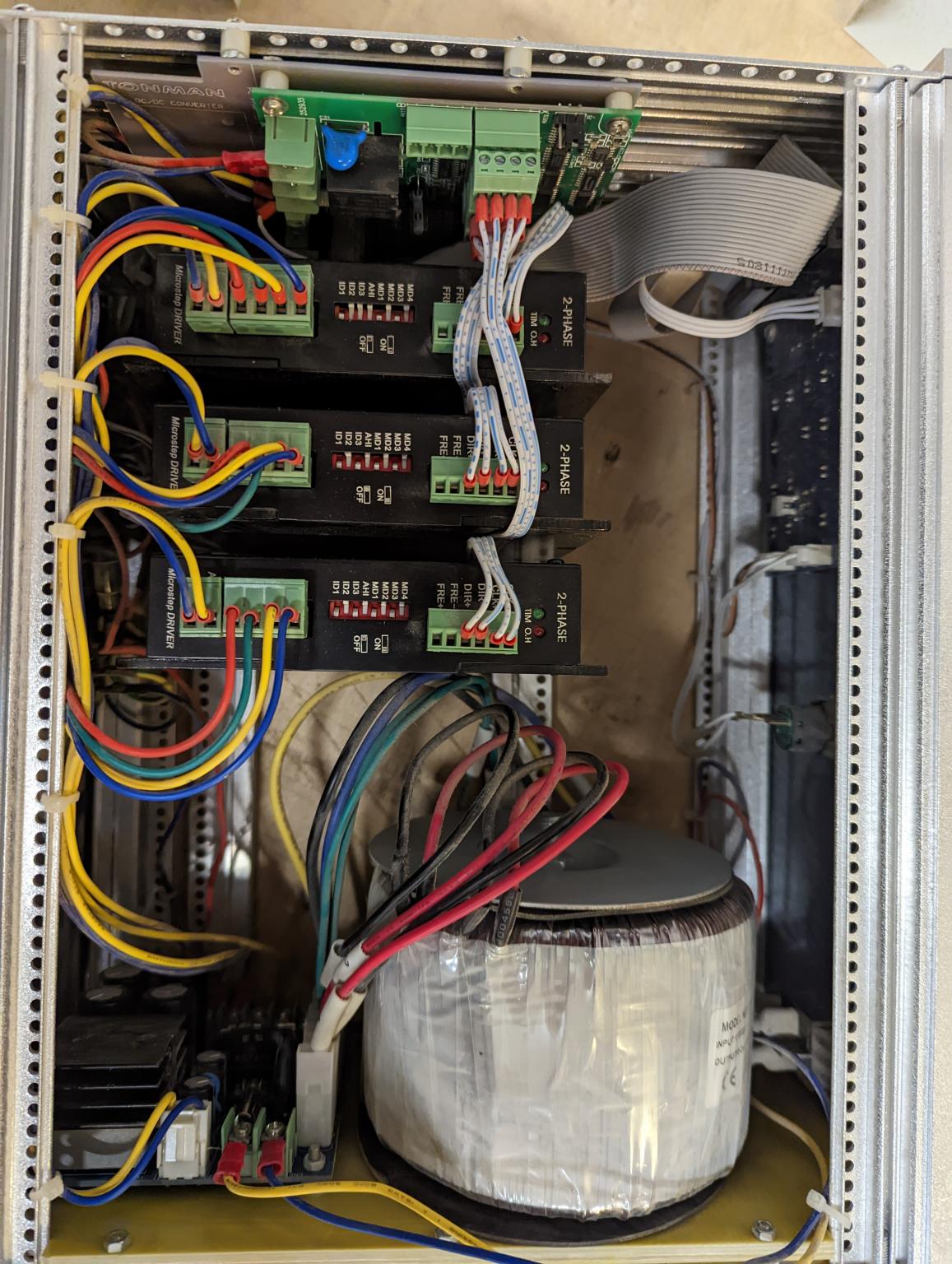

Did you manage to work out the wiring for the machine?
Have you got any photos of what BOB (Breakout Board) is fitted?
My suspicion is it's possibly a chargepump config issue.
The chargepump needs to receive a fixed frequency signal from the parallel port, otherwise it won't allow any of the outputs from the BOB to enable. It's a safety feature to avoid any 'random' movement/activations caused by uncontrolled parallel port outputs, which can happen as the PC hardware gets configured as the PC boots.
However, the fact the E-Stop light goes off during booting, may mean it's using a simple enable output.
Some photos of the inside of the control box would be helpful.

Really appreciate your input m_c. I've attached an image I have to hand of the inside of the control box, I can get a better one when I'm in the workshop tomorrow.Attachment 31679

That won't be an easy thing to work out, short of reverse engineering that BOB :/
Have you got anyway to get the config of the computer that died?
I think at this point, I'd suggest ordering one of the generic 5-axis CNC Breakout Boards from eBay. And just checked, there is a solitary one available via Amazon Prime - https://www.amazon.co.uk/Fasizi-Brea...dp/B09Z29TYNL/
There are a few resources for those generic BoBs, which removes having to guess what pins are required to get the Tonman BoB working.

Don't know if it helps but the yellow/blue power wires are in different position on middle driver.
