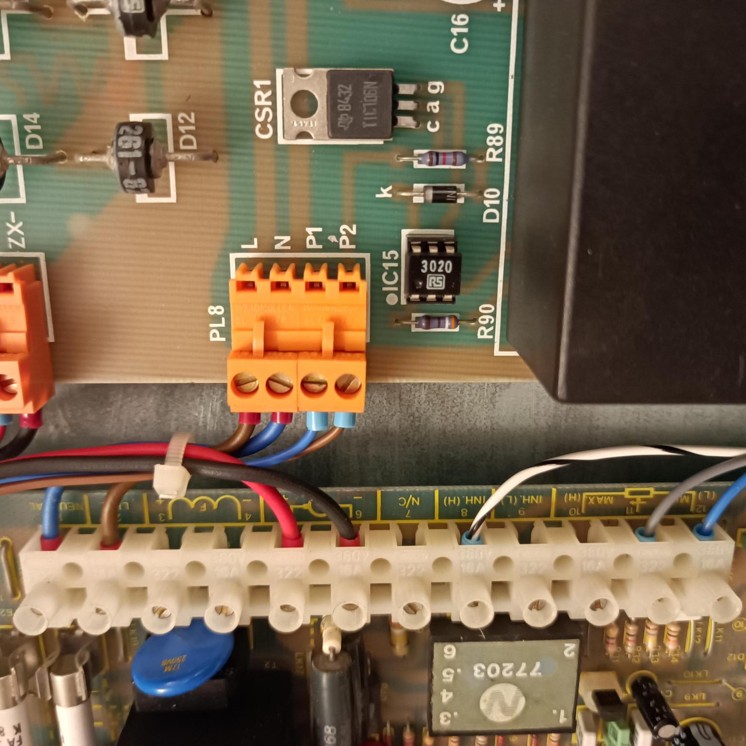

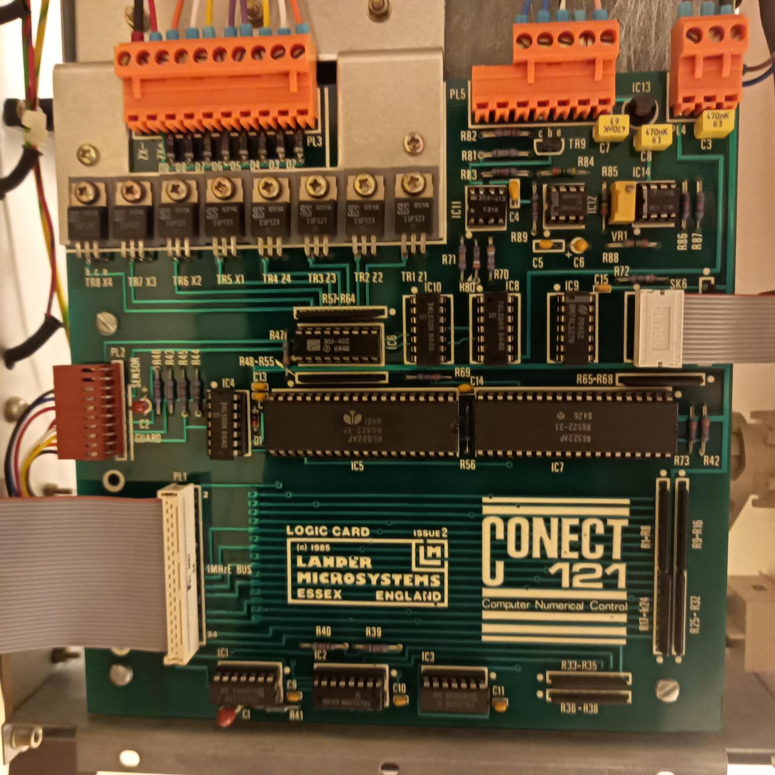

How do I go about using the original spindle drive? I believe it was controlled by the computer and not sure what I need to do on the control board to mimic that...Attachment 31688

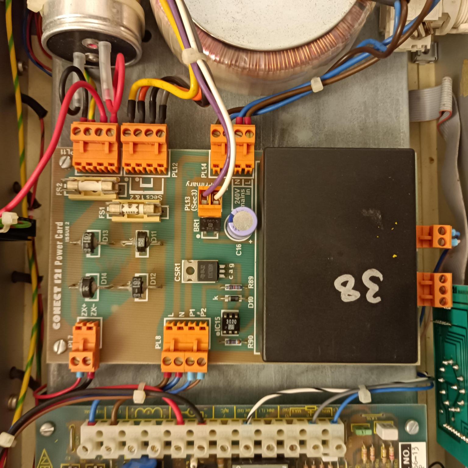

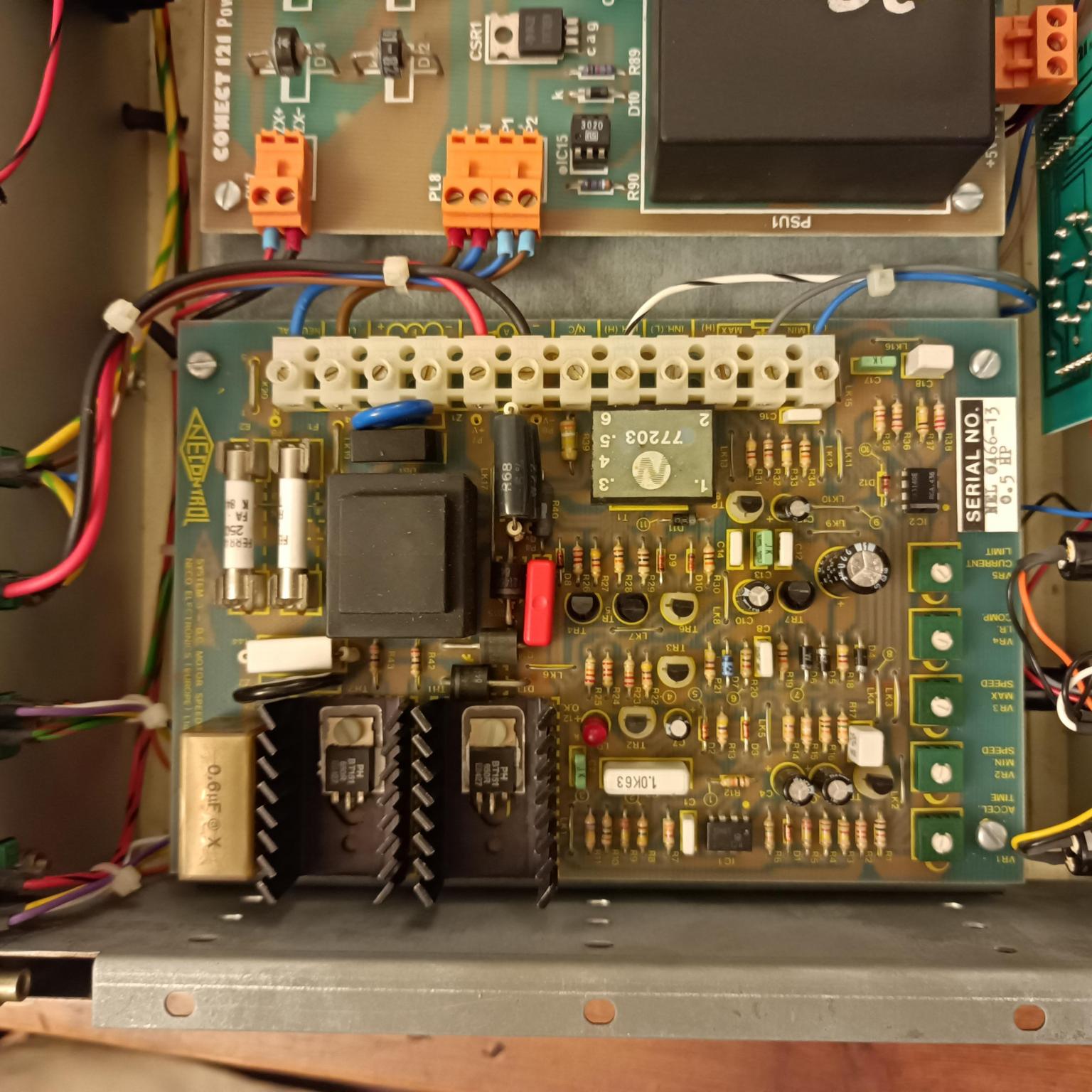

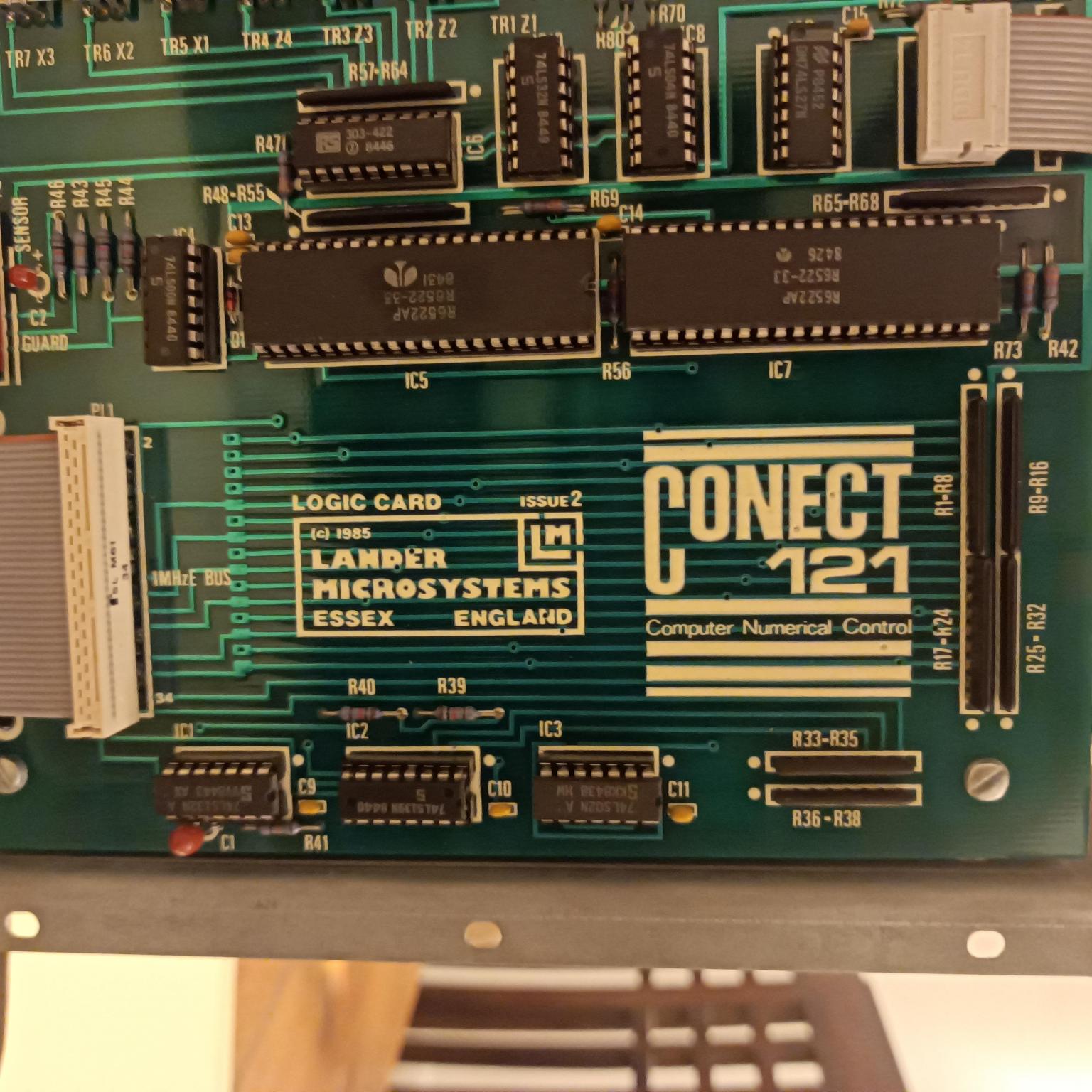

That's the early system.
The spindle drive board (in your first picture post), should have everything marked on it.
As it's a NEControl, I'm not sure if a manual will be easily found, but some google searches might turn up something.
The only unknown will be what the inhibit (white/black wire) gets switched to. I'd trace that wire, and see if you can work out the circuit it connects to.
As it's connected to Inh (H), I suspect it'll get 5V applied to it to inhibit (disable) the drive, with 0V connected to the speed control L.
The grey and blue wires will go to a circuit that outputs 0-10V (or possibly 0-5V - you can measure the voltage between the L and H terminals, which will give you an idea) to set the spindle speed
Does the original computer power up?
If it does, it would be worth measuring the various voltages, as it'll help eliminate guess work.
It would also let you test the spindle drive, as SCR drives do have a habit of the SCRs failing causing the supply fuses to blow.
It's also worth measuring the voltages on the power supply board (Second photo).
If it's anything like the later board, it'll output ~24V for the stepper drivers, and 5V for the control, as well as providing a pass through for the spindle supply.
Although I'm not sure what the big plastic box does. Is that where the wires from the spindle drive board connect?
If so, it could the isolation circuit.
Re: Conect 121 CNC Lathe Project
I plugged the computer in and it immediately started popping and smoking! Suffice to say I think the BBC B is dead. I have a bit of time tomorrow so will power the control box and see what I can find.
I found this on another forum https://www.cnczone.com/forums/gener...78836-cnc.html
Seems to think I can attach a pot to 10, 11 & 12. Not sure what I have to do to the INH - assuming that is inhibit and INH (h) means that it is inhibit when pin 8 has 5v then presumably if it's disconnected then it should run - or maybe I am over simplifying!
You can connect a pot, which if you have one laying around (IIRC they're normally around 100k), I would wire up just to check the drive still works. But as I've already mentioned, be aware those control terminals are probably around half mains voltage.
However I'd aim to keep the spindle computer controlled.
Most breakout boards are capable of 0-10V control, and just need an isolated 12V power source to avoid issues with non-isolated drives. A small DCDC converter is typically used for this, but that power board may already provide an isolated supply.
Inhibits on those boards generally need connected to inhibit. In the case of H, it needs power applied, or in the case of L needs connected to 0V (which may not be 0V in relation to earth)

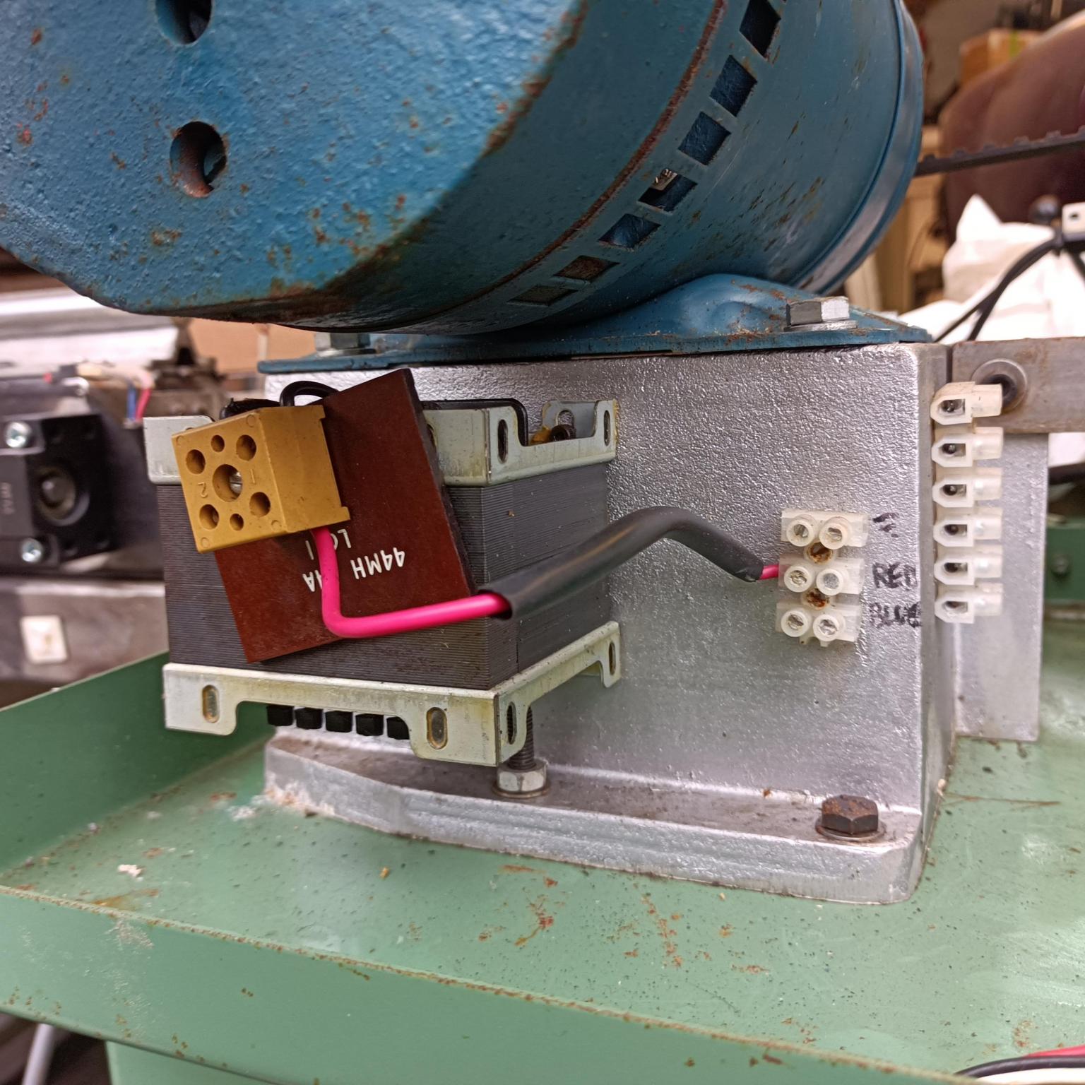

No luck yet with the motor controller. It has 240v to it, I can measure 12v across pins 12 & 10. I attached a pot to 12 & 10 and 11 and can vary 11 between 0-12v but not seeing any output from the motor controller. Tried it with inh connected and disconnected. The motor turns if I attach a 12v supply directly to it. Is there any more I can try with the original motor controller? There is also a component attached below the motor - not sure hat this is...?

That's a choke. They help smooth/suppress noise from the motor.
It's worth checking it's not failed and gone open circuit (either with a multi-meter, or apply the 12V with the choke in circuit).
Have you checked both fuses on the drive?
It could be the Inhibit needs a certain voltage applied, but without a manual, or being able to work out what the wire gets connected to and fed, it's pretty much guess work.
THanks MC.
How would that choke be wired? Is it in series like a resistor? It's not wired up at the moment.Attachment 31706
It should be in series with the motor.
The fact it's been disconnected would indicate there's been a problem.
Depending on how much money you're willing to spend, and your modification abilities, if I was to retrofit one of these now, I'd probably fit a 750W servo motor and drive. Certainly more expensive than just a DC drive, but would give more control over the spindle (depending on which controller you fit).

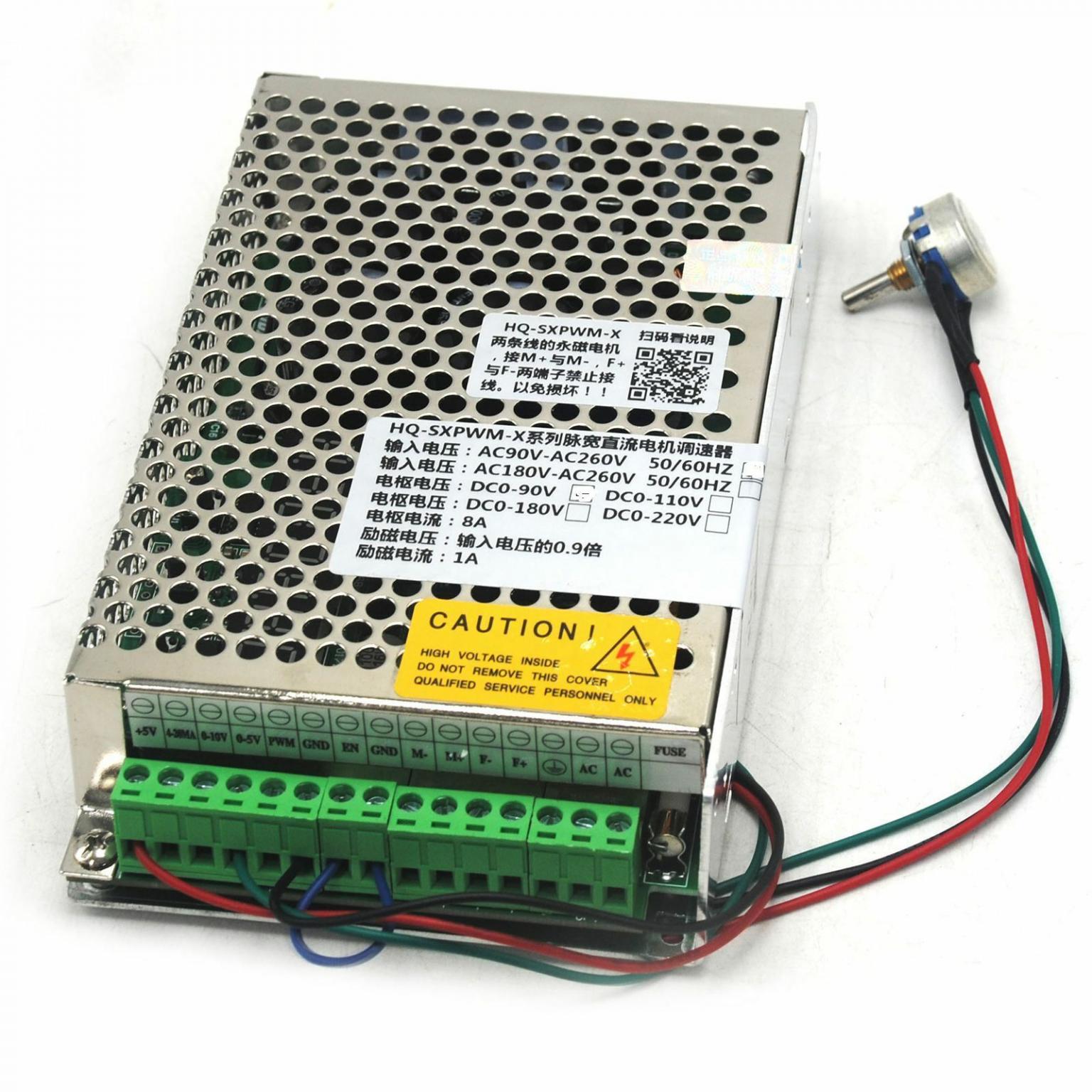

Not had much time but a bit of progress on this.
Replaced the original x axis stepper with a Nema23 which was a direct swap, bolt holes all the same etc.
I ordered a cheap chinese motor controller which arrived today and seems to work well - motor is dead quiet and smooth. It's running off a potentiometer so need to figure out how to get that controlled by software at some point.

That's presumably for the spindle motor? Important to check if the pot is isolated from the mains to determine how to control from Mach.
JohnHaine
Thanks John, how would I determine that?
Well I would normally say, look at the documentation! But there probably isn't any.
A lot of lower-end motor controllers, especially ones using Triacs, do not have an isolating transformer so that, though the control electronics may be working at "safe" voltages like 12v the actual common side (-ve supply) can be floating at half mains voltage. I have a KBE speed control on my Novamill where this is the case. If you then try to connect the control voltage input and Gnd connection to your properly grounded BoB and motion controller the ground connection puts a dead short across the internal rectifier which blows up - worse it may take the other electronics with it. There are ways to isolate the control electronics using opto couplers so it is operating safely with a proper ground connection. I see that the description includes the cryptic phrase "4, high and low voltage signal is completely isolated, the use of safer" - which is hopeful.
To check, you need an AC voltmeter such as a digital multimeter capable of measuring mains voltage. Have the unit wired up (including to mains earth) and running the motor. Set the meter to its max AC volts range, and using INSULATED probes measure the voltage on each of the 3 terminals connected to the pot - if they are all at or around zero volts it should be OK. And, before doing this test, set the meter to measure ohms and check that the black wire has continuity to mains ground (unit switched off of course).
