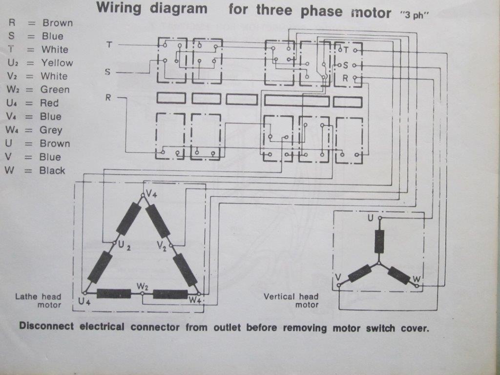

Have attached a copy of the 3 phase wiring that i got when i first bought the lathe, the recently purchased motor is Emco specific but don't know if it's same as shown in the circuit diagram.

Bizarrely the lathe motor has delta windings and the mill head star!
But the real question is what the winding config is on your new motor. Is there a connection cover you can remove and get a photo of it? If it can be easily converted to delta then the neutral, the place where all the windings are connected at one end at the centre, would be accessible at screw terminals and/or have links.

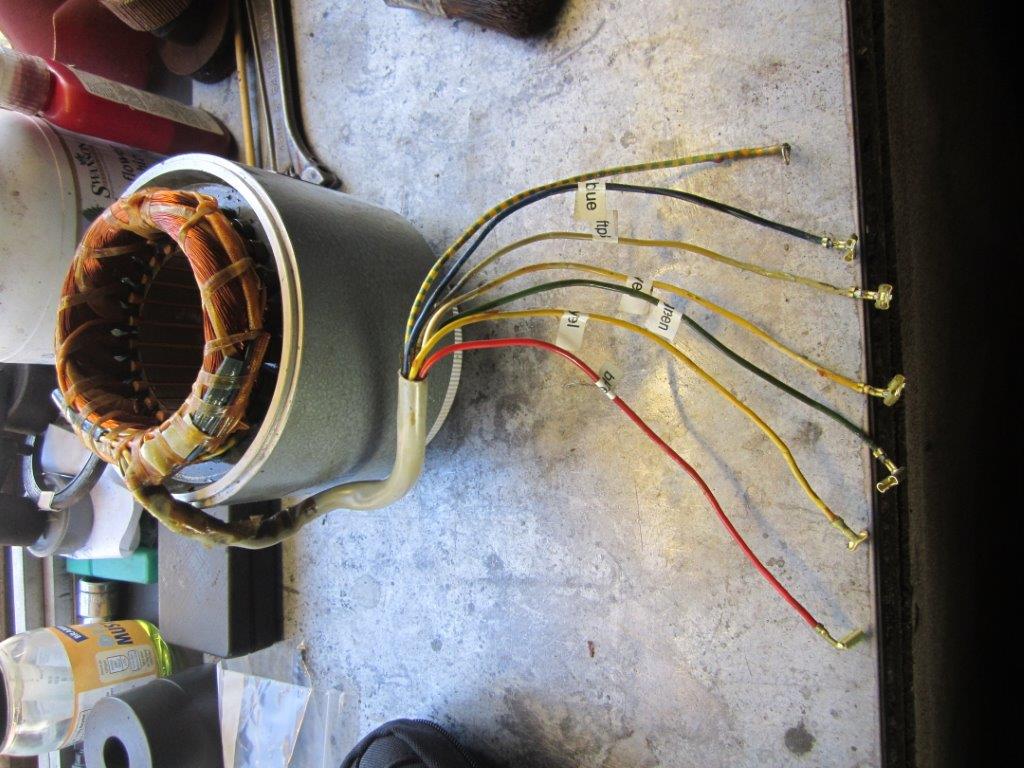

Re: 220V single phase to 380V three phase
as you can see no terminal connections.
any ideas on how you would connect to the VFD ?

Hard to make much of the photo as some of the leads seem to be labelled with their colours and some with something else! Could you possibly say what the labels say on each lead with its colour? - that might be helpful.
There seem to be 7 wires on a 3-phase motor, so I would guess that one, possibly the green/yellow one, is ground and connected to the frame - easy to check. I don't think there could be 7 wires on a single phase. The reason why 380v is associated with 3 phase is because that's the phase-to-phase voltage, which corresponds to 230v phase-to-neutral. Your home single phase supply is usually one phase of a 3 phase supply with a neutral.
That leaves 6 more wires. Measure the resistance between them in pairs. If you are lucky you will get 3 pairs that look nearly shorted but each isolated from the other two. That would mean a simple 3-phase winding that you could easily connect in delta to run on 230v but since the plate indicates dual speed then probably not so lucky.
The only other thing to do is measure all the resistances from each terminal to the other 5 - not so bad , I think there are only 15 measurements to make. From those we might be able to figure out how the windings are configured and which wire goes where.

Sorry about the slight delay with the winding readings, was trying to get the motor mounted yesterday and discovered a slight problem.
John
The labels on the motor leads were only to identify the connection to the switch terminals, the issue with the cable colouring is due to what appears to be some form of insulation coating that has discoloured with the passing of time.
Readings as follows.
V4 Blue to V2 White 85.4 Ohm
V4 Blue to U2 Yellow 47.0 Ohm
W2 Green to W4 Grey 85.4 Ohm
W2 Green to U4 Red 49.4 Ohm
U4 Red to U2 Yellow 85.4 Ohm
W4 Grey to V2 White 46.5 Ohm
Attachment 31806
What you have I think is a Dahlander connected motor.
https://en.wikipedia.org/wiki/Dahlan...changing_motor
https://en.wikipedia.org/wiki/Dahlan...:Dahlander.svg
I think to run in low speed mode you connect the 3 phase wires to U4, V4, W4. For high speed U2, V2, W2, and connect together the suffix 4 terminals. Both ways the motor will expect to see 380v for full power so will give lower power at 230v.
And is the 7th wire connected to the frame (i.e. ground)?
