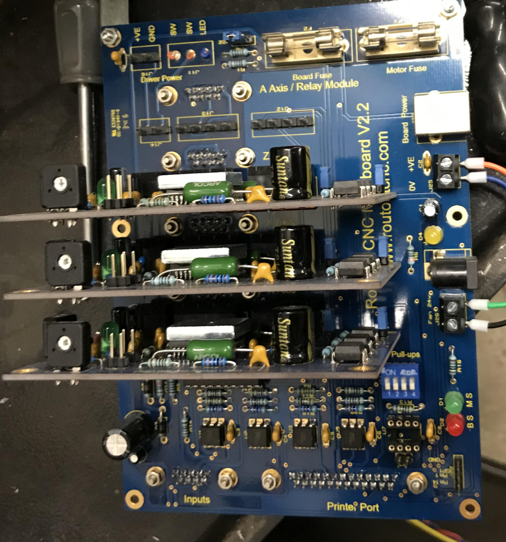

Your point does open up the question of why I am looking for a routoutcnc driver specifically, and the answer is that I’m playing it safe because I have limited knowledge and limited cash to experiment with. I have a routoutcnc BoB and the routoutcnc drivers attach neatly with screw terminals to pins on the BoB, and I know that they will work together. However, the routoutcnc drivers are in fact underpowered for my new steppers and ideally I'd get beefier drivers.

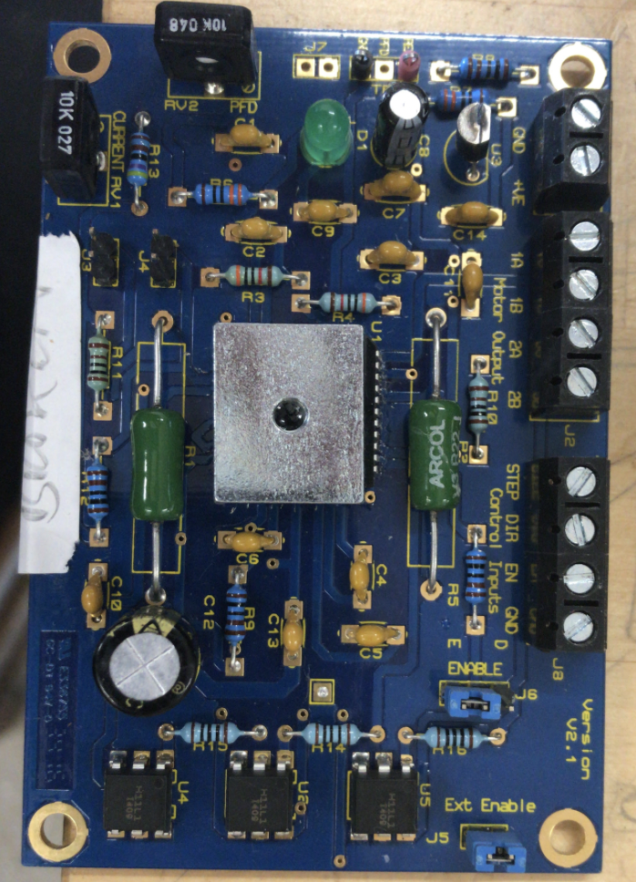

This is the routoutcnc driver’s specs:
https://www.tiggyengineering.com/wp-...5ampdriver.pdf
Routoutcnc Breakout Board:
Attachment 31880
Routoutcnc driver:
Attachment 31879
As you can see the driver has 8 screw terminals that connect to the BoB:
GND, +VE, 1A, 1B, 2A, 2B, STEP, DIR, EN, GND

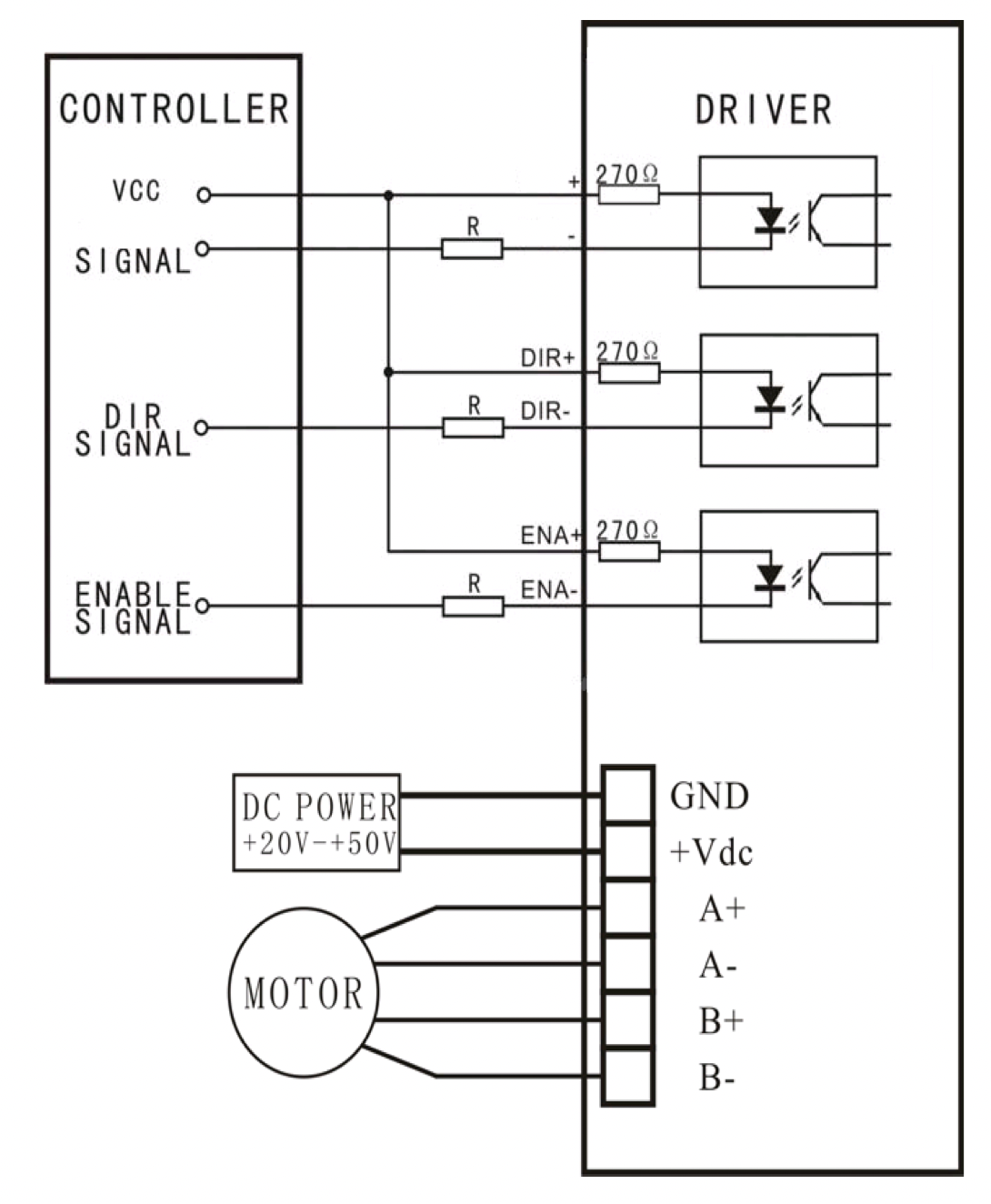

Could I bother you with one more question on this. Looking at the wiring diagram for the CNC4YOU driver you linked, the driver connects to a controller with four terminals: VCC, SIGNAL, DIR SIGNAL, ENABLE SIGNAL.
Attachment 31881
As mentioned, mine are labeled differently (STEP, DIR, EN, GND). I'm concerned by the difference between the diagram's VCC to my controller's GND. You mentioned "you just ground the side labelled "-" on each" but the diagram shows the -'s connected to the controller's SIGNAL, DIR and ENABLE terminals, and the +'s connected to the VCC terminal. Should I be worried that connecting the driver to my controller's GND terminal would not to the same thing as connecting it to a VCC terminal as shown in the diagram?
Sorry to drag this out, I really appreciate your help.
So the CNC4YOU diagram assumes "open collector" outputs on the controller. The driver has opto isolators on each input, with an LED that illuminates a photodiode so there is complete "galvanic" isolation between the inputs and the internal circuitry. Each LED has a 270R current limiting resistor as well as potentially another series resistor R which may be needed with higher values of Vcc as shown in the table.
Your controller seems to have +5v logic outputs rather than open-collector judging by the spec of the routout stepper driver - do you have a spec for the controller itself? Assuming that I'm right, the BoB outputs should go to the + side of the driver inputs rather than that being connected to Vcc, and the - sides should be grounded to your BoB ground. You should not need a Vcc connection between the BoB and the driver since this is derived internally.
You may find that the logic levels are now inverted in which case you will need to fix them in config.

Hi John, I’ve wired everything up but the stepper only moves in one direction. The BoB remains unchanged, the pulse/rev matches the BoB at 1600, stepper current is just under the stepper’s rated current, and logic voltage is 5v. Any ideas? Thanks
In case it is to do with the DIR circuit, when jogging in the direction that does work (-X), the DIR pin is reading 5Vdc on my multimeter. When I jog in the other direction, which doesn’t move the stepper at all, I’m getting a reading of 45mV.
If you can in the controller (Mach3? ) try changing the sense of the step pulses in configuration.
Figured it out - In Mach3 config > Port and Pins I had to tick Step Low Active... At that point the stepper was running at normal speed in one direction and really slowly in the other direction. Then realised I had incorrectly wired a ground needed by the routoutcnc motherboard (BoB). The motherboard has two GND pins and I was grounding one only (the wrong one). I switched it to the other GND and everything started working.

This is a Routout cnc motherboard V2.1 and a Stepperonline DM542T driver and CNC4YOU 1.5Nm Nema23, on a Denford Novamill running Mach3 via a UC100 motion controller. I am using a stepper online 36V 400W power supply. The routout cnc motherboard is still powering the Y and Z axes - the new setup is currently for the X axis only.
