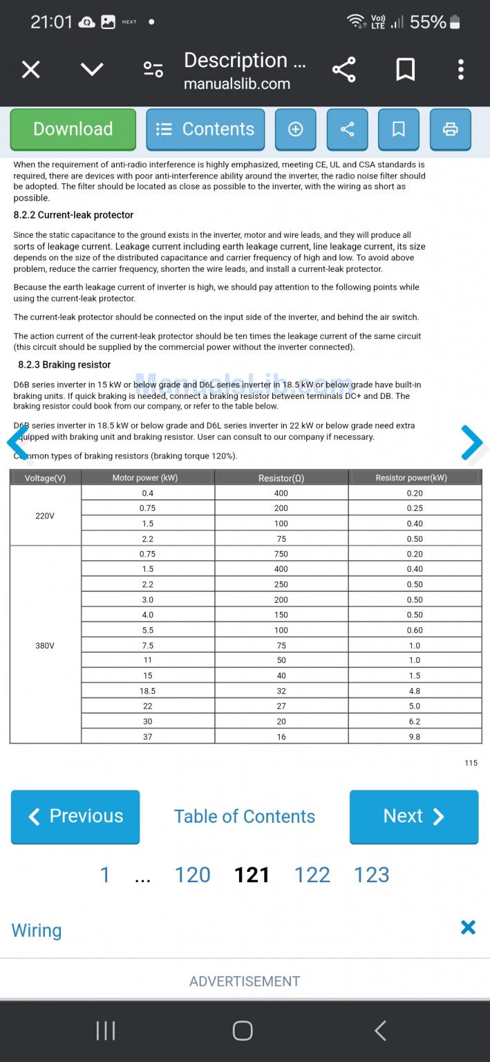

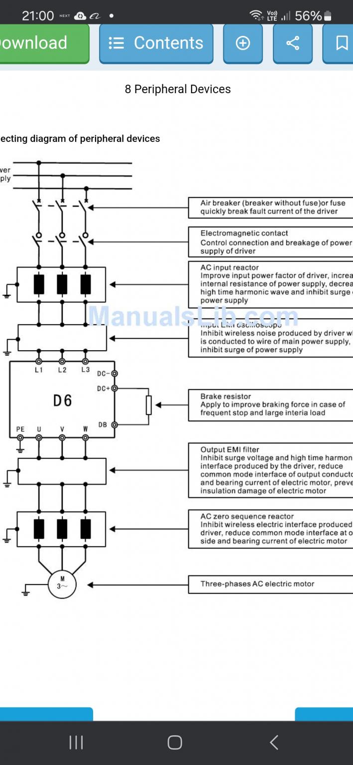

 Quick update
 The Chinglish has confused me again here it's contradicting itself, I've just found a diagram that says the Break Resistor should be connected to DC+ and Db as far as I can see I don't have a Db terminal..??
 Attachment 32210
 Also, found the ohms rating for this VFD (11kW) should be 50ohms I have a 60ohms Resistor... is this a possible issue that could be affecting the breaking time...???
 Attachment 32211

		The supplier has just got back to me and suggested increasing the Break Resistor to a 1500w 75ohm type, but from my understanding a 75ohm would take even longerr to stop than my 1000w 60ohm one..?
 Haha yes, that wouldn't help. Did you lower the threshold voltage (parameter 01_31) to 600V (not critical but probably helps)? Brake utilisation rate (01_30) probably needs to be 100% for max effect. You might also need to set stop mode (01_07) to zero ie "decelerate stop" - it sounds as if you may have it set to 2 ie "DC braking".

		Re: Testing The VFD, Break Resistor and Wiring to AXBBE
		Haha no, don't connect the resistor across DC+ and DC-. That is rectified mains voltage.
 You misread / misremembered the words "Braking resistor is connected between R+ and R- or DC+ and R-"
 The "R-" terminal is the braking resistor switch that goes low when the VFD wants to initiate braking. Otherwise it draws no current and should read 330V or so.
 What is your decel time set to? If it is set nice and short, the decel should cause the voltage to rise until the braking threshold is met, at which point, voltage should appear across the resistor.
		Hi Muzzer, my instinct was correct then, I haven't connected the Resistor to the DC+ and DC- so that's a good thing.
 You say the R- should read 330v, so are those readings for the R+ and R- bad then the max it went to during Braking was 22vDC
 I've had the Decel set on quite a few different settings during the test but I think it's 5 seconds at the moment, the quicker the better, so I could bring that down to 3 seconds maybe...  I think I kept getting faults the last time I changed it too low, but 3 seconds might be ok...
