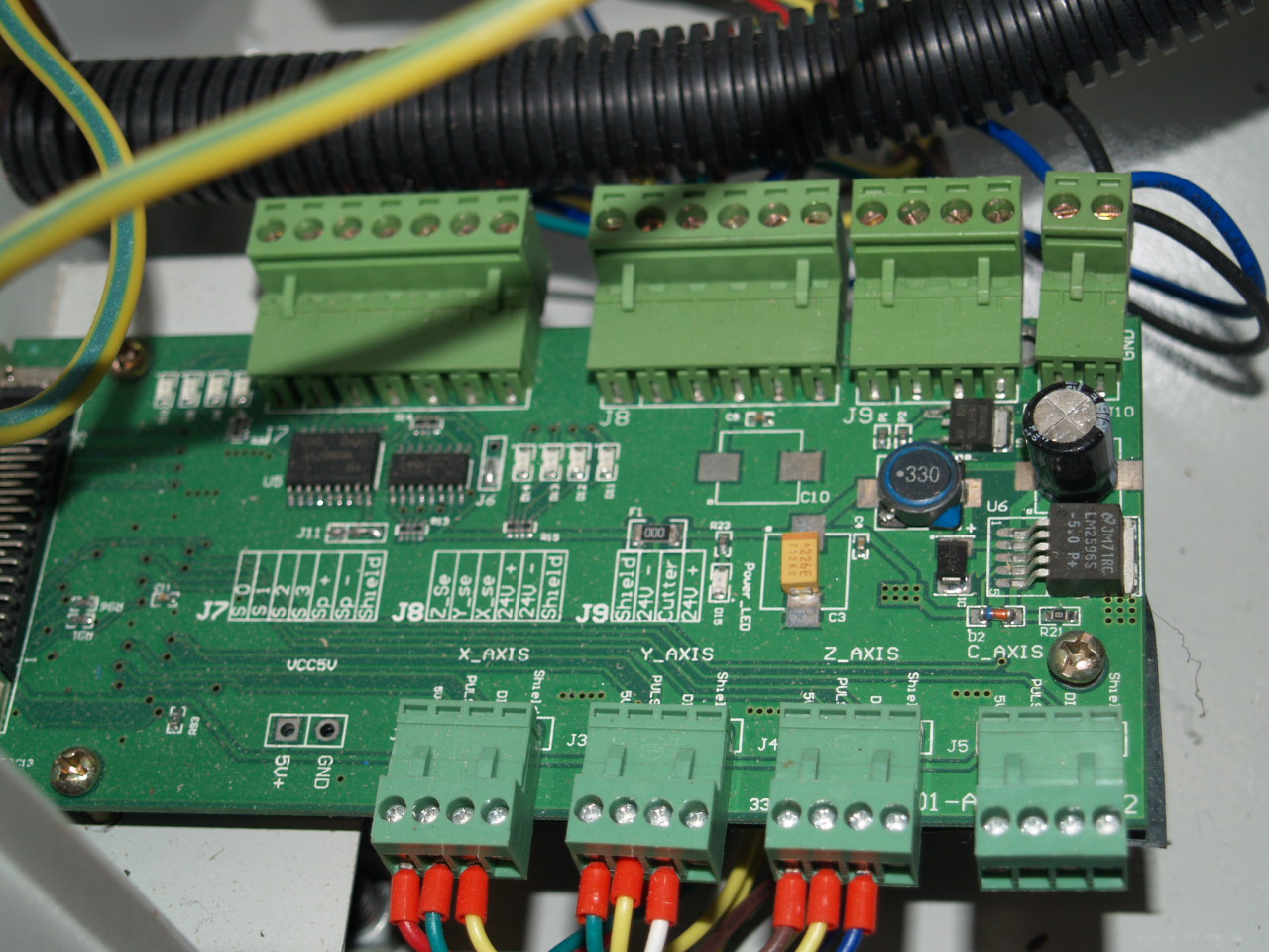

Hi John,
Thank you for the reply - I have a copy of the A11 manual and have been through this multiple times.
I will triple check the direction wire connection again.
Can you elaborate on the potential issue with direction signal and step pulse - How exactly do the two relate?
The stepper motor is NEMA 34, and has 8 wires entering/exiting it if that helps with the diagnosis...

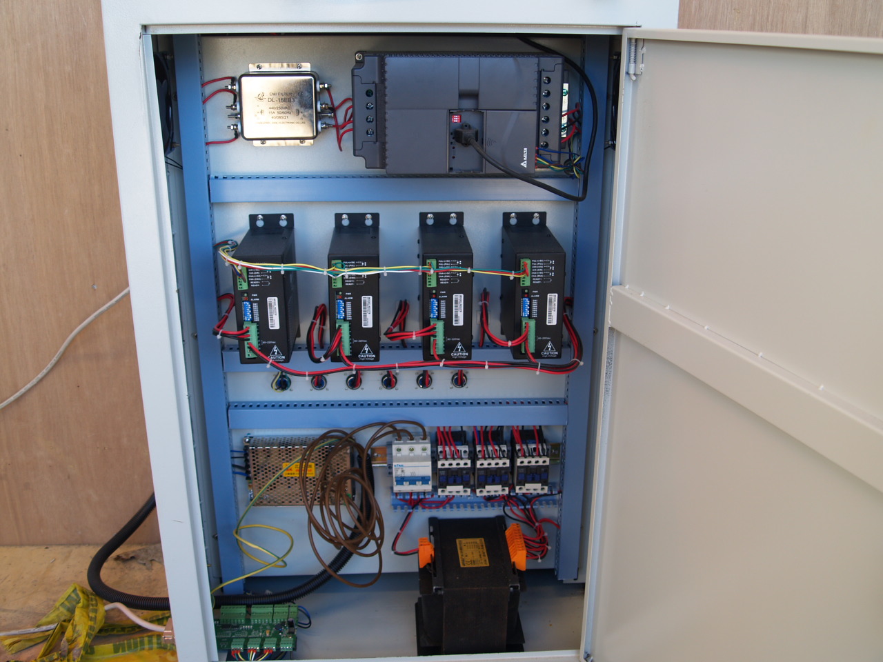

UPDATE:
I swapped X motor driver with the Z motor driver.
I have not yet been able to reproduce the homing the wrong way issue BUT I repeated the lettering V Carve and pocket files in this order:
30 Degree v-bit
1/16 end mill and 1/8 end mill for pocket.
30 degree and 1/16 end mill were flawless. Unfortunately 1/8 end mill toolpath did not go to plan. The lettering was destroyed with what looks like horizontal fluctuation/ abnormal movement likely caused by x axis issue.
Therefore this is likely to be a bad Leadshine DMA860H microstepper driver.
I am fully aware that any electronic product can develop faults but how likely is this?
Has anyone else had driver issues before?

Re: Help diganosing fault with chinese Chinese CNC router
UPDATE
New driver installed and problem has been resolved - thanks for those who chipped in.
