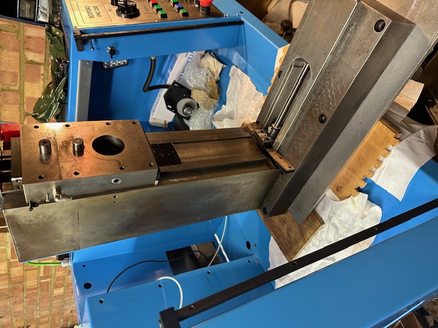

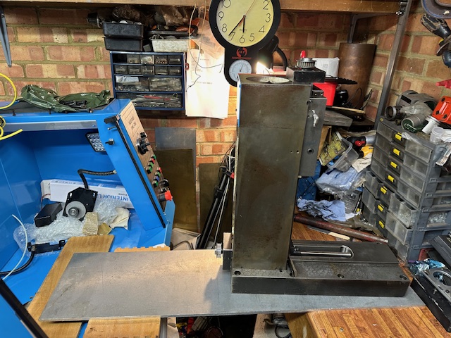

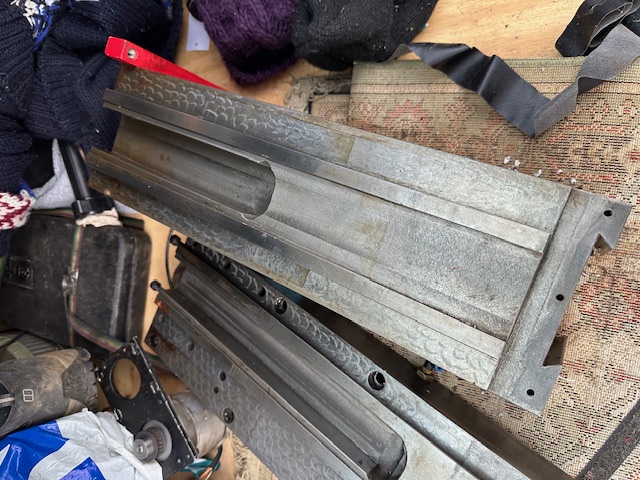

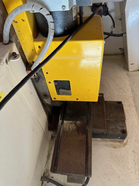

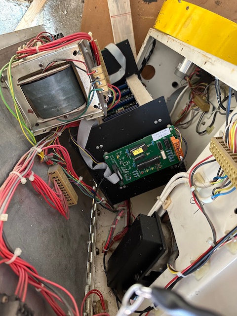

The first thing to do was strip down and see what needed doing. The bed ways and head come off pretty easy and most of the rust was on the surface only, The ball screws seemed OK but felt very gritty, so needed striping and cleaning at the least. The milling head is removed by removing the stepper motor and ball screw attachment bracket, the hole lot then lifts off. The actual milling head on the 260 can be rotated to turn the machine into a horizontal machine, with the head being pivoted. Once the slides had been removed the slideways looked pretty good with the original scraping still looking good. The base of the Y axis is bolted and glued to the cabinet and requires quite a bit of force to remove once the bolts are removed. The column is held to the Y axis with M8 screws from the underside, forming a very substantial and heavy assembly! Pictures below.
Attachment 32601
Attachment 32600
Above Z axis drive belt and pulleys
Attachment 32602
Above the Y axis removed showing the ball screw and nut
Attachment 32603
Above the spindle pivot for, which retains the head to the Z axis for rotation to horizontal position.
Attachment 32604
Attachment 32605

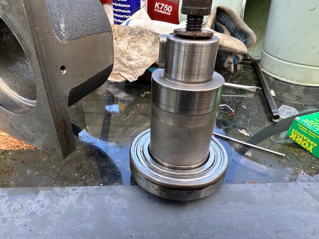

Above the spindle removed from the head, the bearings are are just deep grove ball races so these will be upgraded to angular contact bearing of the same size.
Attachment 32606

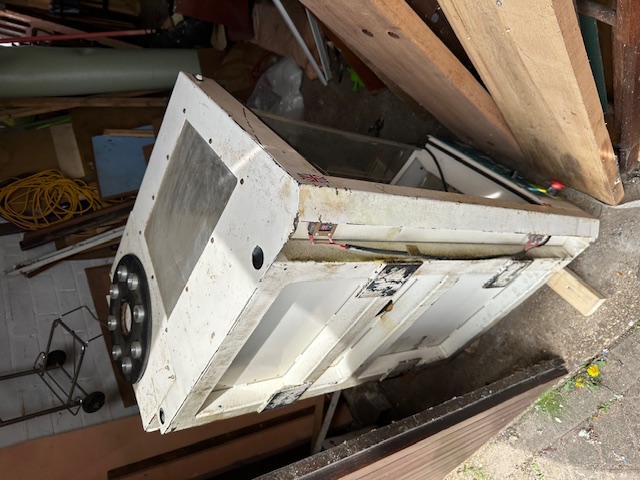

The vertical column and y axis base removed from the cabinet
Attachment 32607

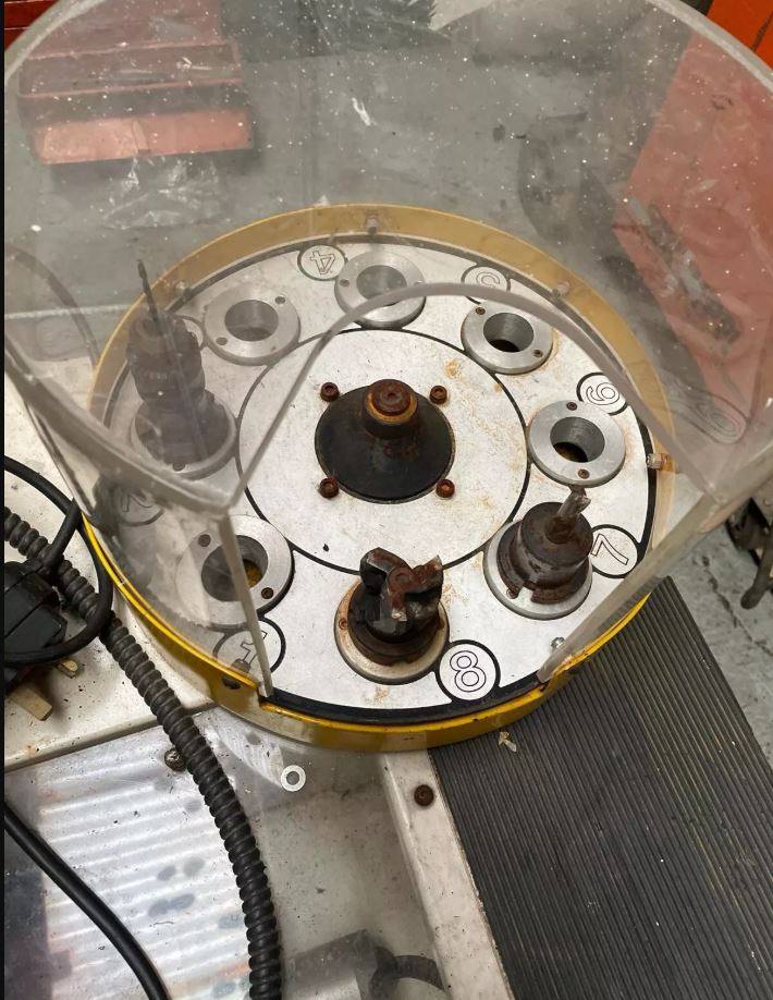

Above the stripped out cabinet, waiting for a decision on what to do to it!

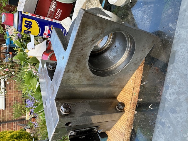

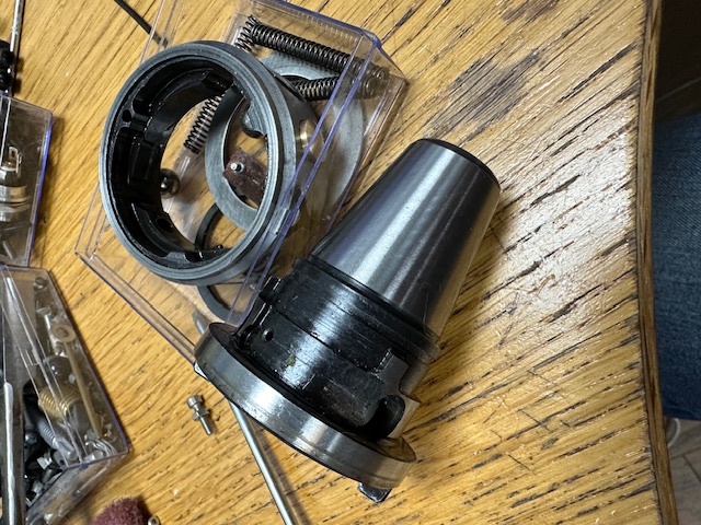

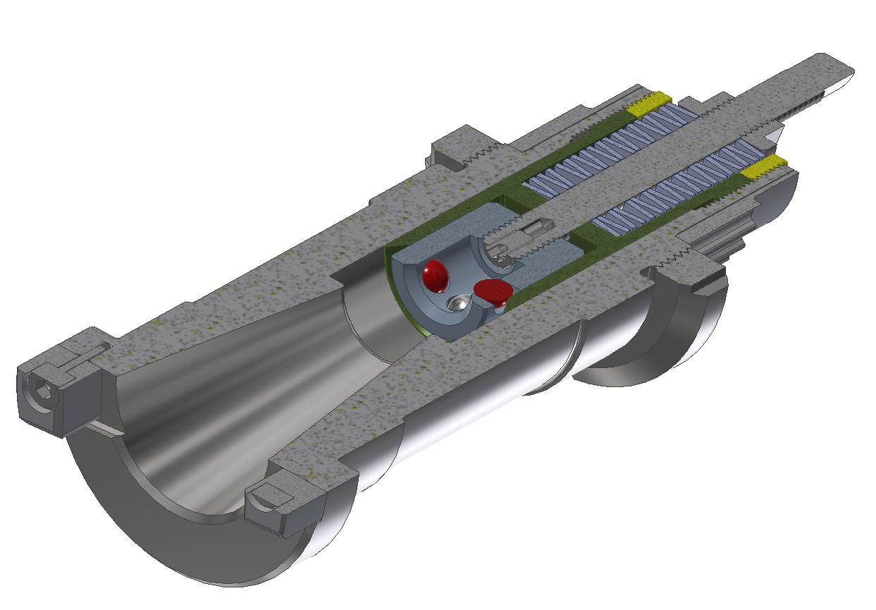

So pretty much after checking all the parts I decided to rebuild the 260, I was originally going to scrap the cabinet as it was rusty inside and out, and also made machine pretty large for my cramped workshop. But in the end I kept it and do think it was the right decision. The plan was to replace all the electronics, replace the spindle motor with a 1Kw AC servo motor, make a new control panel with jog wheel, feed rate and spindle overrides. The controller chosen was a the very capable UCCNC UC400ETH. I had also decided to replace the spindle bearings with 7009 angular contact bearing instead of the deep groove ball races.
It took a few days to totally strip the machine, the main base is held in place with M8 cap screws one of which is hidden behind a cover that run up the edge of the column. With the bolts removed it is possible with large amount of persuasion to break the bond of the glue that seal and holds the base firmly attached to the cabinet.

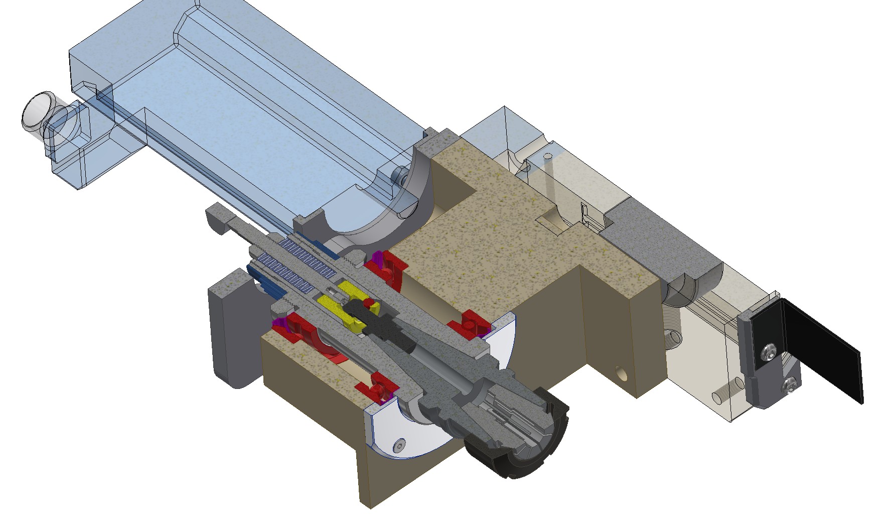

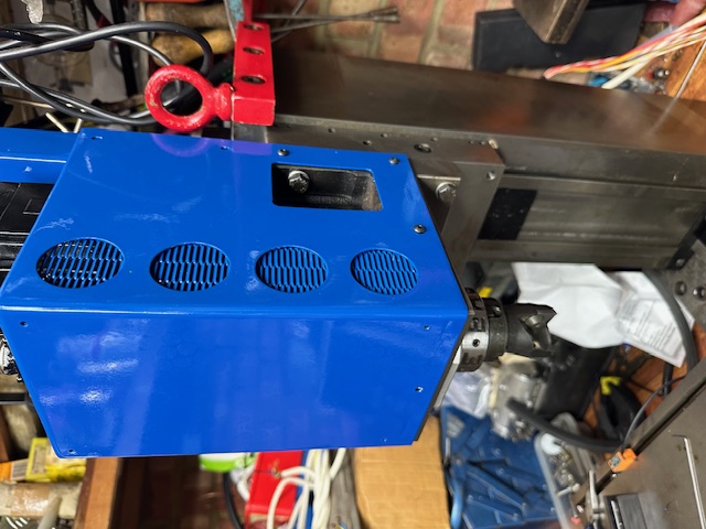

With all the parts removed I made a start on the spindle upgrade this was to be straight forward and was to start off! after cleaning and removing the spindle first thing was to set up the spindle housing to drill and tap holes for a spindle nose cover, this is needed as the angular contact bearings do not have dust/ oil seals. so the plan was to use "NILOS" sealing rings and an spindle nose cover to protect the Nilos ring and act as an extra protection from swarf, I also decided to fit a Z axis wiper while the machine was apart and the Boxford is only fitted with bed wipers on the Y axis. Pictures below I hope will be useful to someone!
Attachment 32617
Above cross section of the spindle showing the Nilos ring (yellow) and spindle nose cover
Attachment 32618Attachment 32618
Above Z axis wiper, which was 3D printed in nylon.
Attachment 32619
Attachment 32620
Above test fit of a 3d printed spindle cover.
Attachment 32621
Above: completed spindle cover fitted
Attachment 32622
Above: I also added some oil grooves to the Z axis as it only had a 3mm hole at one end on each side.

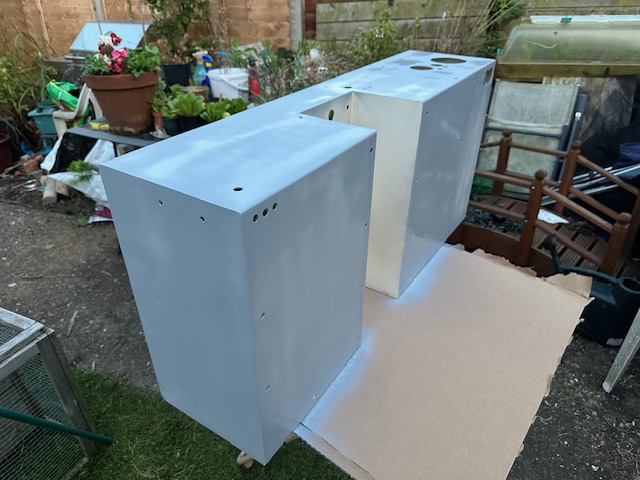

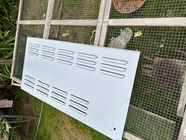

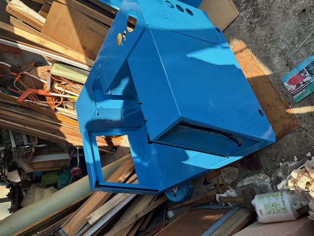

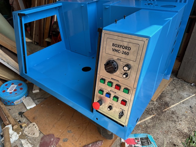

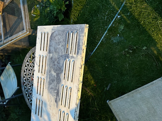

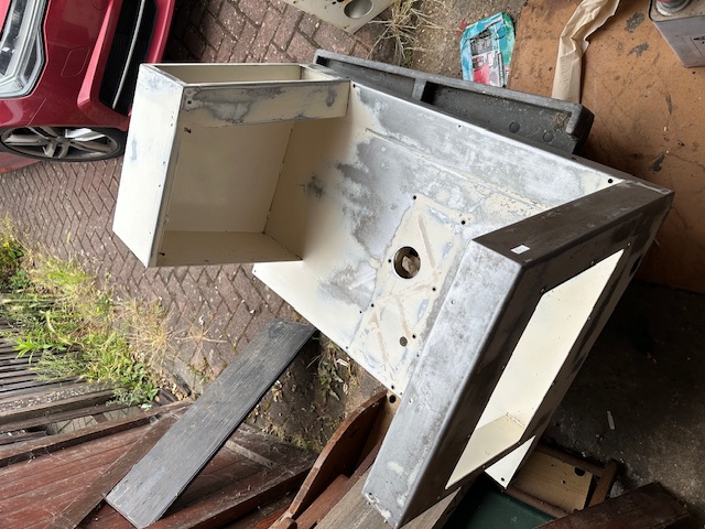

Below are pictures of the Cabinet parts, clean up and painting.
Attachment 32623
Attachment 32624
Attachment 32625
Attachment 32626
Attachment 32624
Attachment 32627
Attachment 32628
Attachment 32629
Attachment 32630
Attachment 32631

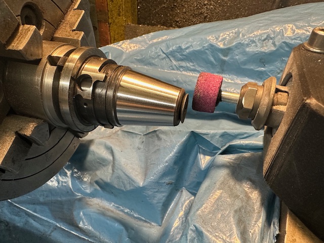

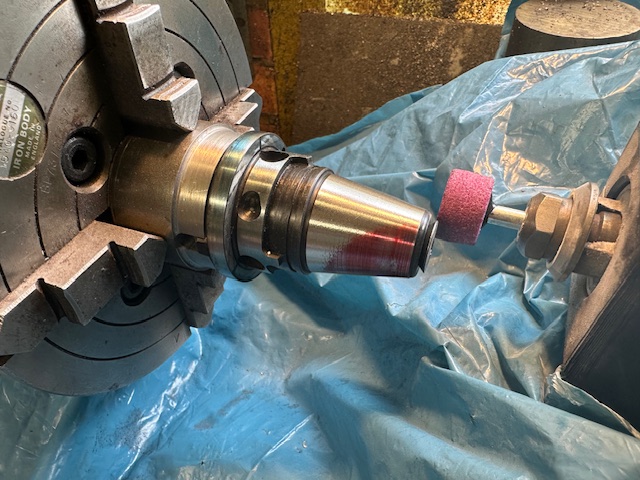

Right, if you’re thinking of picking up one of these mills, there are two key things to check before you part with your hard-earned cash:
Is the spindle running true? (Mine, er, wasn’t.)
How much backlash is lurking in the ball screws?
I’ll admit, I didn’t even think to check the spindle (not that it was important for the what machine cost). I’ve never come across a machine with such a wobbly one! The spindle itself was alright, maybe 0.005" out, but the Coventry Easy Change master holder fitted to it? A ridiculous 0.2mm off true. Pop a tool holder in, and it’s like watching a wonky spinning top. My first guess was a proper crash—someone giving it a right wallop. But I’m not convinced. The holder’s not shaped like it could bend easily, and the error was consistent along the taper. Feels like it was machined eccentric from the get-go. This being a late ‘80s model, ringing the manufacturer (still trading, mind you) for a refund was a bit optimistic.
By this point, I’d poured too much time into this project to chuck it in. So, my options? Shell out a few hundred pounds for a new master chuck body or try to salvage the dodgy one. Problem is, the body’s hardened to 55-58 RC, so turning it was out. Time for some workshop bodgery. I 3D-printed a mount for my Metabo die grinder, turned a mandrel on the lathe, and draped my trusty S&B Model A in as much protective cover as I could. Then, I set to cylindrical grinding the outer taper of the master chuck, this time true to the bore. The finish came out surprisingly decent, but I’m not keen on making a habit of it—my lathe didn’t sign up for this!
End result? Runout’s down to about 0.01mm, maybe a tad less. Not bad for a bit of shed engineering. Anyone else had to wrestle with a spindle horror show like this?
Attachment 32633
Attachment 32634
Attachment 32635
Attachment 32636

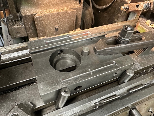

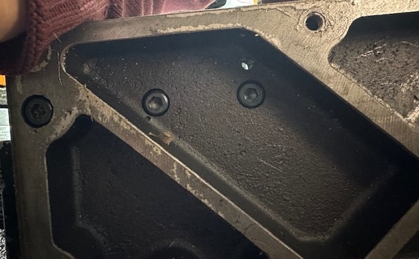

4 Attachment(s)
Re: Boxford 260 VMC rebuild

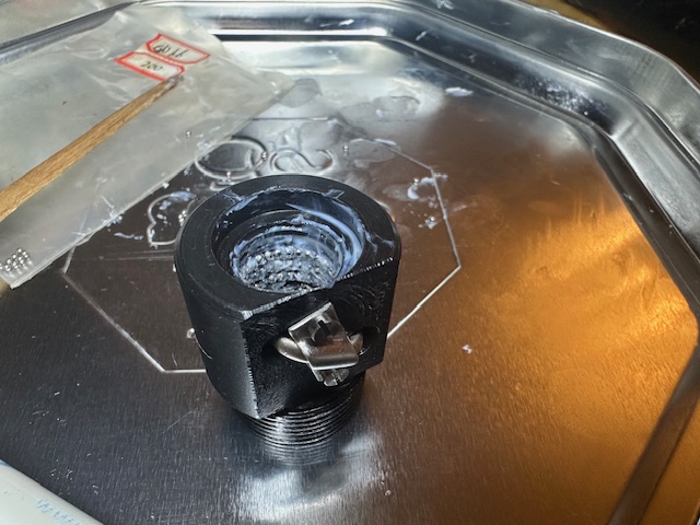

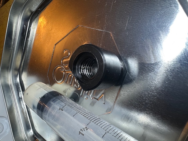

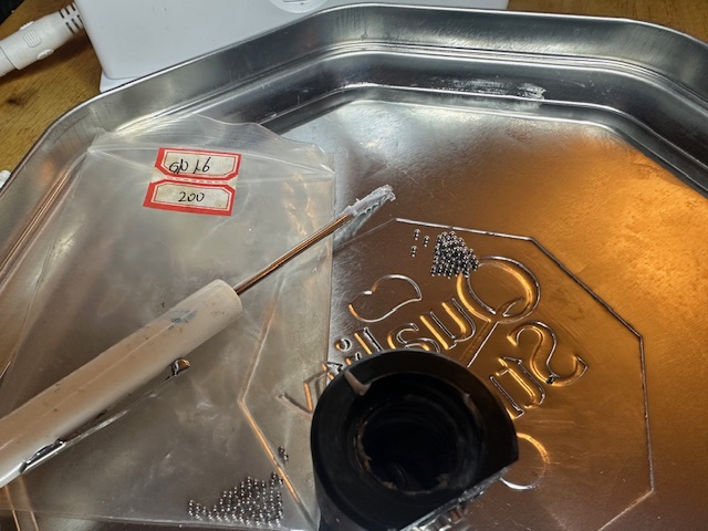

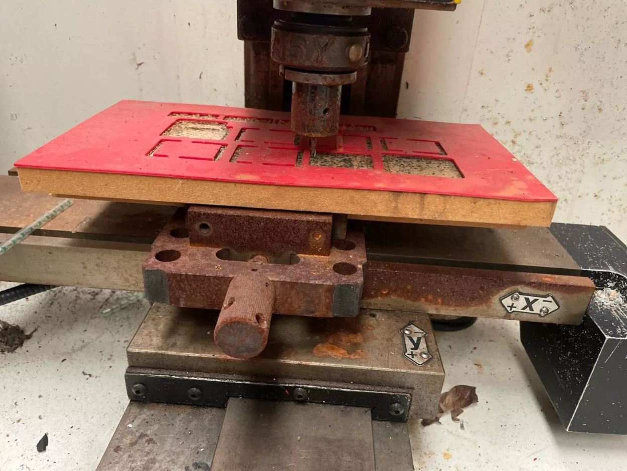

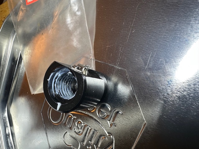

Well, the spindle was a right faff, but the ball screws? No surprise there. These VMC 260s have a bit of a reputation for knackered ball screws. They’re 14mm with a 2.5mm pitch, and to top it off, they’re overhung with no end support. The single nut uses tiny 1.6mm balls, so the load rating’s a bit on the skimpy side. Finding replacements? Good luck. The nut’s a screw-mounted type, not a flange-mounted one, which are ten a penny.
Once I’d got the machine back together and wired up for a test, I braced myself to see how bad things were. The X-axis was the worst offender at nearly 0.18mm backlash. Y-axis wasn’t far behind at 0.09mm, and Z was the least awful at 0.05mm. I did track down a Chinese supplier offering rolled screws for £90-100 each, plus shipping. But knowing my luck, the replacements would probably be dodgier than the originals. So, I thought, why not have a crack at re-balling the ones I’ve got?
I started with the X-axis screw, dismantled it, measured the balls, and ordered replacements. When they arrived, the real fun kicked off. Those 1.6mm balls are so small they vanish the moment you drop one—like they’ve got a personal vendetta against you. For the first go, I meticulously counted out the exact number of balls from the old screw, then counted out the same number of new ones. Sounds simple? It’s not. After thoroughly cleaning the nut, I packed the grooves with ball screw grease and, with the patience of a saint, placed each ball into the grease. This took forever. Once all the balls were in, I slipped in a turned nylon filler rod to hold them in place temporarily. Fitting the screw back was a doddle… after a few practice runs, mind you. The result? Backlash down to less than 0.01mm—good as new, if not better.
The Y and Z axes were a breeze by comparison. I ditched the ball-counting nonsense. Instead, I slapped as many balls as I could into the grease, popped in the filler rod, held it just past the return path tube, and kept feeding in balls until the track was full. Worked like a charm first time and took about 20 minutes per screw. Piece of cake, really. Anyone else tackled ball screw woes on one of these? Or am I the only one daft enough to try?
Attachment 32637
Attachment 32640
Attachment 32638
Attachment 32639

Not had to do one of these but over the years I've rebuilt quite a few ball nuts for people on here, on some of the more expensive assemblies the balls themselves can be of different sizes, this is to do with preload etc
Not done any spindle grinding personally but have seen it done this way on the tube, think it was an Abom video...
Pleased you kept the enclosure and went for a restore, would have been a shame to lose it I think, look forward to seeing her alive again, good luck and keep going :beer:
I've done a couple of 16mm ballscrews. Once you've figured out the technique, it's not too bad. I used a very similar technique to what you described.
In my case I was simply reloading the original balls to new ballscrews (don't ask, you can guess) but for older ballscrews apparently you may need to use bigger balls to compensate for wear. But rather like worn machine ways (gibs) or (split) leadscrew nuts, the wear will be greatest where it's been used most, so I don't imagine achieving zero backlash in the middle of travel will be good for movement elsewhere. Sounds as if you were fortunate to be able to replace the balls with new.

Yes you are correct about wear and oversized balls, I think the thing is with tiny ball screws the balls seem to wear first as I guess the load is less evenly spread on the balls, so was worth a try and it worked out in this case :)

OK will retry posting some of the images as they seem to not show in my previous post.
Attachment 32643
Attachment 32648
Attachment 32649
Attachment 32650
Attachment 32654
Attachment 32651

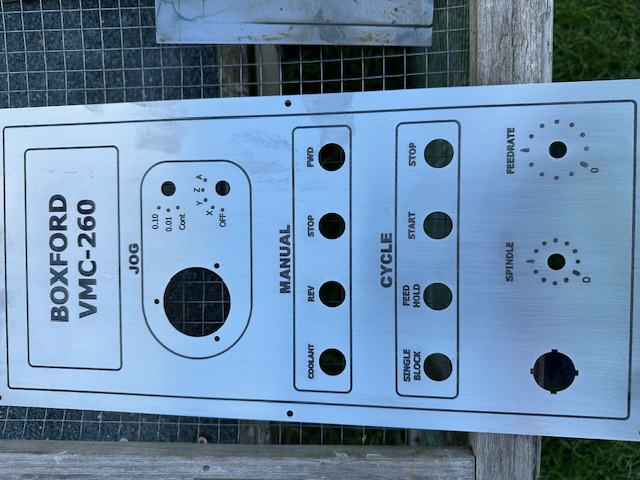

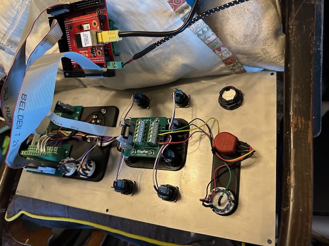

6 Attachment(s)

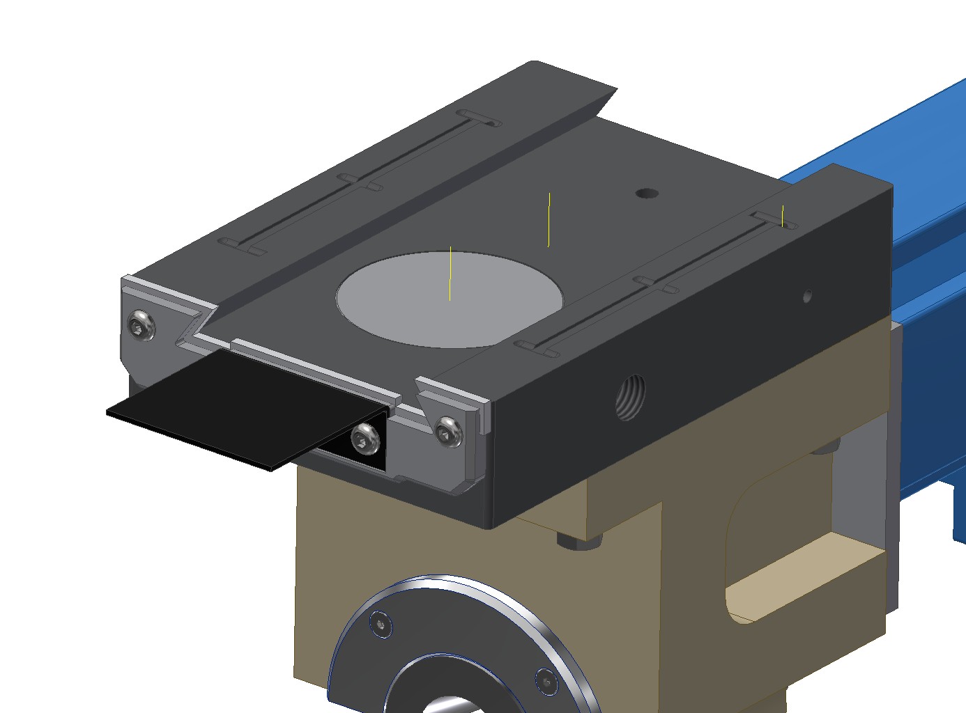

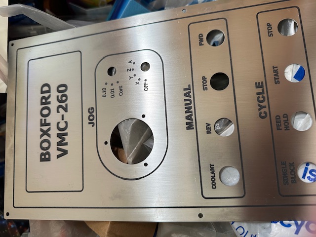

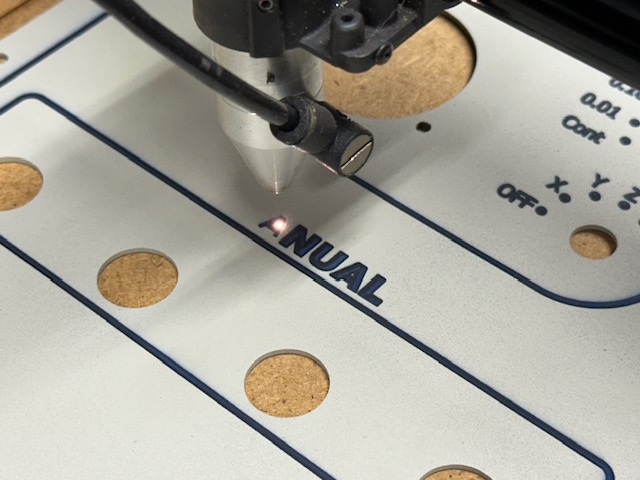

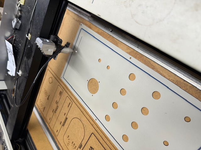

With the rogue ball screws sorted and the wonky tooling tamed, I turned my attention to the control panel. The old one was a sorry sight—rusty and bearing scars from what looked like a minor electrical tantrum. Several components on the back had, shall we say, “vigorously disassembled” themselves at some point. The new panel needed to be a proper job: an MPG dial, feedrate and spindle override controls, plus manual switches for spindle and coolant.
After measuring the old panel and unceremoniously binning it, I fired up the CAD software and faffed about until I had a layout that didn’t offend my sensibilities. I sent the design off to have the panel laser-cut from 1.2mm 304 stainless steel. When it arrived, I dug out my home-brew 40W CO2 laser to engrave the markings. To get a proper finish, I used Ceramark laser marking spray—spray it on, let the laser work its magic, and it fuses into the surface, leaving a crisp, permanent black engraving. Not bad for a bit of shed tinkering, if I do say so myself. Anyone else had to resurrect a control panel from the grave? Or is it just me battling these relics?
Attachment 32655
Attachment 32656
Attachment 32657
Attachment 32658
Attachment 32659
Attachment 32660

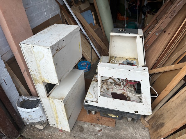

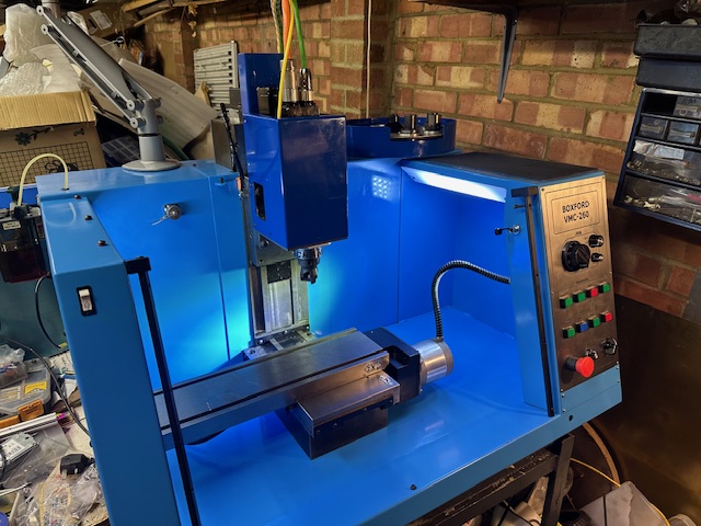

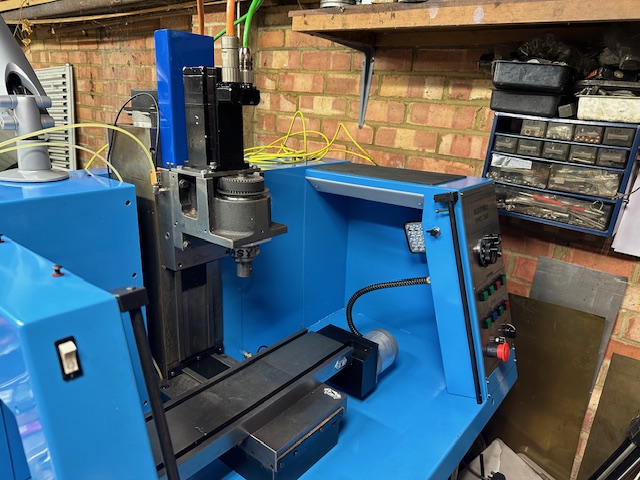

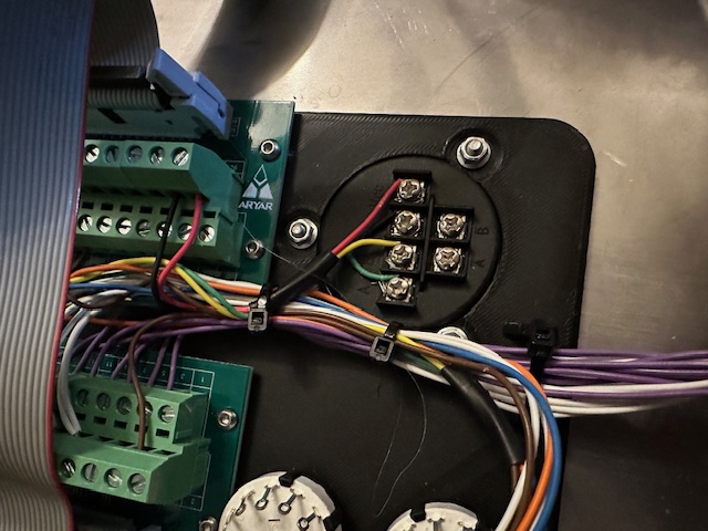

5 Attachment(s)

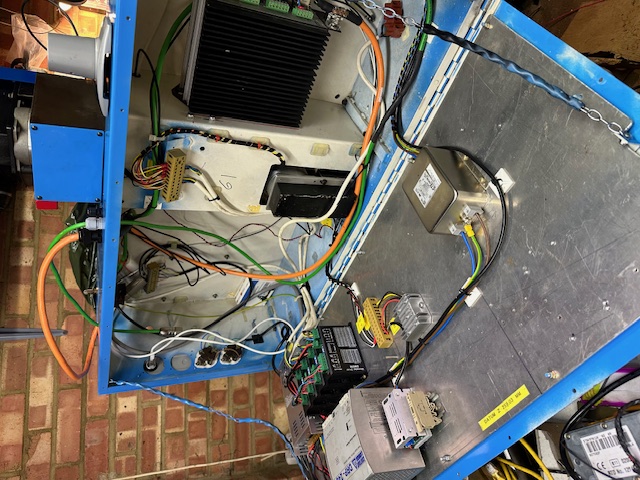

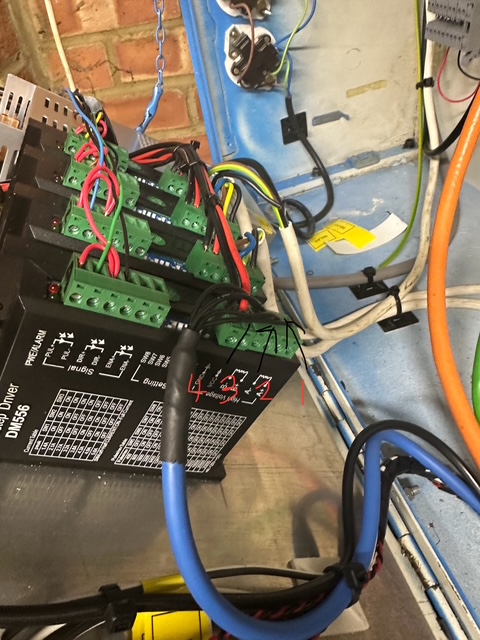

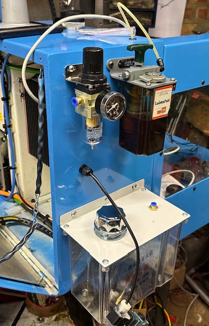

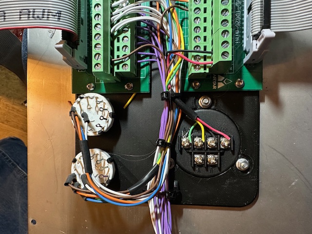

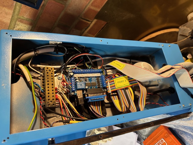

Well, folks, It's there—just a few odds and sods left to sort: reassembly, wiring, setup, cobbling together a 4th axis, and the small matter of squeezing this beast into my gloriously cluttered workshop. Wish me luck!

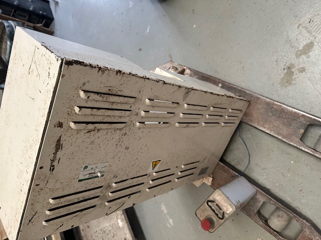

For the controller and electronics, I stuck with tried and tested stuff I have used before. I plumped for the ever-reliable CNC Drive UC300ETH motion controller—used the USB version before and loved it. It’s got bags of inputs and outputs, plus those handy dual analogue inputs for SRO and FRO. For stepper drives, I went with ANGEEK DM556s. At a wallet-busting £8.99 each (including next-day delivery, no less!), they’re an absolute steal. I’ve used these drives before, and they’ve never let me down, so why splash out on pricier kit?
The spindle drive was a bit of a saga. I had a nice Parker Compax3 with an AC servo motor just waiting to be used. I was aiming for spindle reversal and maybe rigid tapping down the line. Sounds simple, right? Not quite. The drive only plays nice with a limited set of inputs: ±10V, open-ended 24V step and direction, or 5V differential. I faffed about for ages trying to get the first two methods to work, but clean input signals were as elusive as a sunny bank holiday. In desperation, I tried driving the 5V differential inputs with 5v open-ended drive signals, despite the manufacturer insisting it was impossible. Lo and behold, it worked! Take that, naysayers. To bridge the gap between the UC300ETH and the drive, I used a couple of dirt-cheap 5-axis breakout boards off eBay.
My one cock-up? Mounting all the control and breakout components behind the control panel. Seemed like a great idea at the time, but it’s now tighter than a sardine tin back there. Lesson learned. On the plus side, I’ve kept the high-voltage, noisy stuff tucked away in the rear of the cabinet, with the spindle drive well clear of the stepper drives to avoid any electrical tantrums.
I just have to get all the heavy bits into the cabinet without serious injury!
A few pictures of the work below.
Attachment 32661
Attachment 32662
Attachment 32663
Attachment 32664
Attachment 32665

Looking really good Mike, I'm going to take a punt and say you've done similar work before :thumsup:
That looks a great build, Did you spray the Cabinet with a HVLP gun or cans ?.Im just prepping a Lathe I brought a while ago and about to start painting I have been torn with spraying for a nice job or brush for a thicker and quicker job.
Lee Roberts
Thanks Lee, I have had a bit of experience but never had to do so much to a machine. The last was a Boxford 240 CNC lathe but it was in pretty good condition so just needed all the electrics and spindle drive etc.
grain_r
I used Rust-oleum hard hat top coat, it is fantastic paint. I was originally going to get the cabinet shot blasted and powered coated, but quotes seemed a bit crazy so rattle cans it was. The problem with Boxfords is that the original paint is rubbish so moisture gets underneath and you really need to strip it all off or not bother.

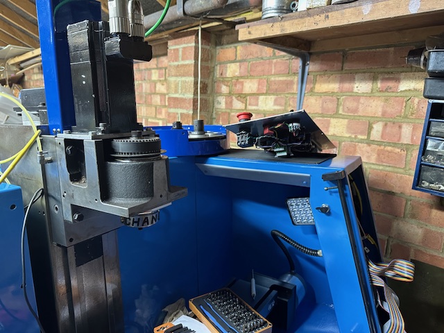

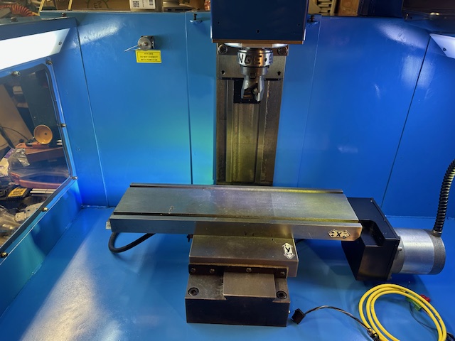

10 Attachment(s)

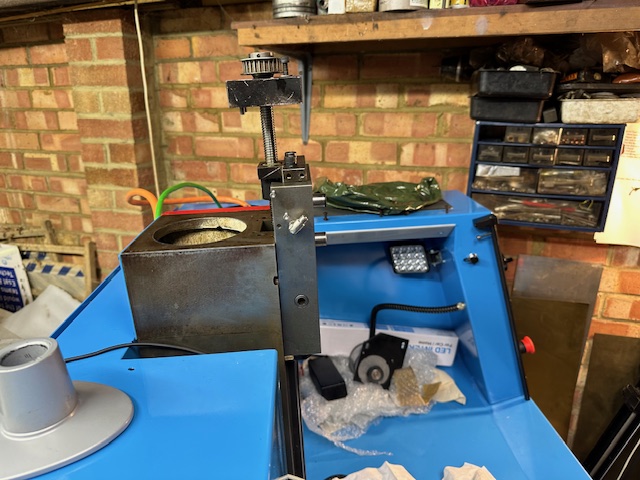

Due to the cramped nature of my workshop, I decided to assemble the machine in situ. After manhandling the lighter VMC 190 out the door, I brought in the main cabinet body and rear section and got them assembled. Next, I installed the rear electrical panel, servo drive, and most of the wiring, along with the connector for the 4th axis. At this stage, the machine was still light enough to rotate on its stand, making it easy to work on from the front or back.
Once I had the stepper motors moving and the spindle motor running, it was time to fit the heavy bits. The Y-axis base bolts to the column with a bunch of M6 cap screws. Interestingly, when I disassembled the machine, about half of these weren’t even hand-tight! I made sure to tighten them properly this time and used thread lock to ensure they’d never come loose again.
Unfortunately, the resulting assembly was way too heavy for me to lift into place without risking scratches to the paint. What I did next probably shouldn’t be tried at home. I built a bridge using an 8mm-thick high-tensile aluminium plate from the bench to the machine cabinet—100% totally safe, of course! The column assembly was then carefully slid across this makeshift bridge and into place within the cabinet. It was pretty much open road from here, with the column assembly bolted into place and sealed with clear silicone, the other parts could be added and tested. Pictures hopefully below:
Attachment 32676
Attachment 32677
Attachment 32678
Attachment 32679
Attachment 32670
Attachment 32671
Attachment 32672
Attachment 32673
Attachment 32675

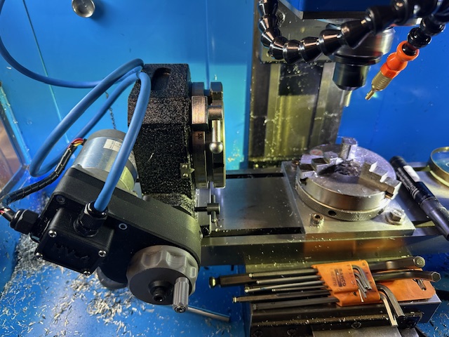

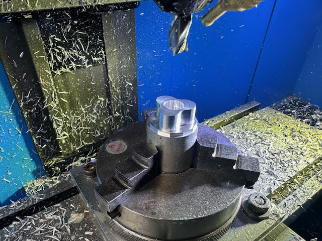

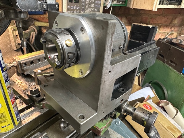

Thank you for your kind comments, I did do a bit more while I was distracted from my main project (Fairbanks Morse 15hp Model N ) https://www.smokstak.com/forum/threa...-model.228112/

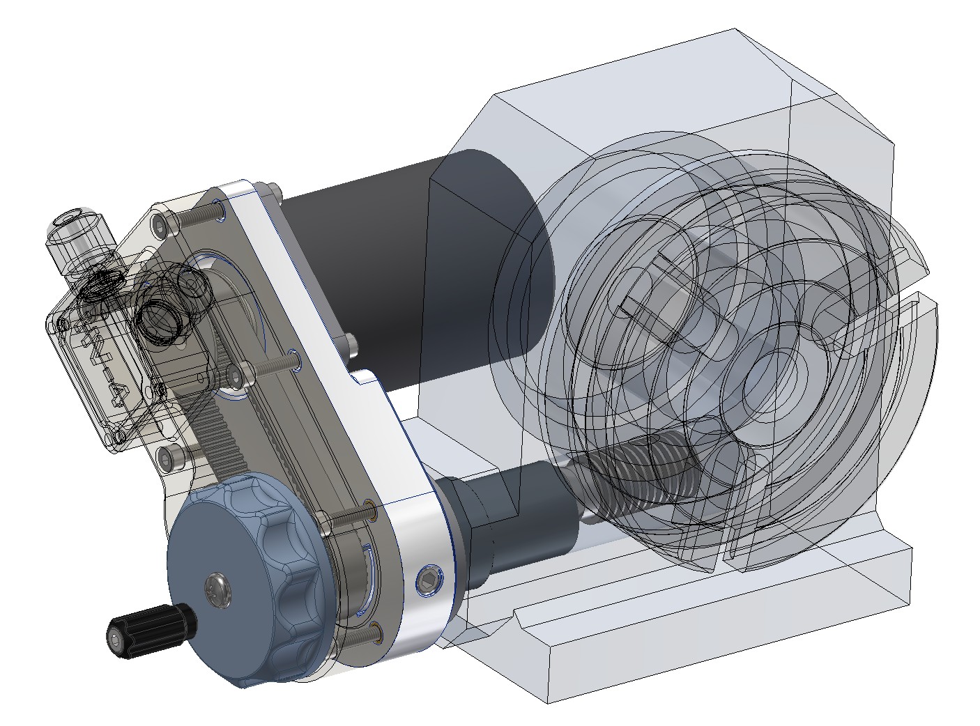

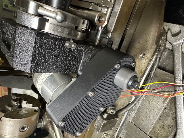

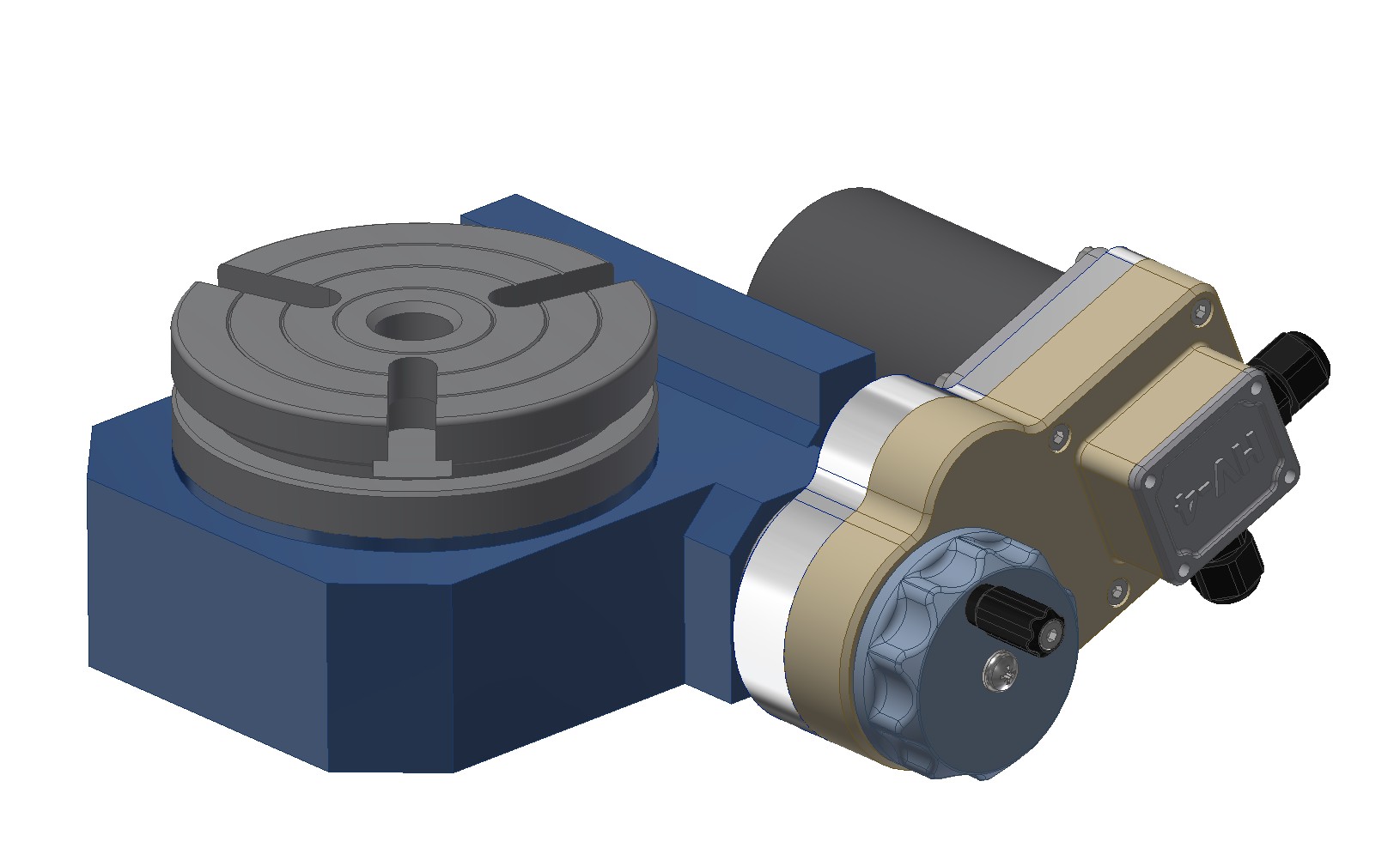

One last thing on my list was converting an RDG Tools HV4 rotary table to a 4th axis. I recycled the stepper motor that originally drove the tool carousel to power the 4th axis. I had already installed a socket and stepper drive for this purpose. A word of warning: if you’re considering buying an RDG Tools HV4 or similar £100 rotary table, DON’T—they’re rubbish! I wasn’t expecting much, but it was about 50% worse than I anticipated. Apparently, Vertex Taiwanese HV4 tables are far superior to the poor-quality Chinese ones sold by RDG Tools. The main issues with the HV4 I used were significant. The 3 Morse taper bore was a good fit on a Morse taper sleeve but was nearly 0.5mm out of true—yes, half a millimetre! Additionally, every single part had burrs and work-holding damage from chuck jaws, etc. I couldn’t be bothered to send it back, and honestly, I enjoy tackling a basket case! So, I re-machined nearly everything the manufacturer had messed up, spent time deburring, and ensured the worm gear was mounted accurately. With some care and running in, I managed to get it running mostly true with minimal backlash. I designed a 3D-printed belt housing and motor mount. The main motor mount was commercially 3D-printed in nylon, while I printed the other parts in ABS. Unfortunately, I didn’t take many pictures during the build, but here are a few of the finished unit.
Attachment 32683
Attachment 32684
Attachment 32681
Attachment 32682
https://youtu.be/9nvm8AGoWtM?si=ZMLrr24wV4OiMYdX
So that pretty much completes the rebuild, hopefully the machine will have a new lease of life and has been saved from the scrap man for now. I am at present trying really hard not to make a BT30 spindle for the machine although the current spindle is OK and works pretty well as it is, I think a BT30 spindle would more rigid than the Easy change tool holders and the BT30 toolholders are so much cheaper than the Easy change ones. Should I or should I just stick with what I have ??
Attachment 32685
Attachment 32686
