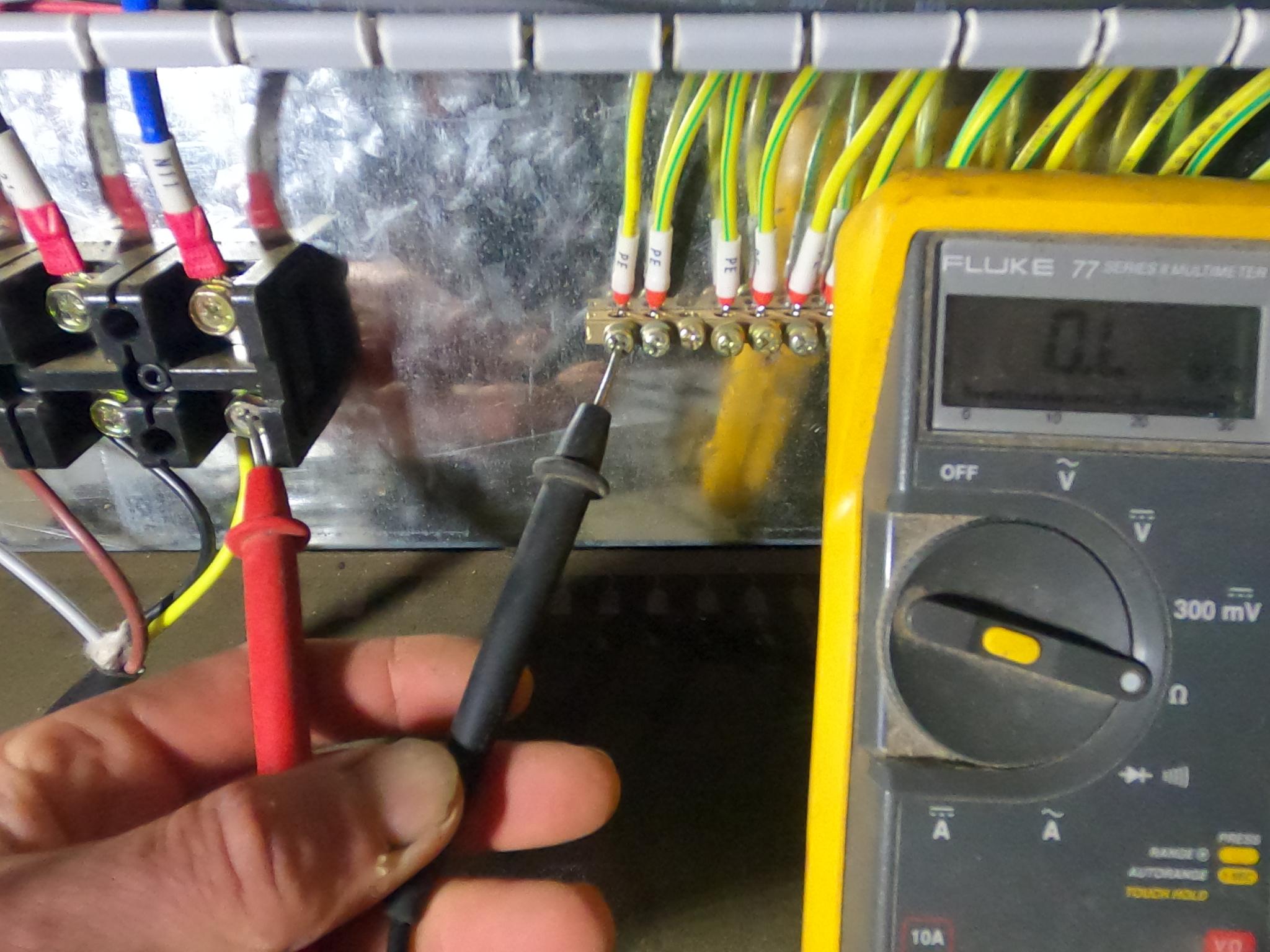

Any earth for protection purposes is what you'd technically call a Protective Earth (or PE for short). This is what the Earth is in your typical mains supply.
All the drives in your machine should have a PE, which is connected to Earth.
Floating neutral is a bit different. In the case of 3 phase, if you don't connect to a supply Neutral, the only way you'd have a floating neutral, is if you had something connected in Star (also referred to as Wye, but that's more a US convention).
Even on a machine that was fully isolated with/without a floating neutral, the structure would still be connected as a PE.
Now having realised exactly what drives you have, none of them are 3 phase, they all appear to be single phase 230VAC.
In the absence of any transformer, this would suggest that your machine should have a 3ph+Neutral supply (or possibly even just be single phase), and I'm also going to guess that none of your 3phase supplies have an RCD fitted, as the amount of current flowing through the earth is going to be well above RCD tripping current levels.
I'd suggest you trace the mains wiring to each drive, and figure out exactly how they're connected for power.

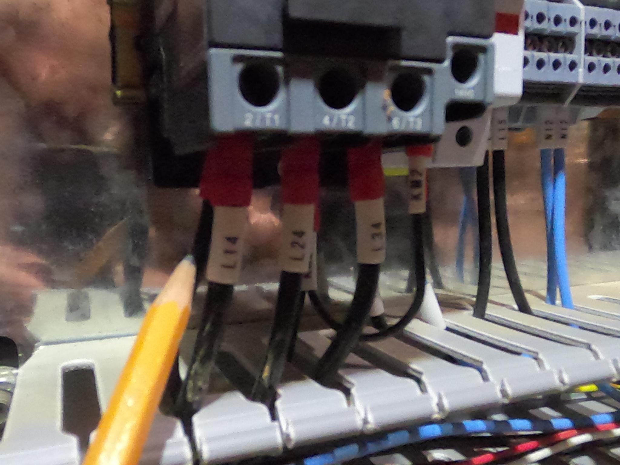

Below is a photo showing 0 continuity between the earths and actual earth. The RCDs are not connected to the machine's earths, would explain why it's not tripping:Attachment 32609
You are correct with the drivers, they're single phase. I've traced back there supply and it's directly from a phase, through a 20A fuse and EMI filter. This phase also supplies the cabinet fans and a transformer for the 24v motion control board. The neutral from the drives is connected to the supply earth (though the emi and fuse also). Pencil pointing at the single phase suppy.
Attachment 32610

Just a wonder here..... what if I connected this floating earth malarky through a seperate wire to an earth spike, providing a proper earth while avoiding interference (which is why I believe it has been designed like this.) There is an earth ring terminal on the side of the cabinet with no wire coming from it. Could this have been meant for a spike? Hmmmm

That N11 tag on the wiring, I'd guess that should be Neutral.
What do the other tags on the input power wires say?

The supplies to the drivers all share the same nunbers, all off the same source. I don't fancy the previous owner to have been converting things from a 5 pin plug to 4, losing the neutral. With all respect to him, that's pretty advanced stuff that I just can't see happening.
I've noticed something really intersting this morning, the earth terminal with no wire is stickered with the earth symbol on the outside of the casing. More importantly, it's the heaviest gauge wire connection to the terminal strip of all the other PE's. It's screaming at me to earth it. I'd get you a photo, but my camera has grown legs atm cough (wife).
I'm in the process of acquiring an earth spike.

If the drive Neutral (or L1/L2) terminals are connected to the N11 terminal, then it is a neutral connector.
My guess is that whoever has wired it up previously, has bodged the wiring with 4 core, and just not connected the earth to the mains earth.
