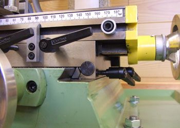

The question is how the table attaches to the Y-axis. On my bigger one the table is machined with integral dovetails that run on ways machined in the Y-saddle, similar to this one of an X2 If so its hard to see how they could get misaligned. All the pictures I can find of the mini-mill (X2 clone) seem to suggest its much the same unless the saddle is in two parts? Are the gibs tightened up? A loose gib could allow the table to twist on the saddle, or the saddle to twist on the y-ways.
Attachment 1678

The X/Y saddle has dovetails machined presumably!! at 90 degrees same as the X2.
I am trying very hard to see how the X and Y can be out of square, it's also very difficult to do an actual
measurement of the complementary dovetails on the saddle to check their squareness.
The gibs were nice and tight and threadlocked and the steppers had an easy life moving the table (3Nm) . Table also had
no more than 0.08mm play with the X extended to far right/left.

I just removed the saddle and examined the LHS dovetails and indeed the machining was not good. At the top of the dovetail was a small (0.1mm) of unmachined
ramp shaped metal 2/3 thirds the length of the channel. I scraped most of it away with a thin file and finished with off with 600 grit.
If I keep up this scraping process I will of course do two things - ruin the dovetail or get no near perfection!!!
I will reassemble the lot tomorrow and retry the previous laborious calibration setup again.

I had the saddle machined by a local company. They first measured the dovetails for parallelism and the results was not good. The fixed end was out by 0.43mm and the gib side was out by 1.05mm.
Both end were machined with a 30 degree dovetail and the results are truely wonderful.
On the machine I now get 0.03mm worst case after lapping the gib on the y axis and making slots for the set screws. In addition I replaced all the 0.125mm balls in the ballscrews with 0.1268mm and this has achieved 0.08 backlash.
