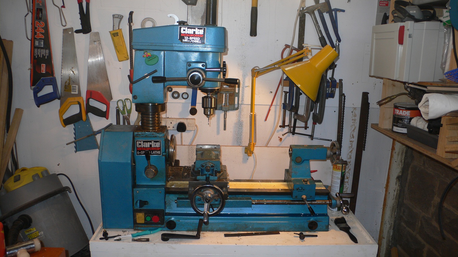

Some pictures from my conversion of a cheap and nasty Clarke Mill / Lathe.
I've called it the sows ear because I don't think any amount of effort will turn it into a silk purse. It's also a bootstrap project - I've had to keep it working during the process since it's the only metalworking machinery I've got. The Z axis is the best example of this.
It's very much an experiment / work in progress as you will see.
Starting point...

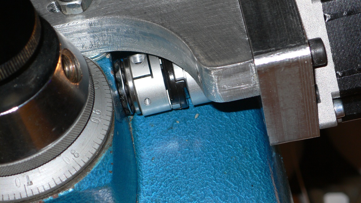

X axis - doesn't look too bad but the coupler is pretty rubbish so it'll need remaking.

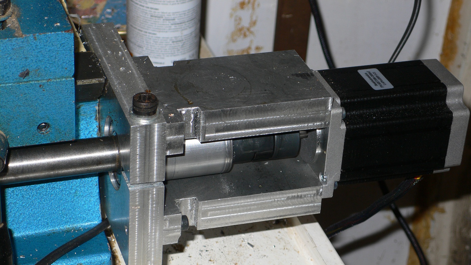

The Y axis works quite well apart from the tendency of the axis to bind if anything other than the vice is bolted to the milling table.

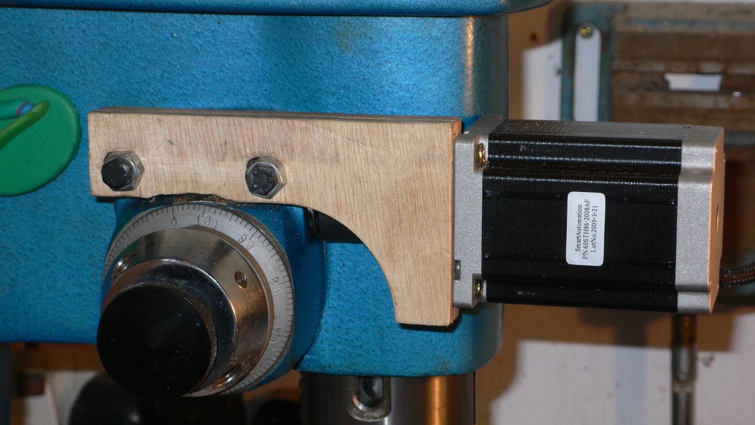

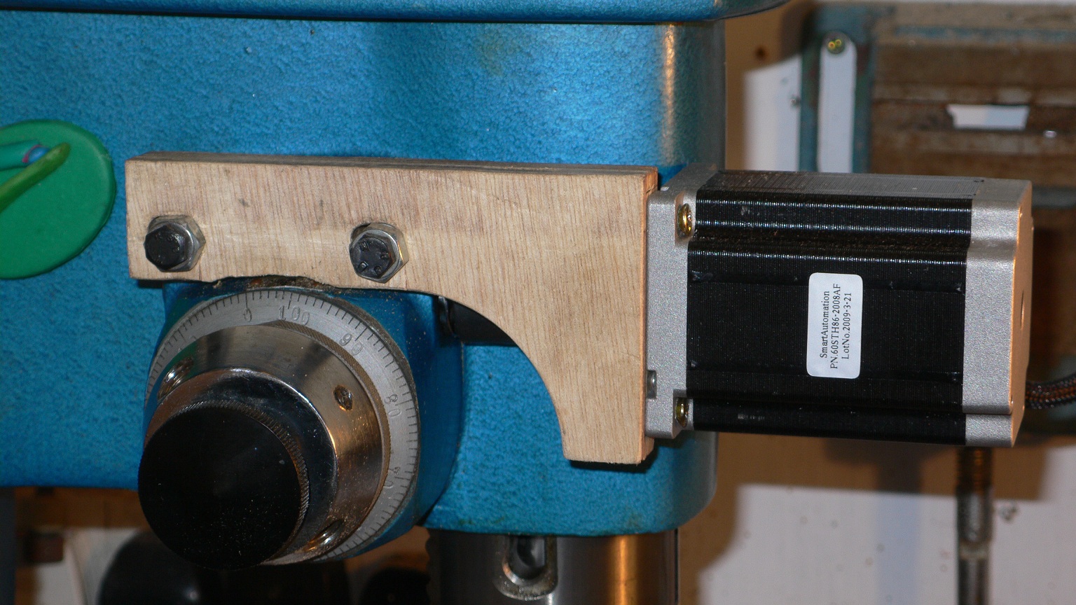

The Z axis will make you wince but it's accurate enough to make the proper brackets which would take ages by hand.
Attachment 1688
It's actually working a lot better than I thought it would. Backlash is approx .016mm on the X and Y axes and about 1 mm on the Z (and it wobbles) but that should be sorted soon. The worm gear from the existing fine feed will never provide great accuracy though so I may need to go to an external leadscrew.

Looking good, next i would look at making a new mount for the last pic/motor. Maybe somthing that fits better to the shape of the machine, like the part you have made in wood but turned the other way with a flat to mount the motor to ?

Nothing wrong with a bit of turd polishing :naughty:
Just a thought but you might be able to improve it a lot by changing one spring. A temporary fix perhaps so you can use it to remake the parts properly.
Usually the quill return acts on the pinion rather than on the quill.
If you put a plate on the bottom of the quill then replaced the quill return spring with a snogging great extension spring pulling up, well off centre on the plate that would have two effects...
1: The gear train would be in tension and more able to resist the tool pulling it down.
2: it would apply a twist to the quill and reduce the wobble.
If you have a sloppy quill, thick grease is your friend.
Happy polishing :smile:

I should have made myself clearer - the quill is fine (good even which is a surprise) it's the bracket that wobbles (very visibly when plunging). I've already used it to make another one in aluminium which I hope to fit tonight. There is a return spring on the quill which, as you say, could be stronger - I think machining grabby materials could be a problem but there is a lock on the quill I can use if necessary and the idea of a supplementary spring is a good one.
I should have done this years ago, it's converted a machine that was border line useful and a pain to work with into one that has many uses, is fairly accurate and is a joy to use. Turning accurate diameters was always a pain with it but now I can make a test cut, touch off to the measured diameter and press go and the jobs done - within 0.04mm first time.
Total cost for the conversion so far is about £400 - bargain :-)
Mark

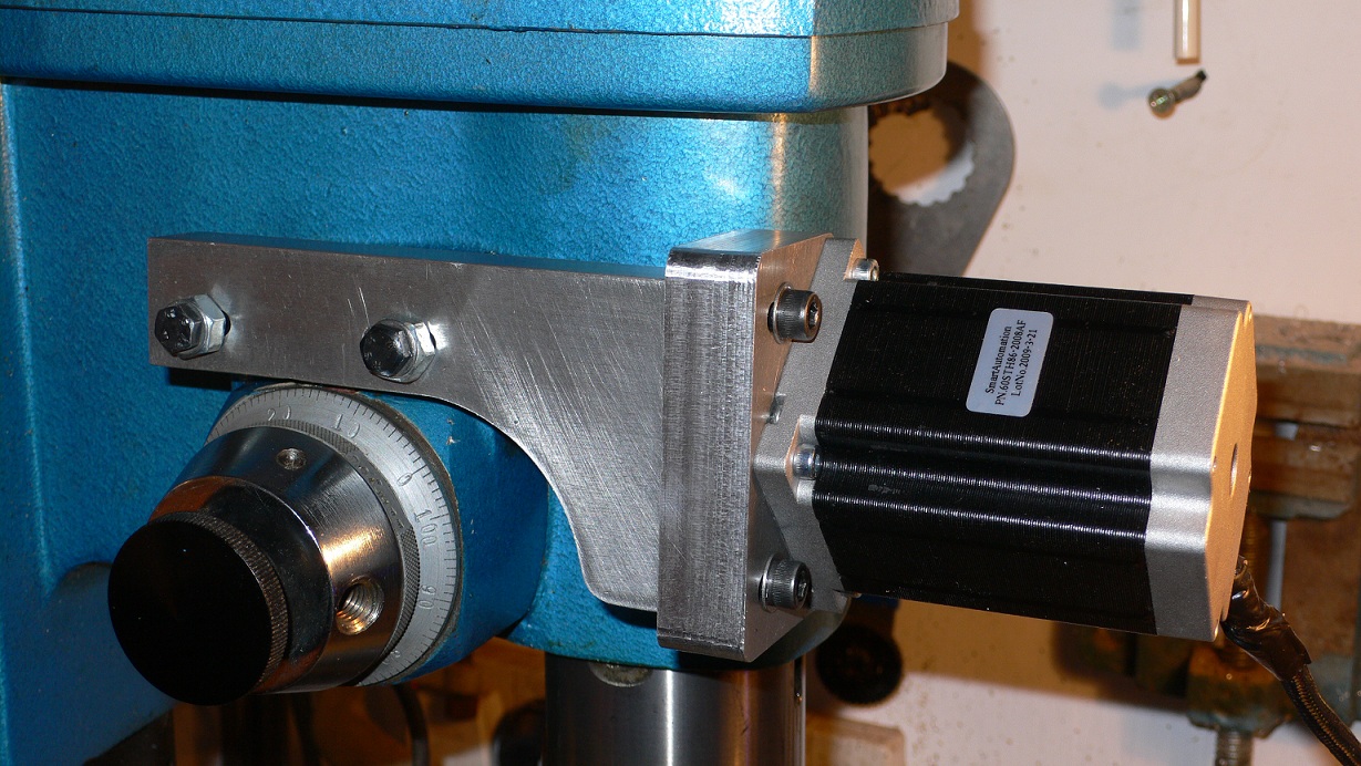

Well the Z axis bracket has made a big improvement.
Attachment 1698
Though the exposed thrust bearing with one race missing is still a bit grim :-) Must get a needle roller equivalent.

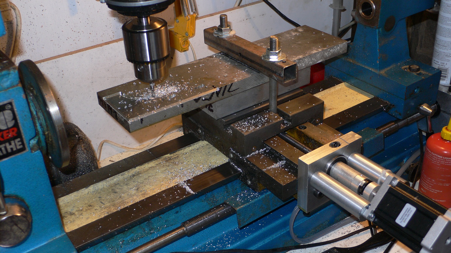

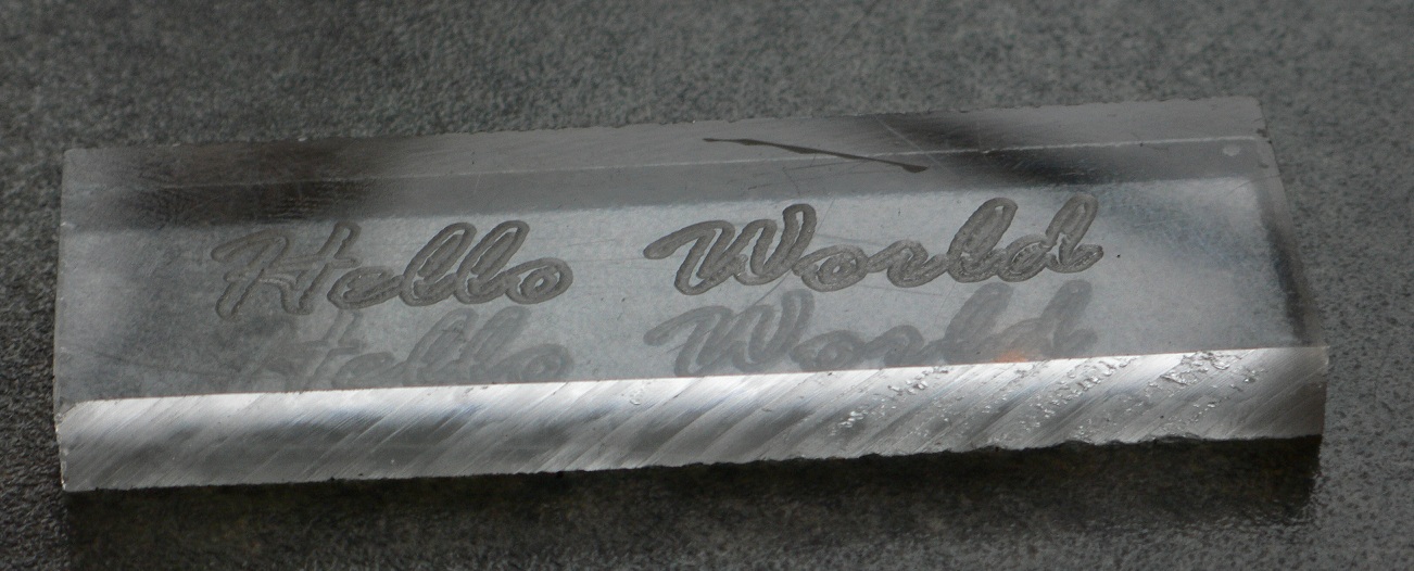

Running an 8mm spotting drill at far too slow a speed got me this
Attachment 1699
Need to look into smaller bits and a Dremel adaptor for this sort of work but I'm quite impressed so far - the EMC2 anti backlash algorithm was very evidently working during the making of this.

Well, I've decided to really put a shine on this turd so it's getting ball screws on the X and Y axes (the Z axis is probably beyond redemption so the plan is to use this to build a gantry mill and then just use it as a lathe).
The current Y axis leadscrew is in such a bad state it's missing steps even at very slow feed rates so I'm making some rough brackets for the Y axis and then I'll make some better ones when it's going.
During testing last night I was bitten by the ballscrew demon - ran the nut off the end of the screw and ball bearings dropped out of the end! I tried poking them back in but there are three separate loops on the ones I have so I had to stick them in place with grease and then gently insert the holding tube - much quicker to describe than do!

The X / Y leadscrew bearings have already been replaced - the ball bearing ones will have angular contact bearings. The mounting brackets are very different to standard (the ballnut has to go at the back of the table due to space constraints). I've had the Y axis completely apart several times - the gib strip seems ok. The X axis is next but that is behaving better than the Y so I'll get that sorted first (may have to gear the stepper down as I've gone from 2mm to 5mm pitch).

Yes, I've fitted cheap 16x5 ballscrews to the X and Y axes and it works fine as a CNC lathe.
The y axis ballscrew made a big difference, the original arrangement is poor in many ways, 12mm isn't big enough to take the cutting forces without binding so it was loosing steps. The X axis ballscrew is an improvement but not so much of one.
The ballscrews are the cheap chinese ones from Zapp - they seem pretty good for the money. The seals are rubbish so I've protected the leadscrew on the Y axis and on the X axis I've made seals from kitchen sealant which seem to work ok so far but not many cuts under it's belt yet :-)
