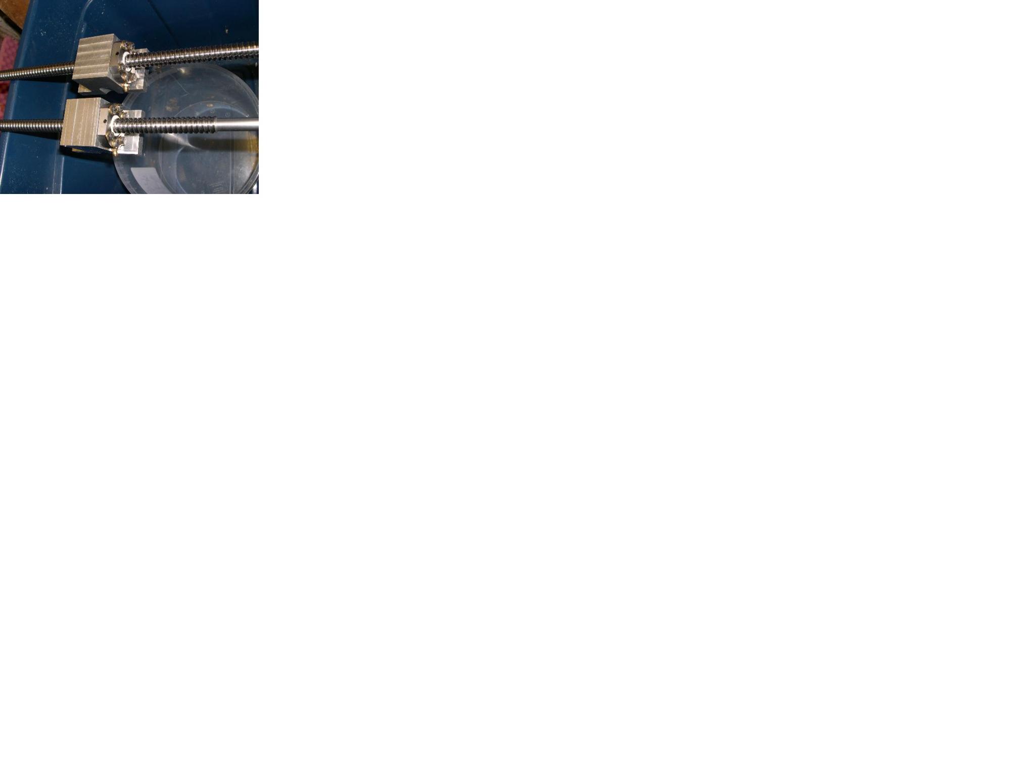

Ballscrews where purchaced from China (sorry to the English Companys) for £92 inc post and end machining. That is 2 x 1605 screws 400 and 600mm long, 2 x ball nuts + machining. They are single nuts and C7 rolled screws.
Direct drive size 34 steppers (4.5 nm) from Arc Euro for X & Y, & A, size 23 (3 nm) for Z & C. (forgot to say, it is going to be 5 axis).
Z screw from an aircraft breaker, (a flap screw I think) anyway it has a 1605 screw and rotating nut.

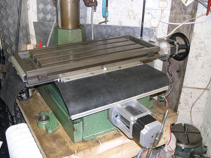

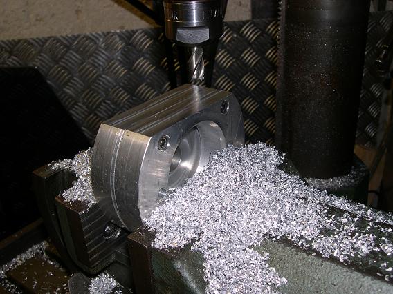

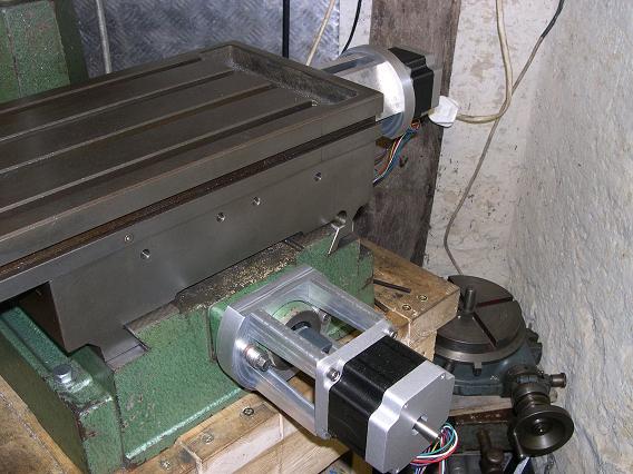

Made blocks for the nuts, used the original bearing blocks and used a pair of angular contact bearings on each ballscrew, with the opposite end floating.
Attachment 1723
The motor mounts
Attachment 1725 Attachment 1724
Motors on
Attachment 1726
Having mounted the motors, I was keen to try it out, so I connected the motors to the driver 36v 11a PSU at min voltage of 32v and hey presto!
Chuffed with my progress, I came indoors and did some more reseach.
I read page after page saying that the driver board I was using was pants! Most blew-up at 30v or more (I had run mine at 35v with no problems {35v is max input for the 5v reg.}).
More research, looked at modding the driver, then decided this was a waste of time and money. So i bit the bullet, phoned ArcEuro and ordered 2 x 9a and 1 x 4.2a drivers (for X, Y & Z). Bought an opto board from ebay, also found some IP67 micro switches for the limits (£25 for 5)
Using the 36v PSU (can go to 80v on the 9a driver) connected up and spent many hours, initially without any movment from the motors, then to one direction only (9a drives have switch for step/dir or CW/CCW orientation wrongly described) and finally working well.(Required 6uS setting in Mach3 for both step and dir.)
Since this is never going to be hyper acurate, I have used 2000s/rev = 400 steps per mm.
It runs at the maximum Mach3 can output in 35Khz mode which is 5250mm/min. so I am happy with that.

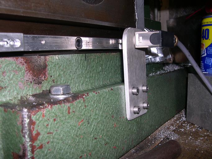

Made sone covers for the ways, and fitted X & Y limit switches (one each).

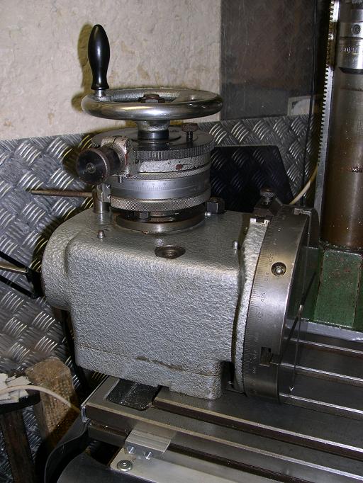

Found another bargain on Ebay, my fourth axis, apparently from a Swiss gear cutting machine.
Attachment 1728
Boy is it heavy, must weigh 40-50 kilos!, bit worried about the balance of the table, but with the trunniun table and end support it should be OK, I hope!?

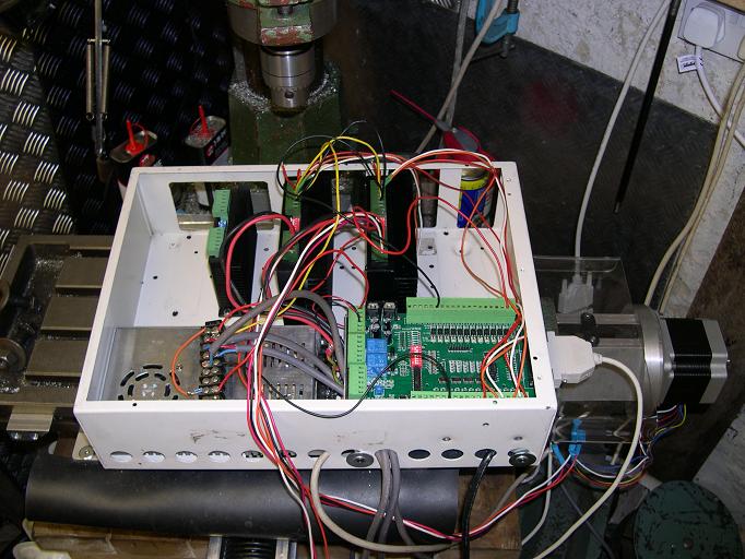

2 Attachment(s)
Re: Buget Warco Major 5 axis conversion
Here is my box for the electonics (ex alarm box from a skip). It is not tidy yet because I am still sorting it out.

and here is the Y axis limit switch.
Attachment 1730

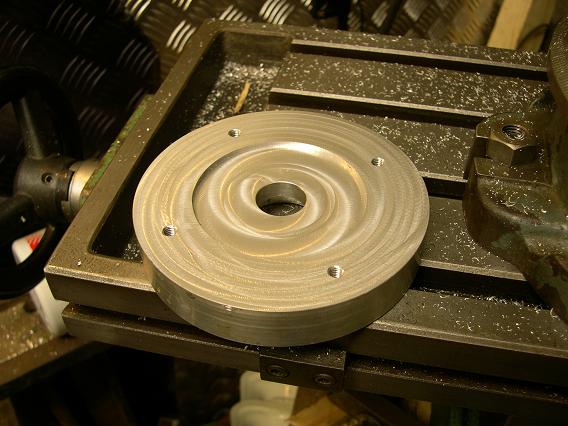

Z is next, have a smaller honking plate than yours, only 25mm thick. It is a disk 150mm dia., with the quill bore offset.
I have seen thinner ones, but when I saw your plate, I suddenly felt inadequate!. Do you think 25mm will flex?

Last question, for the mo' , as you can see my finish on ally is poor, I have not yet aligned the column, but have read much which suggests that finish is related to vibration. I still get some vibration at almost all speeds, feels to me like column flex. Does your do it?, have you filled the column with Epoxy Granite or balanced you pulleys (mine has 2 inters .....pain)?

Last question, for the mo' , as you can see my finish on ally is poor, I have not yet aligned the column, but have read much which suggests that finish is related to vibration. I still get some vibration at alost all speeds, feels to me like column flex. Does your do it?, have you filled the column with Epoxy Granite or balanced you pulleys (mine has 2 inters .....pain)?
What's 2 inters mean?
Obviously you want to avoid vibration but cut quality depends on a lot of variables. I still get a crap finish at times so I have yet to sort it. My biggest problem is aluminium chattering when I change direction into a radius.
If I was asked to list the variables that result in a good finish in descending order of importance, I'd guess...
A machine that is much too big for the job in hand.
Minimise overhangs.
The right tool for the job.
The right lube
The right feed rate and rpm
Cutting downhill
My mill is somewhat different to yours. I have a cast iron box section plinth at the back below the round column, often as not the head is wound down until it rests on the plinth. If I lean on the spindle nose I can bend it about a thou, maybe two if it isn't hard down. Perhaps they changed the design because it was too flexible?

This leaves me with two problems now, my trunion table with a rotary table on top 170mm min., and the column, as the head will be that much higher.
Incidentally, the head clamping is by 3 large nuts (& bolts) which I tighten with a large ring spanner, so much so in fact that the column is free of grease (copperslip)
and won’t fall or crank, until I wind it up!

I do not have an angle plate large enough to mount the Z axis bearing block to bore them, so I am going to use the vertical rotary table (truniun mount to be) and find out how solid it is as a mount.

Ok so now I can get my work-piece accurately positioned, I made the upper and lower bearing blocks, which house the needle roller bearings for the rotating ballnut.
http://www.mycncuk.com/forums/asset....1&d=1269300662
Ah!, having milled the bearing pockets, I checked the bores and was happy (0.01mm undersize), BUT, I measured the bore at the top and when I tried to fit the bearings.... nogo.:cry:
As Robin alluded to previously, the milling cutter shies away from the work, so my bores were both tapered! ..... bugger.
Spent about two hours with a 1" milling cutter in hand, scrapping the bore to make it parallel... what a pain!
I had used a 1/2" cutter, and ran the code 3 times on the final cut!?
I guess a different method is required next time.
The upper block also houses the two thrust roller bearings and this is closed by a plate, which is also the motor mount.
The bearing blocks mount into a 19mm plate which will attach to the front face of the head. They mount “into” the plate so that the ballscrew is as close to the spindle as possible.

The cuts where sooo much better, cleaner, faster and so much quieter.:smile:
And I still have more overhang to remove as I am still using a collet chuck (no metric tools yet for the 3 morse collets).
I was really happy for a few seconds, them I realised that this has severe consequences for my planned 4th & 5th axis, something I guess a lot of you already knew. :redface:
Maybe it will work OK with small cutters running at high speed, I will have to wait to find out.:eek:

Next job is to modify a timing pulley to fit over the 37mm barrel of the ballnut, and then cut the depth stop lug off the front of the machine, and fit the assembly to the machine.
