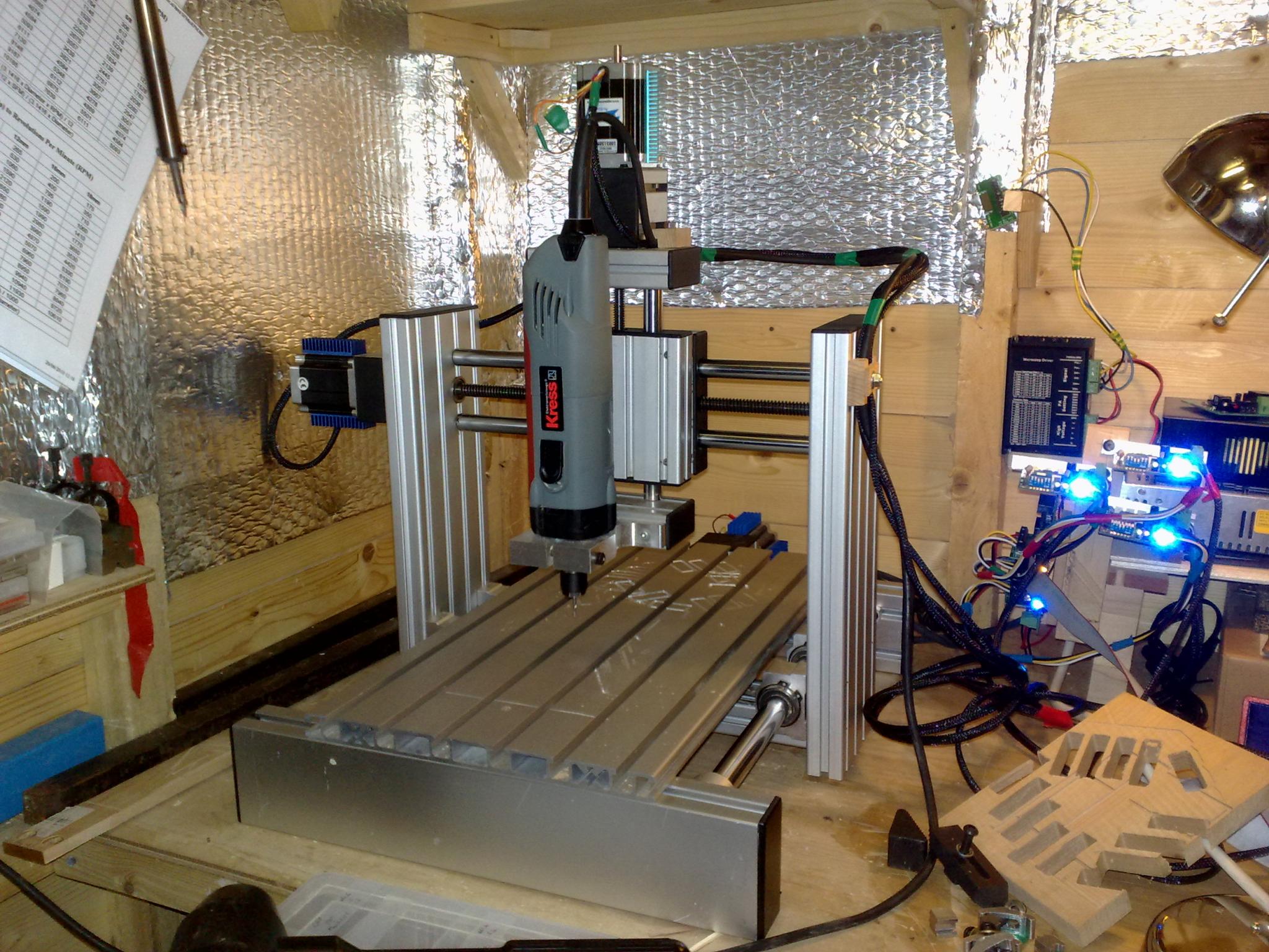

The Router I am running is:
Marchant Dice MDL-2-TR model which has a cutting area (mm) of Y=250, X=220 (gantry), Z=50.
The original set up had the the Z mounted on the side towards the Y motor mount and I found that limited travel even further than the above measure. So I changed the position of the Z which allowed all the weight to be more central as well as the slight increase in cutting area. The only down side is that I had to go into Mach3 and inverse the X axis travel set up. It was not a big problem.
I am currently running Motion King 23HS8603 Nema23 motors that are 1.4Nm. Looking to upgrade to 1.8Nm so that can move a bit faster.
Using a Kress 1050 FME router for the spindle and it cuts fine though looking at the quick change options being offered by a few different folks.
I am using DIYCNC boards which are the PCPPS-3 and the older DVR25 driver boards working wonderful and looking to at ways to slave the spindle to Mach3 (Suggestions and directions welcome on this one).
As stated using Mach3 to control the mess and it works wonderfully. Right now using soft limits and looking at which way i want to mount the limit switches I have to get that bit of added security in the system.
Using Sorotec milling bits and Dremel routing bits. Both are working wonderfully to spec and getting a very good life span out of them.

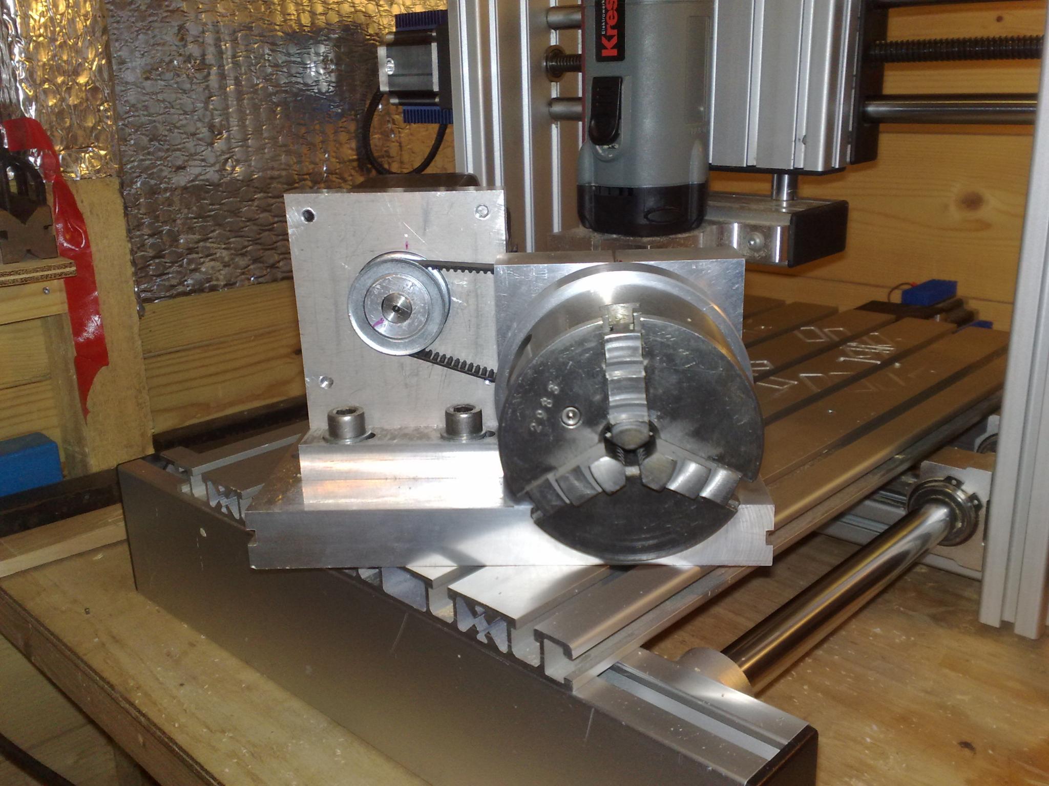

Build is going well and looking at adding a rotary table as a fourth axis. Anyone got experience in converting one from manual to CNC? If so what motor is most likely best to do this with. Looking at either a 4" or 6" diameter table. Any and all input would be seriously appreciated. Also looking at converting to ball-screws for all axis' as well and thinking that 12mm would do my well for that. This is converting one of Marchant Dice's MDL-2-TR to full ball-screw and adding enough Z to allow for a 4th axis to be end mounted (most likely a 4" the more I look with a MT2 arbor mount option).
It will be mostly used 3d milling, though if the hardened bronze and cast iron gears could take it might do a bit of lathe type work from it. Any suggestions would be great.

2 Attachment(s)
Re: Build continues and upgrades plus review.
A bit of an update,
re posting pic's here on the build and giving a bit more info on what I am up to. Also hope to be able to load a video as well. Got the system 4 on line and it is really making a bit of difference with the reduced wire runs and being able to condense things a bit. Have made a few widgets for setting edges on projects for clamping and proving useful. I am going to be milling some of the cable guides and safety switches out of acrylic and that is going well in the design phase (will post the .dxf files when I have them done). So all and all things are moving forward. Bought a 4th axis and will post pics here.
Here is the pic's:Attachment 3773Attachment 3774
I just started writing a reply to this then realised that I'm a bit too late. Nevermind I'll say a little anyway...
I converted a 6" vertex rotary table to use as a 4th axis. It was easy enough to machine a bit of 3" aluminium bar to fit on where the handle/dial used to and hold the stepper. It's very sturdy, however the 90:1 ratio makes it a bit slow to turn. I think the stepper has worn the worm drive prematurely since the backlash has increased a lot from new.
A while ago I started making a faster 4th axis which I've posted about elsewhere in the forum. That's using tapered roller bearings and will be driven by a stepper via a belt, so will be faster and also strong.
In standard form, vertex rotabs have the worm/handle on an eccentric so you can engage/disenage the worm and also adjust backlash...
Yes, the way I converted mine means it still does...however I've tried that and I think the worm gear might be too far gone for that to help.
Take it apart and check it. The worm wheel is just cast iron bolted onto the underside, which i discovered after removing several teeth while machining a bit 1/2" thick steel into a 12" round :-/
Someday, once I've got the mill converted, I'll get it converted into a 4th axis.
