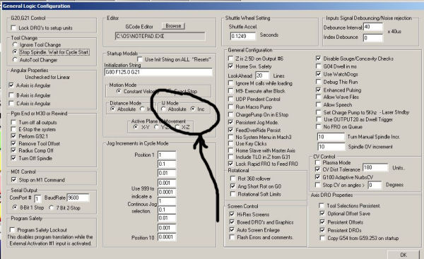

Not even sure i qualify as a newbie, just trying to pop my cherry on my newly built cnc router.. Am running it with Mach 3, but every piece of code I load into it just cuts loads of circles and arcs..
Created some of the code using CamBam, some I got off the net as freebies (a smiley face etc) but Mach 3 just wants to cut circles on all of them..!
Really got me scratching my head on this one.. Have tried to go through all the code but cant spot anything, am beginning to wonder if it is a setting in Mach 3 itself.. Just cant think what..
Any ideas all you CNC gods?

Go to Config > General Config and change the arcs to incremental
Attachment 2143

Hi..

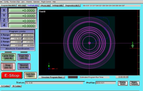

Seems all my cambam nc files have loads of circles overlaying the original designs.. Will have to try another software package to convert to gcode.. Any recommendations for a newbie?
Will go and change my Mach 3 as you suggested John, thanks..

Hi again..
Bit adventurous for first time out I know.. But this is an example of what cambam is giving me.. Run it through a simulator and you will see what I mean..
Steve..

You sure John? Am running the code through a couple of different simulators and getting hundreds of circles above the main design... Doing this on my PC at home, not the one running my cnc..

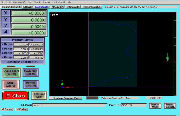

2 Attachment(s)
Re: Getting dizzy cutting circles!
File with Inc arcs.
Attachment 2145
File with Abs arcs.
Attachment 2146

Spot on John!! Works a treat now.. Made my first smiley face!!!!
Many thanks..

As regards the arcs thing, it's got to be the most posted about fault on Mach, it's well documented but who reads the docs ?
It's not actually a fault running arcs in absolute mode and relative mode is a choice, like imperial and inches. Some people / systems use one or the other, it's more a personal choice.
One problem with Mach is when you select a machine you load an XML file up for that machine, defaults are mach3mill.xml , mach3turn.xml , plasma .xml or if you have named one for a machine you may have called it router.xml
When the xml file is loaded it tells Mach all the information about the machine, steps per inch, ports and pins etc so you can run many machines from the same computer. However xml's are not consistent to each computer, they should be but they are not.
A classic example is the pulse width in motor tuning, I could give you a xml with the pulse width saved to 5 but when I pass it to someone else here computer can read that as anything from 0 to 6, it very computer dependant.
The same applies for the inc / abs arcs, they can change on install.
Art, when he had control of the program before he sold it on knew this and put a code in for it, they are G90.1 for absolute arcs and G91.1 for incremental arcs.
If you work in incremental arcs like most people then putting G91.1 in the startup line either by hand or get the post processor to do it will always load the right choice.
