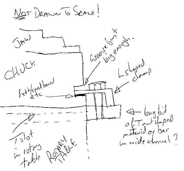

I'd drill through but a smaller size and preserve lathe mount threads (stick some centre marked studs in the thread first and drill through them)? Not sure what size the mounting bolts would be then? If too small for the job...... drill out any way to fit rotary table, then carefully make a back plate with six holes, three to take the new bolts to hold the chuck and three to mount the chuck on the lathe? Or, drill and tap three new mount lathe mount holes in the chuck.
Or, can you get long (1 1/2 inch) bits of t nut profile to fit? Drill and tap the ends. Take the chuck apart and turn a groove 1/8 to 1/4 from the mount end, only needs to be shallow. Make 3 L shaped clamps with a hole in the midle of one side, the other the same length as the groove from the back of the chuck. That end goes in the groove and clamp it down using the t nut overhang?

Tom,
I'm trying to visualise your suggestion and failing badly, can you expand on it...
Re: Mounting a chuck on a Rotary table
Attachment 2337
Art is not my strong point! I hope this comes out! I have looked at the pic of the table at Chronos and this will foul the locking nut preventing full rotation? Another thought. Why not make a round plate that fits the top of the table but bigger diameter, counter sunk short bolts for the t nuts so the front is flush and it doesnt foul that nut (you could turn a recess so it doesnt). Now you will have a table with a surface that is a bigger diameter than the chuck? Make (or buy) another plate like the chrnos mount plate and bolt straight to it?

Attachment 2338
A drawing (of sorts) of the other idea. Make the plates, drill tap etc and put a hole in the middle of each. If your not confident of the accuracy of the plate, make a mandrel, bit of bar faced off, drill and tap centre and bolt (counter sunk) on each plate in turn and very gently face off all 4 surfaces so chuck will be dead parallel to face of table?? Apologies for the crude scribble! I have no idea of your skill on the lathe or your.. if you're like me, incredible scrounging skills and alergic to buying things when you can spend 6 months making one! But just to add, 120 deg holes are very easy. Again, 3 jaw chuck and mandrel you just made with a plate bolted to it through the centre in lathe, get a bit of scrap bar (or a snapped off pencil) that just fits between a flat conveinient surface like the bench and the chuck (lathe) jaw. Turn the lathe off! Hold the jaw down on the scrap so its wedged between jaw and bench and using the crossslide and a sharp turning tool, scribe a line with the lathe tool. Turn the chuck till the next jaw rests on the scrap, hold and scibe again, then do again with the final jaw = 3 x very accurate lines at 120 degress apart. Decide where the bolt centres will be, set the lathe tool to the right diameter (PCD) and rotate the chuck by hand marking the hole centres?

Tom, Thanks for those thoughts. I have a feeling there's not enough clearance between table and locking arm etc. to do that but I'll go measure over the weekend. the pictures were fine, as they say, worth a 1000 words! I've seen works of art such as these decribed as CoC elsewhere on the web... CoC = "Crap O' CAD" :heehee:, works for me!
