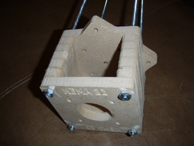

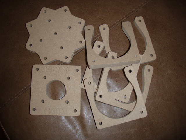

MDF NEMA 23 Motor mounts
For sale on ebay. A new improved design over what my router is currently running. Helpful for new builds (I found the motor mounts on my build very fiddly with few tools to help me).

might just be me but it looks like you loosing steps or calibration need looking at or it could just be the picture
like the design those spacers are a good idea makes adjustmet easy

Firstly, temperature (kinetic energy) does not equal heat (the transfer of energy). A stepper motor generates X watts of energy ( J/s ), the heat gun generates Y watts. X is probably less than 100w (?). Y is probably in excess of 1kw.
Secondly, I look at these mounts as a metal studded rod mount with MDF spacers, the metal rods (in tension?) provide a lot of stability, the MDF (in compression?) doesn't really have any where to expand into.
Third, the shaft coupler should take up any small variation.
Feel free to correct any of this, as if an invitation was required lol.

i think most people know that if they build a machine out of MDF it`s not going to be 100% accurate
Re: MDF NEMA 23 Motor mounts
Correct, which begs the question is all that mdf needed? I would have just used the front and back plates and then spacer tubes on the threaded bar. But as John said, I think analysing MDF to this degree is unnecessary as it will typically be a first build.

I really like the design process. Now you mention it Ross, it probably isn't. I like bolting through a wide face of MDF because it adds plenty of torsional stiffness, but there probably isn't the need for 3 closed sides. If I made the spacers separate (2 on each layer) it'd save some raw material, a tiny bit of cutting time, and some weight. Mk3 on the way... :)

I like the closed sides it gives stiffness, the problem with spacers is that there is no torsional stiffness and it looks like grandads mantlepiece clock.

By the way, the MDF motor mounts are still on sale, and doing well. One happy customer anyway!
I deleted the text because it wasn't functional, and reduced the cost.
