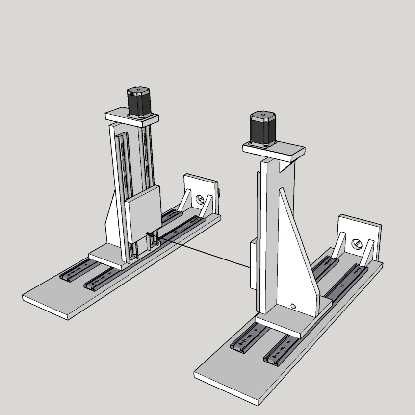

Hi rckeith
Nice little machine. If the author of the plan is on iteration 3 is can't be too bad.
What sort of shapes are you looking to cut - foam core wings, 2D formers etc. ? I guess with any 2D work it's fiddly if you want lightening holes, but maybe with foam/depron you don't need them.
Do the towers move apart to handle bigger jobs?

Re: Hot Foam cutter for RC aircraft
Hi Barry
I'm looking to wings and fuselages. I have a Priory Models Lancaster which is made of white foam and then covered in balsa. On my website as well http://www.rckeith.co.uk/lanc showing the build. I'm sure I can make a fuselage without too much complication. Unfortunately she's in pieces had a speed controller failure but I have new parts to rebuild her.
This video on youtube shows the same foam cutter in action http://www.youtube.com/watch?v=hV79pjFDdRY and as you can see the towers can be moved to any desired width.

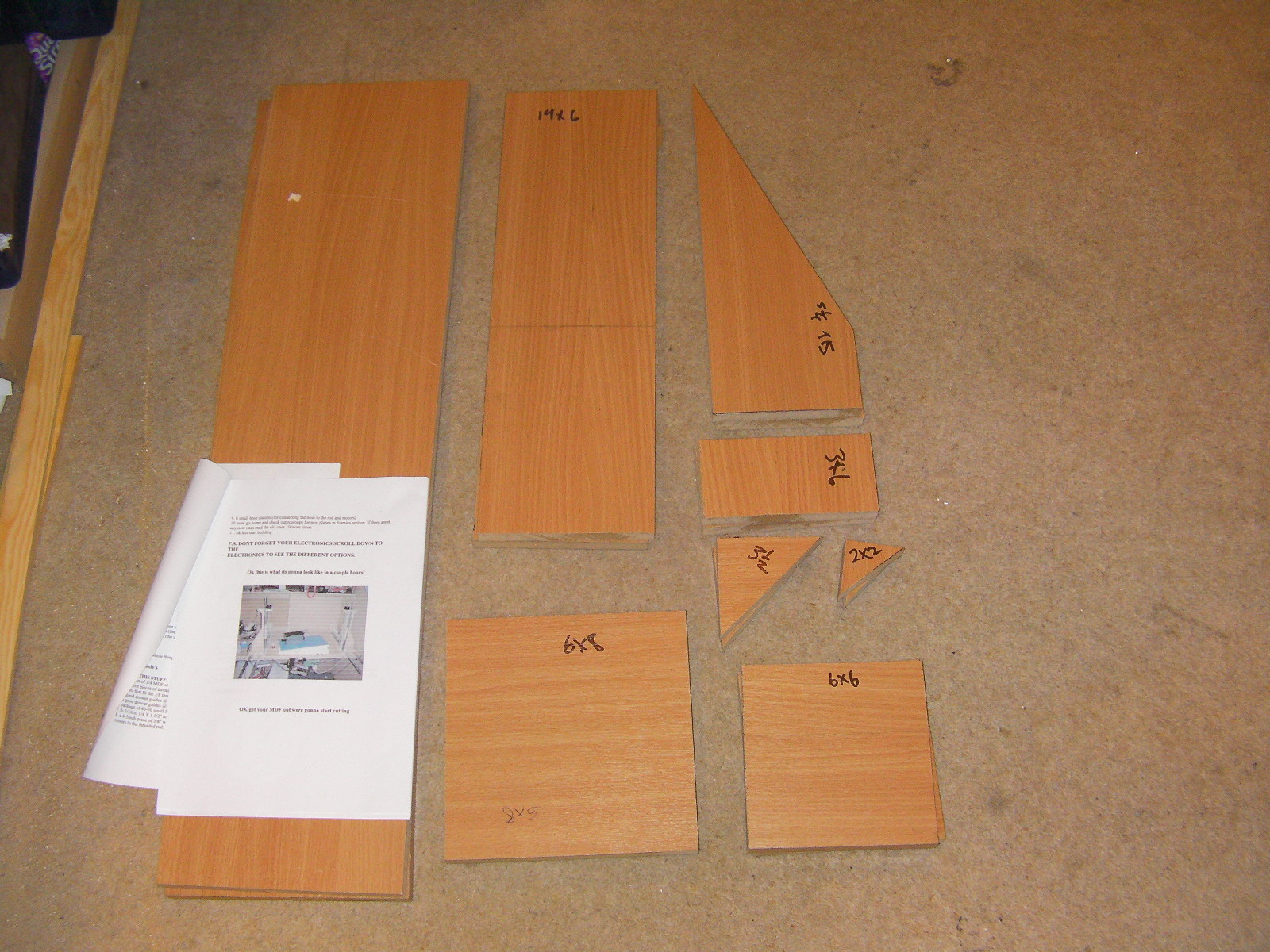

Here is the start of my machine.
The wood is MDF with a veneer. Some desk were being dumped from my work place and it seemed a same to see them burnt so I saved them for a better life as a cnc machine. All parts are cut to size.
Keith

Hi Keith
I have this feelin that the width of this machine can be narrower unless I'm missin somethin that dictates it needs to be wide?
Hi GeorgeD
Yes the width can be adjusted to suit. The only thing between the towers is the hot wire,
Keith
How do Keith.
You do well to put the towers on a sliding base for differing widths apart.
ie use some T channel aluminium rack and rebate the T track in 25mm baseboard and then space the towers when ever you feel the need to widen them?or just have them permanently affixed to a base board because there's no stability in that design ie a gust of wind will blow em over :heehee: and thats not good for the motors//mechanics if you want to avoid damage.
Hi George
The towers will be clamped/screwed down on a base. The tension on the hot wire would certainly pull them over. The main reason I chose this design is that I have quite a small workshop so when not in use I can store them away. Once I've built this one I'd like to do a cnc router but I'll really need to work that one out, with the space I have. Problem I have is that a lot of space is taken up by 10 radio controlled planes of different sizes and I have 2 kits that I haven't even started yet.
