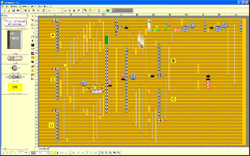

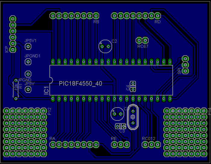

Certainly a lot more professional and easy to use than my 1st pic board :whistling:

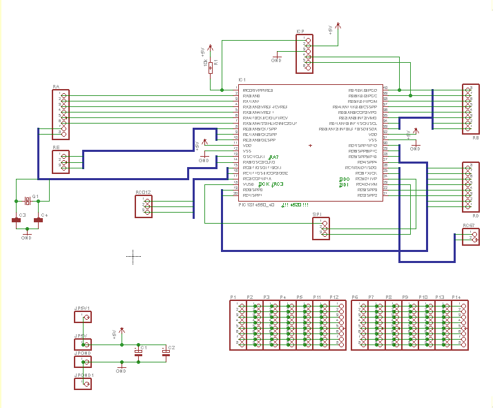

Attachment 2628
Re: The 'ultimate rev counter' thread...
ecat
Attachment 2628
This is cool, you had a concept and went off and completed it, and Hey if it worked what more could you ask??, I think i would have enjoyed making that as much as i enjoyed making some of mine, this is what irving does,without even realising it, he encourages you to get building, because he and others on this forum are here to help you out when you get stuck..
Rick
ecat
Attachment 2628
lol don't knock stripboard, it has its place... I use plugboards now for prototyping (pic is my basic setup) but for some things where you want a copper ground plane, stripboard still works bette as a prototyping medium...
Attachment 2629

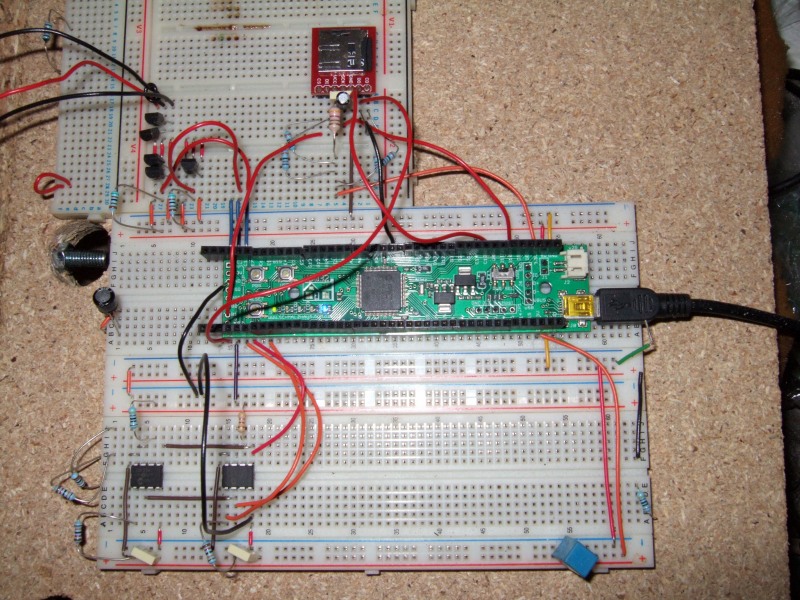

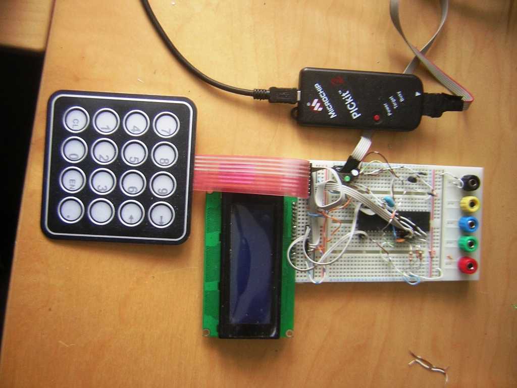

3 Attachment(s)
Heh, general dev board looks a little different these days
Attachment 2630Attachment 2631
and prototyping a little more advanced
Attachment 2632
That's a few Dallas temperature sensors, 80MHz cpu board, 32K external RAM, 4MB external flash and a 1GB micro SD card. Add a little test software (http://forum.sparkfun.com/viewtopic.php?f=19&t=17217) and things have come a long way :)

I hadn't used stripboard for ages until I made Les's Tacho x2. Much more used to the joys of UV boxes, FeCl3 etc. I have now resolved never to use stripboard again. It's just too much hassle checking for shorts between the strips :sad:
ecat's Eagle .brd looks good. Must investigate ...
