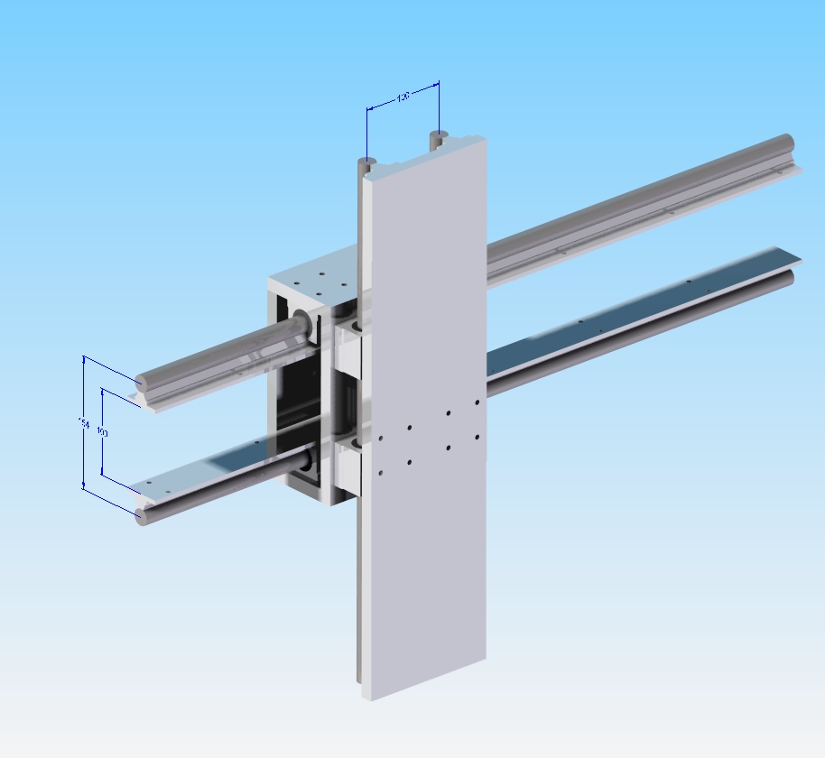

Straightness of steel/alumunium box section
Is aluminium/steel box section straight enough to mount a supported linear rail on opposite sides and expect it to run smoothly without binding.
Here's an example to clarify. I'm thinking of putting a piece of 100x50 box section between those two horizontal rails.

Assuming the rail is straight and if it's only a few tenths here or there you could use a thin layer of epoxy.
Re: Straightness of steel/alumunium box section
Extrusions are very accurate, either profile Ali or RHS Ali section. Bit more expensive than steel, but alot of steel is ERW (electric resistance welded) with a seam down one side. I remember reading a post where they wished they'd skimmed the steel section before mounting the rails. Factor in the cost of getting two faces ground and the Ali profile is your best bet.
By the way, in your sketch showing the box section assembly wrapped around the gantry this could probably do with a slight re-arrangement. As drawn the top and bottom plates fit on top of the sides. This means that the sides have to be very accurately cut to get a nice just-right preload on the bearings.
If you make the sides longer, and have the top and bottom plates inset, then the play in the bolt mounting holes (~1mm in total up and down) which are now in the sides and not the top will allow you to put it together better, and set the system up with just the right load. Otherwise you risk either squashing the bearings or pulling them apart.
Thanks for that. I reckon I'll go for 80x80x3mm aluminium box section then. There's someone selling it near me for £20 per meter. That does make the centre distance of the Y-rails only 134mm - is that OK?.
Excellent point about the bearing preload - that's probably saved me a lot of hassle! I'll change the drawing now.

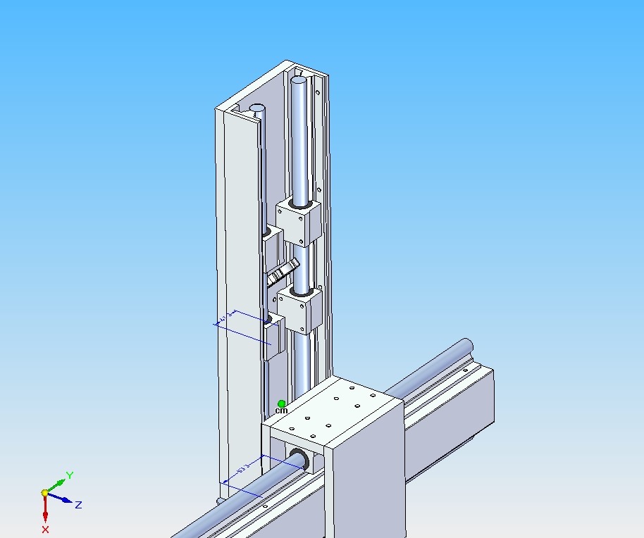

Are you using the rails back to back on the y axis to counter the uneven load distribution? (ie 25% reduction at the open side) if so have you looked at doing the same with the zaxis? if you mounted them on a c channel (or box with a slot cut out, then you would have space for the Drive screw as well)
Just a thought and is some thing I was looking at a while ago for an Ali box and supported round rail machine. Not enough hours in the day..........
Exactly.
Ross77
I looked at it, but didn't think of using C-channel which would make it quite simple.
The place near me has some 3"x1"x0.25" aluminium angle. There's also U, 2" x 3" x 2" ... only 3/16" thick though. Time for some more drawing / calculation!

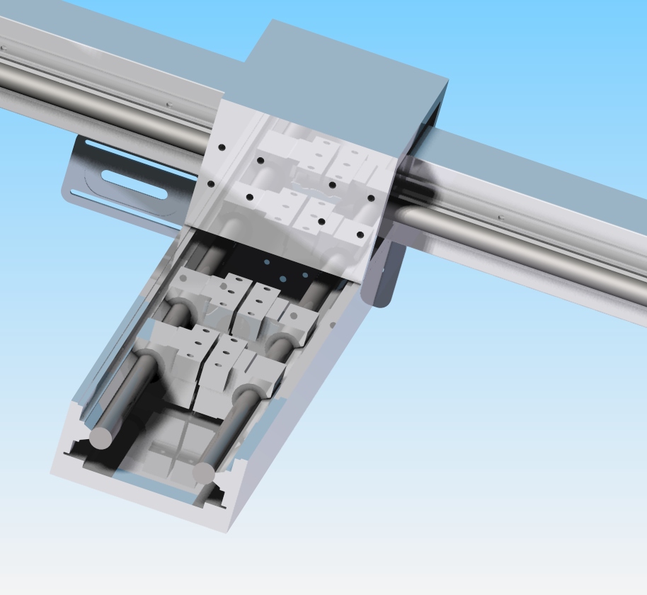

This is what I was looking at, the idea was that the two horizontal box sections top and bottom with the c channel and vertical box in the middle would provide a pseudo I beam but with improved torsion due the central box, the c channel would house the Ball screw and there fore keep the z axis in tight to the gantry
The idea for the z axis was similar in that the spindle and hence cutting forces were in close to the gantry and the back to back rails to give an even load distribution. I figured that a wider z carriage was acceptable as the increase in rails needed is marginal compared to the bearings.
Anyway thats as far as i got and I know there are many improvements but hope it of some use or sparks another idea

Wow' thanks for the drawings! That looks like a good way of going about things - much less expensive aluminium plate which is a bonus.
I've been trying to get the rails to fit on 3"x1" angle mounted too the plate...but it's just generally not working. I'll post more when I've got a drawing done.

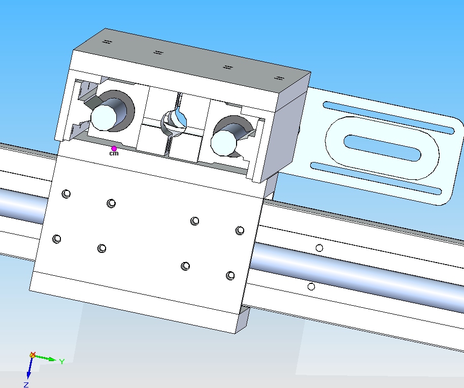

I'd also been playing around with a few ideas recently. Some of them are very similar to yours Ross!
First off, tried to get Z axis as close to gantry as possible (using profile rail, which I'm fortunate to have) and came up with the scheme below (LH image).
Also, playing with gantry sides idea using RHS, with an offcut from the gantry as a spacer to get the loads well into the RHS and avoid just locally distorting the wall (centre and RH image). Lower joint down to the X bearing is always an area for many ideas - thought using these bars each side were a bit neater than the usual double back to back plate arrangement.
Option of TIG-ing a closer plate over the sloping part of the RHS, but probably not worth the effort.
p.s. Looked at some of the steel box and RHS in the stores, and the ERW stuff would need grinding. The sides tend to cave in slightly relative to the corners.

I like the idea of rhs with the spacer, nice and neat, you could probably get away with just gluing a closer stip over the angle to keep dirt and chips out.
Where would the ball screws go on the first one? with those rails could you wrap the carridge around the beam and mount the srews and motors on the back or would the leverage be all wrong? not pull ing from the centroid etc...

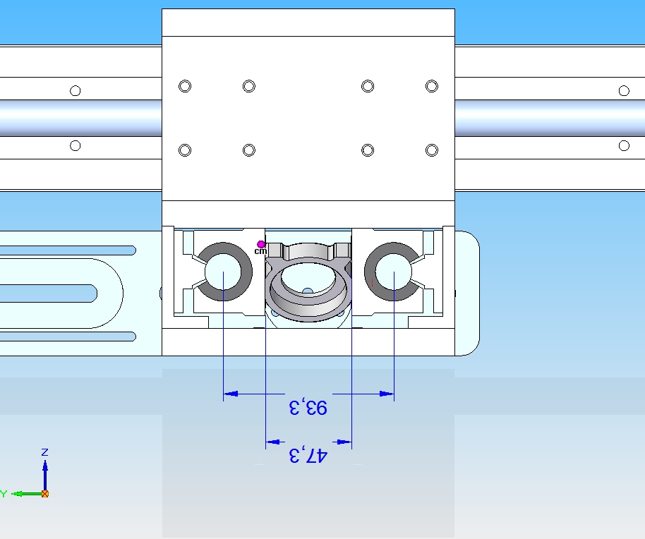

Well, I tried 'borrowing' your design Ross but couldn't get it narrow enough for my requirements. Great ideas though.
This is what I ended up with:
Attachment 2867
Here's my current design. Just trying to work out how to fix the 4 blocks to the aluminium plate that slides on the Y axis. There's not much room and it's made more difficult because the bolts thread into the bearing blocks...I don't really want to start drilling those out.
Attachment 2859
Attachment 2860
One plus of having the Z rails this way round is that that aluminium angle will stiffen up the 20mm aluminium plate significantly. Maybe I can replace the 600x160x20mm plate with 15mm to save a few ££'s?

Right, hopefully this will be the final final design!:
Attachment 2861
I've rendered it with the Y axis off the blocks on the Z as otherwise you wouldn't see much.
Have I done anything silly...does it look OK?
The mass of all that is 25.9Kg, that's not including the stepper motor, screws, bearings and spindle.:thumbdown:

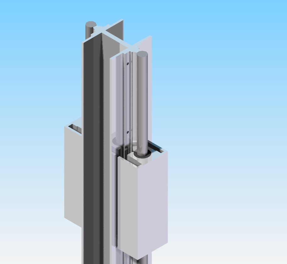

Some good development and ideas, but where were you thinking of putting the Z axis leadscrew? Looks like there's no space now.
I wonder if you just turned the Z axis rails through 90deg and mounted the support rail onto the router plate, and mounted the blocks back onto the main Y axis carriage, you would be better off. Stiffness wise it must be similar, and you are no further away in terms of spacing from the gantry than the above dwg (judging by the dwg above). You could even include the angle pieces in there as well if you want.

I wonder if you just turned the Z axis rails through 90deg and mounted the support rail onto the router plate...
Are you describing what I drew in the first post on this thread, or something different? I rotated the rails to even up the load on the bearings. Do you think this isn't an issue? If so I'll quite likely go back to the previous version as it's easier.
If I understand the dwg in post#17, then the router plate mounting footprint onto the Y axis carraige is now very narrow. I assume the blocks with the hole in for the ballscrew are the mounting feature into the bearings and into the Y axis carraige.
If this is the case I personally would go back to you original drawing. Ross can make this work, but your geometry requirement is obviously a bit different. Don't think the bearing load would be a problem for the original dwg, especially compared to the compromise on mounting in post#17. If you keep the angle piece you can always add these to the router plate if required. Any further views on that Ross?
The supported rails do have bulk, more so than profile, so it looks like you've done all you can.
[edit: Wonder if you should allow for (i.e. drill the holes for) a second pair of bearing blocks at the lower Z support. Because of your long Z axis reach the loads will be high at the bottom bearing, trying to open it up on the post#1 dwg. Another one next to it would help. Bit like some heavy doors have 3 hinges, with 2 close together. Never tried 3 in a row - don't think there would be a tolerance problem unless someone knows different. ]
