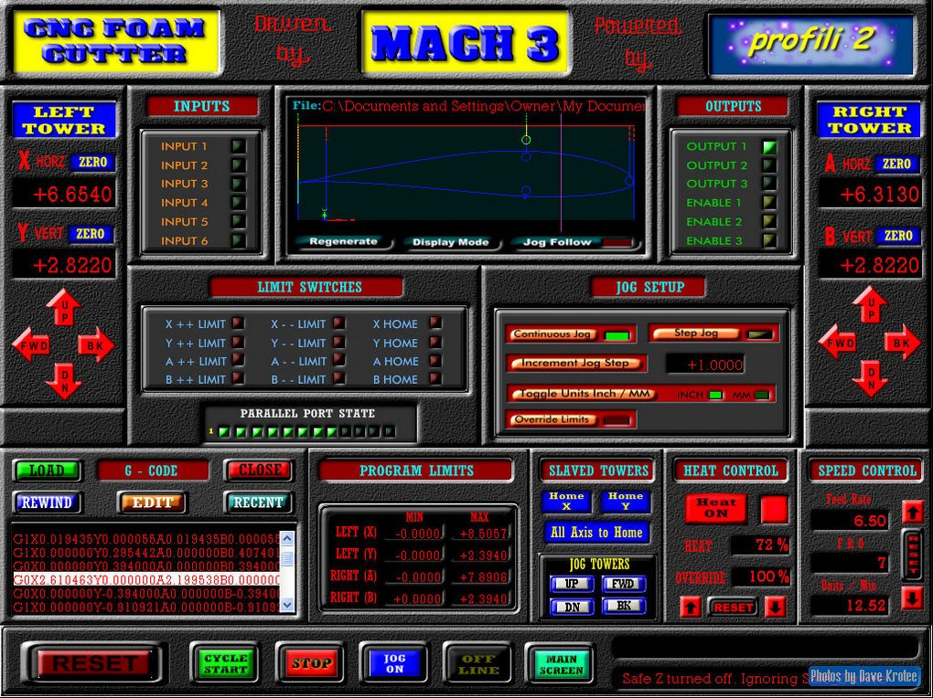

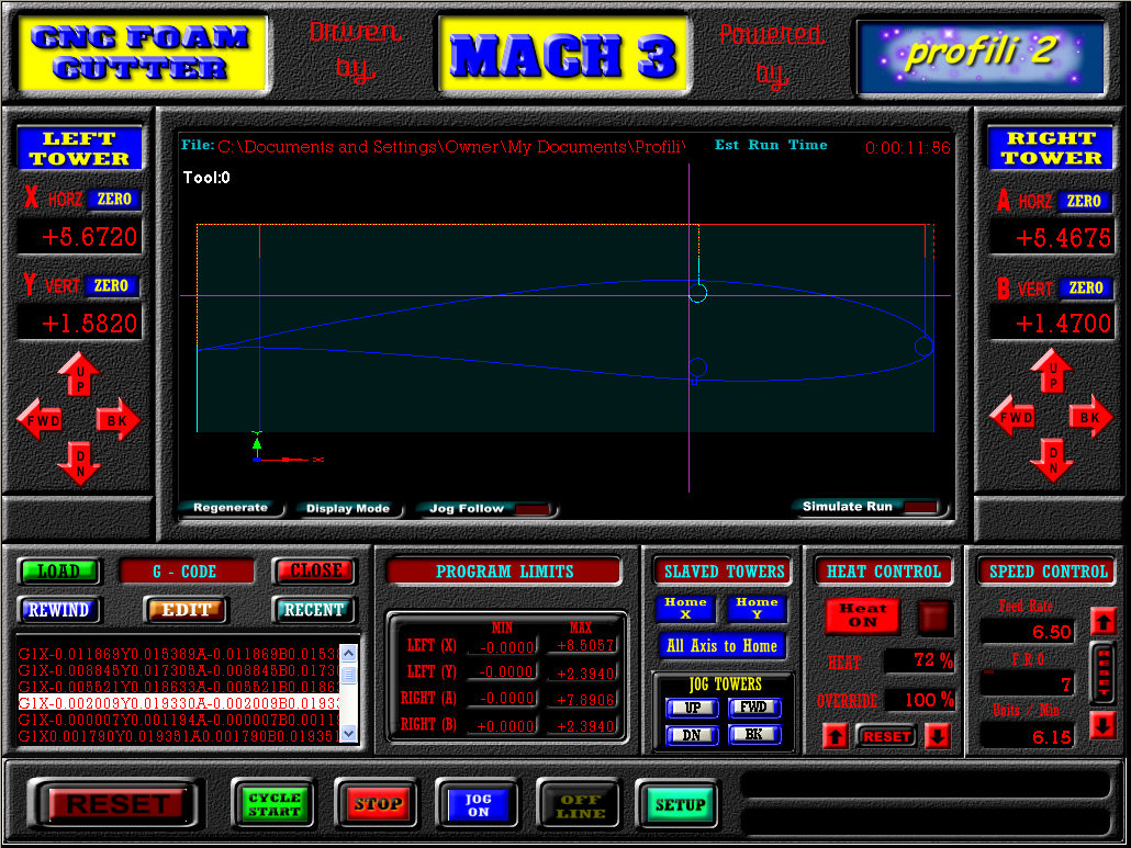

Here are a few screen shots of a screen set I designed for controlling a hot wire foam cutter.
Attachment 2869
Attachment 2870
Here is the screen set if anyone is interested.
http://odysseywood.us/profili/CNC%20Foam.zip
Sam

Hi Sam
Not too familiar with the tower foam cutters,but I would have thought that with them being identical towers and each one supports/carrys and guides the hotwire through its paces but at identicl co-ords therefore all axises motors wired in parralell with each other on the three independant axis.
I see in your screen layout that one axis is out of sync is that the way it should be?
I'm thinking if one axis lags behind this would cause a problem?
Not all wings are parallel chord, the wing could be tapered or have washout
Hi Sharbold,
Great work there, looking really good. I've not used Profili2, but heard alot of good things about it. Will it generate Gcode to drive mach3 as suggested in the title area?
Hope rckeith is reading this, perfect for the foam cutter he is building!
Hi Vic66,
Good point about tapered wings, but can the wire manage washout? Not having used foam cutters I'm trying to picture in my head how the wire would move to do that - being pulled taut limits the possibilities I think, unless you overcut into the waste using multiple passes?
For those that don't know washout is a deliberate twist (to a lower angle of attack) as the wing goes from the root (near fuselage) to the tip. This helps reduce tip stall at lower speeds on tapered wings, for a compromise at high speeds.
Not used a cnc foam cutter either, just templates and bow, I have been slowly collecting parts for one though. I would imagine you could achieve washout with multiple passes with a bit of thought, although I havent gone through that process, you could make the wing half in multiple pieces as well, my comment was in response to George's question about the axis's not being parallel but myself and ecat must have replied at about the same time.
Yes Profili Pro will output Gcode that will run in Mach3. If fact the screen shot was taken while running Gcode produced from Profili Pro.
As for washout in profili you can input the amount of washout and profili will adjust the tip of the wing to add the washout.

1) Where can I find the latest version of this great screen set ?
2) how do I move both towers a fixed distance without writing G-code ?
With the standard screen set you can set a 'step' jog distance. (which i use all the time with my CNC router) Going to the setting page and clicking 'step' does not change anything and the green 'led' does not come on

Allen,
Nice work on the screen. I would be interested in getting your profile xml file to understand the underlying hardware settings.
Are you using any macros or brains to control the functions or is it all standard stuff inside Mach3? If you are using macros and brians would you be willing to share?
I have my own machine that I've been working on for some time now and getting both towers to move at the same time in jog mode is something I have not been able to figure out.
Any help would really be appreciated. :joyous:
Jim
https://www.dropbox.com/s/f8iyaulvhg...Mach3.rar?dl=0
XML file. all function is inside Mach3.
I never went very deep in settings Mach3 but, as we have done all settings, the machinery works well in both 2D cutting (letters, logos) but also in semi 3D (model airplane wings, cones, pyramids)
https://www.facebook.com/evergreenpr...47113028738916
Jim are the towers working as independant axis like seen on high end hotwire cutters or are they slaved as one axis.? Should Jog without issues if slaved but if independant then gets more tricky and some coding will be needed. Could possibly do it with brain but would need some testing.
JAZZCNC,
The axes are independent (X,Y,A,B). I left Z for a rotating platform to do some funky shapes in the future (but I get ahead of myself :-) )
I have it running under G code control, but it is a real pain to get the wire close to the starting point of the cut when you cannot move the towers in parallel:) I've been trying to do with brains (mine and the MACH3- not sure who's winning yet:-) ), but cannot seem to find the right codes to use to make things happen. I have found no good info on what specifically each of the DRO, Button, etc. codes can do...

Awesome screen set. I have one small problem. I placed the cnc foam folder in the bitmap folder, Loaded up the screen set and I still have no way to reset the E-stop. The space for the E-stop reset is missing. Can any one give me any ideas to resolve this.
Steve
thank you for this screen, I am setting it up now, but I have two problems:
1. The A--/ home and B--/home switches are not responding to any input. X and Y axis are okay. wiring is okay. Input on number 13 and 15.
2. when pressing HOME ALL TOWERS, the Y-axis is going the wrong way (upwards in my case). I tried reversing in home/limit switches or set limit switches NEGative, but no result.
