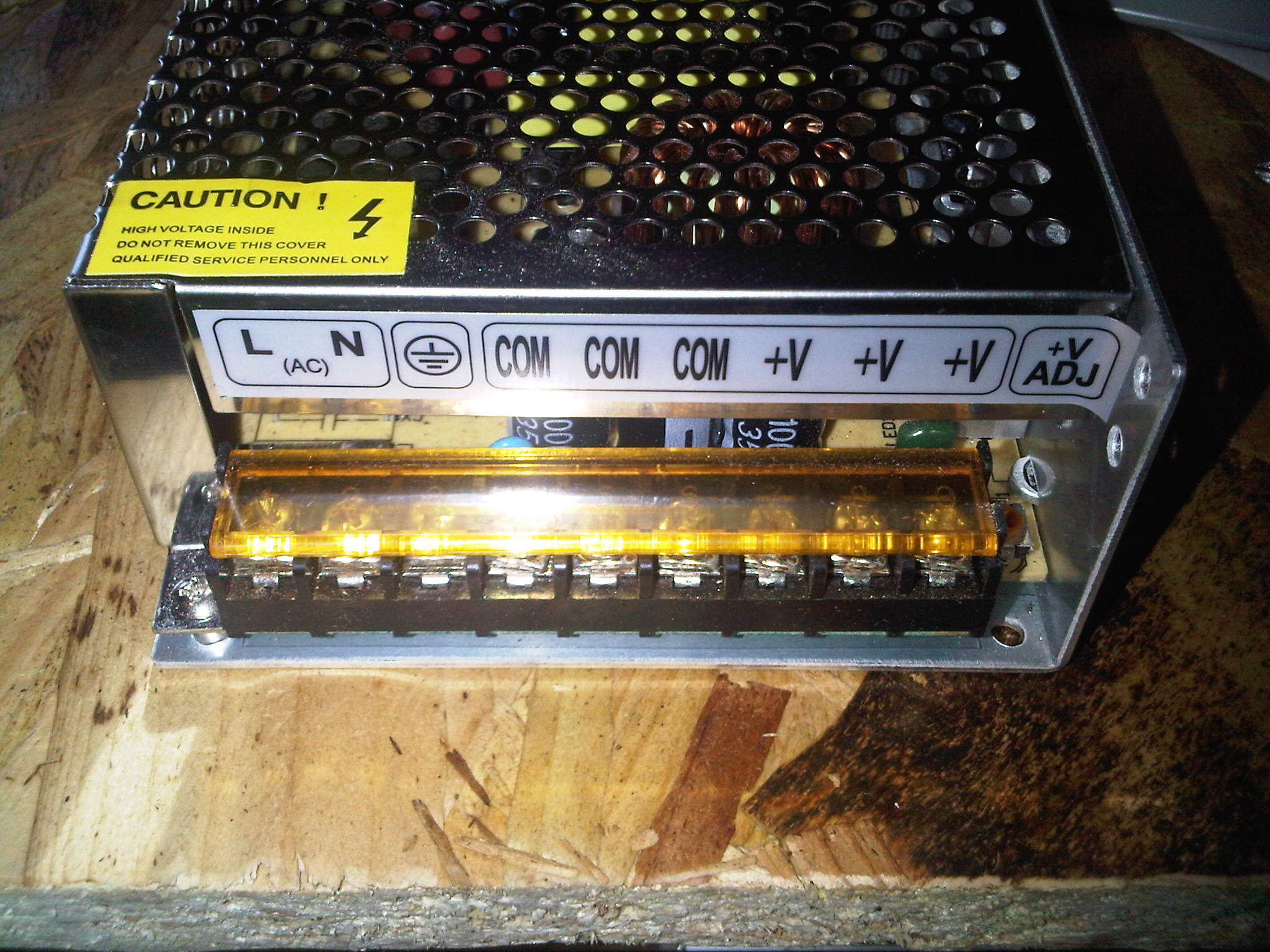

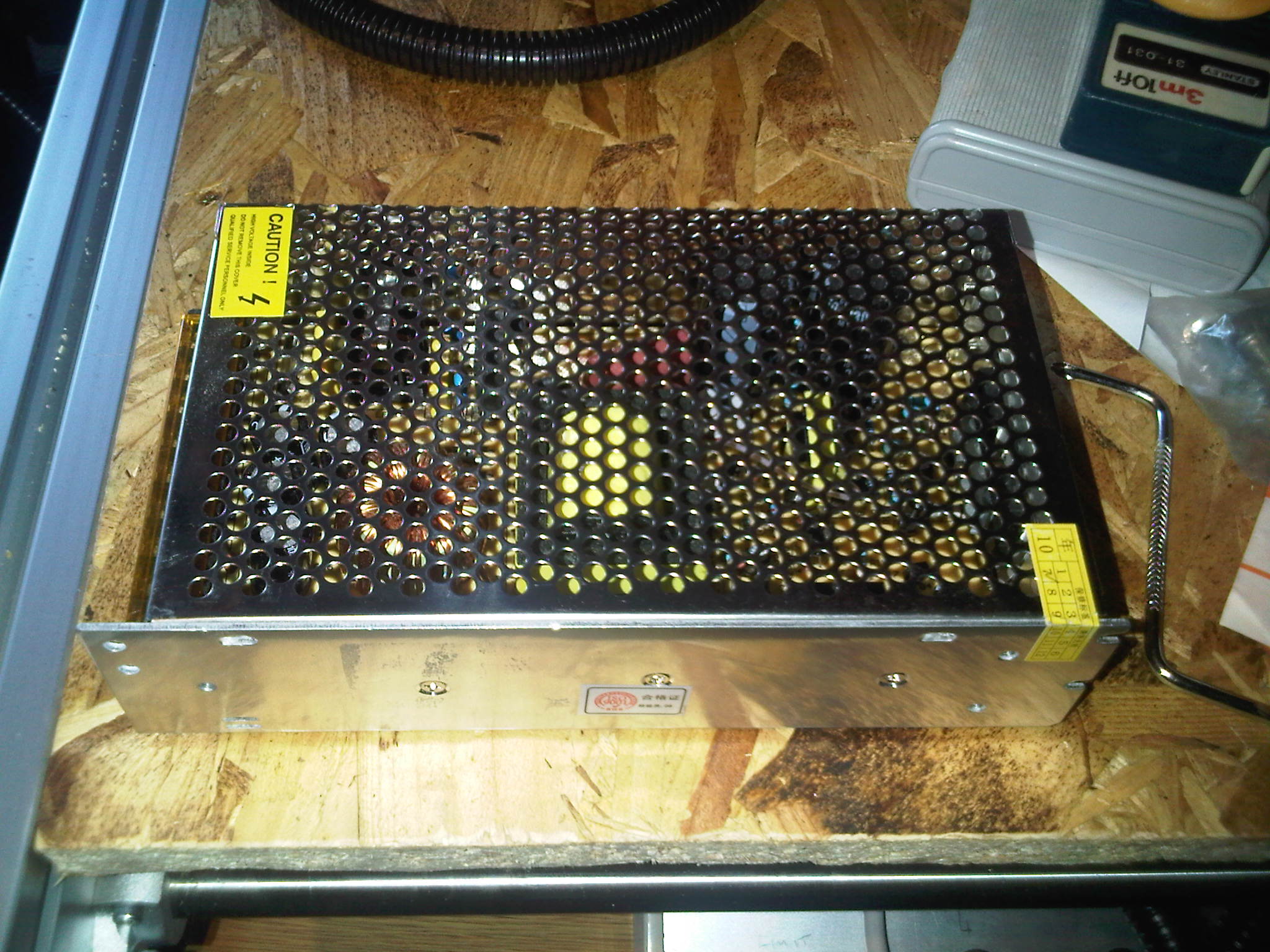

Gents,
Can anyone advise on how I connect the power supply as shown on the first photos? I assume that I need a fused plug and lead connected to the L, N and Earth thus providing 240v inout but which terminals do I then connect the L, N and Earth of the control unit as shown?
I thought all if this would have come assembled from the gent I purchased from but alas not!
Thanks to all in advance.
PS, I have now ordered a cable as suggested.
Re: Total novice and lost
The photo's are not big enough or clear enough for anyone to help you safely.
2 Attachment(s)
Clearly marked, the 3 on the left.
If you are not sure then please get help.

John,
Thanks, I know the first 3 are Live, Neutral and Earth, which I assume will take the power from the socket but what connectors do I link the controller 2? Any ideas?
any one of the commons and +VE
However you need to know the correct way round.
I'd seriously try to get some help on the job, if we are to help from a distance we need more information like what voltage the power supply puts out and where it goes inside the control box.
Sorry for being so vague but it only tales a millisecond of crossed wires to damage the drivers etc.
Any COM and +V will give you the output voltage stated on the PSU, its like having 3x live and 3x Neg, so where COM is meaning - , and +v meaning + if you have a multimeter to hand to check polarity.. that would help if your unsure.
Also for info, on the far right is a potentiometer which you can adjust with a screw driver. This will vary the voltage up a or down within a range, depending upon the spec of the supply. This might be set too high for the drivers so you need to check the output with a voltmeter as mentioned above. Assuming this is the right supply for this box then setting it low might be a good start point.
The white lead coming out of the main box is probably the power supply lead, but you need to know which is + and which is -. Is the control box easy to open, might be obvious which is + and - if you are able to peek inside. Might even state the max voltage on the board. Posting a photo of the inside might even show what make the bits are and lead to more detailed help.
You can use 'ring terminals' to make all the connections to the power supply - these crimp onto the end of the cable (remove a bit of the insulation first). Make sure they are good and tight by giving them a pull afterward. You can buy crimping tools to do this.
Once it is all working, obviously the mains terminals are dangerous (!) so you need to decide how to cover these, or place the unit somewhere safe. Mine is inside the overall control box, with a small fan (ignore the date, the camera is faulty):

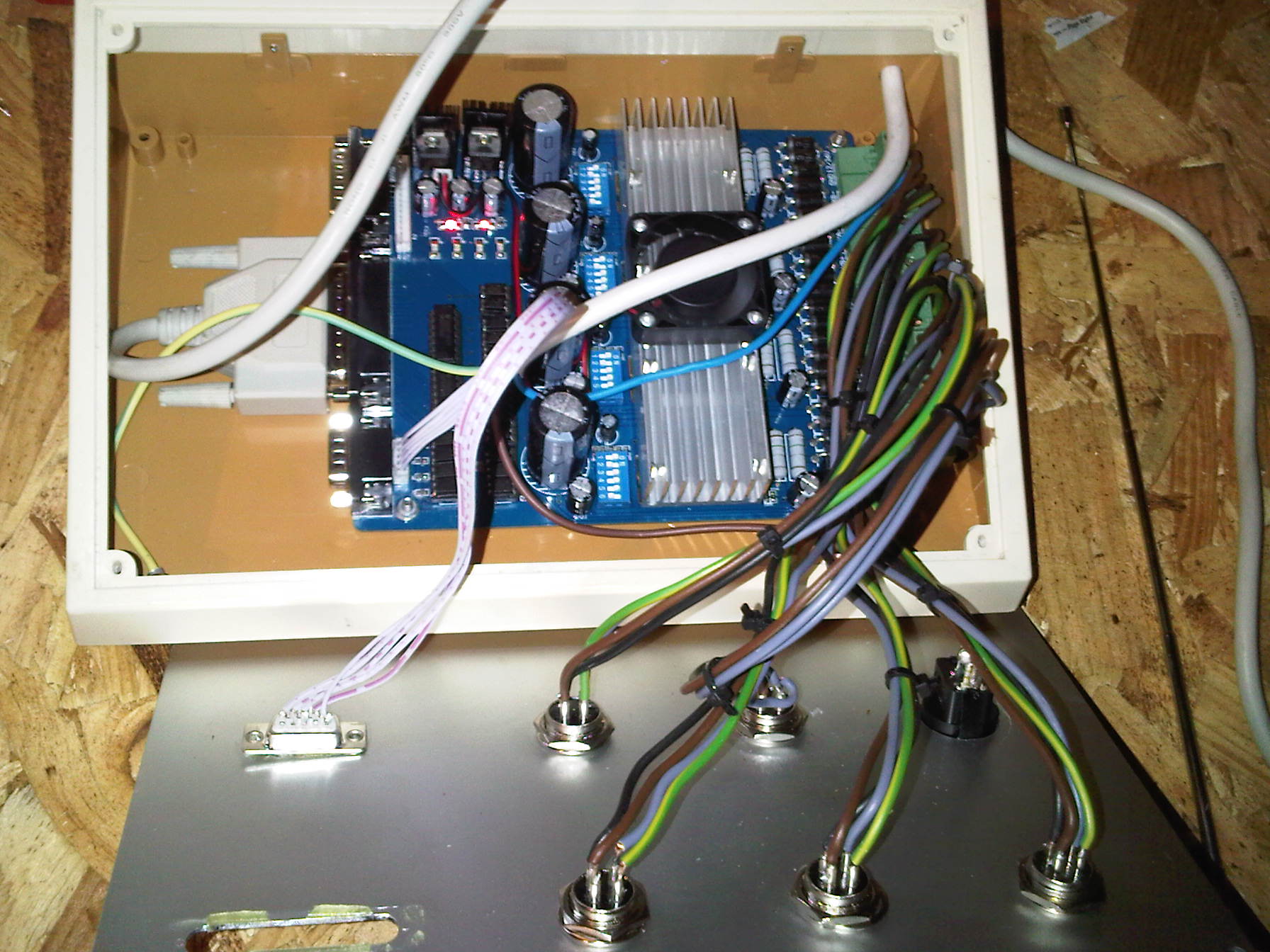

Attachment 2950Hope this helps.
Oo, looks like one of those TB6560 boards from ebay, better wait until someone can confirm this, but meanwhile...
http://cgi.ebay.co.uk/3-Axis-CNC-Ste...item2a09a9f81c
you can find the set up document about 2/3 down the page, it's written for Mach3 :)
I've got one of those TB6560 boards, attached is the user manual for it=> Attachment 2951 Hope this helps...it enabled me to set up mine which worked first time I powered it up...

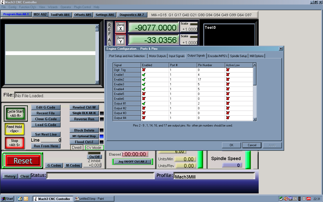

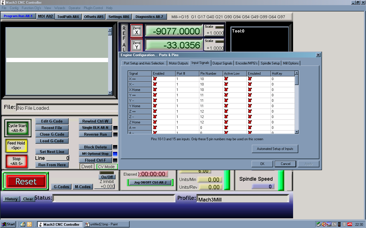

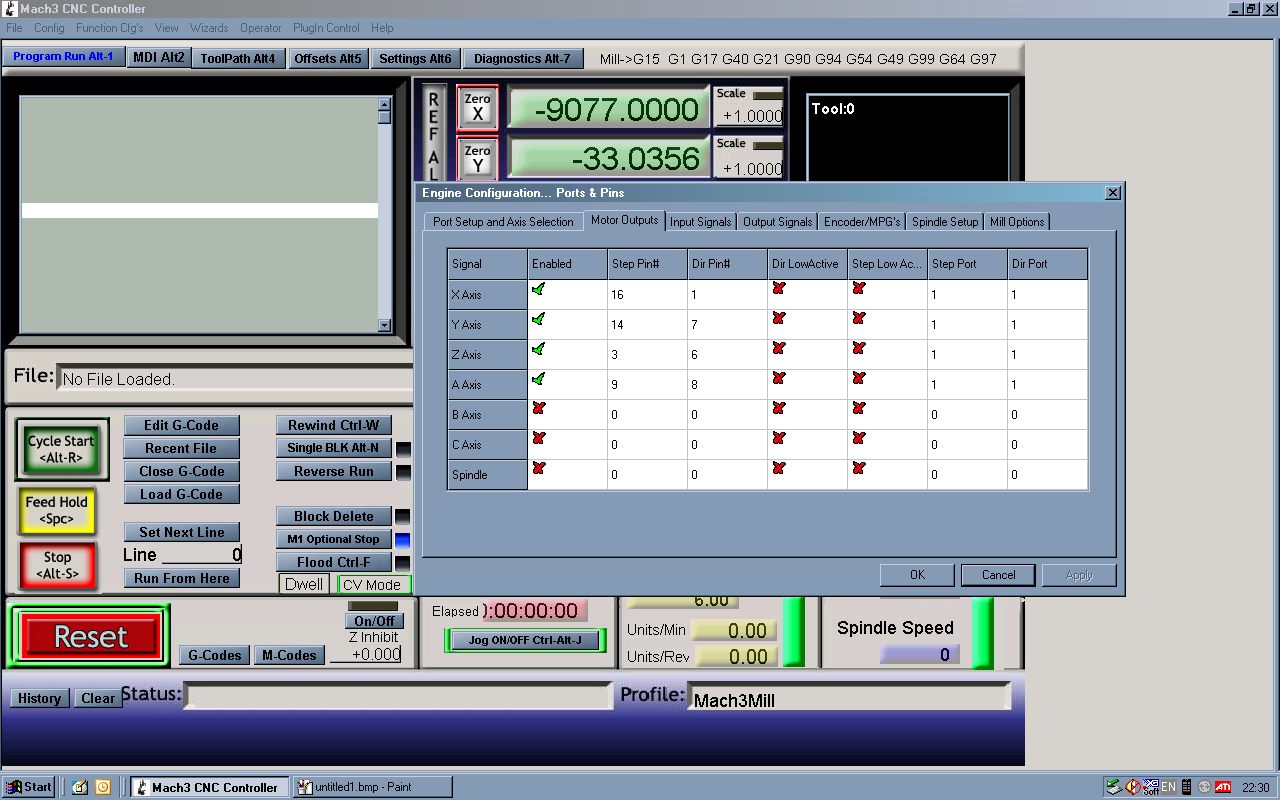

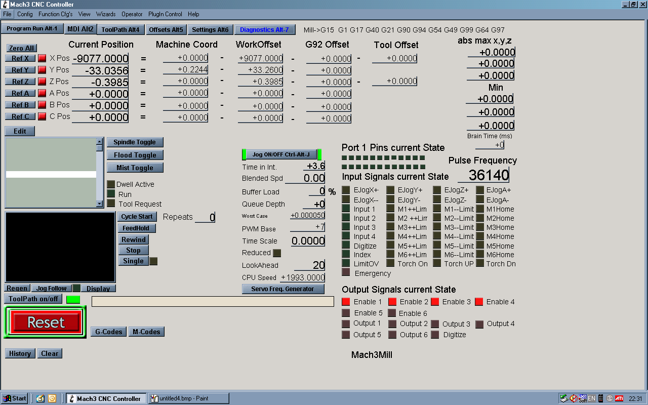

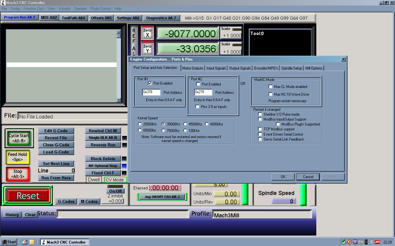

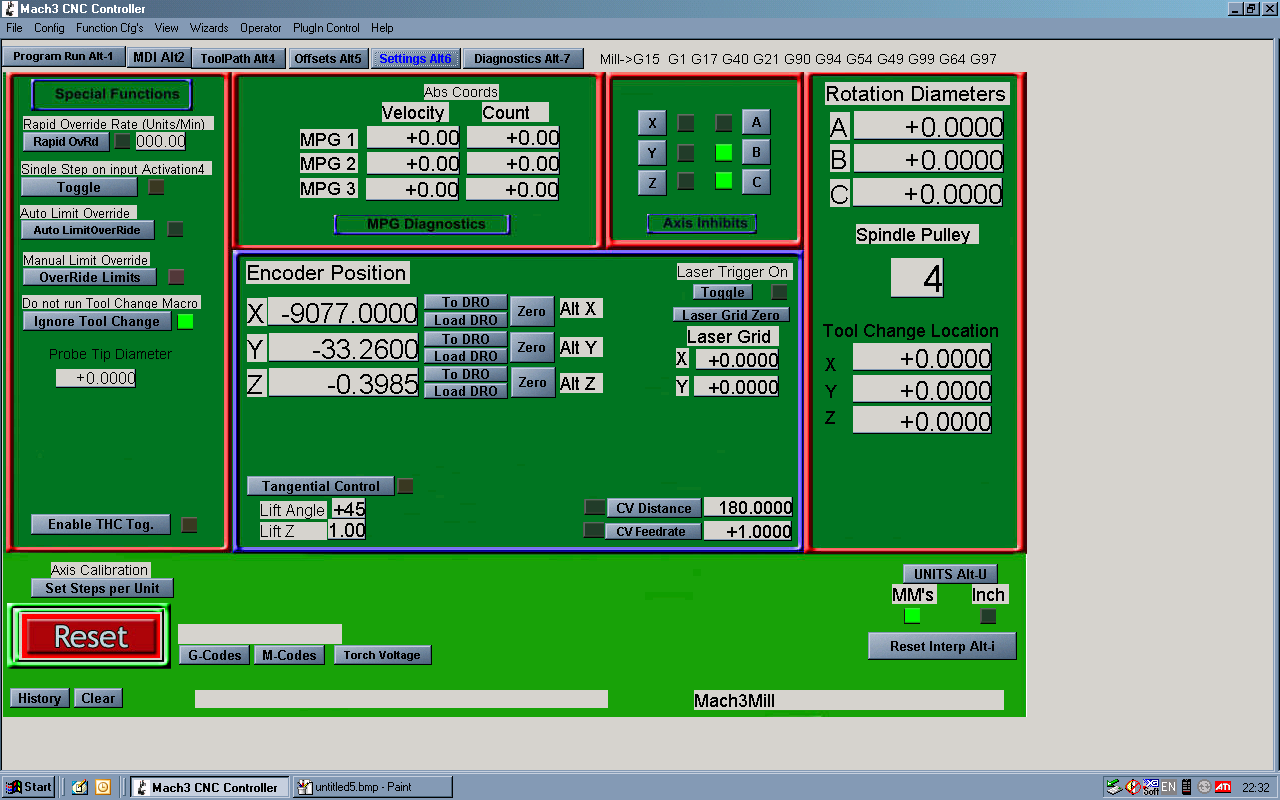

6 Attachment(s)
Attachment 2957Attachment 2956Attachment 2955Attachment 2954Attachment 2953Attachment 2952A selection of screen shots as current. Comments welcomed. Note that the Y axis is working but in 1 direction only.
Firstly I'd try putting the kernel speed down to 25Khz. I doubt that's causing a problem at the moment, but it may do later on. Do you really need it at 35Khz for the feedrate you anticipate?
Here's the manual for the 4 axis board...
http://www.savebase.com/infobase/dow...xis_Driver.doc
If you trust the settings shown there, then yes I see no problem with how you've set it.
The only thing I can think of doing now is to trace the pins on the PCB. i.e. look at each pin on the parallel port connector on the PCB and see where it connects. You should be able to verify the step/dir settings quite easily doing this. I once did it for an unknown stepper driver board....
are you 100% sure the parallel cable is ok? can you buzz it out and confirm its wired 1:1?
As Jonathan says the configuration looks basically ok, but can you bring up the motor tuning page for each axis and take a screen shot.
Another thing to try is swap X and Y axis.... so make X-step, X-dir 14 & 7 respectively... then try jogging X... which should cause Y to step. Incidentally I was led to believe that you must stop and restart MACH3 after making each change so that it saves and rereads the new configuration (I read this somewhere).

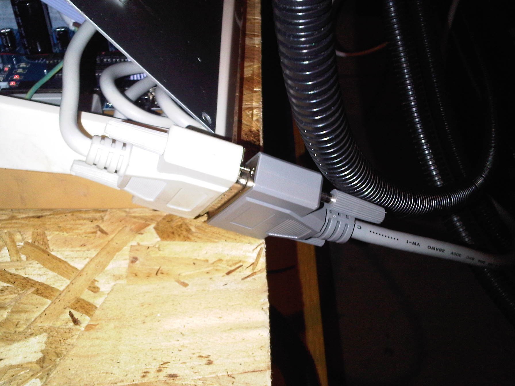

2 Attachment(s)
Morning all,
I have a multi meter to hand and guidance on what i need test and how to test it would be apprecaited.
With regards the cable, there are 2, one connected to the PCB then one connected to that, an extension cable. This is due to the configuration of the box. I can try connecting direct without the extension.
How would I testAttachment 2960 the cable as being 1:1, I purchased the one suggested by a member here however the one in the box was already there (found it when I opened up)Attachment 2959
http://www.mycncuk.com/forums/images/misc/pencil.png
Have you tried the original cable ?
