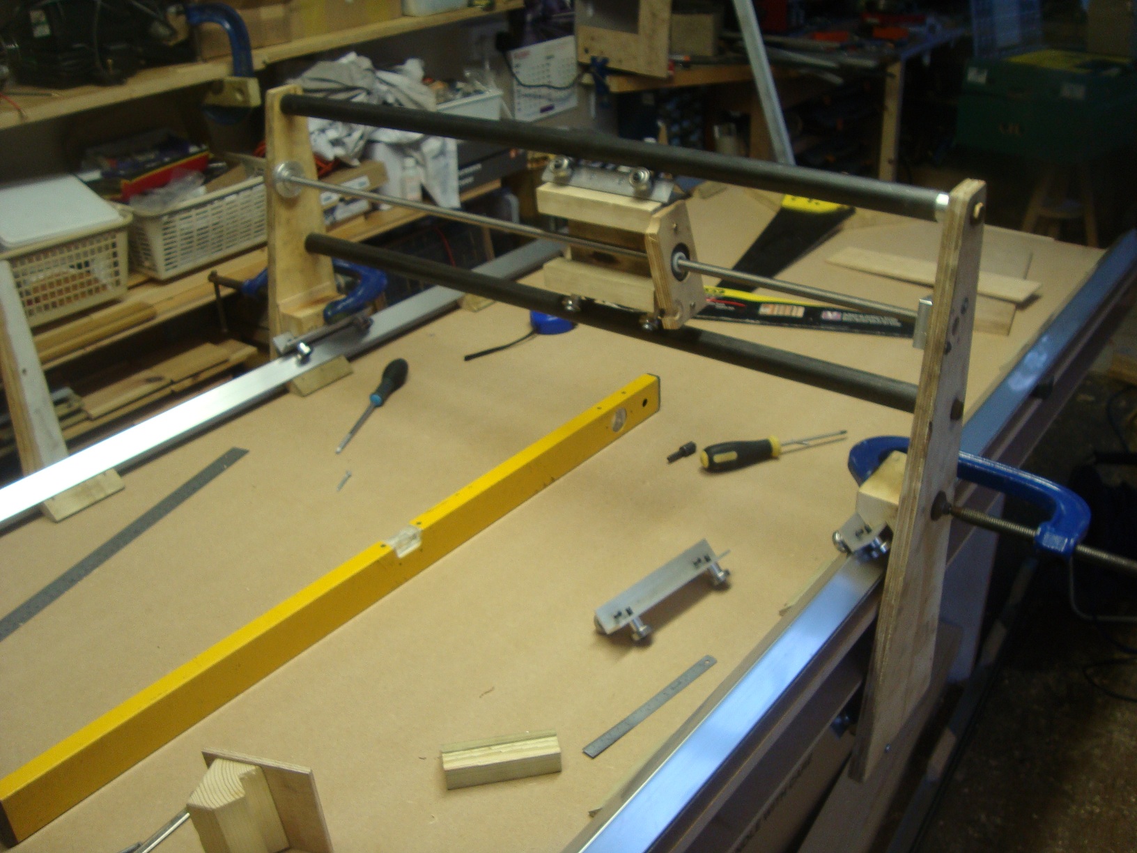

 I'll post some more pictures soon. Here a couple of the base and X/Y/Z axis' I made which will not be used for obvious reasons...

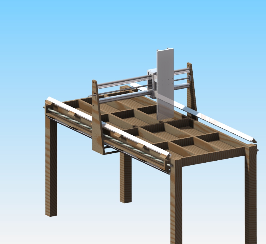

 Drawing....disregard the plywood gantry sides as above.

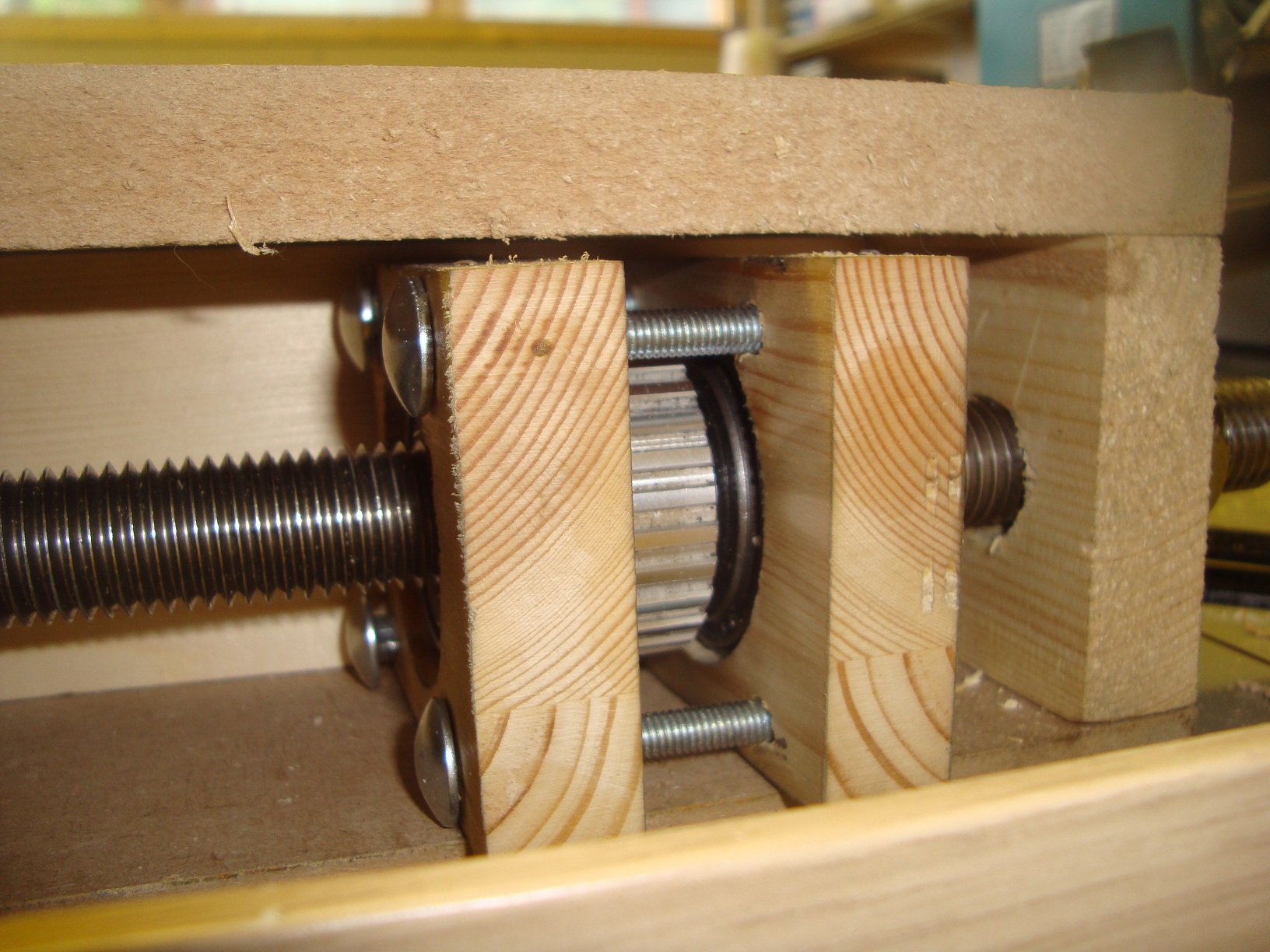

 Attachment 2906

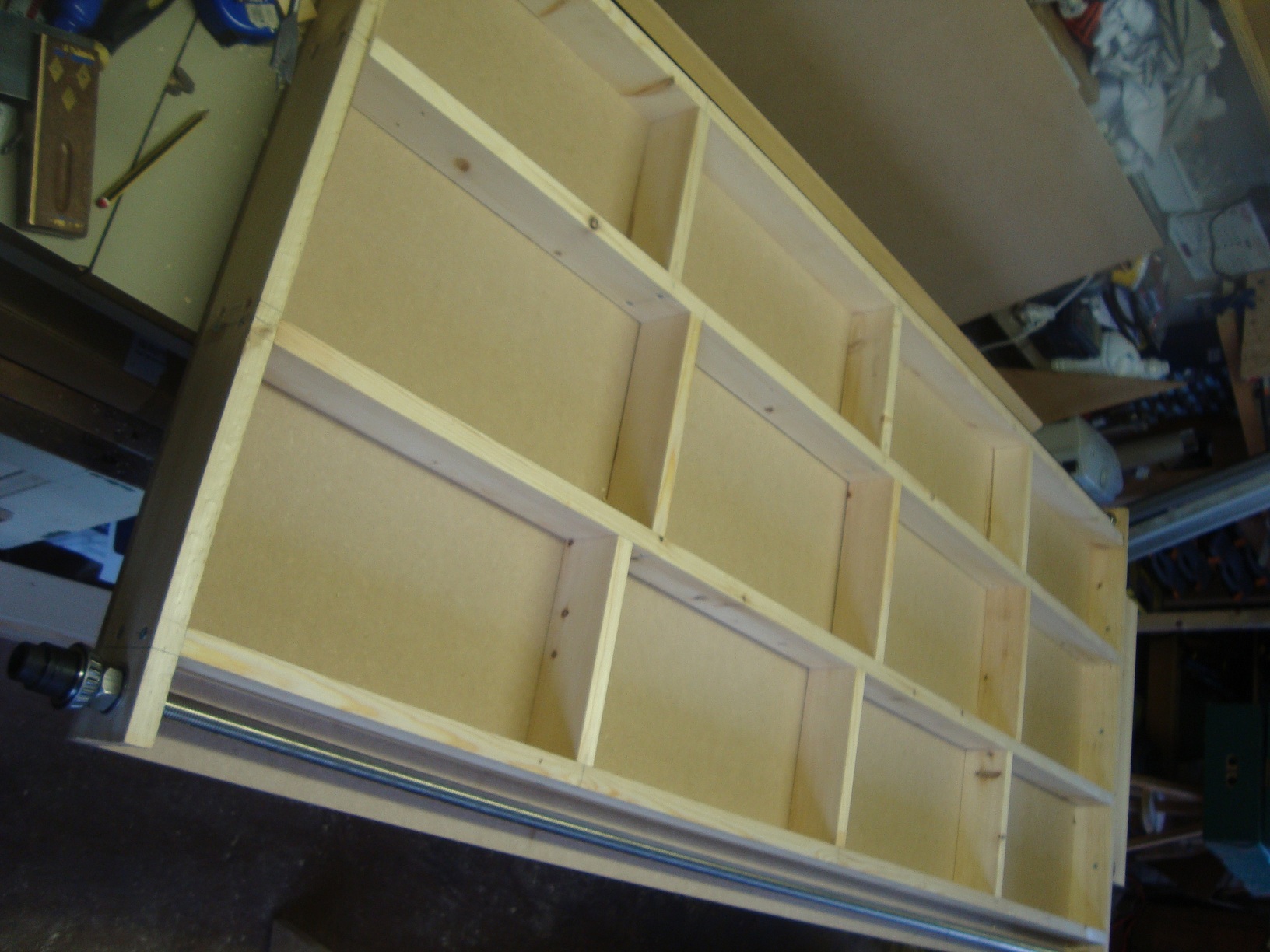

 Frame without top 18mm MDF sheet. Screws are M20x2.5
 Attachment 2907
 Didn't want to be spinning those 2m long screws, so antibacklash nut placed between two tapered roller bearings. Those pine side bits are temporary until I make aluminium ones.
 Attachment 2908

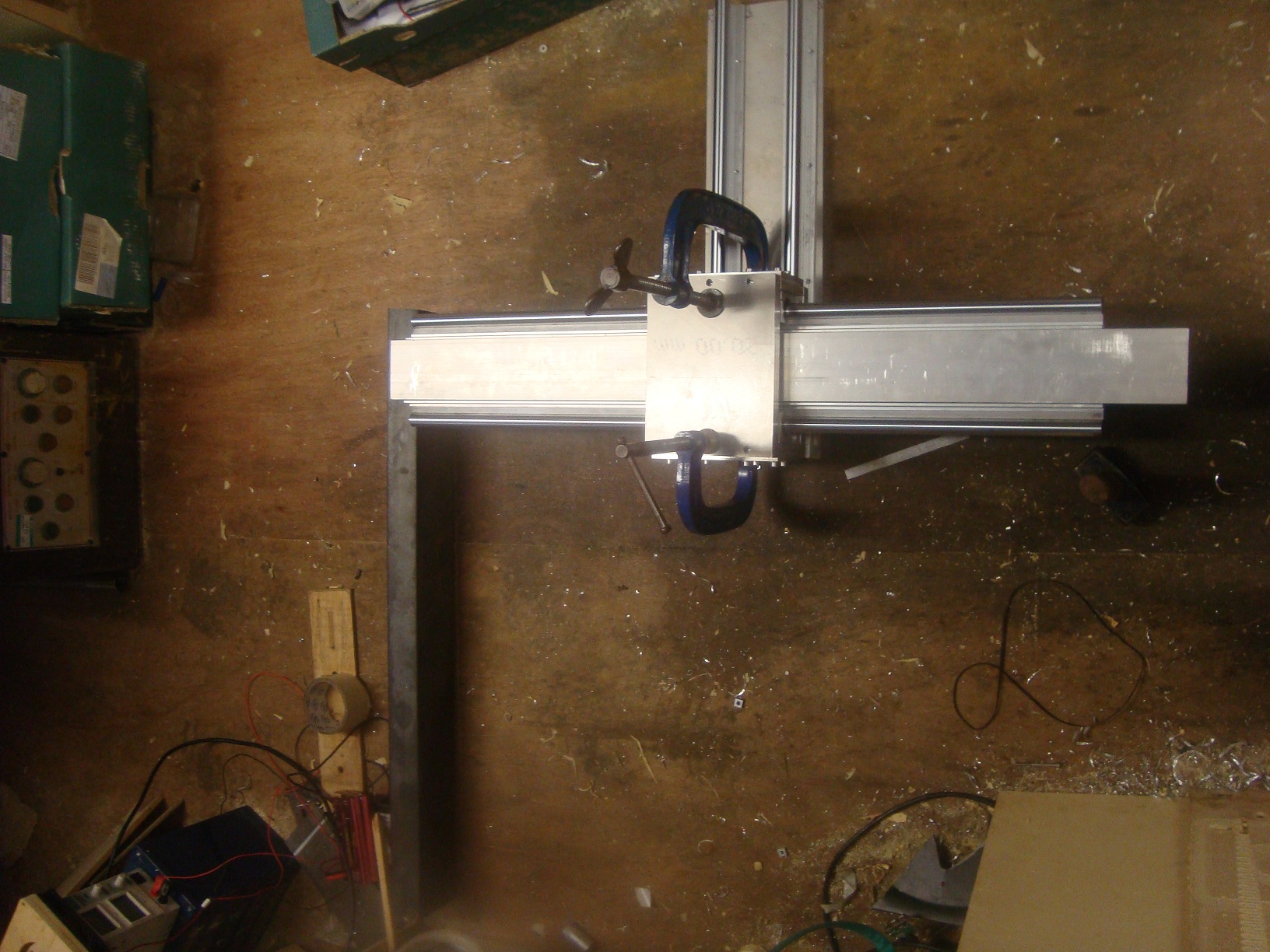

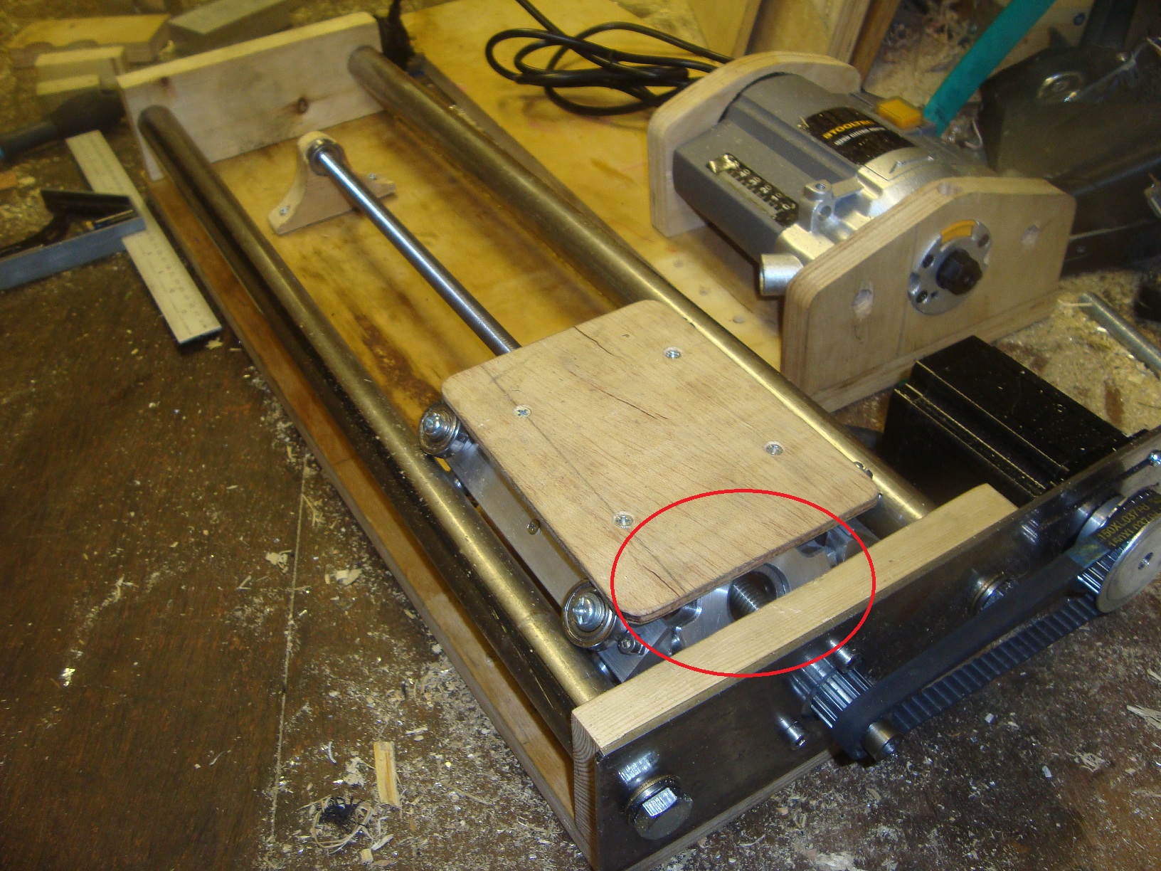

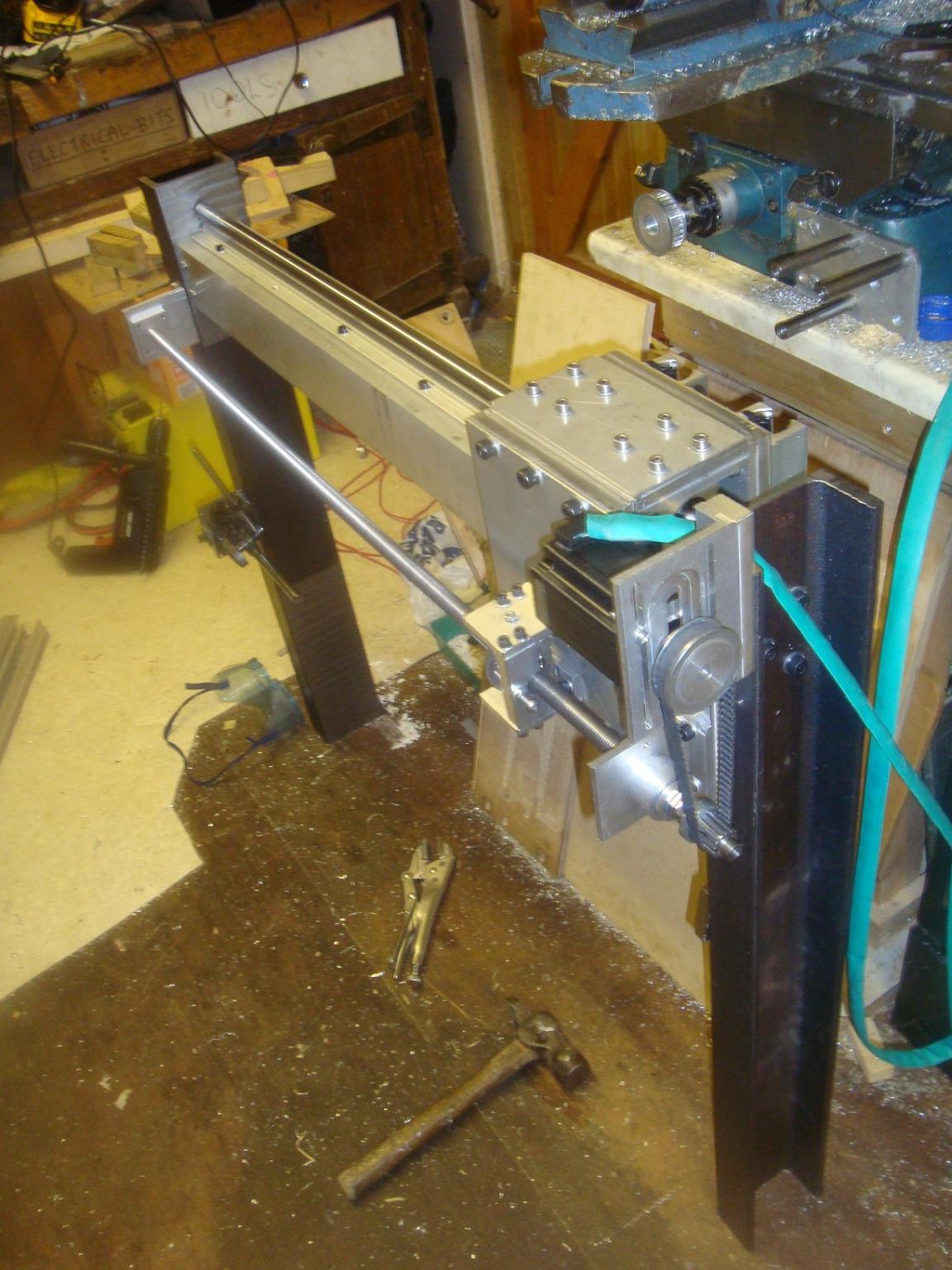

 Er, not much here....am I right in thinking I should rotate the X rails by 90°? At the moment the bottom one possibly doesn't really do much?
 Attachment 2909
 Old Z-axis ... ditched that plywood idea! Do note the alternative to a nut i'm using for the drive on the screw though - bearing. More on that later.
 Attachment 2910

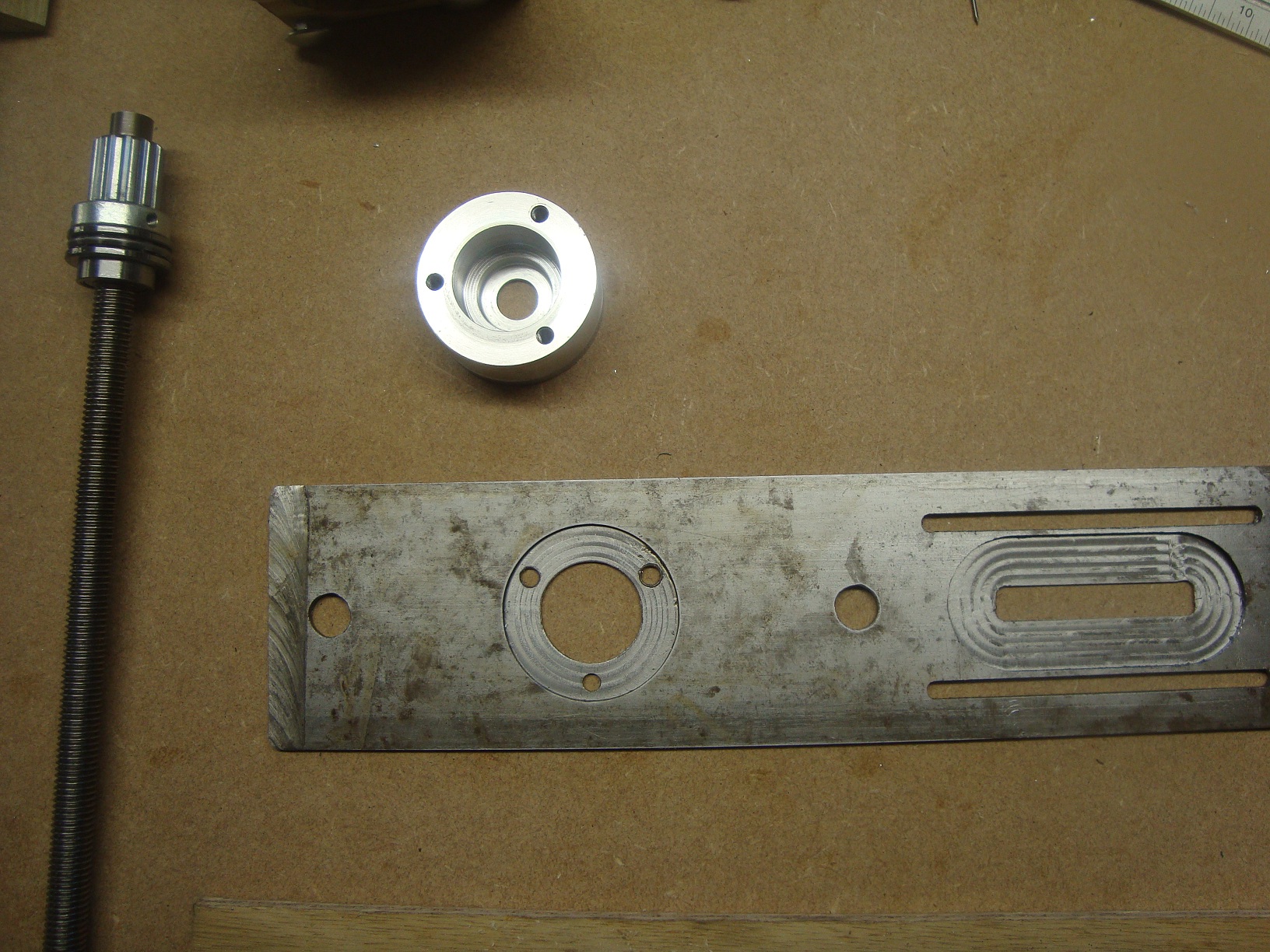

 Mount for stepper on Z-axis (will still use this) and screw. Note thrust bearing etc...
 Attachment 2911

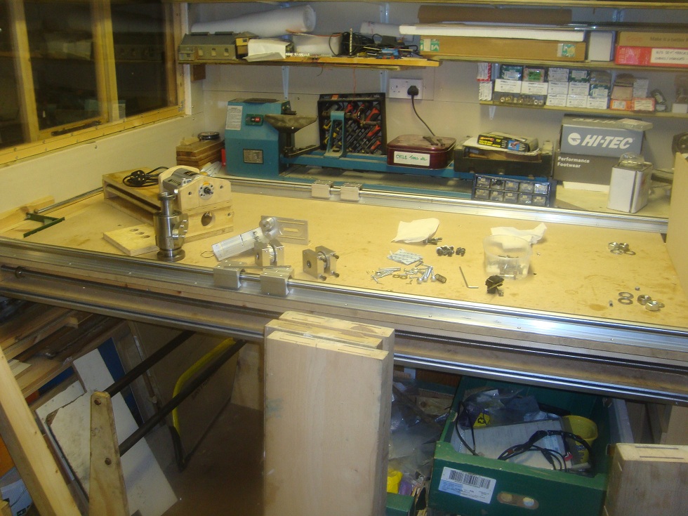

		3 Attachment(s) Re: 1.7*0.74*0.4m Mill / Router building...

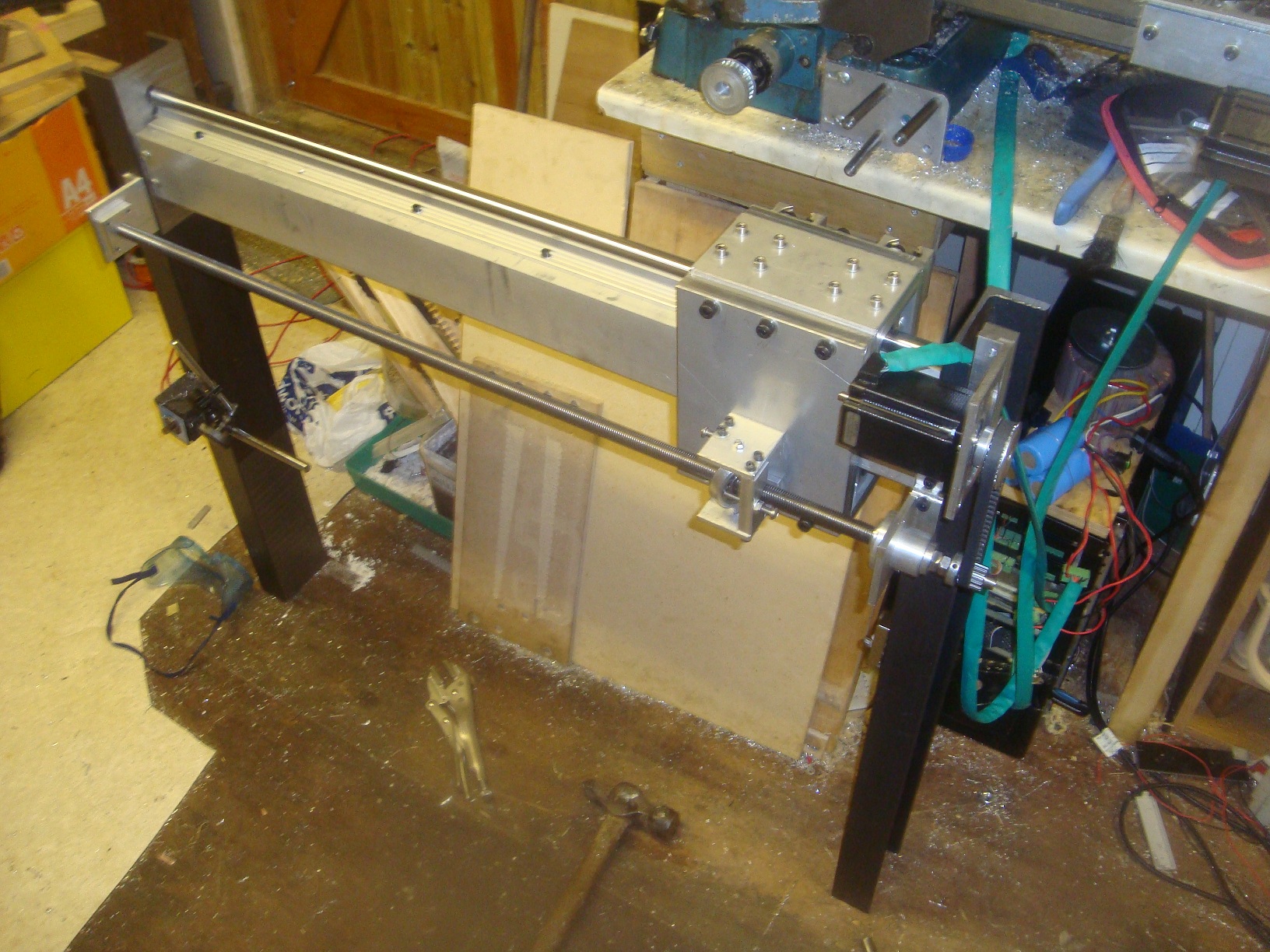

		Been busy making router today and Friday...some photos of progress:
 Gantry...layout of the parts just to check it looked ok:
 Attachment 2941
 Closeup of Y/Z axis'
 Attachment 2942

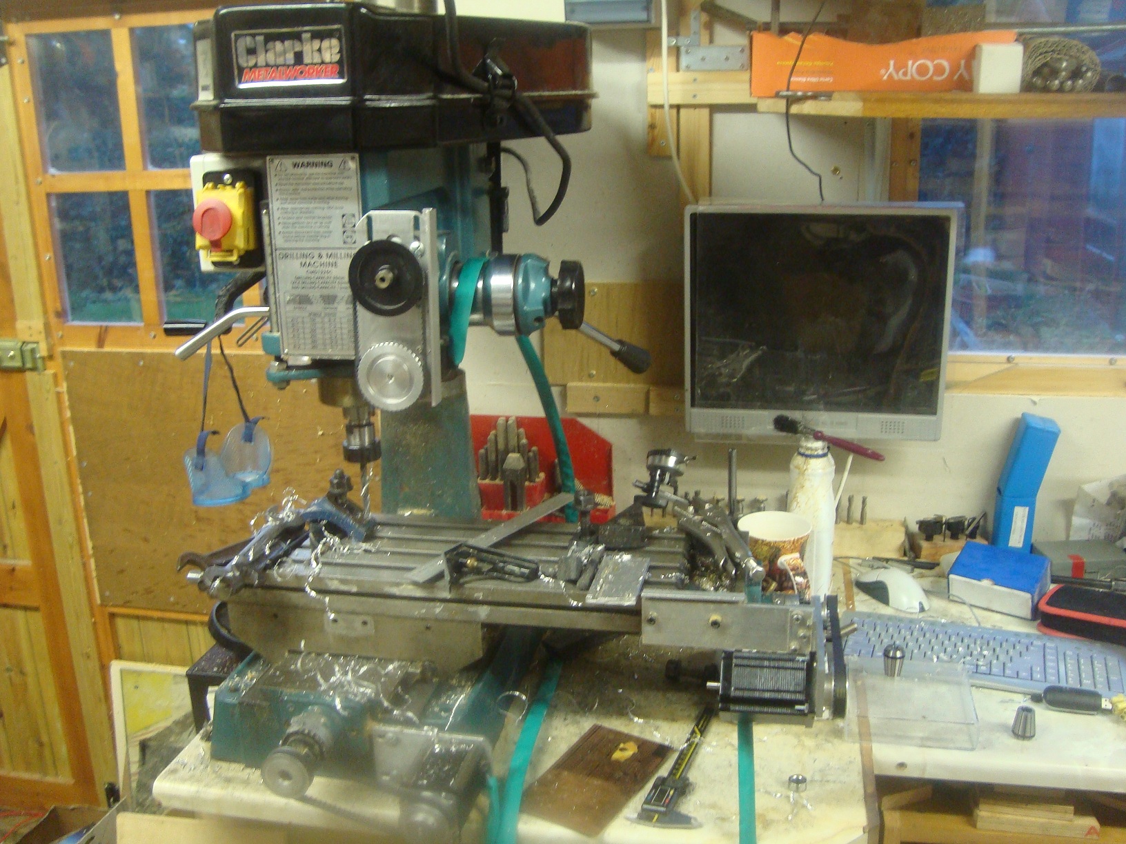

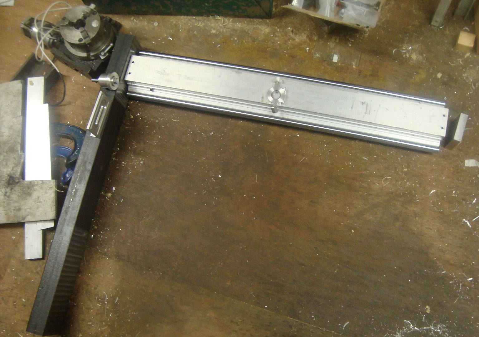

 My milling machine...
 Attachment 2943

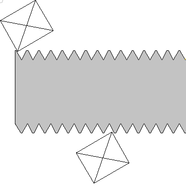

		Just got some M16 threaded rod for the Y-axis, thought I'd give a quick demo of the drive 'nut' as it's a little different...
 http://www.youtube.com/watch?v=m6k8Jz_-WCk
 I know I should probably use ballscrews, but I reckon using this method is almost as good - rolling friction, low backlash... I measured the backlash on the plywood Z-axis I made using this method and it was <0.005mm which I think is pretty good considering the cost!
 I guess it'd be better to use trapezoidal and put an insert in the bearing to fit the thread better - I'll leave that for a later date though.

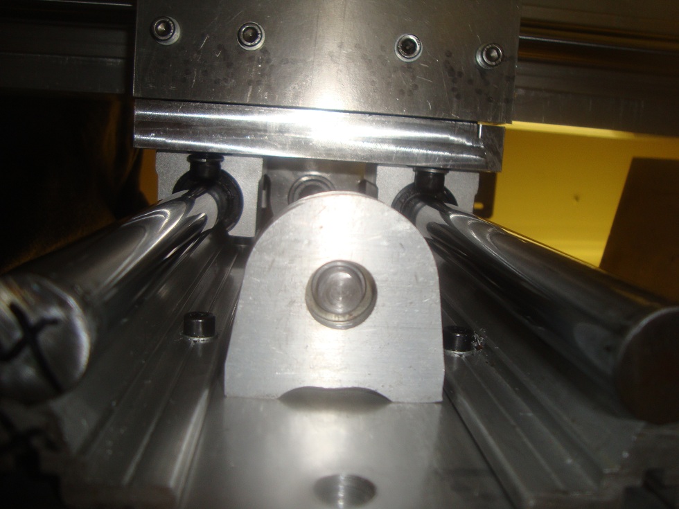

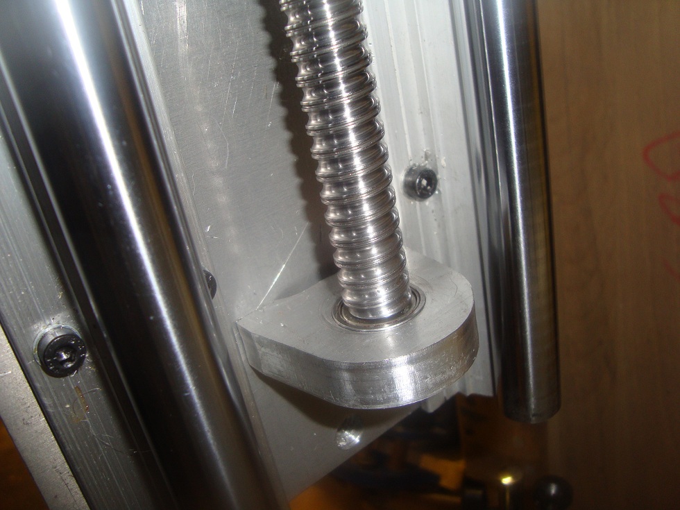

		1 Attachment(s) Re: 1.7*0.74*0.4m Mill / Router building...
				Originally Posted by  irving2008
What have you done there? Can you give some more detail
 Er, not much more to say really? Standard thin section bearing with bore bigger than the thread (20mm here, but more would be better to get less axial load on the bearing) placed on the thread at an angle. I'll use a strong spring to pull the bearing against the thread so that it rides over any imperfections. That's what the tabs are for on the mount, to mount the spring.
 Attachment 2944
 I'm toying with the idea of pressing a brass insert into the bearing lathed to better fit the 60° thread profile. It's tricky to work out the exact dimensions though...
		Hi Jonathan,
 Interesting idea, but it's got me a bit puzzled.  If the thread rotates, and the bearing rotates with it, how does it progress along the thread?  For a nut in a thread to progress, one part has to rotate whilst the other stays still.  Yet in the video the bearing inner and the thread are both rotating.  Is it perhaps vibrating it's way along?  If so I'm not sure this will give reliable position control.
 The only way I can see this working is if you removed the inner race (somehow) to create a pseudo ballnut.  Or maybe I'm missing something here so please enlighten me!
 Er...it just does!
 The bearing is rolling on the thread properly, not vibrating. It's difficult to explain and visualise. Try just getting a random bearing and screw and fiddle with it, you'll soon see how it works!
 If you imagine the inner ring of the bearing was stationary then clearly it would still work...just like a normal nut. The inner ring rotating makes no difference to this, except of course giving rolling friction.
 Sorry I can't really explain it any better!
 One slight issue I can see with this is the bearing applies torque to the screw, trying to bend it. This could be solved with having two bearings angled opposite to each other but I think M16 is strong enough for this not to be an issue.
		Mulled it over a bit more and managing to visualise this now.  Yes, it does work.  Nice idea, and worth a look compared to the cost of ballscrews.

		I think there will be a torque limit (from the stepper motor) which can be applied to the leadscrew, otherwise the bearing will want to jump over the teeth.  Depends on the spring preload holding it against the teeth - higher is better for this, but then more bending load on the leadscrew which is less good.  This effect will probably be the determining factor in the success of this idea, but good thinking!
 Better tooth engagement from a brass insert, as you suggest, might help although there will still be a limit - you'll have to see how it goes.  You might be able to arrange a locking up nut so that when the spring tension is developed you can lock it off at that position.  Of course this won't compensate for small variations along the thread, but might be a fallback position if it keeps jumping.
		I can see bearing jumping could be a big issue with a long screw since for the bearing to jump the screw would need to bend a bit...
 Locking nut on the spring is a good plan. Just thought instead of using a standard spring I could use a couple of belleville washers since the travel required is tiny. Can also adjust the spring constant by stacking the washers different ways etc...

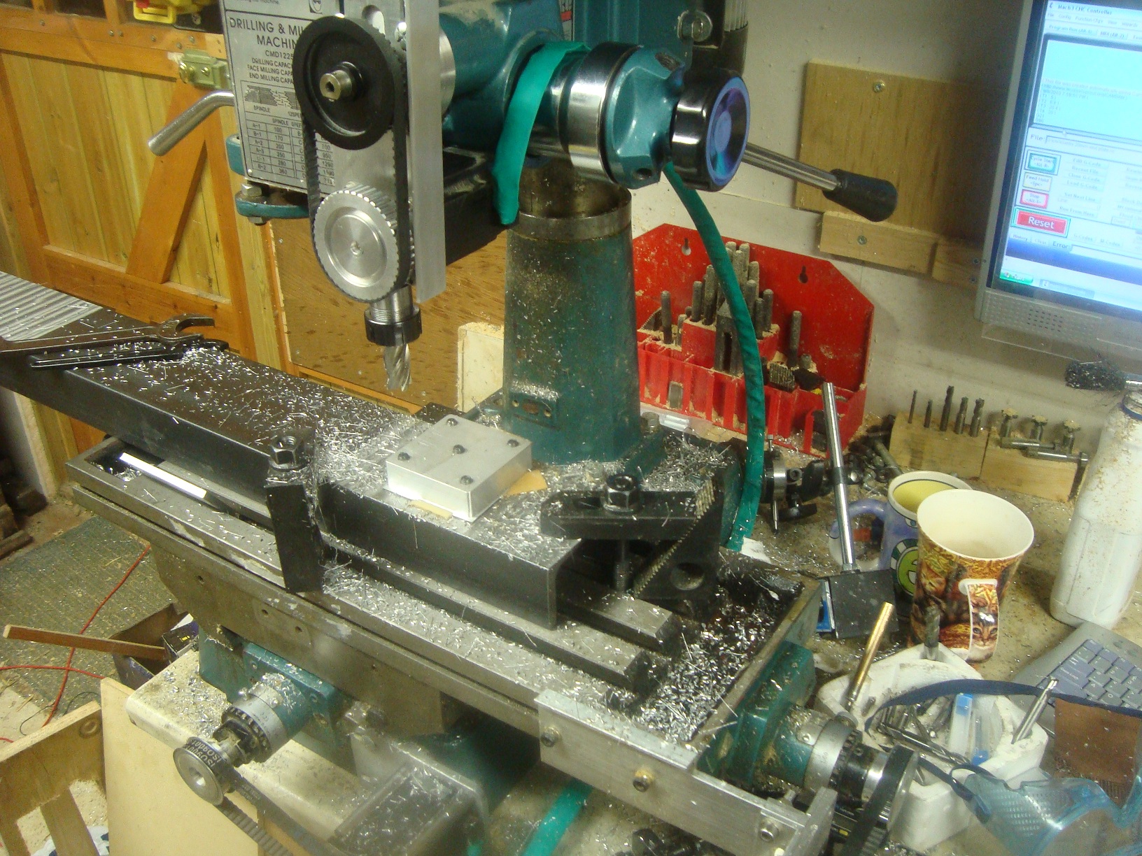

 Back to the main build.
 I went into school today. Their laser cutter had arrived over the summer...it's huge! Only 80W but still useful I guess.

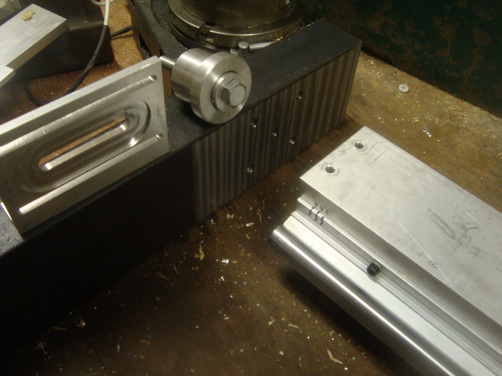

 I milled the 600x160x20mm Z axis plate square and drilled and tapped a couple of holes to bolt the rotary table to it for when I want a 4th/5th axis, not that that's very likely since I can't afford the software.
 I also cut and milled the steel gantry sides square which took much longer than anticipated. It's not a nice grade of steel to mill.... Started milling the surface flat on either end to make a better contact between the gantry cross piece and this. I'm putting a piece of 20mm aluminium plate in both ends of the 80x80 box section to make a good strong joint.
 Photos coming soon!

 I'd need to draw it out and look at the angles and forces etc. , but I suspect that the bearing jumping would occur on any length of leadscrew.  If the bearing is mounted in a sort of gimble as you have shown and held against the screw thread via a spring, then if you push the leadscrew it will try to rotate (not spin) the bearing about the gimble pivot axis against the spring force, and ratchet the bearing over the screw threads.  A bit like a handbrake ratchet on a car where the pawl runs over the teeth against the pressure of a spring.
 If you zoom in close to the exact point where the bearing contacts the thread you'd see an inclined plane sliding under the angled face of the bearing.  When the inclined plane of the thread moves forward (either you pushing it or the action of the stepper rotating the leadscrew) it will push the bearing upward and away.  If it pushes the bearing far enough away it will jump a thread.
 Anyway, I was thinking of a way around this and was thinking about a setscrew with a small rubber buffer on the end, but your belleville washer is similar and neater.  Hope it all works out because it's a nice idea and will save some cash.  I went with 3 ballscrews for the fit-and-forget method, but it was not cheap.

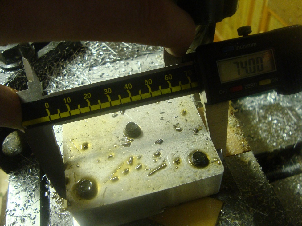

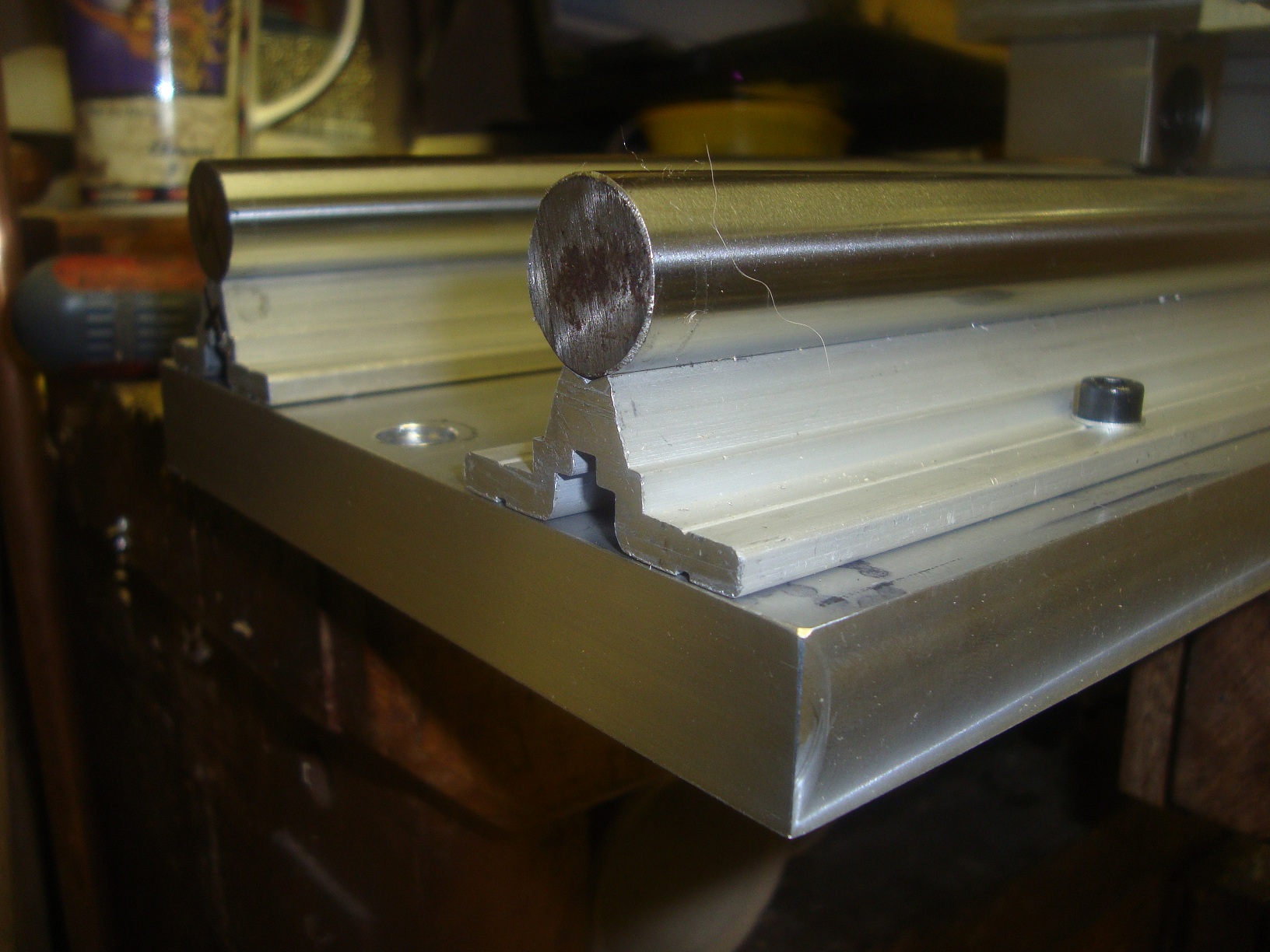

		2 Attachment(s) Re: 1.7*0.74*0.4m Mill / Router building...
There's a big thread regarding this idea on CNCZone...  seems some have used it successfully and theres a commercial offering based on the idea.
 Yes I spotted that. There's two threads, one quite short one about the method I'm using and one huge thread about roller screws which is another story entirely. I may well try making a roller screw if this method doesn't turn out so well.

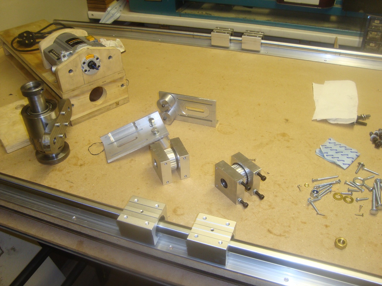

 These photos wore taken yesterday:
 Pretty self explanatory - Z-rails are bolted down and really smooth.
 Attachment 2963
 I milled the alu plate square at school, shiny! Never seen such a good finish on aluminium - must be the grade.
 Attachment 2962
 Today I've milled the gantry sides flat at either end and drilled them. Also had to nip a few mm off the end of one of the Z rails. I was a bit worried with it being hardened, but it milled OK taking small cuts. Plenty of smoke...
 Also started machining the M16 rod for the Y axis.
 I'll post some more photos tonight.

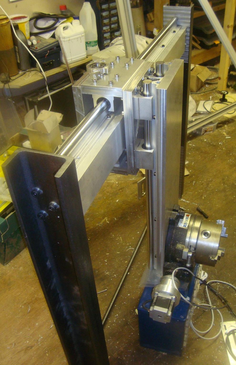

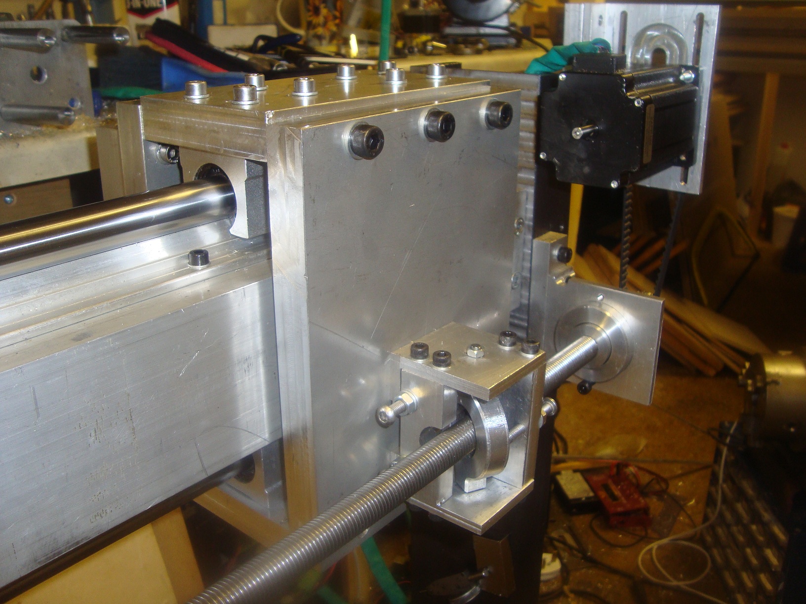

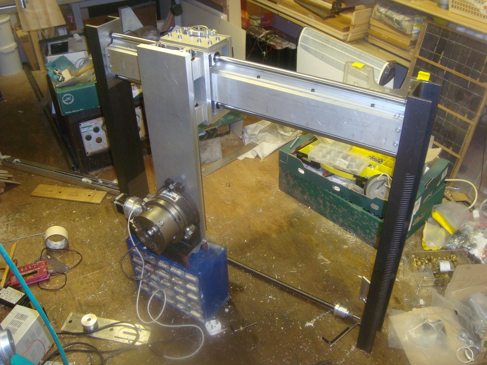

		6 Attachment(s) Re: 1.7*0.74*0.4m Mill / Router building...
		Some more photos ...
 This is how the gantry fits together.
 Attachment 2976

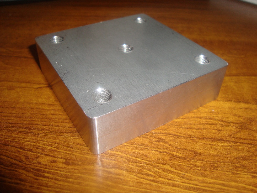

 Detail of gantry sides. I've milled them flat etc. Unfortunately I drilled those 5 holes (for M8 bolts) in exactly the same place on both sides, forgetting that the other one is flipped over! Looks like I'm going to have to mill those 5 holes on one side to move them across by 6.5mm...dow!
 Attachment 2981

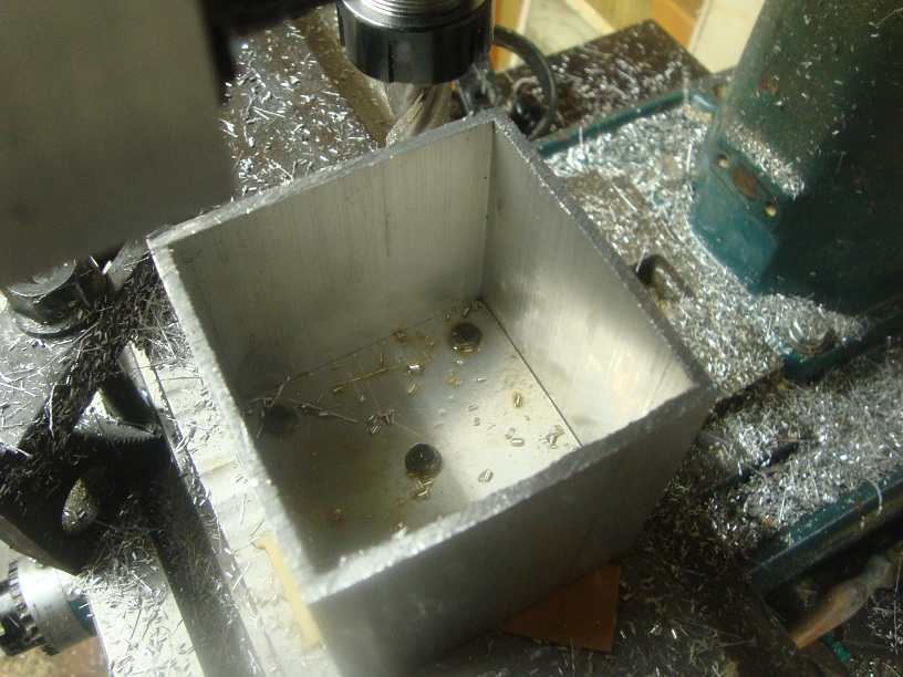

 Just after milling block to fix box section to gantry sides:
 Attachment 2977
 It fits!
 Attachment 2978
 Pretty accurate too :smile: I sawed the plate to roughly 80x80mm then used a 20mm 4 flute endmill to cut it to size. I used 2mm cut depth and 1000mm/min - no problem at all! I'm sure I could have gone faster or cut deeper since it didn't get hot. I then did a single finishing pass taking off 0.2mm at full 20mm depth and 300mm/min.
 I'm very pleased with the accuracy seeing as this is with trapezoidal screws and using backlash compensation. I guess the brand new cutter and having set the backlash compensation values to the nearest 0.002mm a few days ago helped.
 Attachment 2979
 Shiny :)
 Attachment 2980
 Just a shame I didn't measure the box section beforehand and relied on the sellers dimensions. Turns out it's more like 74.6mm, not 74. I think it'll be ok though...
 I'll post a vid of that latest bit of milling when I've compiled it.

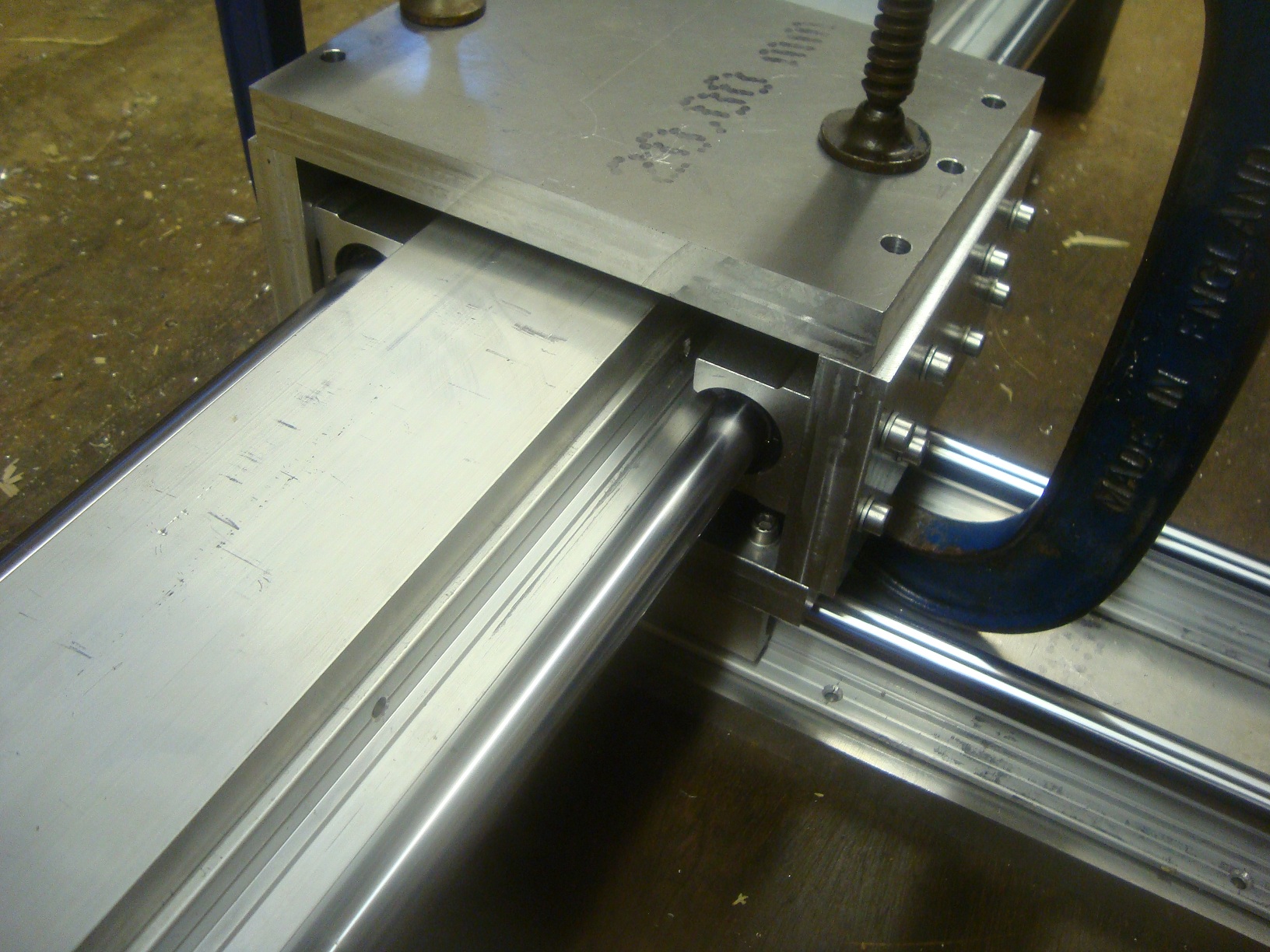

		http://www.youtube.com/watch?v=iC7lXNTPYrg

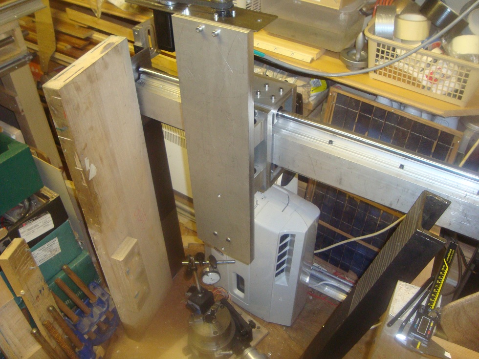

 Some progress today. I made another of the above part and assembled the 50kg(!) gantry, then assembled it:
 Attachment 3047
 Attachment 3048
		Not much backlash!
		Success!

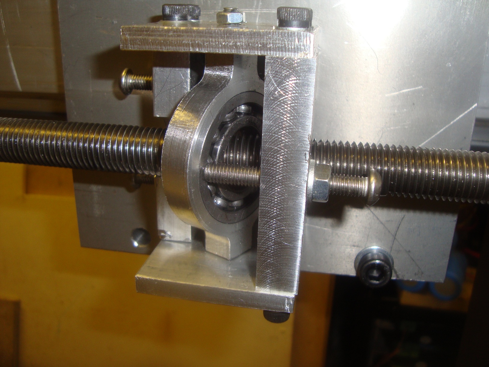

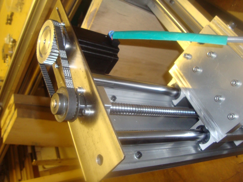

 I made the mount for the angled bearing thingy on the Y-axis. I'm not using springs/belville washers at the moment since I don't have any...yet. Currently it's just a few bolts pushing the bearing onto the screw at the right angle, but it seems fine!
 So about an hour ago I clamped the motor mount and just the bearing for the Y screw at the motor end onto the gantry using G-clamps and mole-grips :whistling:
 Motor is half stepping, 42T pulley on motor and 28T on the 2mm pitch screw. Currently I can just get 3600mm/min rapid feed but I'm sure it'll be more if I use a smaller than 28T pulley and mount the bearing on the floating end of the screw. Still a respectable amount though I think?
 Anyway....backlash: 0.006mm :exclaim:
 I spend about an hour checking that figure so I'm pretty confident it's right. I was using a 0.0001" indicator and the reading averaged 0.25 thou.
 I think I'll settle for that :rofl:

		Got the motor and bearings fixed down properly on both ends of the Y screw now.
 Been experimenting with the pulleys. With 42:13 I could get 6000mm/min, but that's above the critical speed of the screw as calculated by Irving's spreadsheet, and yes it started whipping at that. So I tried 28:13 and got 4800mm/min (maybe 5000), which seemed pretty smooth. Acceleration currently 800.
 I don't think I'll use the 42:13, Irving what do you think would be best if you don't mind working it out? I've got plenty more pulleys to experiment with. The motors are the 3N.m ones from Zapp moving an 18kg Z-axis.
 I know it's a balance between high rapid feed and having sufficient torque for cutting, but it's difficult to work out where this point is since there's so many variables!
 I measured the backlash again, and got 0.01mm this time...
 I'm not sure wether to tension the screw or not. It wouldn't be too difficult to tap a hole in the end and use that to tension it with a thrust bearing, but is it going to make much difference if I stick with less than the current critical speed?

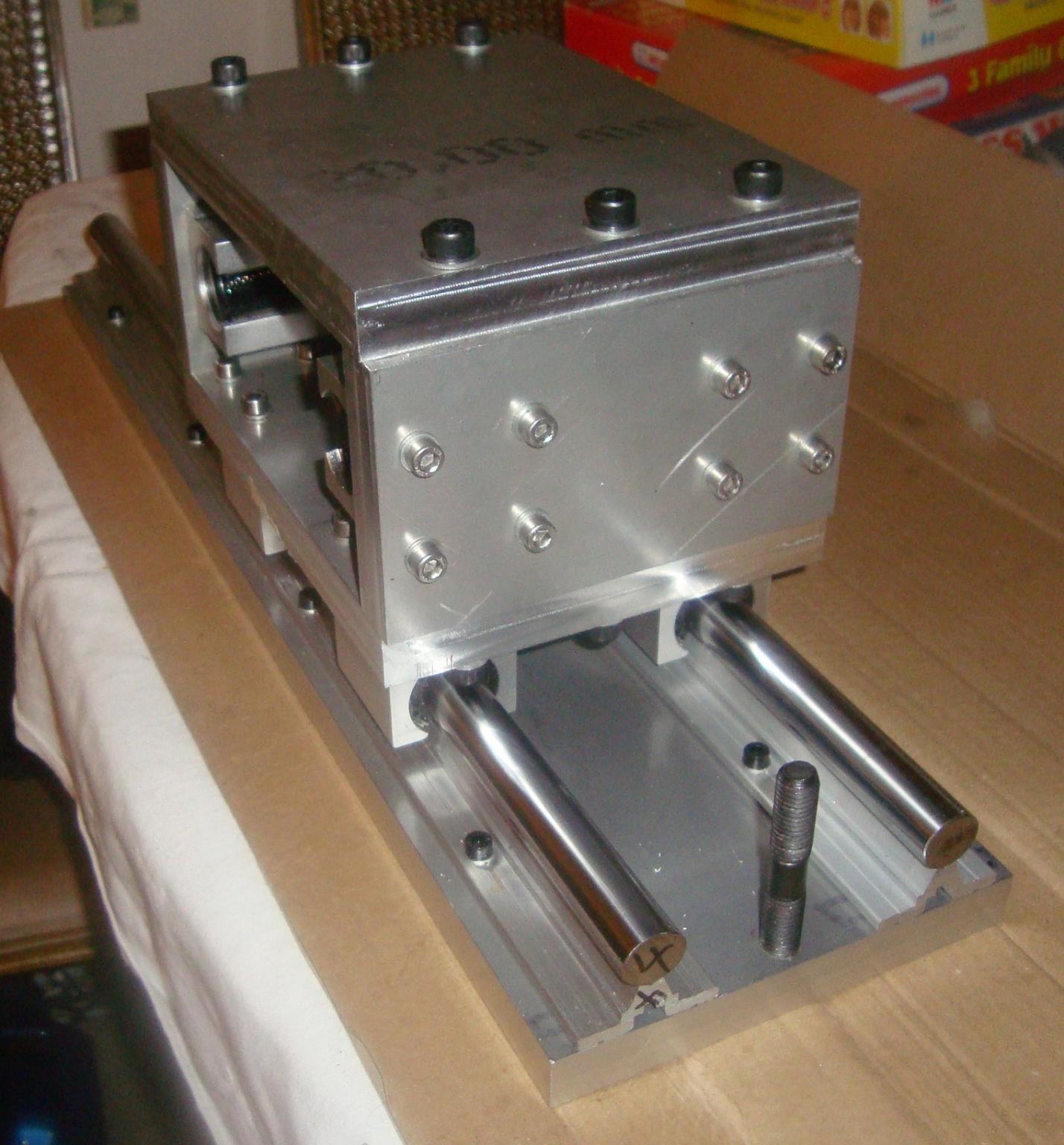

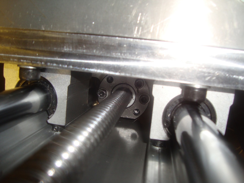

		4 Attachment(s) Re: 1.7*0.74*0.4m Mill / Router building...
		Irving,
 Thanks for those instructions - I'll do that at some point when I've got the whole router together. Thought I'd done my last physics practical :lol:
 Some photos...
 'Nut' I may well add springs/Belleville washers.
 Attachment 3116
 Attachment 3115
 Attachment 3117
 Attachment 3118

		Been at university recently so have not had much chance for router building. I came back on a couple of weekends and made a few bits - stepper motor mounts for X-axis and bearing mounts also for X-axis. I decided to scrap the latter and buy two SBR25-2000mm rails, which have now arrived. No customs charges either :smile:
 Also had a change of plan with the Z axis. I couldn't get the drive mechanism I've used on the Y-axis to fit at all easily, so I decided to go for the easy option and bought a RM1605 ballscrew at the same time as the above bearings. I got back for Christmas holidays on Friday :smile: and on friday/saturday CNC milled the bearing mounts and ballnut mount for Z. One angular contact bearing at the stepper end of the ballscrew, and a normal bearing on the other end.
 Somewhat randomly I picked a 42T pulley for the stepper and 22T for the ballscrew, so effectively the pitch is now 9.545 mm. PM752 driver with 3Nm motor as with the other axis and I'm getting 10,000mm/min :smile::exclaim: with 1000 acceleration. That means only 2.5 seconds to travel the whole 400mm Z axis. I might try some other pulleys/ratios but that can wait until I've done the X-axis and found which of the pulleys I have is most optimal...

 Gantry with Z mounted:
 Attachment 3478
 Z ballscrew bearing mount:
 Attachment 3471
 Bits left to fit + old Z and 4th axis:
 Attachment 3472
 Top of Z axis with stepper, 42:22 pulley:
 Attachment 3473
 Ballnut, can just about see the mount:
 Attachment 3474

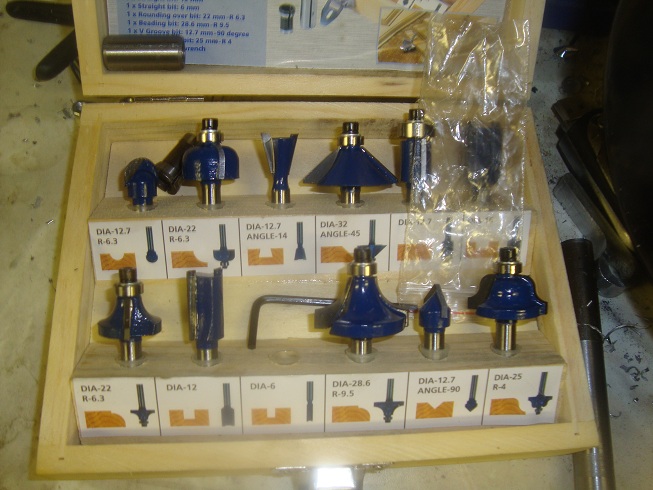

 Router bits from Aldi, very cheap:
 Attachment 3475
 Another view of Z axis:
 Attachment 3476
 Finally the whole router:
 Attachment 3477
