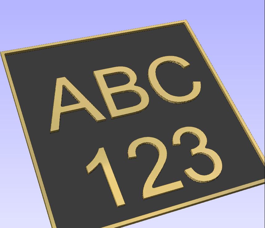

Like this ?
Attachment 2946
Just did this in Vectrics Cut2D
http://www.vectric.com

You can model and create a dxf then bring that into Cut2D or do as i did, define a shape, in my case I guessed 250mm x 250mm x 6mm thick.
then chose Arial text 70mm high , did the ABC bit. Then swapped from CAD to CAM and chose a tool and depth, calculate and job done.
No the eval download will only create code for the samples with the program, loco wheel, con rod and the badge that's there.
