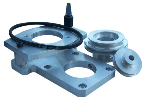

any one know where to get a belt drive convertion for x2
Hi guys just had my gearbox go my mill got no hi / low was working then made some
funny sounds then it stoped thought it would be the nylon gear on top but no thats in mint condition lol
going to strip it down tomorrow to see whats going on it a Xj9512 mill china thing i think lol
basicley a variants of the X2
looking for a belt drive convertion at a cheep cheep price broke lol
would make it my self but dont have a lathe to make pulleys

George,
The pulleys have to be specific sizes and bores to fit the machine, stock pulleys won't fit and the guy doesn't have a lathe............................................. .......
Re: any one know where to get a belt drive convertion for x2
There are different bore sizes on almost all the pullys in RGD site ie same size pully but with different bores.

Right he needs two 2 step pulleys one bored 9mm and one bored 1.180" and keywayed, remember, no lathe............
Yes 1.180" x 25.4 is equal to 30mm, the original kit was designed in the states hence the imperial measurement.
Here's a picture of the main pulley, so you'll see it's not an off the shelf item.
Attachment 3146

There is a kit on Ebay at the moment but it's £70 and 6 days to go, 5 bids.
You can get one from the States, buy it now for £69 quid and about 10 quid P&P.
i think i will just fix my lathe and make a simple pulley arrangment for my mill i think its better in the longrun rather then replacing the gears
i think i could do it cheaper than £70
