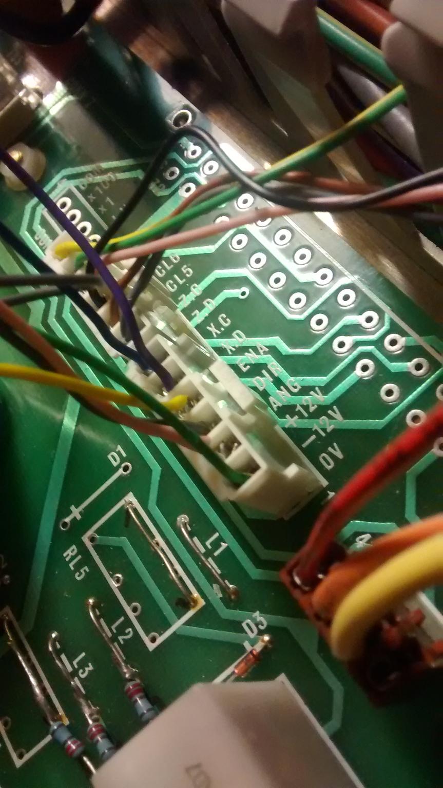

I have taken a photograph showing the board I have retained (mainly as it has the drives attached). With regards 0v, 12v, -12v, Ang, Dir, Ena. I believe these are all specific to the Spindle. My question is does anyone know if I can connect them directly to my BoB. I have worked out if Enable connector is 12v supply and when connected to the wire on the Lenze it starts the Spindle motor. I have also worked out that if you connect the 'dir' wire to 0v that also kicks the reversing relay.
Any help on how to wire to my BoB would be appreciated as struggling now. If you look in the photo XD, XC, ZD, ZC and CL5, CL6 are all the step, direction for the x, y, z axis which have all connected straight to my BoB.
PS. I have a PMDX-126 BoB and PMDX-107 Isolated Speed Control board although I am not 100% sure I need the 107 board.

Hi Steven,
You will need the 107 board has it provides the 0-10V analog voltage source. It also provides you with couple of Solid state relays to Control Run and Dir.
(thou strictly speaking these are not needed and you could just use normal outputs.)
I'm not expert on these Boxfords but I'm pretty sure that the +12v & -12V are not for the spindle speed unless the lenze needs analog + & - voltage for speed control and direction.? I think not thou.!!
Personally I think you would connect the Aout on the 107 to Ang and Agnd to 0V thou often the 0V usually as some ref to Analog Gnd like "Ana 0v".?
The Enable and Dir would just be controlled via the relays.
What Card is this your showing.?

Hi JazzCNC,
It's showing the original Boxford card that has my drives attached. However I may move away from this when money permits but at the moment it would be nice to get the machine up and running even if it is slow. I was hoping I could use the machine to mill out the spokes on clock wheels as it takes me ages to cut and file them by hand.
Steve
Re: Boxford 190vmc upgrade
swood1
Ok I didn't think that was the Lenze board and the reason why I asked.
Can you show the Lenze board and it's connections.

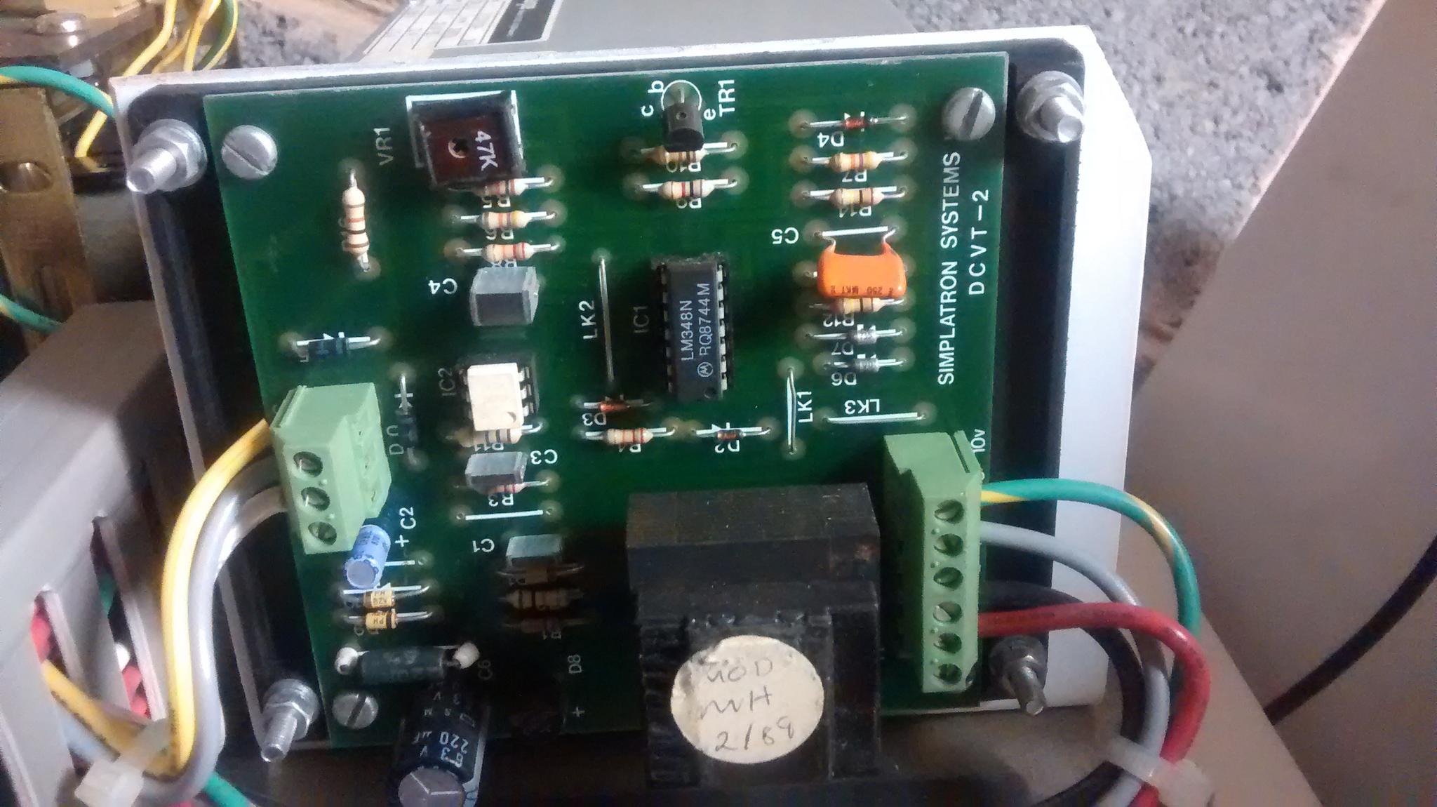

3 Attachment(s)

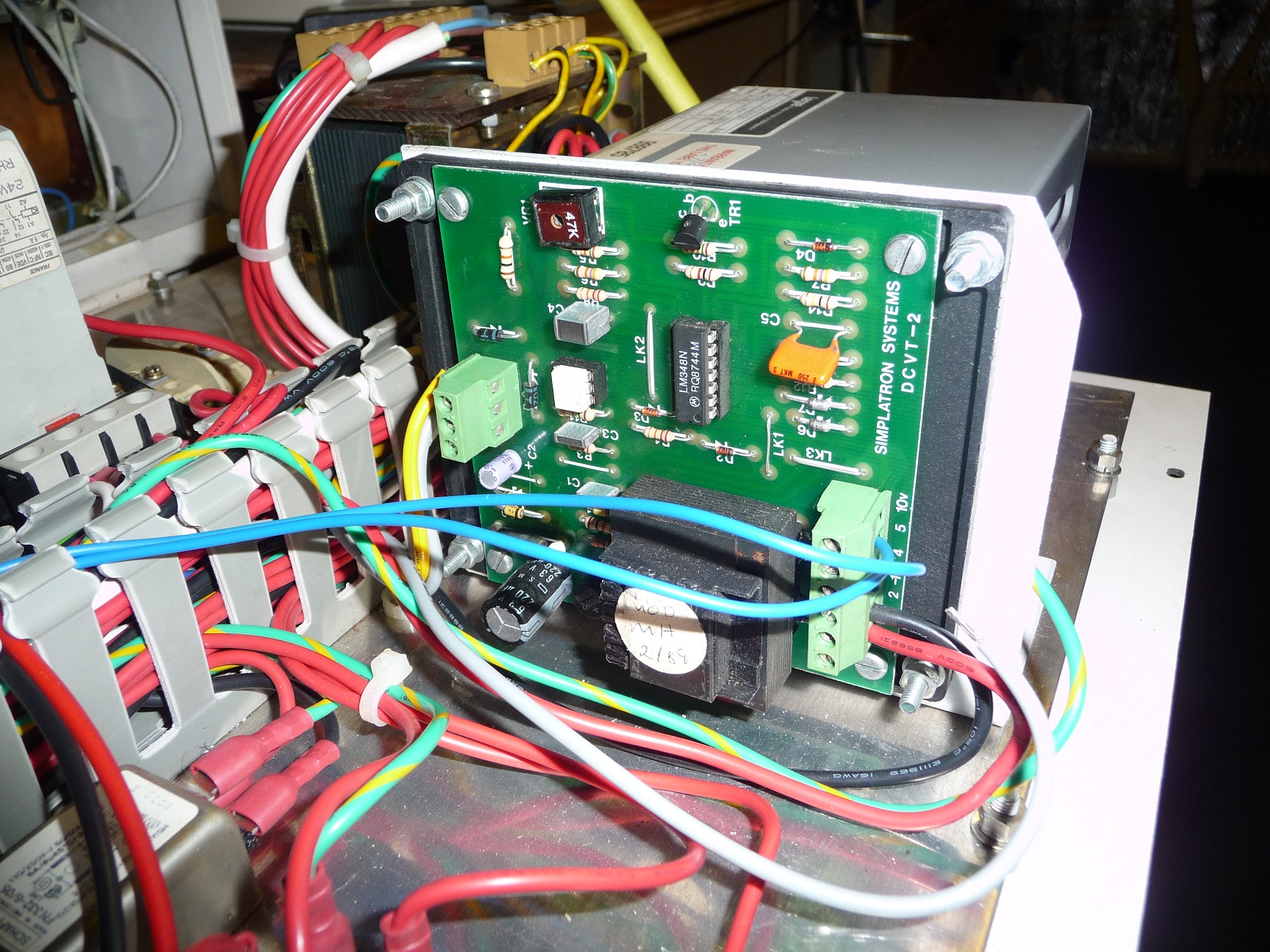

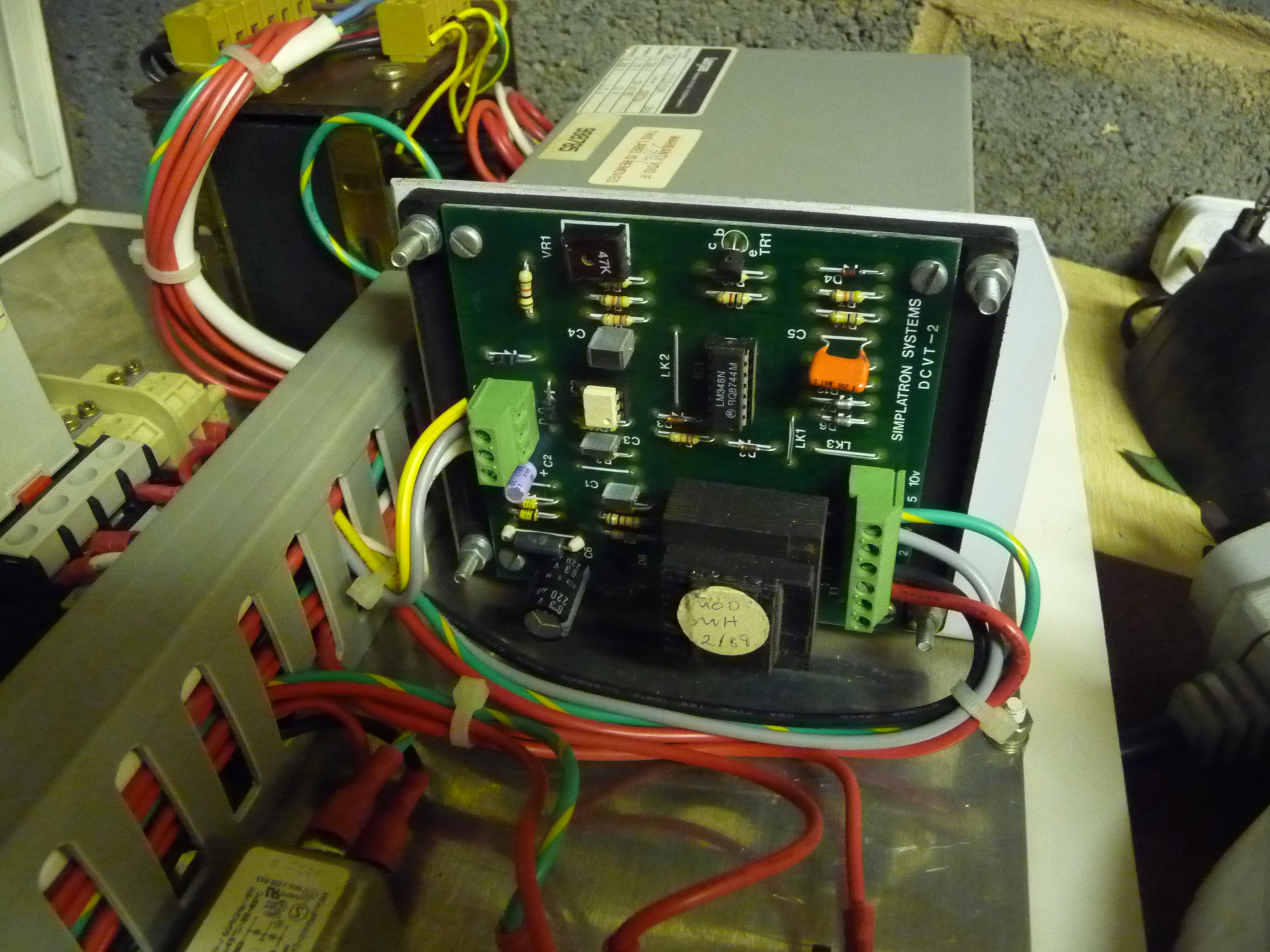

Hi attached are photos of a board attached to the Lenze with connections (which I assumed was doing the job similar to the 107 board ), I assume I should by pass this board and wire straight into the Lenze. I have also attached a photo showing the side of the Lenze with it's connections. The Lenze I have is the 534.
Attachment 16330Attachment 16331Attachment 16332
swood1
No if I remember correctly from helping Keith with his lathe this board is where you connect the 0-10V and Run signal from pmdx 107. Those 4 wires on the right are 0 & 10V and the + & - Enable for Run.
The Direction is changed by the Relay swaping the polarity of the DC spindle so you control this using the Dir relay on the 107.
Edit: Just be aware you will need to set Mach3 up so there is a pause for spindle to come to halt before reversing output is set other wise damage will be done.
Are you talking about the green board?
If so the connections on the right read look to read 10v, 5 (i assume volt), 0v, -10v. For some reason the machine was originally wired up using only the 5v and 0v connections. The bottom two wires are black/red for 240v ac. The Lenze seems to have a seperate 240v supply.
swood1
Yes the green board.
It's not unusual for some speed controlers to use 0-5V and the Pmdx 107 has this feature if required. However It's more common to use 0-10V.
The Lenze controller can obviously use either.
Agnd on pmdx 107 goes to 0v and Aout to 10V. By default the 107 outputs 0-10v so If you want to use 5V the set the Dip switches on the 107 board to output 5v.
If you want to test this with crude setup then put a 1.5Vdc battery between 0v and 10v. (Or 0-5v spindle will just spin faster thats all)
Then find the enable pins and put a NO switch on them to toggle ON/OFF.
(Warning don't do any of this wiring live has the speed controller could be at mains potential)

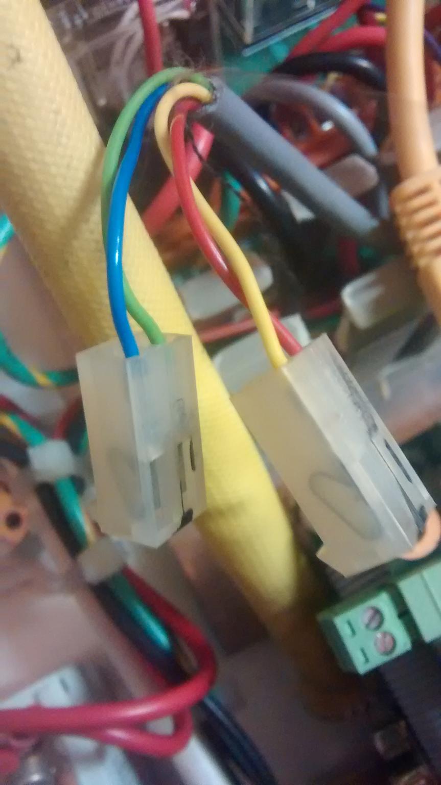

Next question for you both.
Basically there is a spindle sensor, I assume it must be required for the auto toolchanger as it used to rotate the spindle to a specific angle prior to activating the tool changer. So was wondering how I go about determining details of this sensor.
At this moment in time I have found the wires that come from the sensor (pic attached). Wire colours are blue, green, yellow and red. Is there any relevance of wire colours for sensors?
Attachment 16386

Hello Steve,
Spindle sensor is for feeding back the spindle speed or for tapping synchronisation. Spindle position doesn't matter for the toolchanger. The spindle sensor will probably have 2 wires for LED and another 2 for the (photodiode) detector. The slots in the sensor disk cause the detector to pulse once per slot. Try and read any numbers off the sensor and look for a datasheet on the net. Don't worry about the ones with 5 leads as they have a different detector. They are not expensive to change if you need to.
I can't find any details on my wiring diagrams, sorry
Has Dave says will be for spindle feed back and the colours will probably be something like this but they could be anything has well.
Red = 5v (For LED)
Grn = 0v(gnd)
Yel = Signal +
blu = Signal -
If it's like most of these Slotted Optical sensors fitted on these machines there will be 2 slotted sensors, one for RPM signal and one for Index signal wired together each with 4 pins. Model number will be something like 306-061
pin1 = Signal +
pin2 = signal -
Pin3 = Led -
Pin4 = Led +
Like Dave said you really need the switch model number.

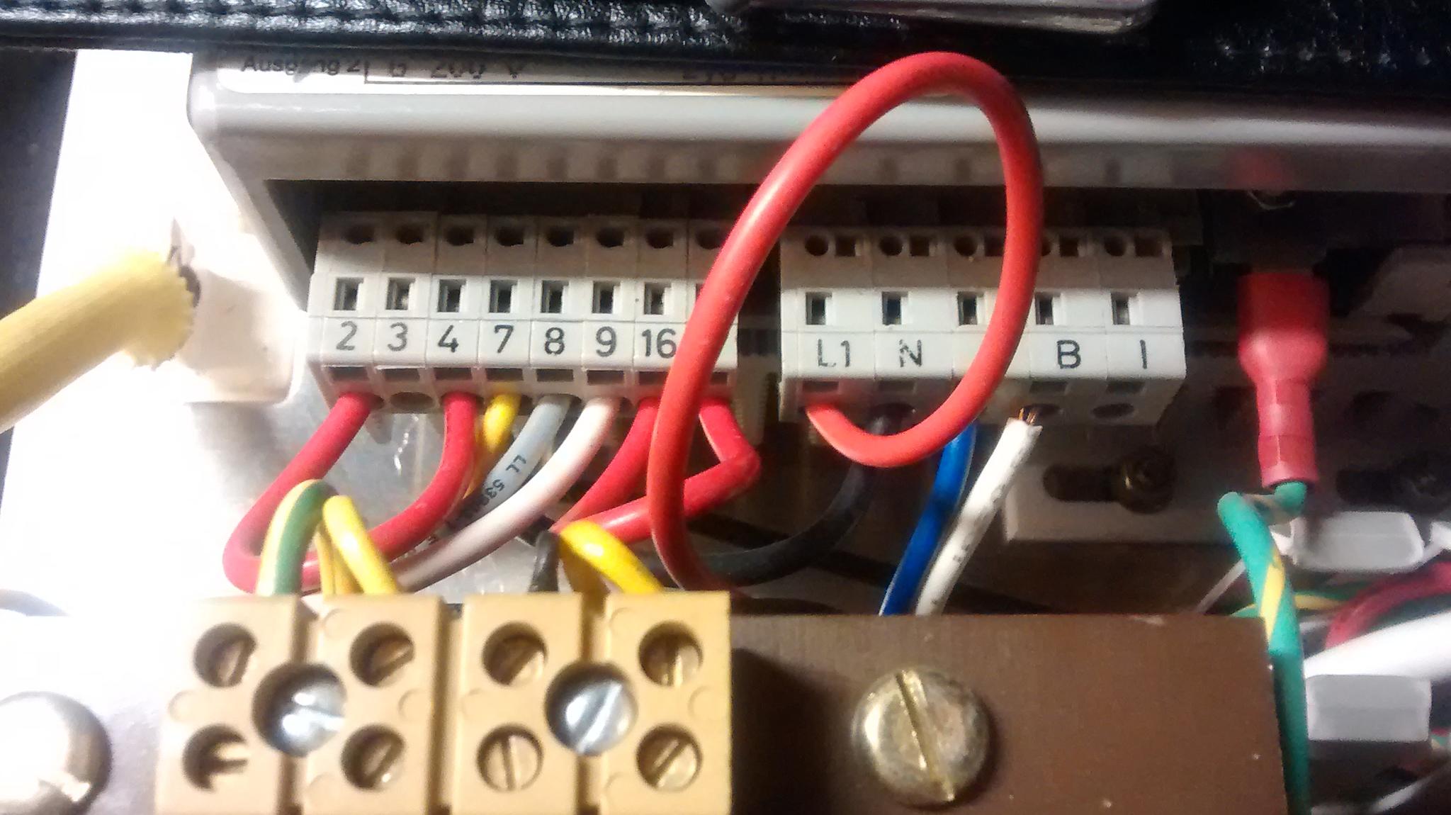

That is just the Speed control of the motor. The Reversing will be done by relays or Contactors that switch the Polarity of the Motor. You control these Contactors using the Relay OUTPUT's on the 107 board. Then in Mach3 you setup which OUTPUT/Relay controls Forward or Reverse.
The time Delay you setup is how long Mach waits before turning that OUTPUT/Relay On/off.

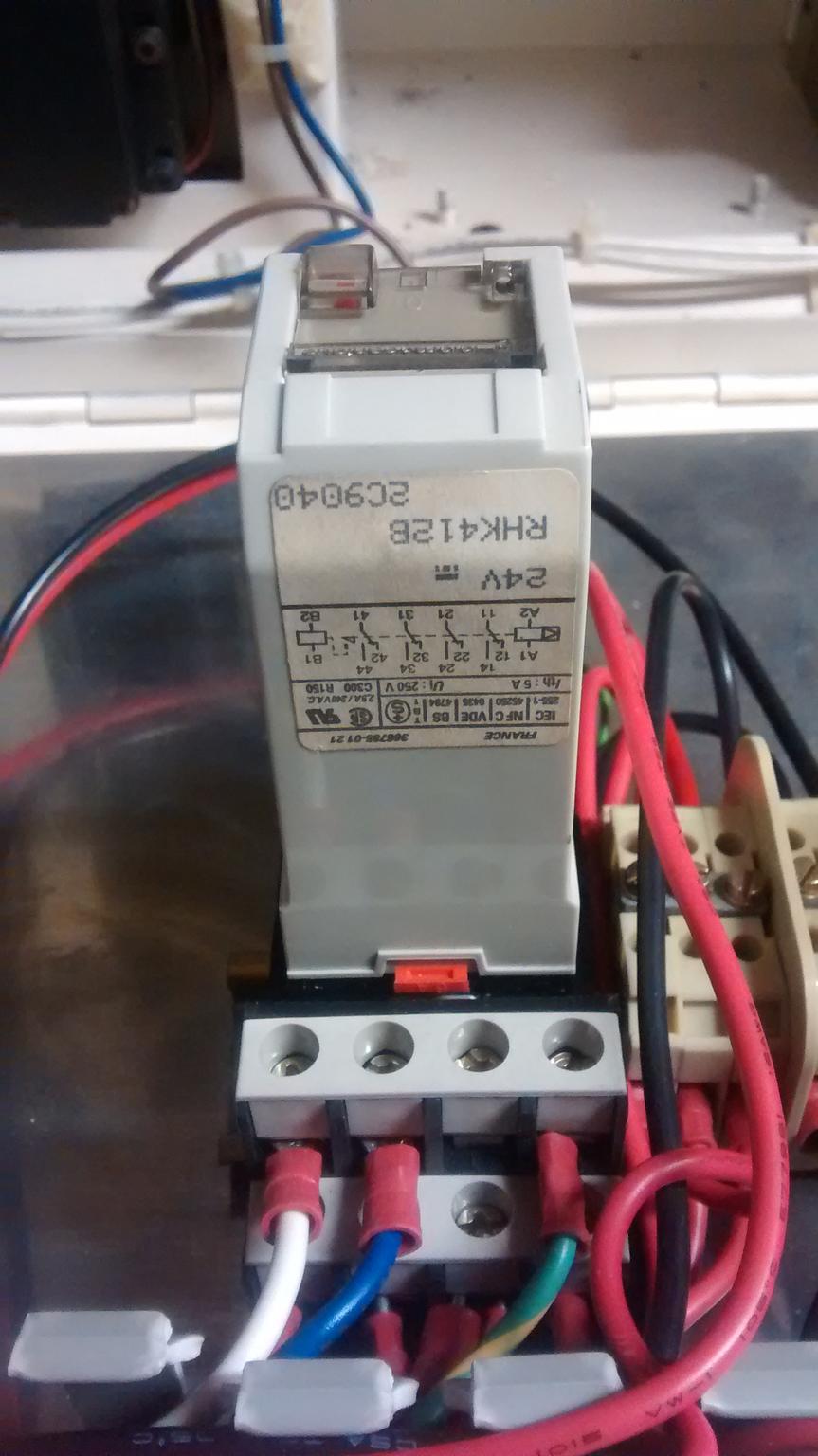

3 Attachment(s)
Hi Jazz,
I have only re-visited the setup of my machine and last week I bought the full version of Mach4 which I now have setup. You stated in your last reply that I need to control the relay to switch polarity of motor. There is a relay on the original board for which if the direction and the 0v wires are connected it flicks the relay over and initialises reverse direction, it would be great if I could work out how to incorporate this switch within the 107. So I suppose my question is should I be using the original relay off the original CNC board or should I use the relay on the 107? If it's the relay on the 107 I dont understand which wire connects to which terminal on my power supply board (simplatron). Looking at the power supply board it does have 5v and 10v but no reverse option so I assume with my current setup the only way to get reverse is via the original relay unless I strip all this stuff out the machine. I attach a couple of photos, the one shows the original wiring the other shows my new wiring (temporary blue wires). Would be nice to hear your thoughts on this.
Attachment 17394Attachment 17395
And reversing switch which works (when I join 0v and direction wires).
Attachment 17396
Steve
The white relay is switched via one of the three clear cap relay in the row
with the Lenze drive. I don't know if the middle or the right relay is for left direction. The first is, if the machine doors are closed.
swood1
None connect to the Simplatron board other than 0-10V signal. Control the White Change over relay using the 107 Relays which are controlled Via Mach3 M3/M4 switching the Outputs.
I suppose the Clear Cap relays Uli12us mentions where controlled via the original control software using standard Outputs. Your just replacing those with the ones on 107 which are just connected to dedicated relay Outputs on 107 controlled by Mach3.
the white relay RL1 is controlled from one of the 2 relays RL3 or RL4.
these two ar controlled from the main board with the large connector with 12 or so pins. Unfortunately at my machine something is wrong at the moment, the motor turns only left or only right. I must find out why, but not before next week.
