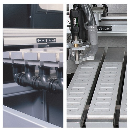

hi was it not the peg board type of stuff? http://www.panel.com/pegboard,-hardboard,-mdf--hdf-10/
mine has a vacbed the waste board according to the instruction book is made out of normal 6mm mdf, no metion of porus mdf,
its cut to the right size then theres a program to cut the holes in the right places, this is then attached to the vacbed with a few bits of double sided tape to secure it,
the work piece is put on the bed, and any surplus holes coverd with off cuts to get a better hold,

Using MDF as a spoil board on top of a vacuum table is quite common (check out cnczone.com or woodworkforums.com).
I seem to recall a recommendation of sealing the edge of the spoil board with paint.
Standard MDF is certainly porous.
