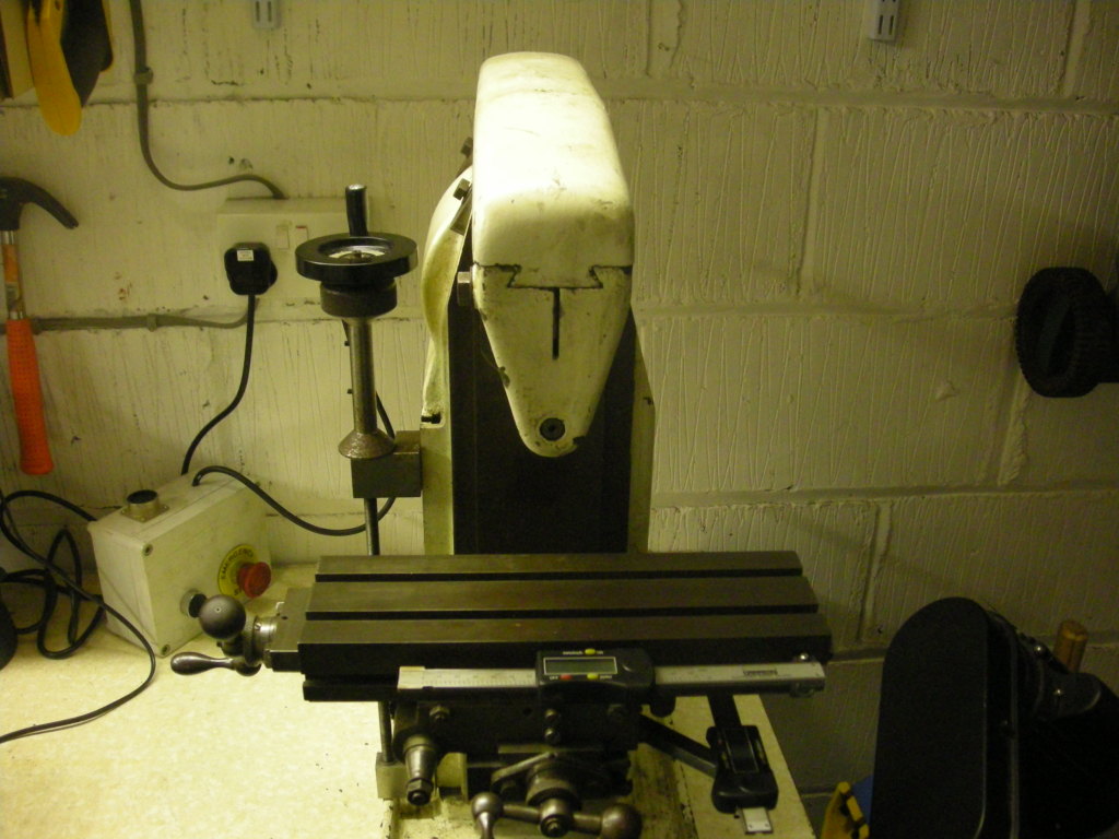

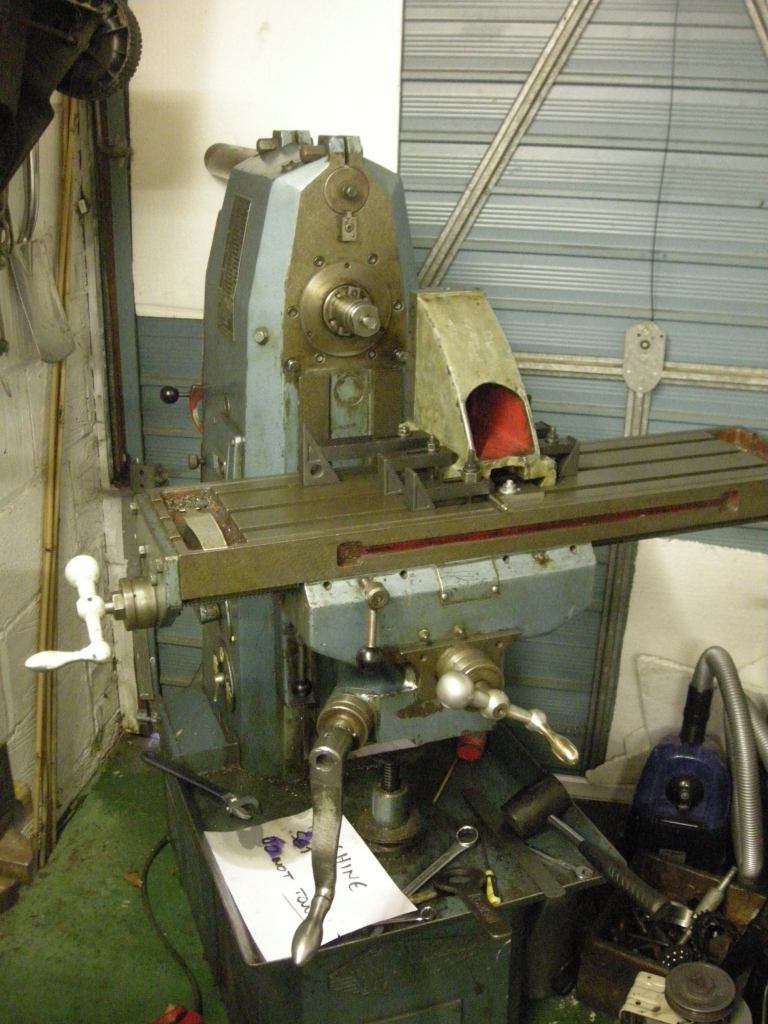

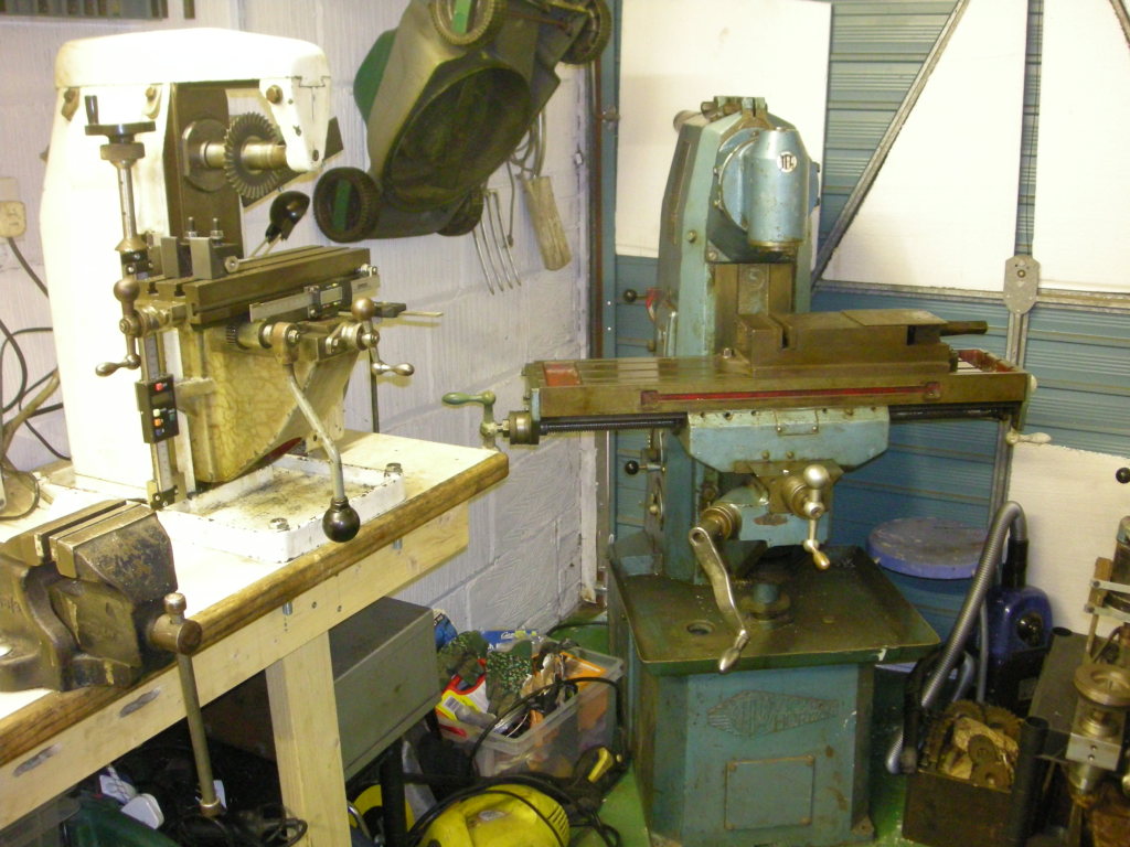

the basis of the mill is a Centec 2 horizontal purchased a few years ago for the sum of £150. This served as my mill until replaced with the AEW show in the pictures below:
Attachment 3391
Attachment 3392
This machine is very tired with lots of bed wear and backlash so the first task is to rectify this. It is also a knee mill operated with a rack and pinion system and stops. A rubbish threaded rod lead screw system has been added later to make the knee more controllable. I will have to come up with a better method to raise and lower the mill.

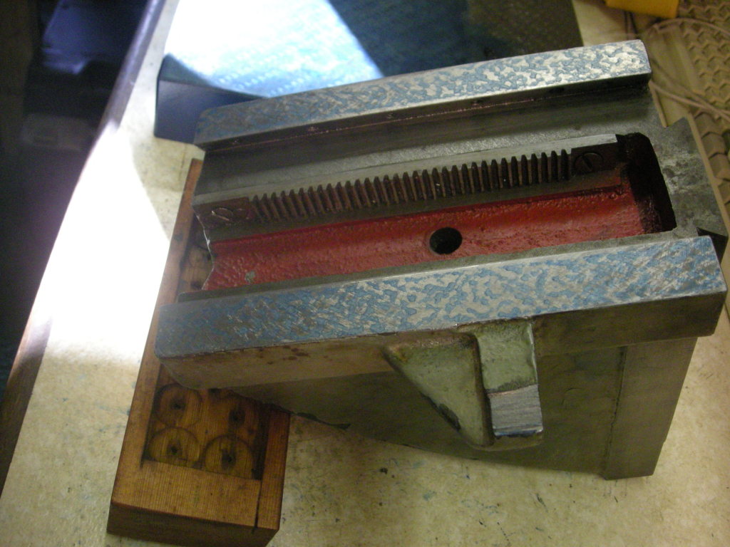

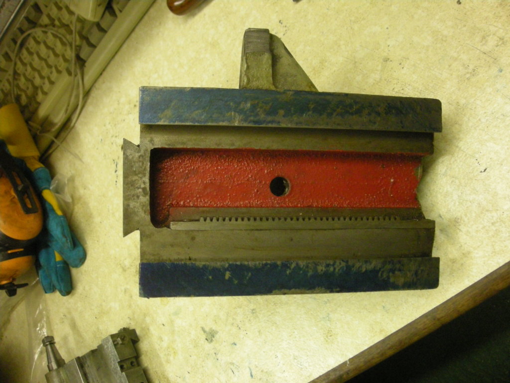

Scraping the vertical slideway on the knee (before showing uneven wear):
Attachment 3395
after showing spots per inch (note rack):
Attachment 3396

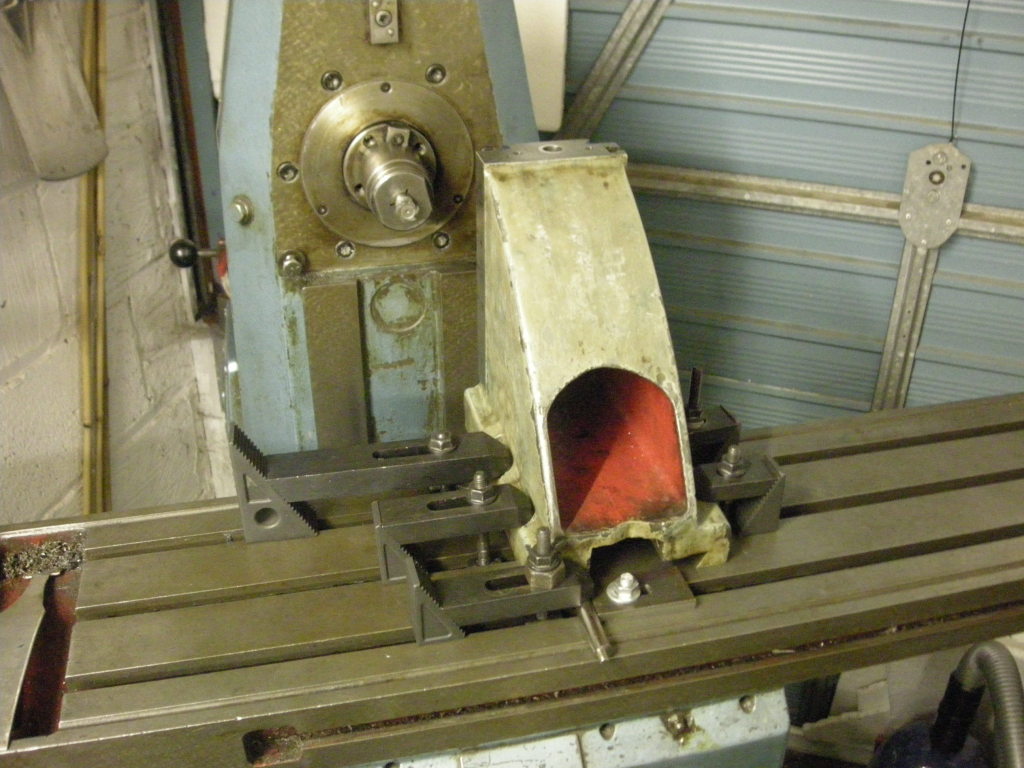

Milling the knee:
Attachment 3393
The knee was aligned to a ground rod that had already been trammed. Wear was beyond scraping on horizontal part of knee.
Attachment 3394

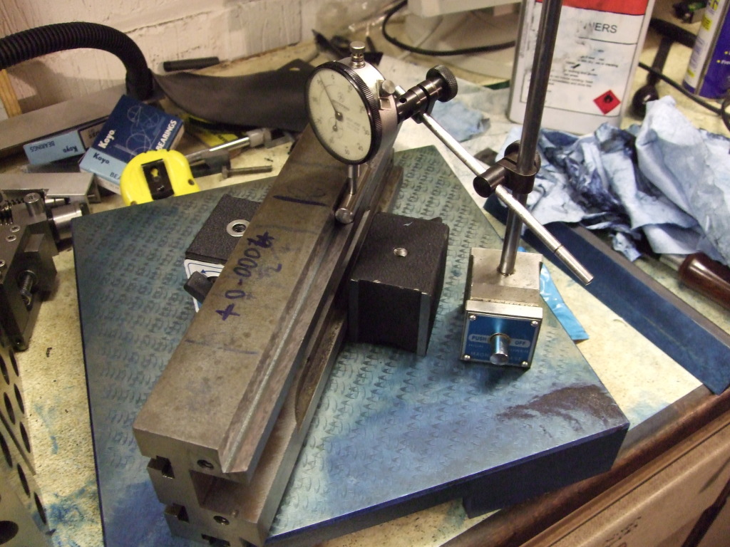

This is a shot of one of the bearing blocks being centred. I find the easiest way to centre a dot punced block is to use a more taper centre with a spring cntre as a wiggler. This does rely on accurate centre puching thought. I have recently invested in an optical centre punch which makes life a bit easier. this is on the larger harrison lathe.
Attachment 3404

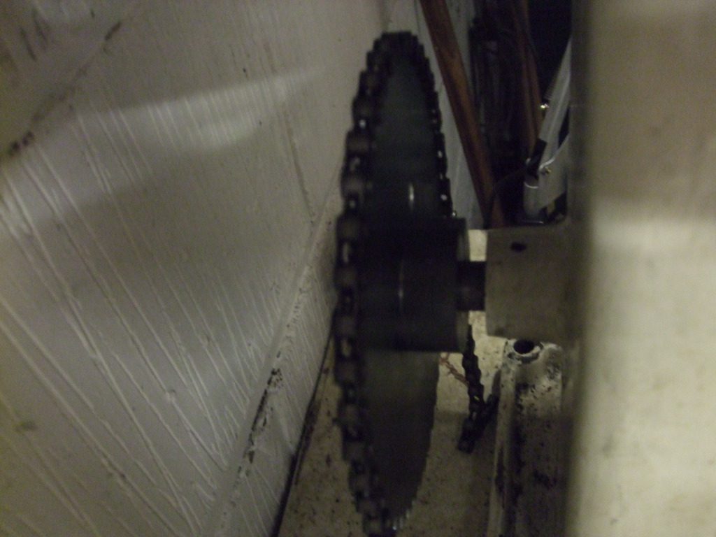

brrr its cold out there! Here are some pics of the counter balance assembly.
Attachment 3408
Attachment 3409
a weight is fitted to the end of the chain

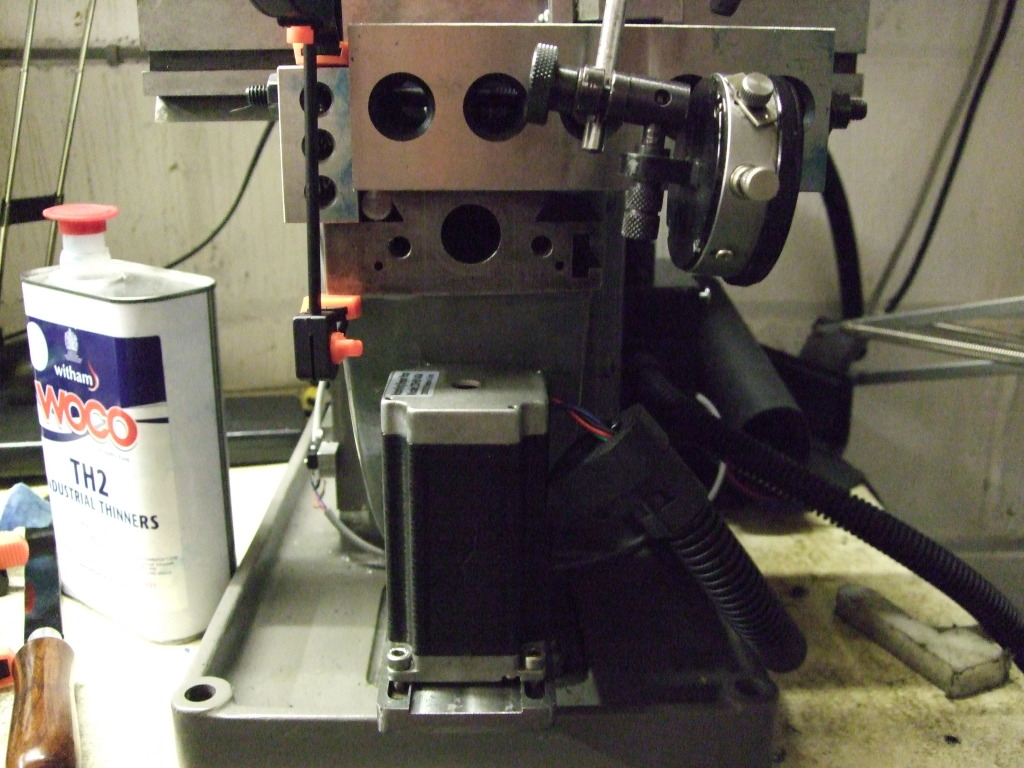

I replaced the side acting z screw with a screw that acted below the approx c of g of the knee. This resulted in a much smoother action. The stepper is geared 2:1 and as stated before the knee is counterbalanced using the original rack and pinion system using a chain wheel, chain and mass (the wiring is just a lash up to test it)
Attachment 3413
the stepper turns the nut rather than the screw. The nut is supported using two largish AC bearings. No anti backlash nut is required as long as the counterbalanced force is less than the weight of the knee. This improves the raising action significantly and it is smooth with no evidence of the crabbing action seen with the first method.
The only issue is that the screw protrudes below the base of the mill when the knee is lowered so the bench has to have a hole in it! Not too much of a comprimise for a simpler system without the mass of the stepper on the knee.
Attachment 3414
The electronics are also shown in the box next to the machine. I may add a post about this later.

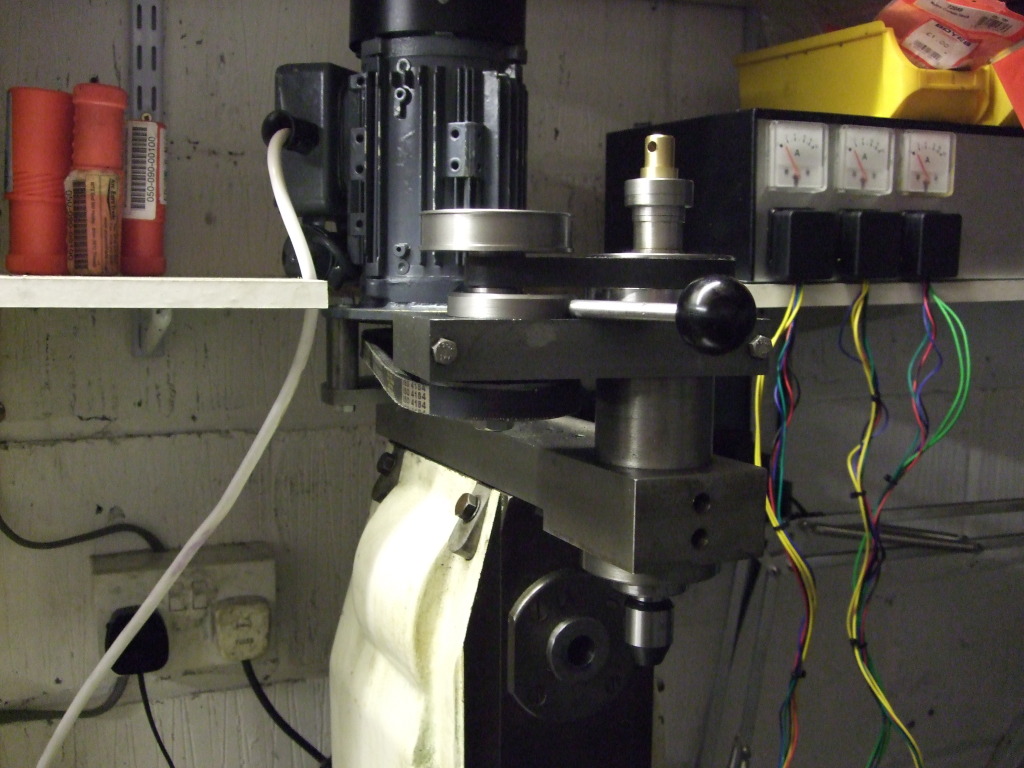

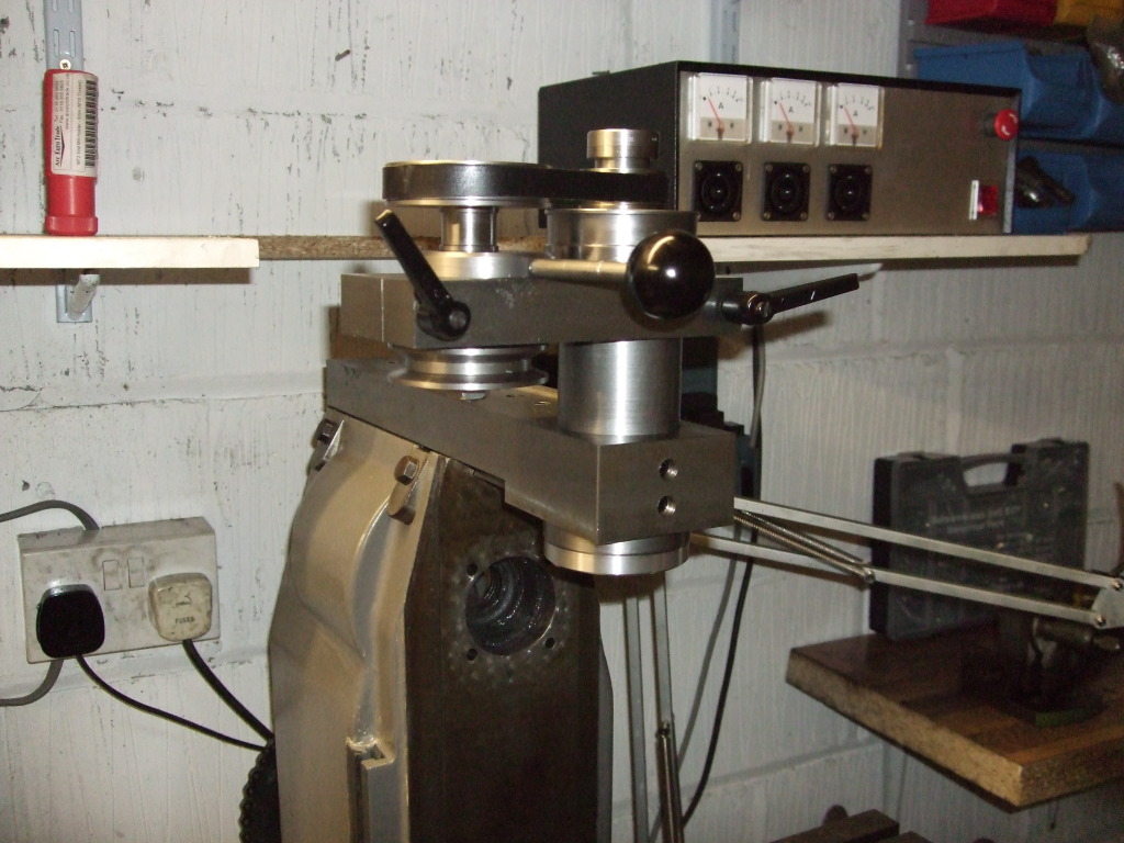

These shots show the spindle drive pulley arrangement. Tensioning of the high speed belt is achieved by rotating a block in which the counter shaft is mounted (eccentrically). The low speed (v belt) is tensioned by rotating the pulley assembly.
Attachment 3791Attachment 3789
note that no guards have been added yet but are on the list before the mill is complete.

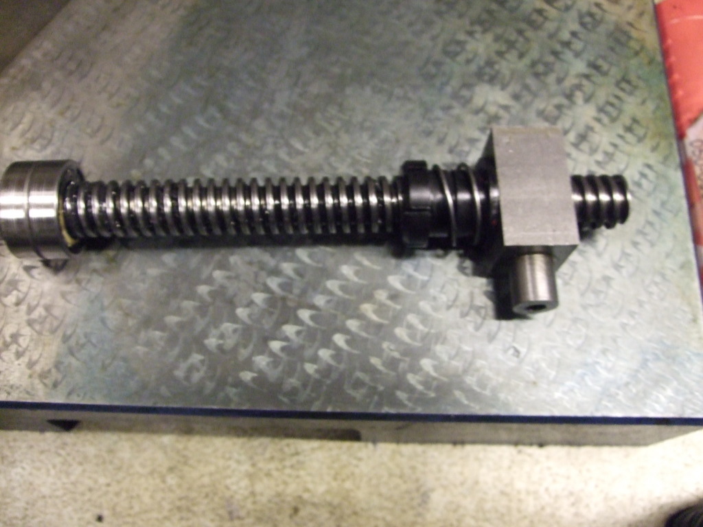

The anti backlsh seemed to work ok but I had an idea how to improve them. I modified the design so that the two nut halves are radially fixed to each other but axially free. this was acheived using 4 off 3mm rods in close fitting holes in both nut halves. The slave nut is threaded with a fine thread and an outer collar threaded on. this is biased with a tprsional spiring to take up any backlash. hopefuly this greasy sketch might help - it was used when I was machining the parts so it is not the clearest:
Attachment 3792
drilling the holes for the rods in the nut halves
Attachment 3793Attachment 3794

machining castelations in the collar
Attachment 3795
some surgery to the bed to fit the larger diameter nuts in - I love machining cast iron!
Attachment 3796
X axis nut in position but biasing spring not fitted over collar (lash up wiring shown!)

one more picture showing x axis nut
Attachment 3797

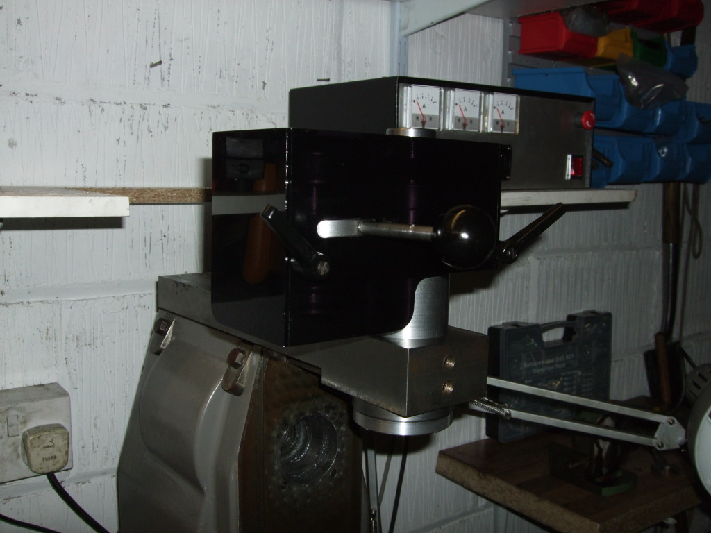

I have rebuilt the mill and painted it. Here are some pics of the z assembly showing rotating nut (not pressed in in the photos)
http://i1031.photobucket.com/albums/...mill/004-2.jpg
http://i1031.photobucket.com/albums/...mill/001-1.jpg
http://i1031.photobucket.com/albums/...mill/003-3.jpg
http://i1031.photobucket.com/albums/...20mill/006.jpg
Re: small mill for machining steel. Max spend £500 including computer

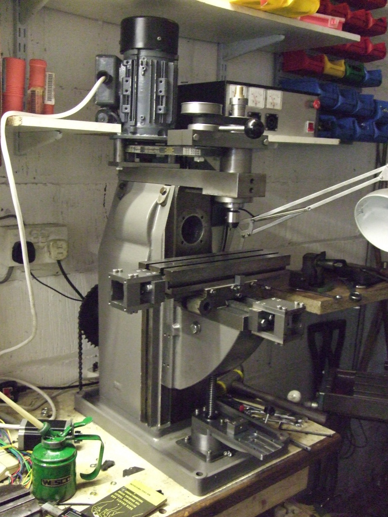

Here is a picture of the newly painted mill part assembled
Attachment 3938
Jobs I am hoping to do in the next couple of weeks:
tidy up wiring with conduit and built swarf protection for limit switches
Hi Andrew,
Looking good
How long did it take to design and build the Z axis ?
Phil
M250cnc
Hi Andrew,
Looking good
Phil
Cheers. Design was carried out during daydreaming on the train and manufacture two or three saturdays of pottering in the shed plus a bit on the computer to purchase belts and bearings etc.
3 Attachment(s)
I had my spindle running at 3500rpm and it was seriously heating up. Tried all the usual things, preload lubricant etc but to no avail. Thread on it here:
http://www.mycncuk.com/forums/showth...2074#post22074
Long story short I have rebuilt the spindle with better bearings and different seal system.
Rubber seal replaced with alu labyrinth (shaft clearance 0.0015")
Attachment 4060
I have also made a perspex guard over the pulleys. It is smoked rather than black so you can see which pulley has the belt on
Attachment 4061
without guard
Attachment 4062
I am running the bearings in and will post progress when I next get a chance:smile:
4 Attachment(s)
I fancied a change of tack so I have started checking and improving the geometry of the axes.
First check is the perpendicularity of the knee. This is the set up for the first method
Attachment 4129
Attachment 4130
This was the second method which I was planning on checking the first method with, however the results of this method were not very consistent so I abandoned it.
Attachment 4131
The results show an error of about 0.001" out of plane using the first method which can be improved with a bit of judicious scraping.
Attachment 4132
I has previously used the gound side surface of a parallel as my reference. This was not a very good reference so the next task is to scrape a reference surface. Oh joy - blue fingers over the weekend then! Once the horizontal surfaces are complete I will then check the other two surfaces of the dovetail are parallel.
3 Attachment(s)
I have made a straight edge to fully scrape in my dovetails. Before I used a piece of round plate which was not that good.
Attachment 4156
Attachment 4157
after scraping to 20-25 spots per inch
Attachment 4158

some more scraping updates:
dovetails on the knee were scraped parallel
Attachment 4499
Horizontal ways on table were scraped parallel to top of table (measured with mic)
Back way scraped to front face.
Attachment 4500
front way scraped parallel to back way using smae method as the knee.
