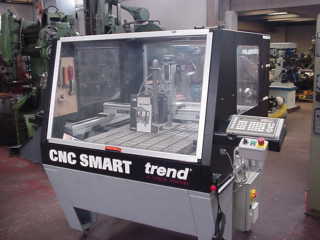

basicaly the story goes, got a used trend smart cnc, with vac bed
Attachment 3397
not had it long, done a few basic jobs on it that came installed on the pc, seemed ok worked as it should, so getting a bit more confidence I thought I would try some 3D carving, got a design of the net that used a diffrent code to what this one uses (.cnc), so thinking that the installed software (easycnc) was a little out dated, I installed mach3, set it up, zeroed the axis, started the program, all went well for about 2 minuets then nothing, thought at first the pc had crashed, but that seemed ok, so gave it about 10 mins to see if it would recover, well it never did,
now the real problems start, went to the onboard control panel to move the axis to recover the work, X & Z moved up and along no problem, Y axis was not good, the stepper drive motor screamed as if slipping, gave it a push and it moved normal for a while then stuck again and screamed, a push and back to normal, when moving a slight touch could stop it, at first thought the motor had gone bad, so to test swapped plugs with the X axis motor Y now worked as normal with full power and cant physically be stopped, X was totally dead,, put the plugs back to normal and was back to being weak and screaming,:cry:

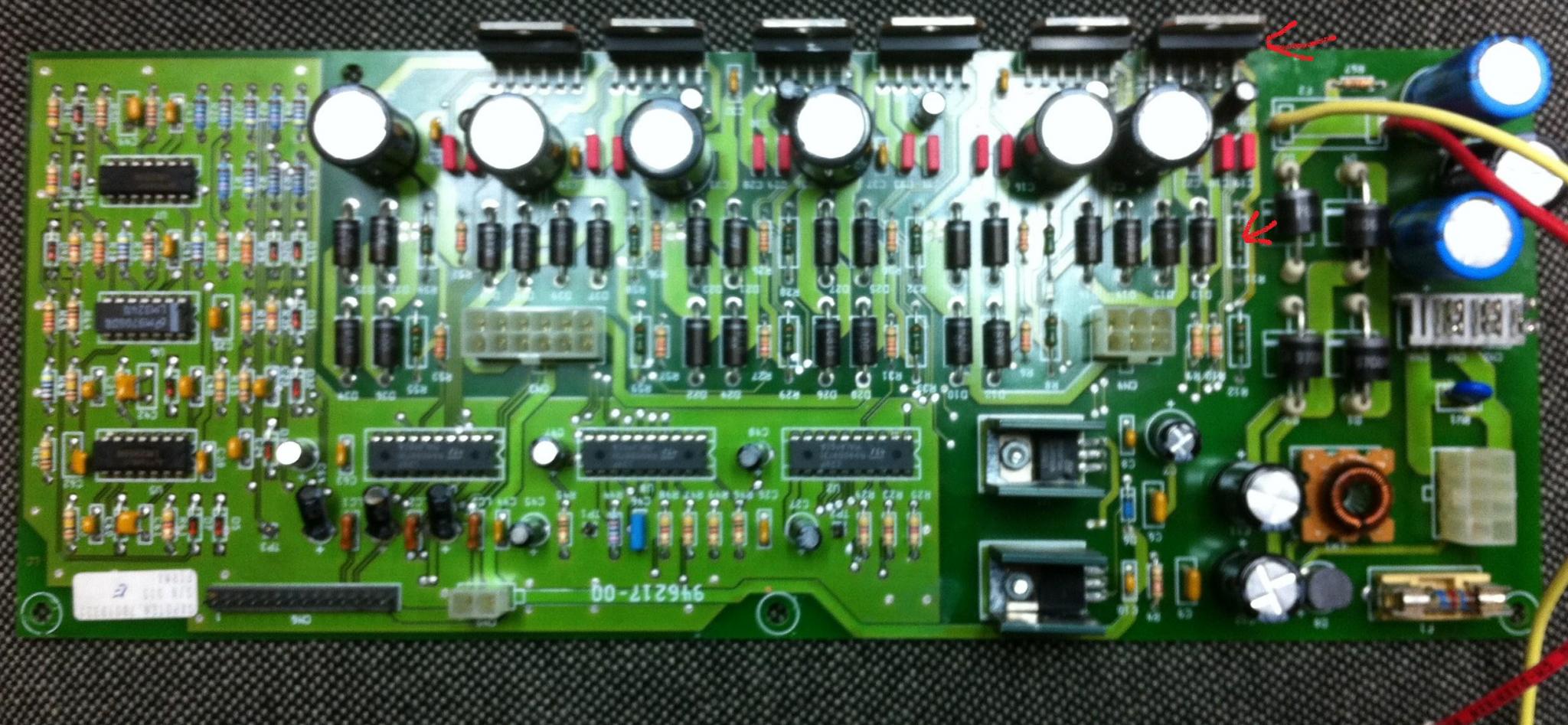

well I took the covers off to have a look inside to check fuses and connections and saw a couple of transistors had blown 1 ( L6203 0-48VDC motor controller) and 1 (BDW93C 12A darlington transistor) so being fairly handy with the soldering iron, I thought why not have a go replacing them, anyway ordered bits and replaced them, but when put back together I still had the same faults, so thought there must be more damage to the board that cant be seen, so i left it, had another look at it today and went over with a test meter and found another resistor that wasnt working, so a quick trip to maplins and a bit of soldering and its back up and running,:dance:

here's a photo of the board robin, arrowed are the bits that blew, plus a Darlington transistor that was on another little 2"x2" board that was joined to this by the yellow and pink wire,
don't know if there's diodes or not, didn't know what the other little bit was either, but the lad at maplins said something about resistor,

The line of black items 3rd row down are the flyback or catch diodes... therefore the issue probably wasnt back-EMF spiking but decelleration surge... that makes more sense if other parts died that are not directly related to the output transistors.... of course all has been stressed now... so budget for a new set of drivers sometime...
