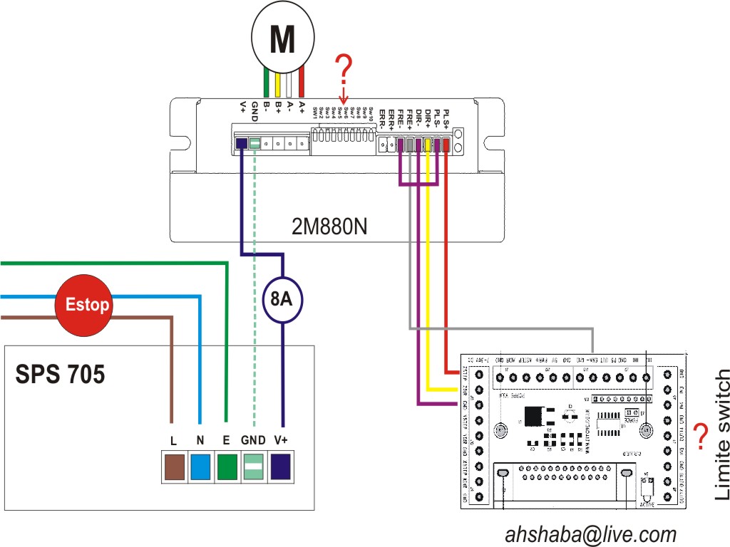

I need someone to fix and finish my wiring diagram

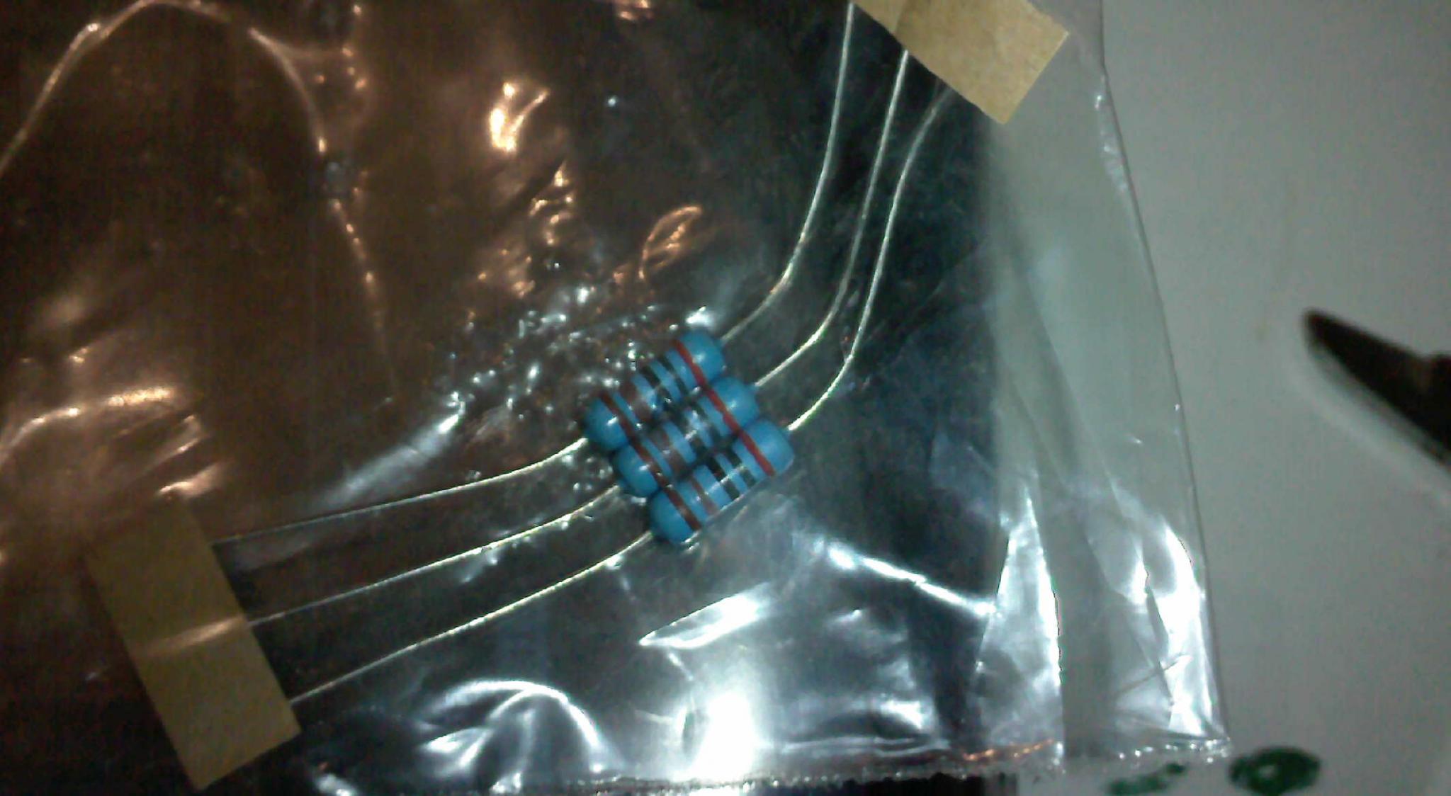

Why do you need to add resisters to your circuit? Give us some more detail on what you need to achieve.
Gary if your looking do you understand?
The resistors are to limit the current to the driver if voltages above 5volts are used. If 24 volt is used on the step/direction pins then a 2k resistor is required 12volts a 1k resistor is used. The bottom line is the current to the control side of the driver must be between 6-16mA

and I want to please tell me your opinion on my setup diagram

If the 10A is a fuse/breaker then it is too big, your drivers are only good for 8 amp. Calculate the current for your motor based on how you are going to wire them (parallel/series) if you are wiring them parallel then go on 2/3 of the total motor current.
For your step/direction wiring use a twisted pair preferably shielded, so on the 2M880N take one twisted pair to the PLS+ PLS- then the other twisted pair to the DIR+ DIR- the PLS+ then goes to the step pin on the PCPPS V3 the DIR+ to the Direction pin on the PCPPS V3 then join both NEG wires and join then to a GRD on the PCPPS V3.
If you are using the charge pump I would not bother with the enable signal (FREE+ FREE-) just implement a PROPER e stop circuit that will kill all movement and disable the primary side of the power supplies. DO NOT rely on MACH or any other control software for your E-Stop circuit you are using very powerful motors they will not stop if you get in the way!!!.

I understand I need to change the fuse 8amp
and I change an electrical cable thicker here I made another small body please help me to complete it and switch (SW1-SW10 ....... SW) my installation and parallel

Have a look at this by H.O (post 6) it may explain the e-stop circuit a bit better. The e-stop should kill ALL movement inc spindle.
http://www.cnczone.com/forums/567931-post6.html
I think you need to take a little longer with your build and do a bit more reading so you understand what you are trying to achive.

so I finished my wiring in the plane of my (post1)
but unfortunately I have a problem
The NEMA 34 motors SY85STH65 runs smoothly
but
The NEMA 34 motors SY85STH118 there is a problem he turns around and block as a brake
and when I plug in the 4 engines mach3 will continuously reset

Hi Ali, Andy is currently resting as you must have overloaded him with questions.
When Mach keeps resetting when the driver board is connected you may have an input active high or vice versa
Connect your machine a bit at a time then you will find the thing that is miss configured
Have the motors NOT fitted to the machine so there are no accidents
