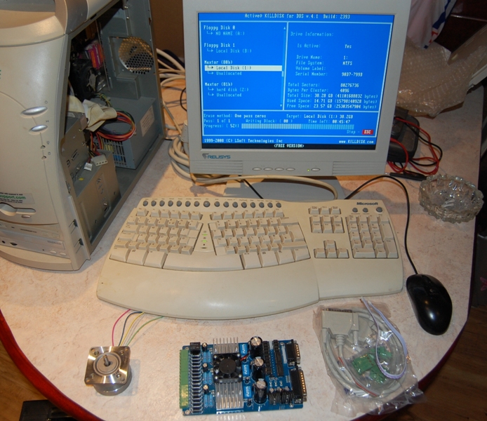

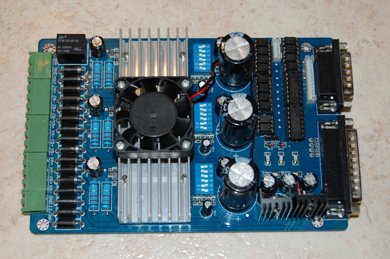

my first cnc project from the start. as i type i am formating a pc that will be dedicated just to cnc.
my board came today from ebay :smile: very fast delivery 2 days.
i will post more as i get on.
Attachment 3498
Attachment 3499

Ah, the ubiquitous TB6560 3-axis board from eBay... If you haven't already, you might want to search for TB6560 and look at other threads related to these boards...

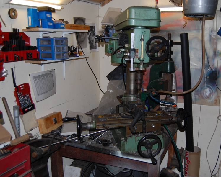

this is my MC that i want to convert to cnc
Attachment 3514

Out of those motors I'd go for the last one, with the biggest torque. Except your driver is only 2.5A...I think that's near enough though. Definitely get a 4 (or 8) lead motor. Your milling machine is very similar to mine and I found that when I started with 1nm motors they just didn't have enough torque to go above a few mm/s and required pulley reduction, so I upgraded to 3nm motors from Zapp, with their 70v drivers which works very well.

BTW what mill is that? looks similar to my Warco, but older...
thanks irving had a look at your tutorial it was a very good read.
am not sure of the make of the mill no markings on it :( but would love to know.

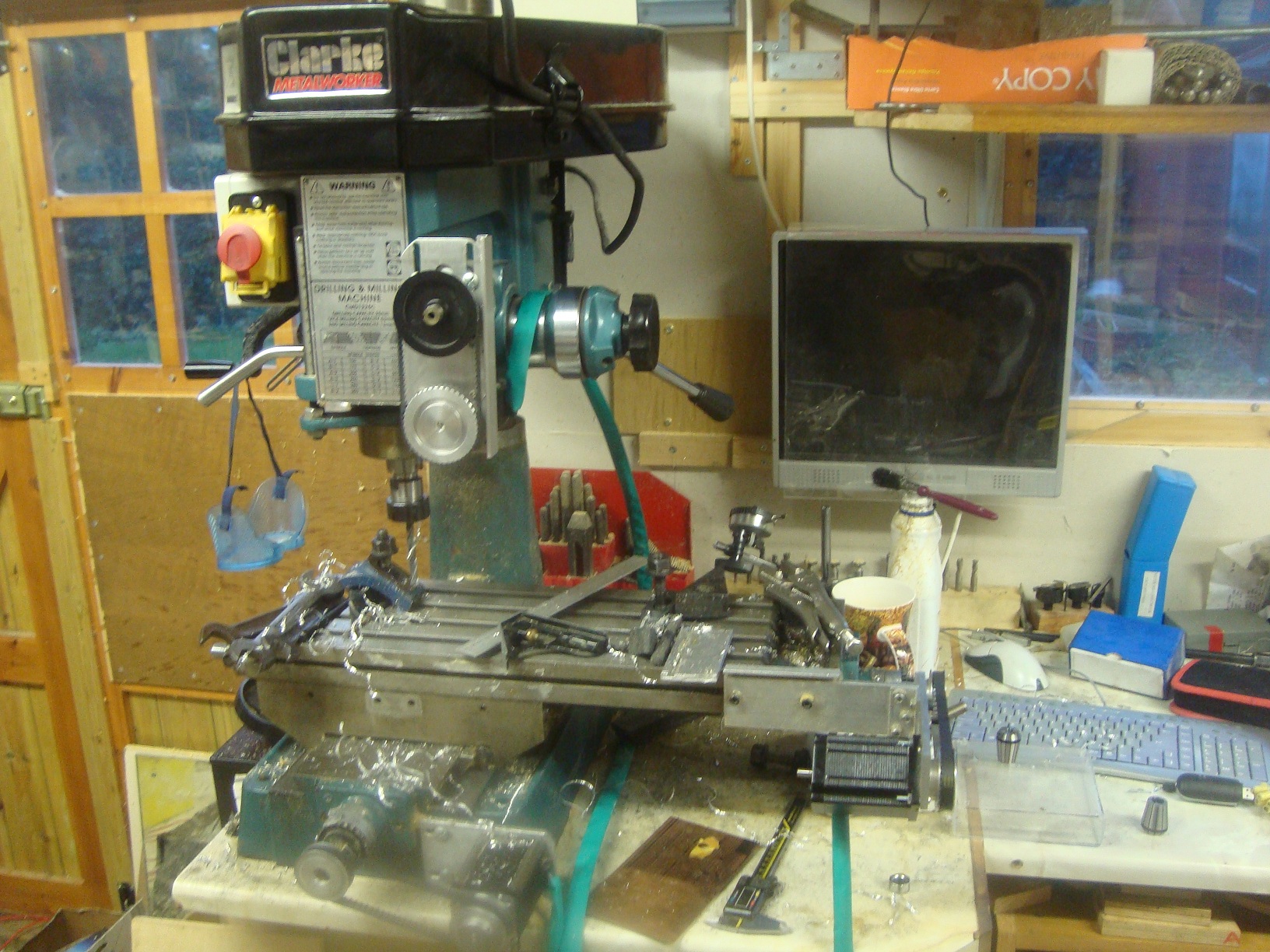

Those numbers are similar to what I got on my milling machine with the same motor. I've never cut at over 1000mm/min, and that was with a big cutter (http://www.youtube.com/watch?v=iC7lX..._order&list=UL). The 2150rpm spindle limits the feedrates I can use. I started off with 2500 on the X axis (see http://www.mycncuk.com/forums/showth...ll=1#post12790 post #19), but have gradually reduced that to 1800 over time. Now I've taken the motors off to use them on the router. It will still do more than 1800, but not 2500...I think the ACME screw or something has worn a fair bit. Time for ballscrews perhaps-that should make it a bit faster due to the efficiency.
Attachment 3516
Looks like a Clarke MD25 - Similar to the Warco MD30/Minor i have.... tho mine has a longer table... I wont be using the original screws but some ballscrews I got off Robin..... the top speed of the spindle is limiting, I have a VFD to go on so plan to increase the belt ratio to up it to 3000 or so... tho running at 1800mm/sec with a 6mm cutter would ideally like 5000rpm on the spindle... not sure the bearings will like that much tho...
If that's mine your referring to then it's a Clarke CMD1225C from Chronos (though I got it second hand). The castings look pretty much the same. Agreed with the 5000rpm. I'm thinking either mount a separate spindle to the side of the main one (i.e. my 6000rpm 6kw-ish brushless motor), or put that same motor in place of the 750w original motor. I was about to ask you if you thought the bearings would take that rpm! They allready sound a bit rattly and the spindle pulley gets warm - maybe that's normal. How long is your table and what are the travels just out of interest? I get 350x141x92mm.
