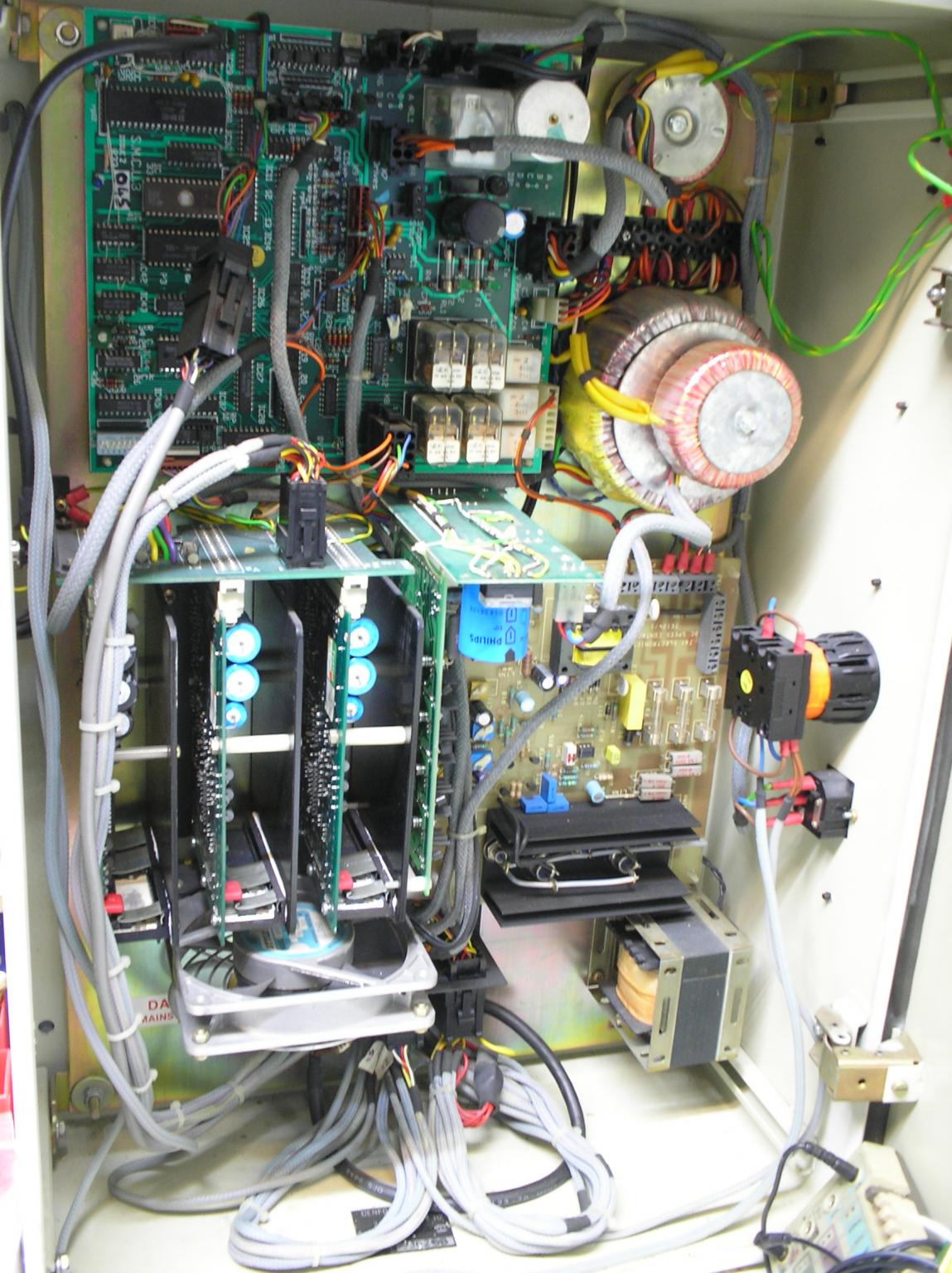

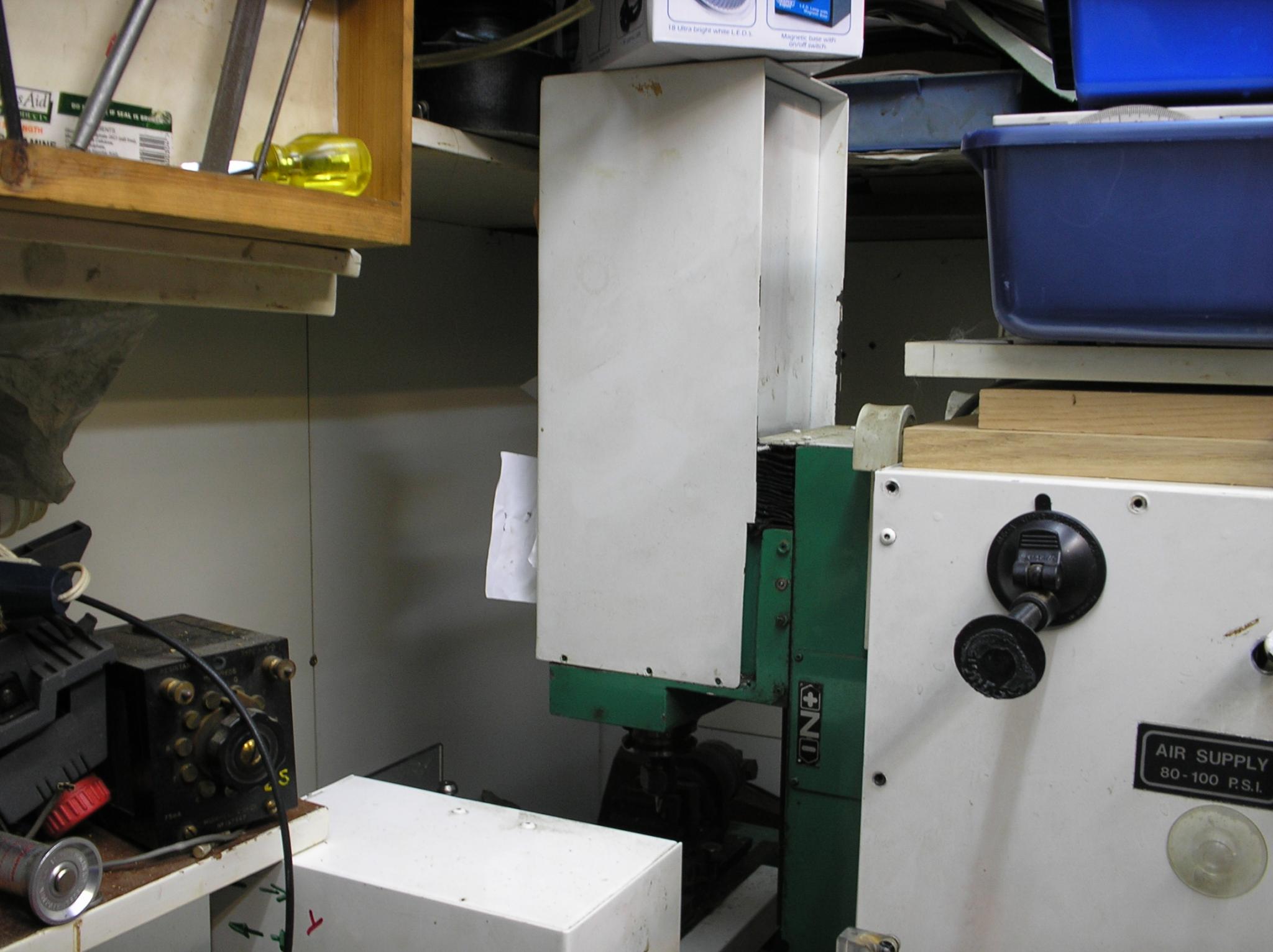

Attachment 3541Attachment 3540Control panel on front with jog wheel mini data screen stop button ect. Big box at back with main controls as pic one. pic 2 is side of machine with tool changer. Phil.
I was running it quite happily on a BBC. Slow and rather frustrating at times, especially when trying to go between machine control and editing. Then one day I switched it on and it would not establish link to computor. I spent some time checking leads connections etc. I tried several desktops using win98 to XP. and software from Denford forum site all to no avail. I have just assumed that the main board was gone but no way to check. To cap it it all, I converted an emco 5 cnc to Welturn and it worked brilliantly with very little problem and just £300. I wish there was an equivalent board for Starmill. I was hoping to use existing motors' drives and PSU with perhaps Gecko 540. I have been advised that to get Toolchanger and Spindle control working with Mach 3 is hard, and I really wanted machine at least as useful as it was before. I have been putting this off for some time but using my old Victoria for some of the small componants used on my engines is def' a Walnut job! Thank you for your time. Regards Phil.

Attachment 3606Attachment 3605I have hard a good look at the circuits in Attachment 3604the back of the Starmill. I can't be certain but out of the two types of drive on that Denford link you posted, the sd range looks closest.
Attachment 3603 I have attached a few pics. On one of the motor boards- PKS Digiplan '87.
The Spindle board is- Jay Electrical DC speed control JE124/1 seriAttachment 3602al 98712407
The tool change psu 122ve.
I have received parts from Maplin to make buffer but haven't got a clue where to connect up. Phil.Attachment 3601
have a look at the end of the stepper drive boards and it will state what type they are, probably a cd20 or sd 20. Page 23 of the digiplan drive manual shows the pinout for the end connector, and pins 26 and 28 of row c are the dir and clock positions. You'll need to find the wiring that feeds these signals into the drives and isolate them from the main board, then it's simply a matter of putting the buffer board between the breakout boards output and these points
