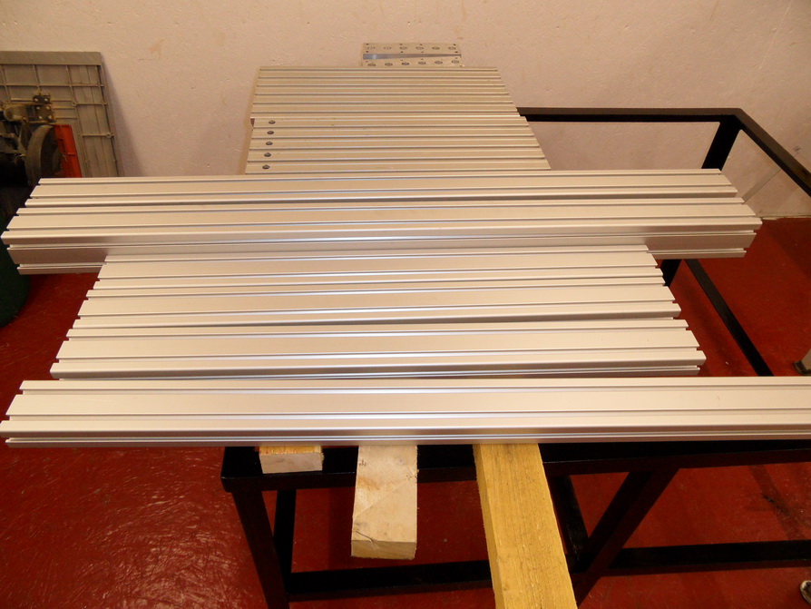

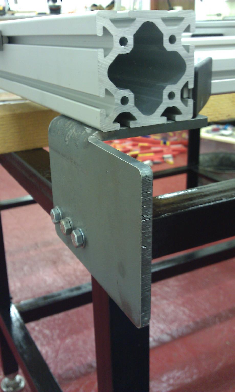

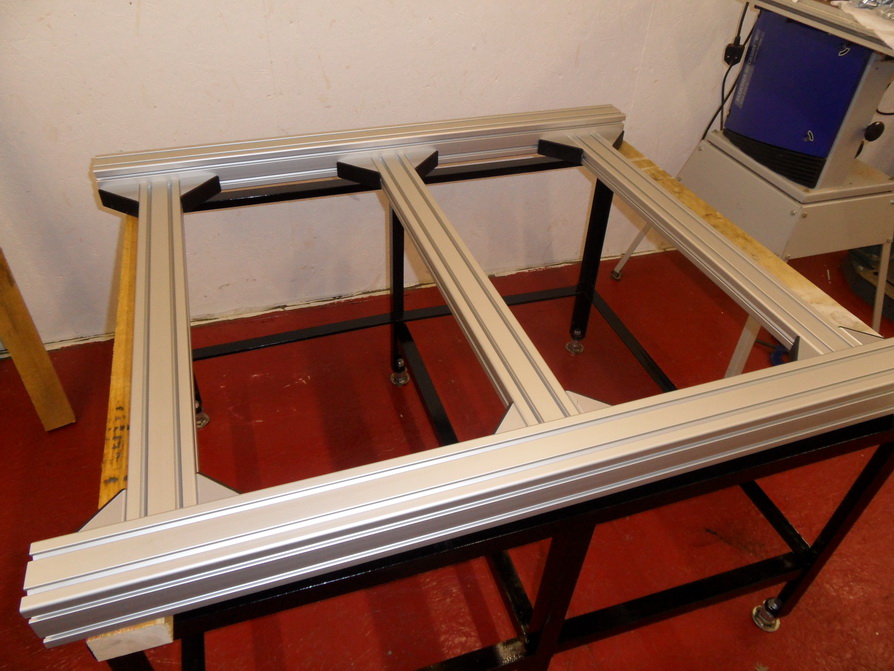

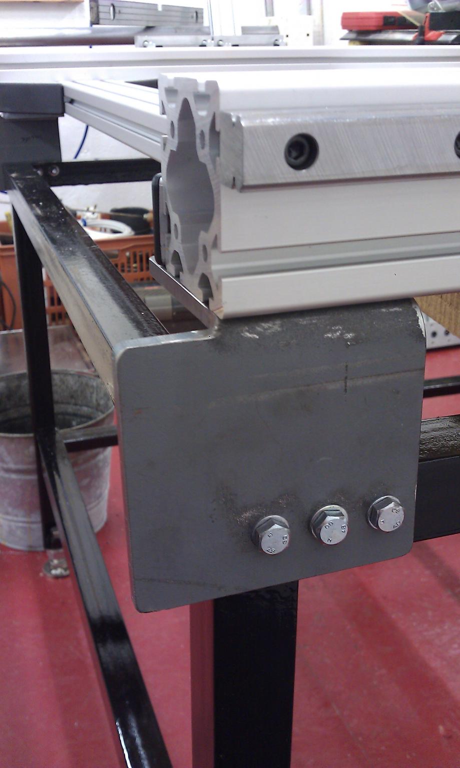

Web Goblin cnc has begun

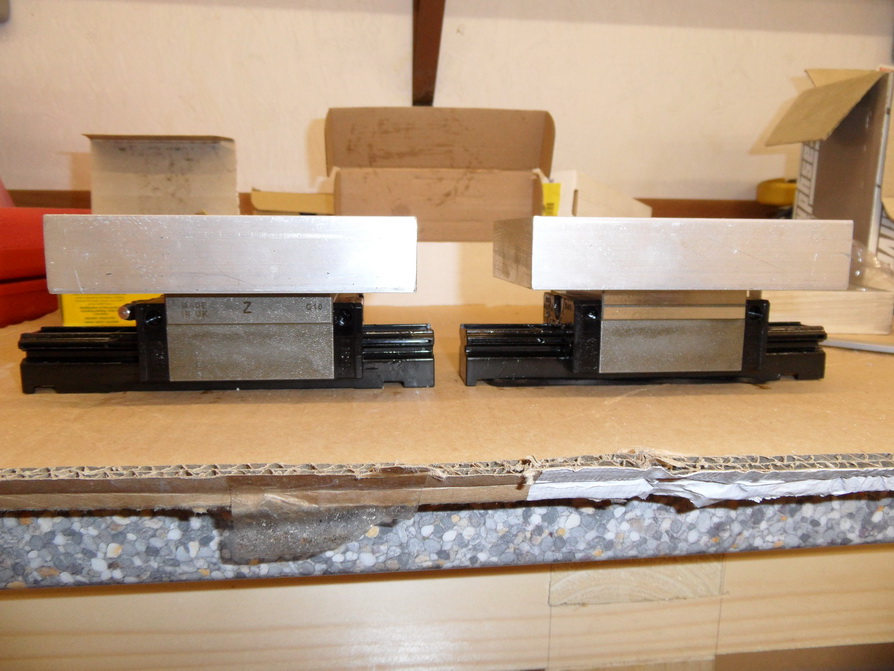

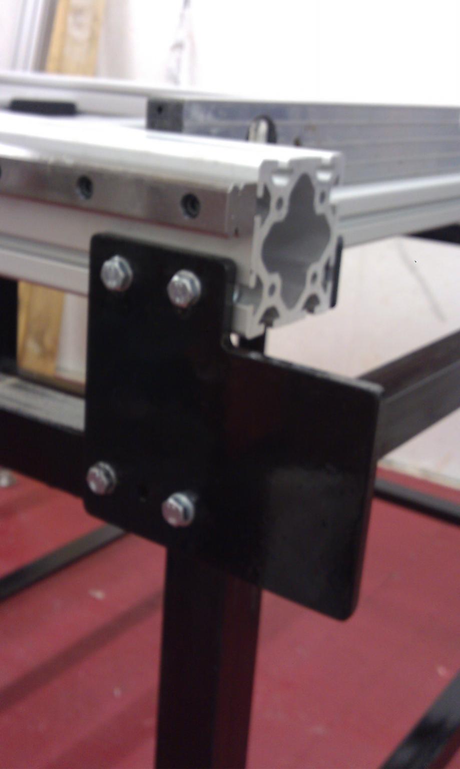

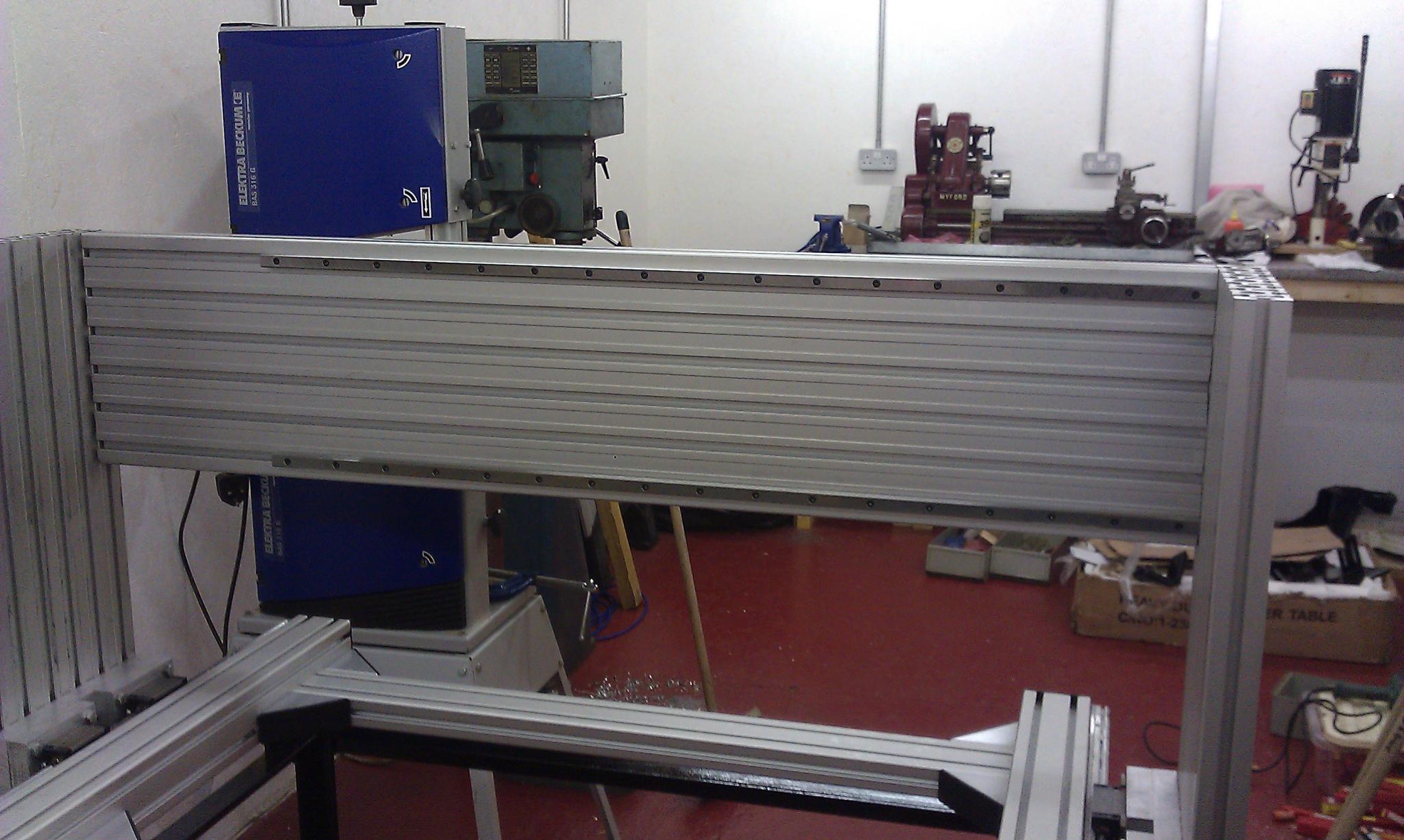

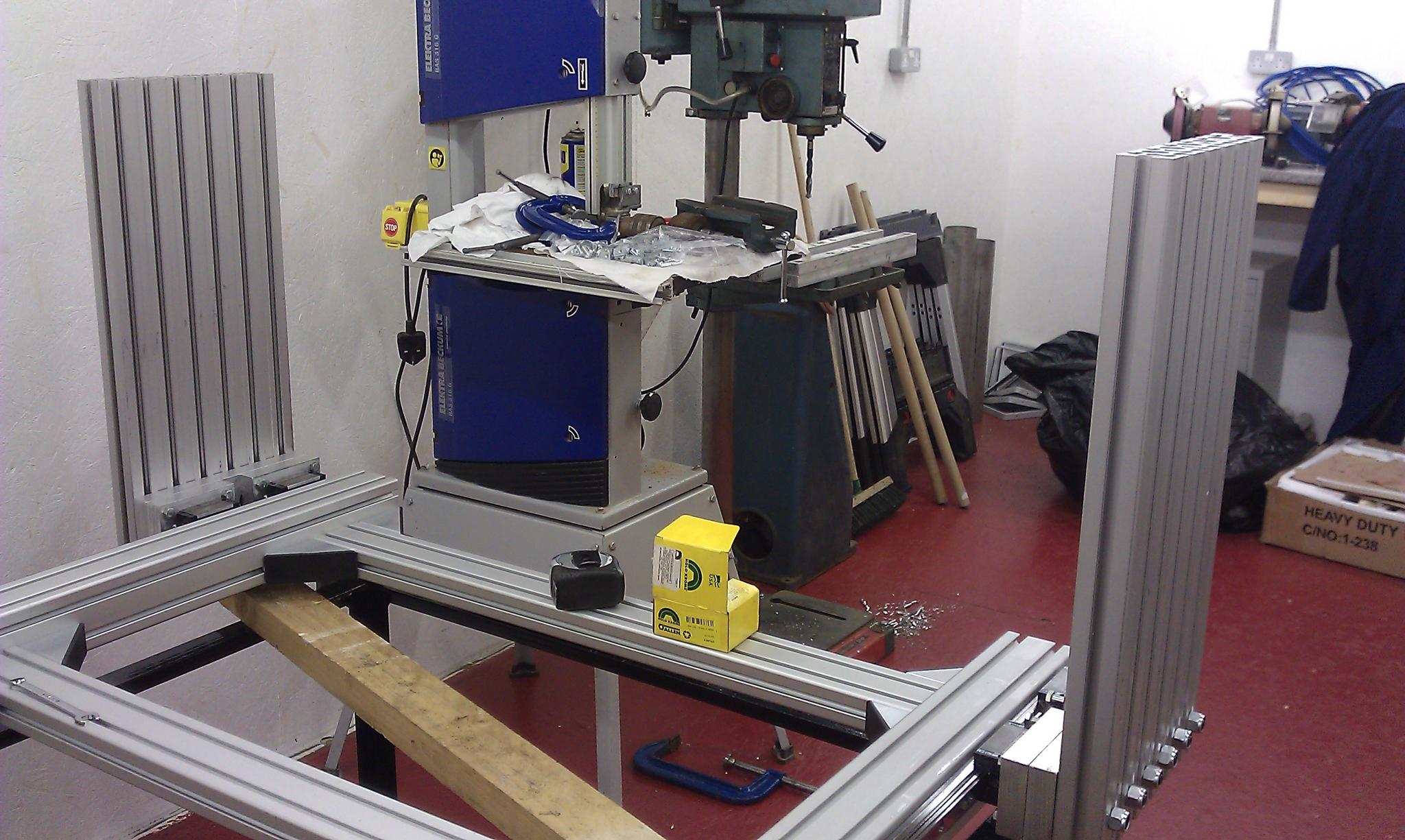

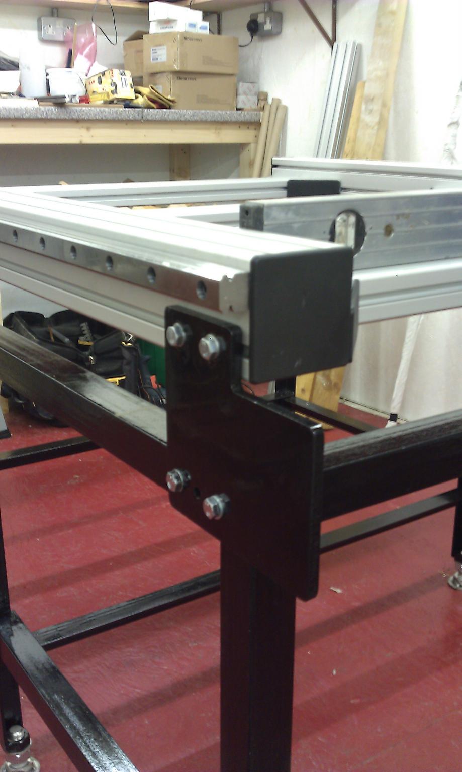

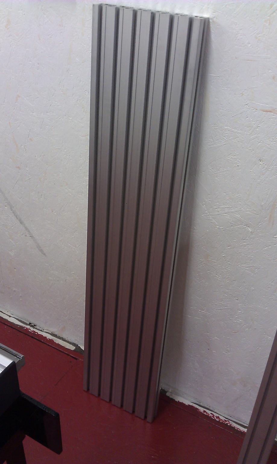

Some of my parts have arrived so its time to get the build started. The bed frame is 1250mm long by 1065 mm wide. It will be running on linear rails and bearings with ball screws driven by NEMA 34 motors.
The whole assembly will sit on a purpose built angle iron frame with adjustable feet to level it.
Pics 25, 28, 29, 30 show the extrusion and the built base frame with part of the linear rail attached. 26,27 show the bearing riser plates and the y-axis risers. 14 shows the bearing mount plates and the risers and 16 shows how they fit together.
I havent got the ballscrews yet and some of the motor mounts are out of stock but should be here soon.
Hopefully tomorrow I will finish fitting rails for the x-axis and get the bearings and mount plates fitted. Then I have to work out the mounting plate for the frame to fit to the base which will also mount the motors and the ballscrews. If I can get that done tomorrow I can get them cut out on the Laser at work Monday.
I need to figure out attaching photos as well

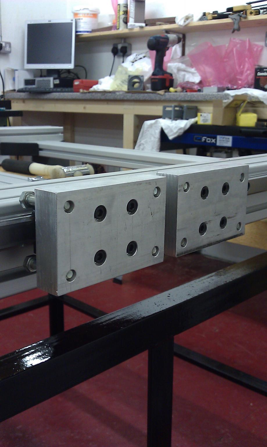

4 Attachment(s)
Re: Web Goblin cnc has begun

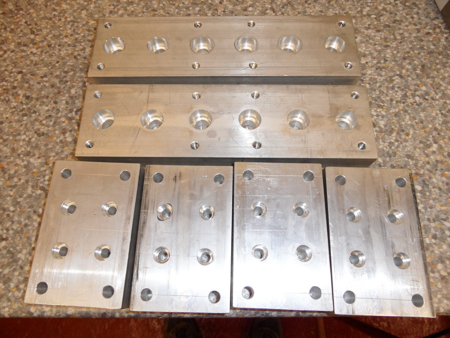

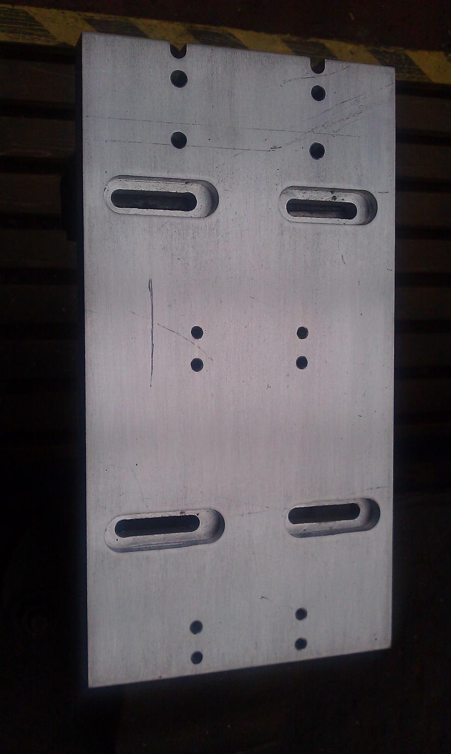

I managed to get my motor and bearing mounts drawn up and cut out and flanged. They have been fitted and are ok. On the first photo the top flat part of the mount is lying slightly at an angle. I know that the brackets are accurately flanged so I can only think that the angle iron of the frame is slightly twisted. I have gone round all sections of the base frame with a level and it matches the frame so it appears to be level.
Attachment 3636Attachment 3637

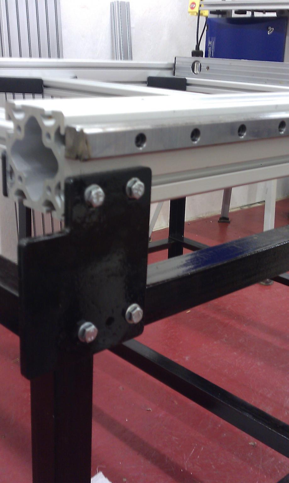

I also got the chance to mount the y-axis risers as well so that I could get an accurate measure to get the y-axis bars cut. First photo shows the bearing blocks mounted on ther bearings.
Attachment 3635Attachment 3638
Hopefully tomorrow I will get some time to paint the motor and bearing mounts.
Ian

most of ther uk profle that I have seen has either 6,8 or 10mm wide slots. I dont know if the american stuff will still be in imperial sizes so it might not fit very well at all. The valuframe stuff is great stuff. Thats what I have used for my build except for the wider 275mm profle for the y-axis riser plates because the valuframe range only goes to 200mm wide I think. Normally if you are using a rack and pinion drive I would space it out from the edge of the frame by maybe 2mm and centre the drive pinion to the rack so that it would have a little bit of float. The good thing about rack and pinion is that it can float about a bit and not cause any problems and also if your gearbox/motor assembly is spring loaded it helps to keep the pinion in mesh and also lets it follow an uneven rack.

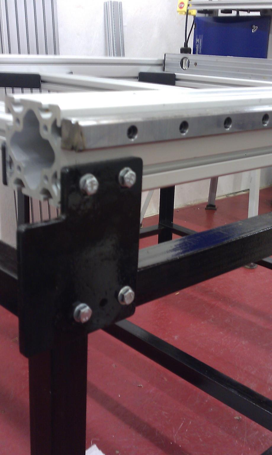

4 Attachment(s)
Unfortunately I havent gotten much work done on my build over the last week.
I decided to change to motor and bearing mounts to straight plates. Got them made and fitted and levelled the frame up again.
Attachment 3666Attachment 3667Attachment 3668
Also managed to cut and fit the rest of the X-axis linear rail.
The Y-axis extrusion arrived this week as well.
Attachment 3669
I need to set up the Y-axis on the floor of the workshop to see where to drill the riser plates to take the Y-axis extrusion. I also need to see where I am going to fit the motor mount and then see where, if anywhere, I need to cut out a notch from one side to take the ballscrew. When I get that done I can get them fitted and it will start to look like a machine then. I also picked up my steel enclosure today to take all the electrics so I suppose I can get that started while I wait on the ballscrews to get machined.
Ian

I managed to drill and tap the Y-axis riser plates and the Y-axis beam.
Have them refitted to the machine and have also fitted two sections of the linear rail.
Attachment 3675

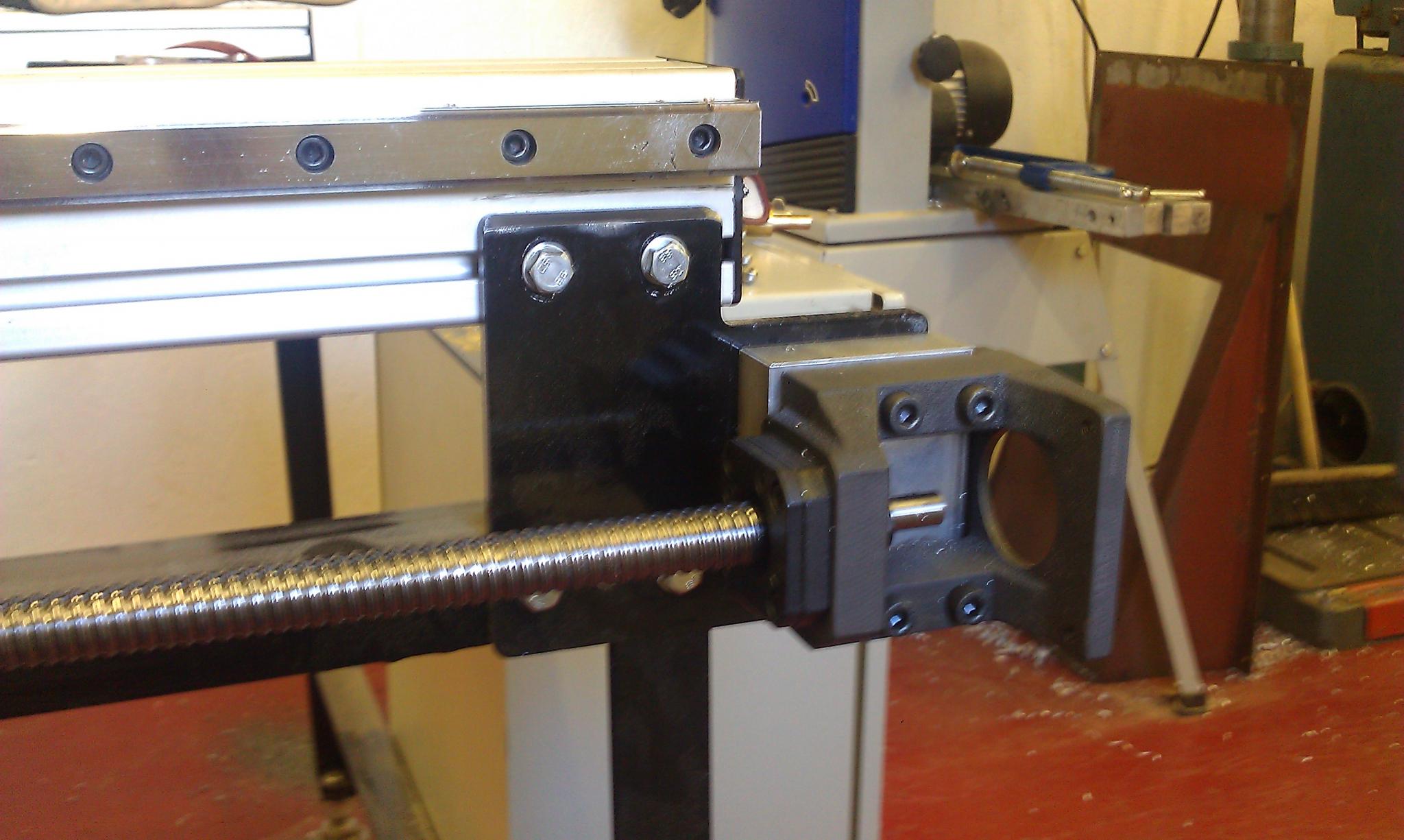

Managed to get my Y-axis motor and bearing mount finished today.
Attachment 3685Attachment 3686
Also got it fitted to the back of the Y-axis beam although this position might change when the ballscrews arrive and are fitted. I have around 35mm adjustment to allow for tensioning of the timing belt.
Attachment 3687
Now I need to get the coupling bored out to the correct sizes for the motor shaft and spindle and get that fitted as well.

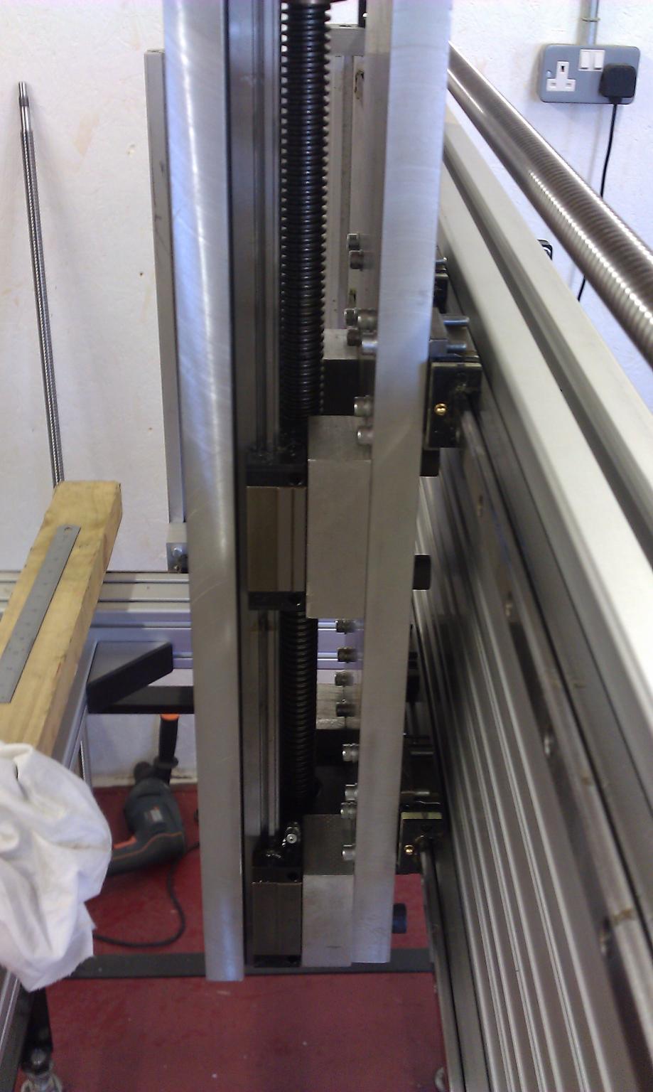

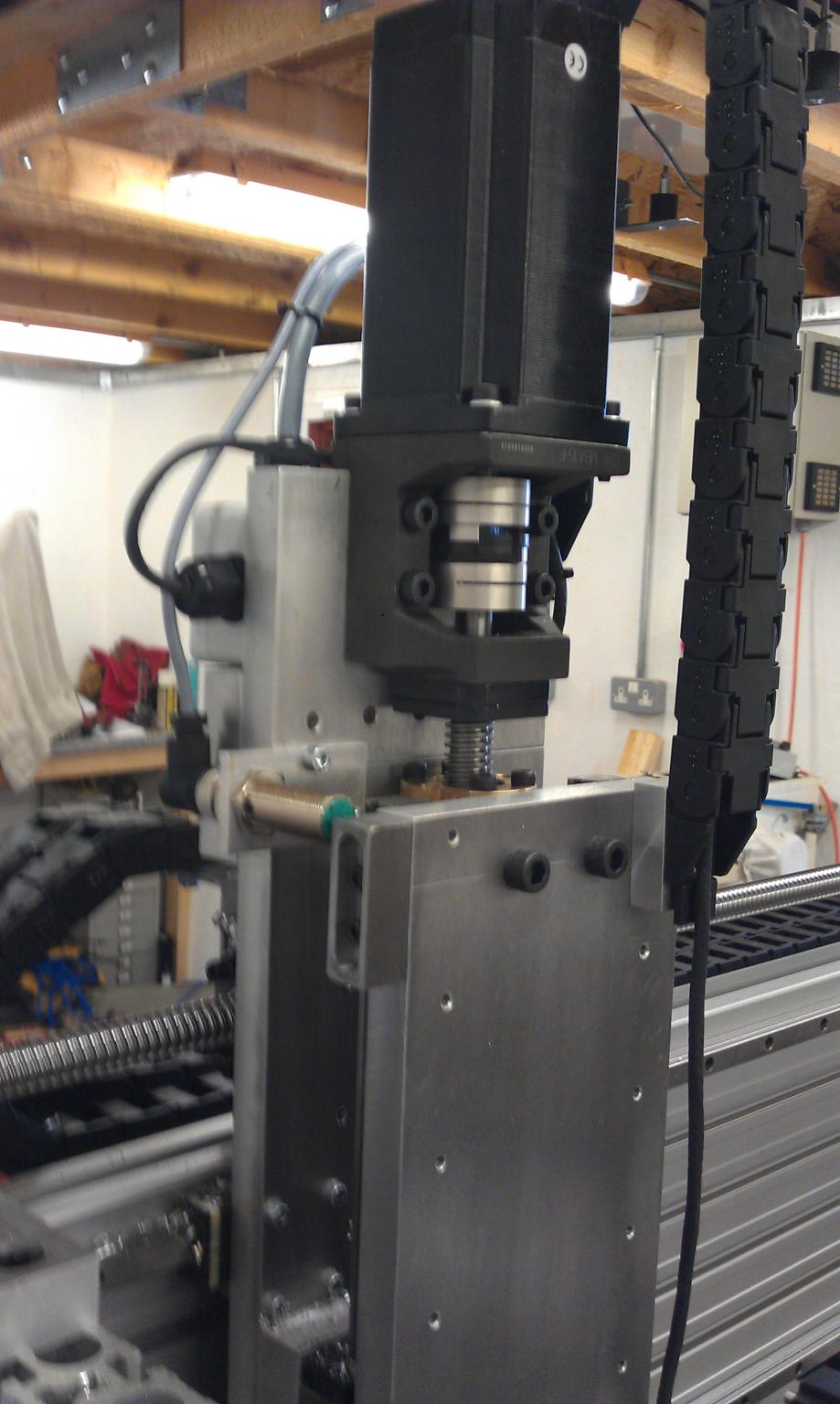

Right several weeks on now and guess what? My ballscrews turned up, well nearly. One of them is wrong again and I am going to have another two week wait, at least, to get a replacement.
I have managed to get some time in the workshop and have been able to get some more of my build done.
The Z axis is more or less complete and fitted to the machine as per the photos.
Attachment 3957Attachment 3953Attachment 3955Attachment 3954Attachment 3956Attachment 3952
I have the ballscrew for the Y axis and have fitted the ballnut and mounting nut and the end bearings and it is just sitting on top of the frame at the moment for me to get some measurements. Next job on Monday is to mill a spacer block of aluminium 95mm x 75mm x 16mm thick to go between the ballnut mount and the Z axis frame.
The Z axis took quite a bit of work to get right. After it was made and assembled I ended up with about 1.5mm of movement in the screw from end to end so it had to be taken apart and a new spacer ring made to suit. Once this was done and re-assembled there is no movement at all that I can see so I`m happy with it now. :dance:
Ian

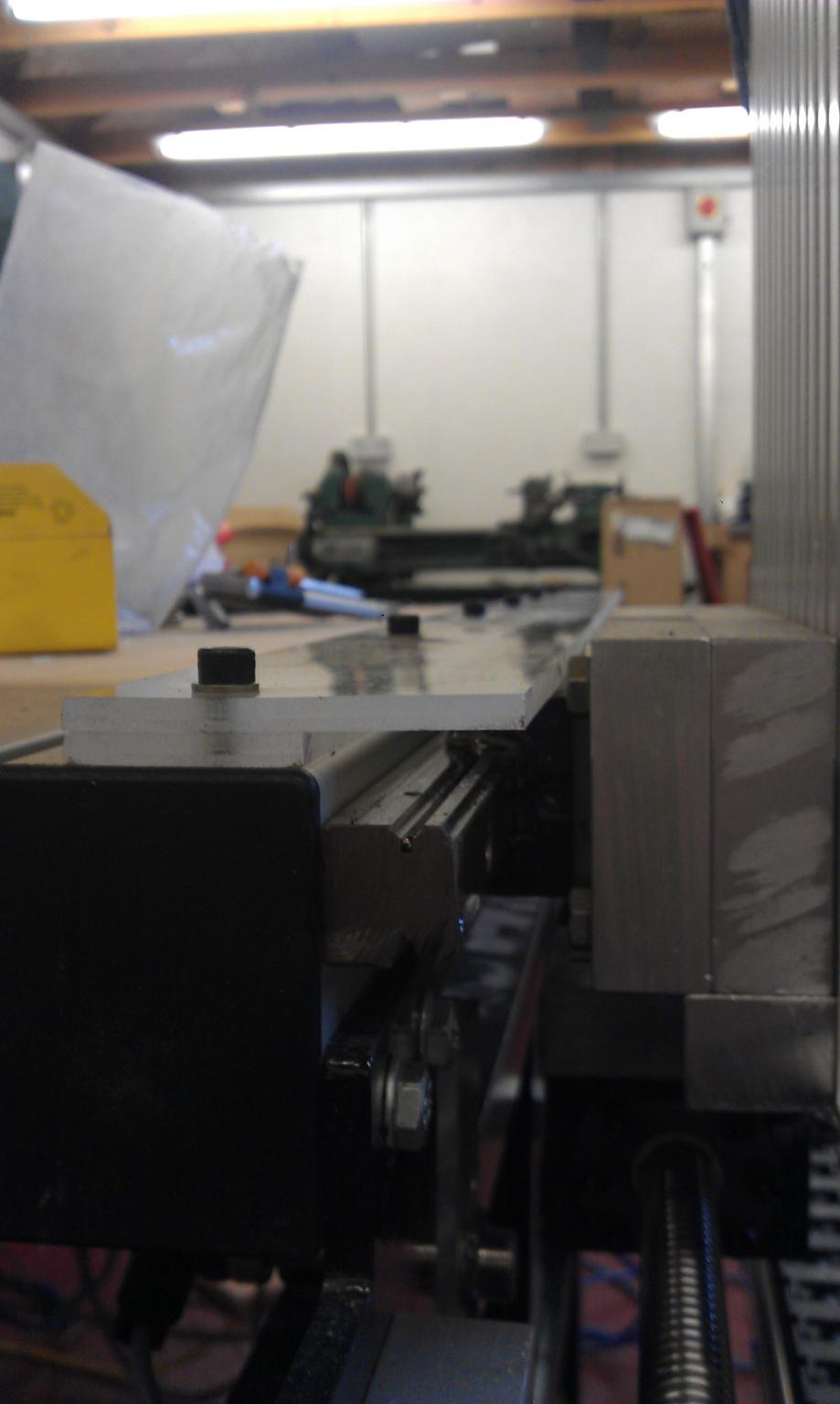

I have assembled the X axis ballscrews, nuts and mounts. Made up the spacer blocks and got them all fitted and set up.
Attachment 4009Attachment 4007Attachment 4008Attachment 4010Attachment 4011

No flanges on the Y-axis pulley could cause problems, but I guess if the belt doesn't fall of then nothing to worry about. Why have you extended the motor shaft then put a pulley on the end? It seems an expensive way to do it. Surely the motor bearings are sufficient to take the belt tension, or was there another reason? The reason I mention it is you've now added the moment of inertia of that shaft to the system which will affect your acceleration a little.

the y axis motor shaft was not long enough to got through the motor mount to take the pulley. I had looked at making a different mount for the motor but it was working out to be rather thin material to get the pulley fully on the shaft so I decided to go this way. I could have made it a bit shorter but I dont think it will make too much difference.
The pulleys I had at the time so went with them rather than buying new ones. If the belt does give problems and runs off I can always change them for castle ones later.
On my X axis I have a pulley with no flanges (the ones I made), and one with one flange. It's been fine so far so fingers crossed... You can always add your own flanges to the pulleys.

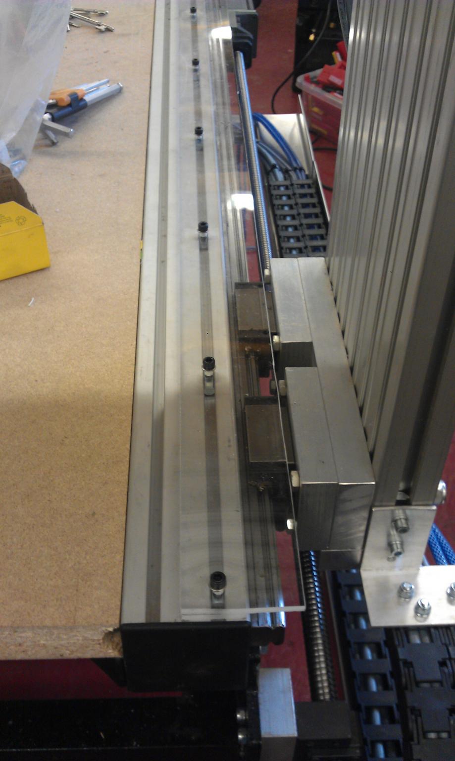

Update time. I havent had much time again in the last few weeks but I am getting there slowly. I have managed to get some work done on the electrics now.
Attachment 4124Attachment 4123
I have fitted the limit switches and have most of the wiring in place with just some tidying to do. All motor have been connected up.
Attachment 4126Attachment 4127Attachment 4125
Drag chains and supports are fitted with wiring in place and the cables are glanded into the panel.

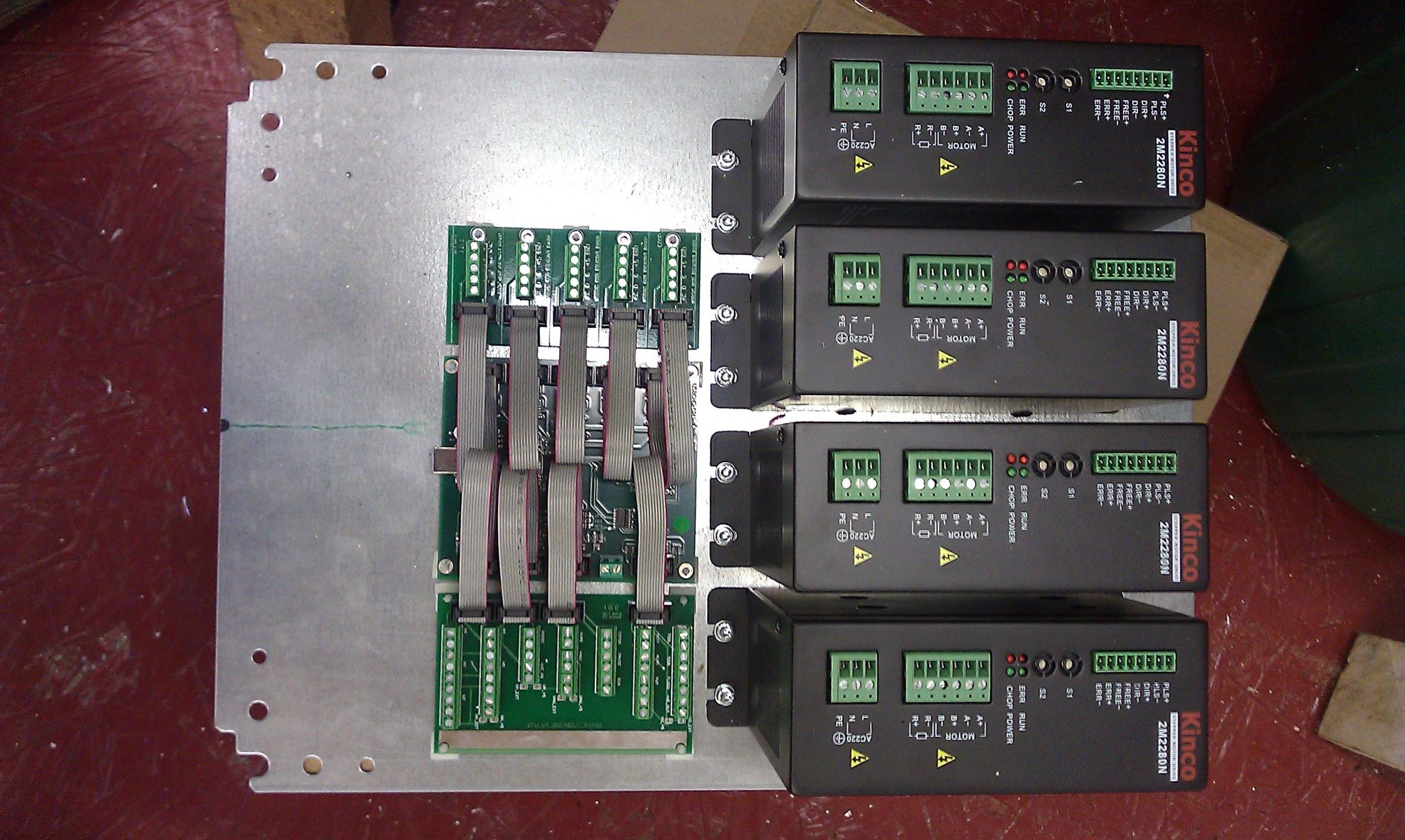

I have finished the wiring and connected up the drives and limits.
Attachment 4153Attachment 4154
The panel is a bit crowded but its what I had around and I didnt really want to spend £100 on a new one.
Those drivers generate quite a bit of heat so looks like I will have to install a couple of cooling fans.

Looks nice and tidy to me. I don't think you should connect the mains wires to the drivers one after the other. This will cause each subsequent driver to get a lower, and varying, voltage to the previous ones in the chain. It's better to have wires from the live and neutral all connected to the same point, then connect that point to the mains. It may well not make a difference, I'm not sure!

Linking the drivers should be ok as long as the supply cables can carry the load current without heating up. As long as they stay cool the volt drop should be minimal. I will check the full load drawn from the supply when I remember to get my current clamp meter out.
Jonathan's right, in that ideally you shouldn't daisy chain the power wires, but I'd say interference/poor connections are a bigger hazard than lower voltages.

Linking the drivers should be ok as long as the supply cables can carry the load current without heating up. ...Did you have a look at the link I pm,ed to you?
I'm working it out properly now to see if it actually matters. I'll post what I find out.
I did look at the link - it's a good link thanks!
What diameter cable did you use to the drivers?
It says in the driver manual:
'For better heat dissipation, two drivers shall be installed at a clearance of at least 50mm'
With sufficient fans I'm sure you'll be fine though.
Let the resistance of a single piece of wire connecting the drivers be R. Let the current to each driver be the same, call it I. Assume it's steady state, which it's nowhere near so pretty poor assumption...Also assume no impedances other than the wire resistance ... again we should really include it but there's not really enough information to make it worthwhile so I didn't bother.
1st driver gets the supply voltage, V.
2nd driver: V-2*3IR = V-6I
3rd driver: V-2*3IR-2*2IR = V-10IR
4th driver: V-2*3IR-2*2IR-2*IR = V-12IR
So as you can see the last driver is in trouble if I and R are significant. The good thing with your drivers is they're at mains voltage, so I is not very high (maybe an amp, could peak at more) and R is (assuming 1.25mm^2 wire) about 14mOhm. That means you're loosing about 0.2V to the last driver. Compared to the 240V that's not much, but maybe when the currents are changing quickly it could be a problem as then the impedances I ignored would have an effect ... and all the drivers will be drawing different currents.
If you have 50V drivers then a reasonable average current might be 4 amps. Lets say you used the same wire, that's 50-12*4*0.014=49.3V
The thing is that DC voltage will now fluctuate, there's now about 1% ripple on the power supply. This could cause a problem if the smoothing capacitors are not big enough in the driver.
As m_c said, there's more to it than just the voltages.
(On reflection I guess working out the above didn't achieve much, but I thought it was interesting!)
Ian
Hi, Newly registered here but been lurking around :wink:
Why not ring wire it? It works for household wiring, you then have two paths for the current to flow so if one fails the other is active and also it can still look neater than lots of wires from one branch.
Supply cables are 1.5mm^2. I dont have my regs book handy but they should be good for around 16Amps. All cables are shielded are are grounded at one end only should interference should be minimal. I will check the load drawn and the voltage supply to the last driver and see what they are. If there is a problem it will be simple to change it. I remember the manual saying about the clearance distances between drivers but the panel was already there and begging to be used. A couple of 80mm diameter cooling fans should take care of the heat.

Again I have not had much time on my build lately but I have managed to get afew things done. My workshop pc died a couple of weeks ago but I have now managed to get another one up and running. I have had the machine moving about with it again. I have started to get some work done on the spindle wiring.
Attachment 4376Attachment 4377
I need to get this finished and get the interlock from my cooler done as well before I try to run it.
I had also been looking at a way to protect the linear rails from cuttings so this is what I came up with.
Attachment 4379Attachment 4380Attachment 4378
Nice and simple idea. The perspex should keep the worst of the cuttings away from the rail and it will also let me see if anything gets in there.
Ian

the gantry seems stable enough but I have not actually cut anything with the machine yet.. I have had some problems with the USBCNC software and hardware and cant get any feedback from the supplier. He doesnt want to answer emails so I had had to try to sort them out myself. I think I have most of the problems sorted but time will tell I suppose. My workshop pc died as well and it took a couple of weeks to get another. I had gotten hold of a Lincoln Electric welding torch cooler to use as a cooler for the spindle but this had quite a few problems as well so it has now been scrapped.
I dont know if I would change anything yet except the Z axis screw. I am currently using an acme screw but I think it would be much better with a ballscrew. I may change this in the future. I also have an extra section of alu extrusion to fit across the front of my gantry but this has not been installed yet until I see how the machine runs without it. If there is any play in the gantry I will fit it.

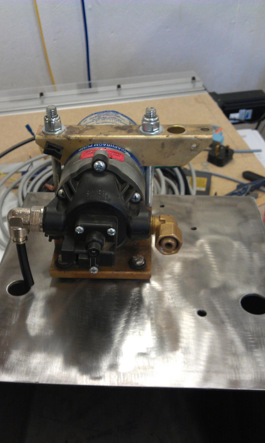

I have decided to make a new cooler unit from scratch using some of the parts from the old cooler.
I have fabricated a new tank from 3mm stainless steel. Then fitted the pump.
Attachment 4423Attachment 4422Attachment 4424
As usual just need some more time to get it finished and tested now.

Personally I wouldnt use a pond pump. I dont think they like being turned on and off lots. They also like to be run with full bore pipe work to match their outlet size. I used to run the pond pump during the day and turn it off at night and I had also reduced the pipe size. The pump lasted about 2 years. I installed a Titan pump using 50mm bore pipe and it runs constantly. Only gets turned off about 4 times a year for cleaning. Its been going for about 5 years now.
As for a 1000l/m pump I seriously dont think you will get anything like that flow rate through the spindle.
As Jonathan has said the stainless steel box I have made will act as a good heat sink and will hold around 10 litres of water so should do the job fine.
