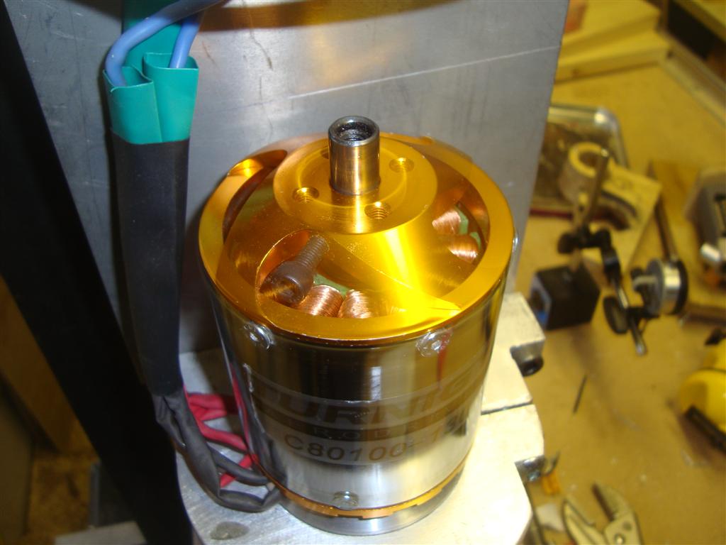

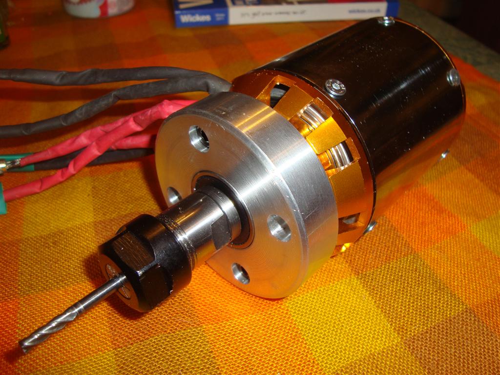

It's alive!
Heated the angular contact bearing in oven, cooled the shaft and it dropped straight on.
Bit of a fiddle to get the rest together, but it went ok.
I've run it up to 3100rpm (24v) and it sounds fine. Slight noise from the bearing but I don't think that's significant.
I also measured the runout and it's less than 0.01mm.
Will post some more pics in a minute.

Re: Using RC Brushless motors as spindle
Jonathan
It's alive!
Will post some pics in a minute.

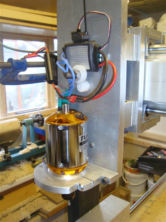

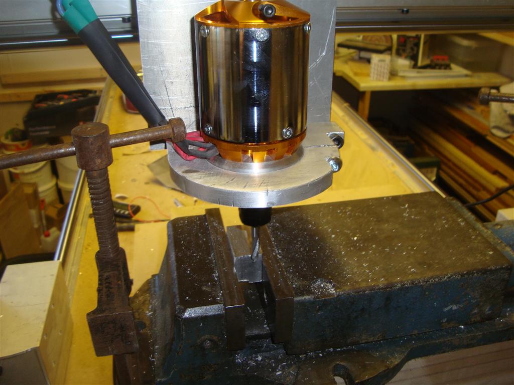

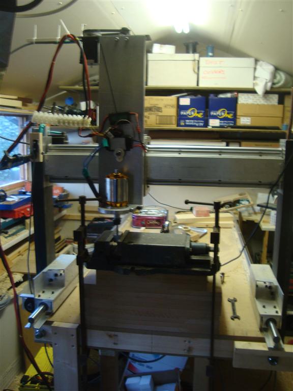

I did the mount today, not the neatest of things I've made with the rotary table but it works:
Attachment 3654
Attachment 3653
Spinning...nice effect:
Attachment 3655
I ran the motor in for about 5 mins on 12v, soon got bored of that (I'll leave it running properly tomorrow). So I tried carefully grasping the motor body with some kitchen roll to protect my fingers - couldn't stall it, not even close :smile:. It merely drew 550w and about 53 amps. I'll have to think of a safer way of testing the power at higher voltages.
I think I'll stick with the batteries for now unless anyone can point me to a 50v PSU that can deliver a LOT of current. Maybe a few of those switching PSUs people have been using for steppers on eBay...

I was under the impression your mill was under cnc control why the RT ?
Jonathan
Its a temperature thing if it doesn't get hot just keep increasing the speed in increments.
Jonathan

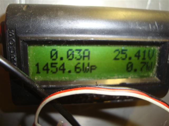

Sounds like mum & dad are gonna have a big leccy bill coming. :eek:
Phil
M250cnc
I took the steppers off the milling machine and put them on the router. Didn't want to put them back just for one part. Rotary table was also the most accurate way I could make the hole for the spindle, not having a boring head.

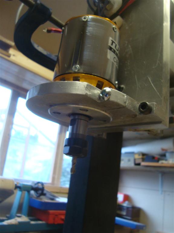

I measured the runout again now it's mounted properly. I put a 10mm cutter in and measured 0.03mm about 10mm from the collet. If I put the DTI on the collet chuck itself it reads 0.01mm.
Are you measuring the outside or the inside of the chuck for runout ?
You should be measuring the inside and i would measure at the extremes of the taper to see if you have different amounts of runout at the two points.

It wouldn't fit easily on the lathe - it's only a C3 mini lathe with 4" 4 jaw chuck. I probably could have got it to fit, but it wasn't worth it since I needed the rotary table to do the semicircle on the outside anyway. Wish I had a lathe like yours...made so many things on the same one at school.
I used the lathe with 3 jaw chuck for a few of the bearing mounts for the screws - carefully designed the shape to fit the chuck easily.
I measured the runout inside. I'll try again like you said.

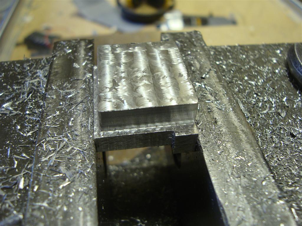

Just tried cutting with it. 7mm two flute cutter and some scrap aluminium. Using 0.5mm depth/width of cut it was happy. Sometimes 1mm, machine is a bit too wobbly to do more at the moment. I'll post pictures in a minute to save a thousand words...

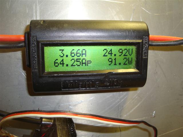

The motor drew 30w extra whilst cutting, 100w idle.

I ran it at 3100rpm for 20 mins. The angular contact bearing was very slightly warm - helped no doubt by all the aluminum around it. The stator got a little warmer, still nothing to worry about.
Managed to get 1.5kw out of the motor without it complaining.

Use a fine oilstone to de burr the slits in the collets as they can have tiny burrs which can be a cause of runout.
When checking the runout it the collet mark the high or low point so you can see that they are in the same place vertically when you measure both positions.

Jonathan i have just seen the pictures of a sample of the cut produced by your machine with the spindle.
All i will say is you have balls of steel.
What did I do wrong :redface: this time?
Part was securely mounted...it didn't move. I raised it up to stop the Z axis bending too much and took light cuts.
Thanks for the tip about deburring the collets - I'll try that.
