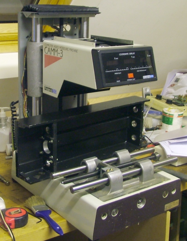

		1 Attachment(s) Hacking a Roland CAMM3 PNC-3000
		Hacking a Roland CAMM3 PNC-3000 just about sums it up...
 I got it for the look and it has passed wife inspection for home office use (provided it doesn't make a mess). Good idea for cold weather if you can get away with it :smile:
 It's a small 3 axis mill with ball screws resolving 5um, round linear rails and a robust cast aluminium frame of average section about 1cm. It's also a bit of a dinosaur :naughty:
 Good thing is you can download all the circuit diagrams, meaning you can copy it's EPROM's and make sense of them with a Zilog disassembler. It's got a Z80 :smile:
 I have a new proto BIOS written so I can upload new code and run it in RAM. Much easier than blowing zillions of EPROMS. All looks pretty straight forwards. Have you discovered Dosbox? It's a freeby that lets you run antique software under XP, Win7 and, amazingly, it all works. Nominate a directory containing all your DOS favourites, mount it as a disk drive under Dosbox and away you go. Google for dosbox if you want it.
 Mechanically I need splash guards to comply with wifely edict. I also want to hush it up a bit. The brushed AC motor isn't too bad but DC would be quieter and I could slow it down a lot, it's much to fast. I'm fitting an ER16 spindle at the same time because Roland collets leave a bit to be desired.
 Pic 1: Spindle out, motor out, new ER16 spindle waiting to go in.

		I'd rather rather do Z80 Assembler than STM code using HAL, I like to get down and dirty :tickled_pink:
		Re: Hacking a Roland CAMM3 PNC-3000
		Sorry chaps, didn't realise I was feeding a troll :culpability:
		Hi Robin,
 I had a Specy 48k+ but i was 7 at the time. Not a scoobie.
 Do you have any paperwork or manuals you could share? i haven't started stripping it down yet, don't even know if its steppers or servos and if they're worth keeping, what are the collets? i'm thinking a possible swap to linuxcnc to get it moving, whats your thoughts? i could donate the electronic gubbins to you if they'd be off use. i think it's only of use to me as a hardware frame as i don't have the know how for diggin into the electronics of it.
 Snowy
		It is 400 step/rev steppers so it purrs.
 There ar 3 manuals:-
 User's Guide
 Command reference manual
 Service notes (Which includes the full circuit diagram).
 I could swap you a set of collets for the front panel with all the knobs and switches on.
 You won't be needing them unless you take my firmware hack :sneakiness:
