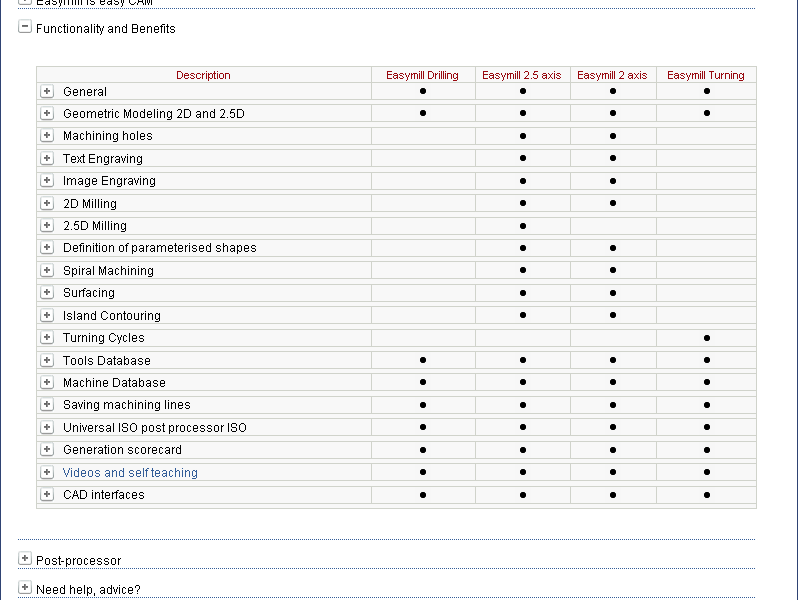

But EasyMilll cannot compete as it doesn't have the capability to do 4 & 5 axis as can be seen on the picture from their own website It's only 2.5D.
Phil
Attachment 3858

Aahh.... It seems there is another Easymill - the one I was referring to was www.easymill.com (French) or www.easymill.co.uk (English).
That one does do 4 and 5 axis in 2.5D.

Yes those were the sites i was referring to, maybe you need some lessons on the differences between 2.5D and 3D/5 axis machining.
Phil
Phil
- A 4 or 5 axis machine is one that moves with 4 or 5 distinct axis, with each controlled independently to each other.
 - 3+2 axis - 5 axis machine where two axis are used for positioning, not moved at the same time as the main 3.
 - 3 axis - obvious
 - 2.5 axis - 3 axis but with Z only 'up' or 'down', possibly some in between but generally making 'flat stuff'.
I'm not sure how you could confuse that software with 4 or 5 axis. The terms are well defined.
Yes Easymill can rotate parts in 4 and 5 axes - but not while cutting.
I am surprised by your response - you say 'what credibility do you have ?' yet you do not explain what you mean - from my web research there seems to be confusion between rotation axes and 2D/2.5D/3D.
And more specifically a great deal of confusion as to what constitutes 2.5D!
With Easymill as far as I am aware the axis is rotated but doesn't cut while rotating.
When the part has been rotationally positioned, the cutting starts in 2.5D.
