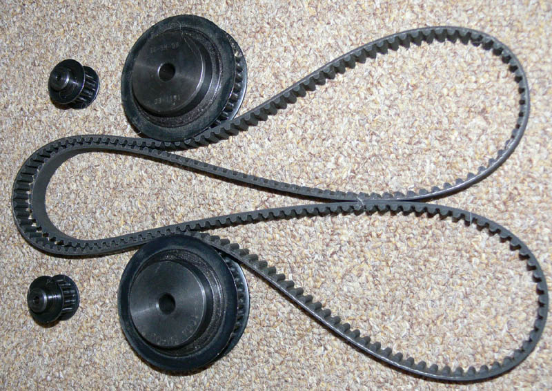

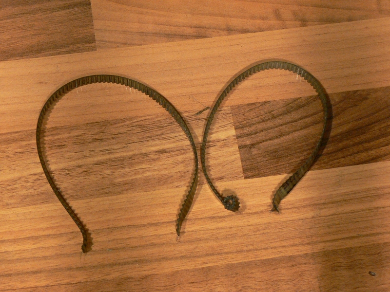

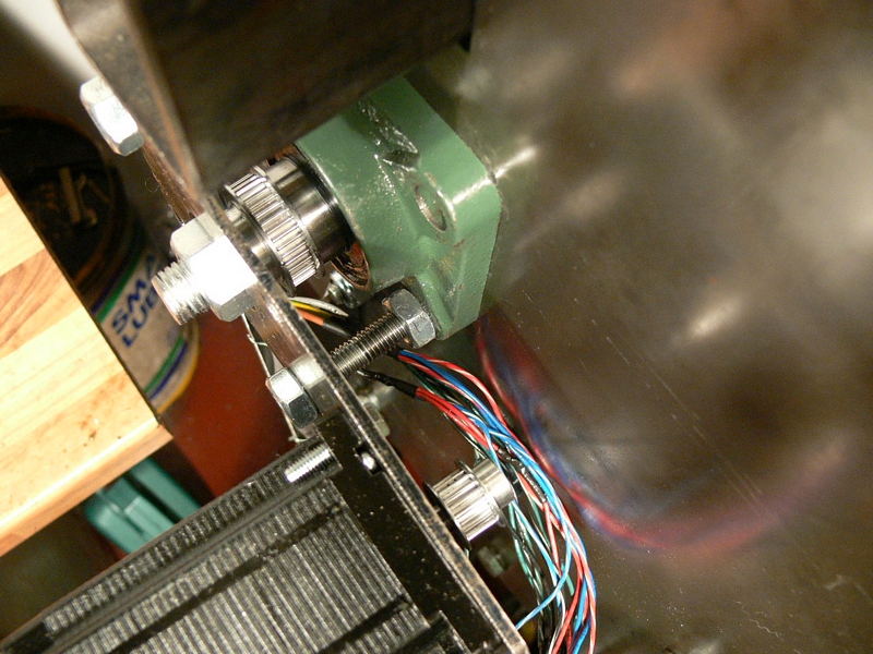

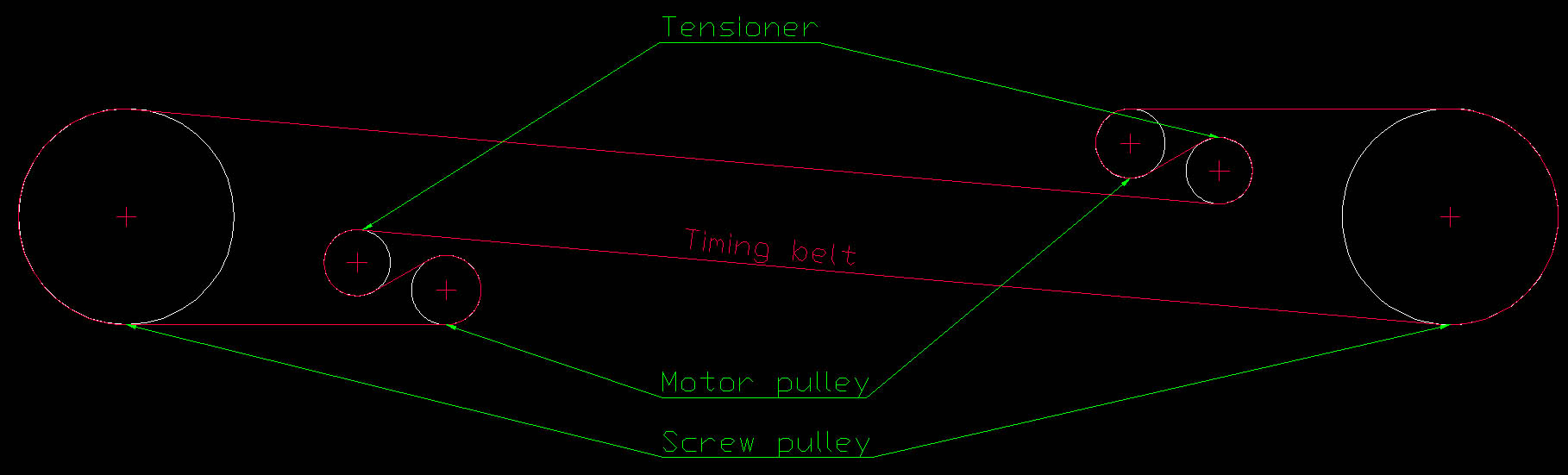

I use T2.5x6mm Synchroflex timing belts to transfer power from stepper to lead screw.X and Y axes have two motors to rotate the screws. And yesterday the belt snapped, not for the first time I gotta say. So now I'm planning to replace two 2.5mm pitch belts with one 5mm pitch on Y axis but still leaving two motors to steer two lead screws. Of course I'll need to replace timing pulleys and make some tensioners. Stuff ordered,hope it will work.

I've used XL pitch belts, at least 1/2" wide and have never had any problems. Can also make your own pulleys for them with a bit of care which saves a bit.

I don't have rotary table to cut the pulleys :( . Money are sometimes an issue so I went for smaller pitch, cheaper belts and pulleys. On all axis I've got M16x2 lead screws. Nuts I've made myself from 32mm dia steel bar. They are 60mm long with a grease nipple re-drilled to fit 4mm nylon tube for oiling. Very simple, good and cheap solution, with no backlash at all.
you don't need a rotary table to cut the pulleys use your cnc to cut them out of plate ;)
You are right Chris. I've never cut timing pulleys, but some time ago I was messing with robotic arm gripper. All parts I've cut on my CNC from 3mm steel.

Stuff have arrived. I managed to do some drawing . Hope tomorrow I'll find some time to put it together :)

Just looking at your proposed new drive system, isn't it bad practise to use two motors coupled together?

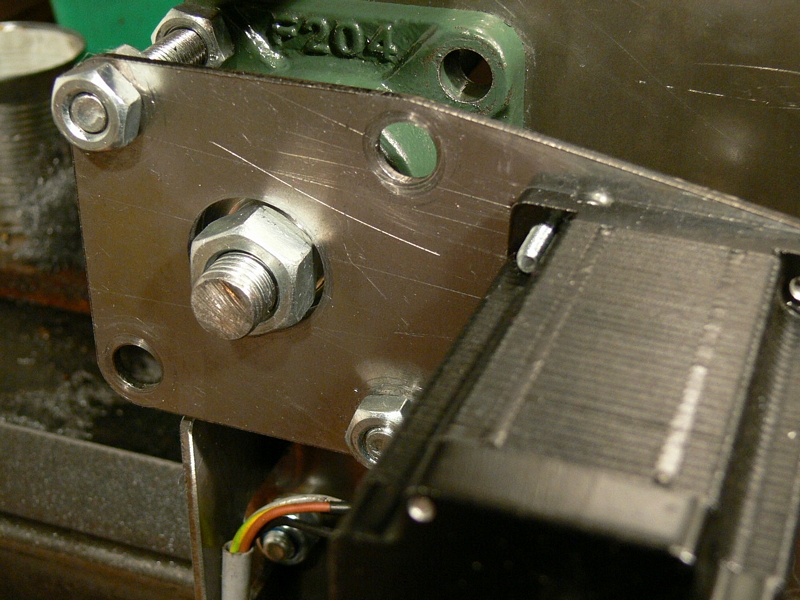

So far the only problem I had it was when one of the belts snapped and then the other motor was pushing Y car's one side only eventually snapping the second belt or stalling the motor. That's why I decided to use one ,long, strong timing belt. Why do you think there may be any negative aspect of coupling the motors together ?? I've attached mounting plate pic. I'll try to produce it asap.
Attachment 3759
Using two motors with one driving each side is ok, but I've seen it mentioned in various places that coupling two motors together can cause problems.

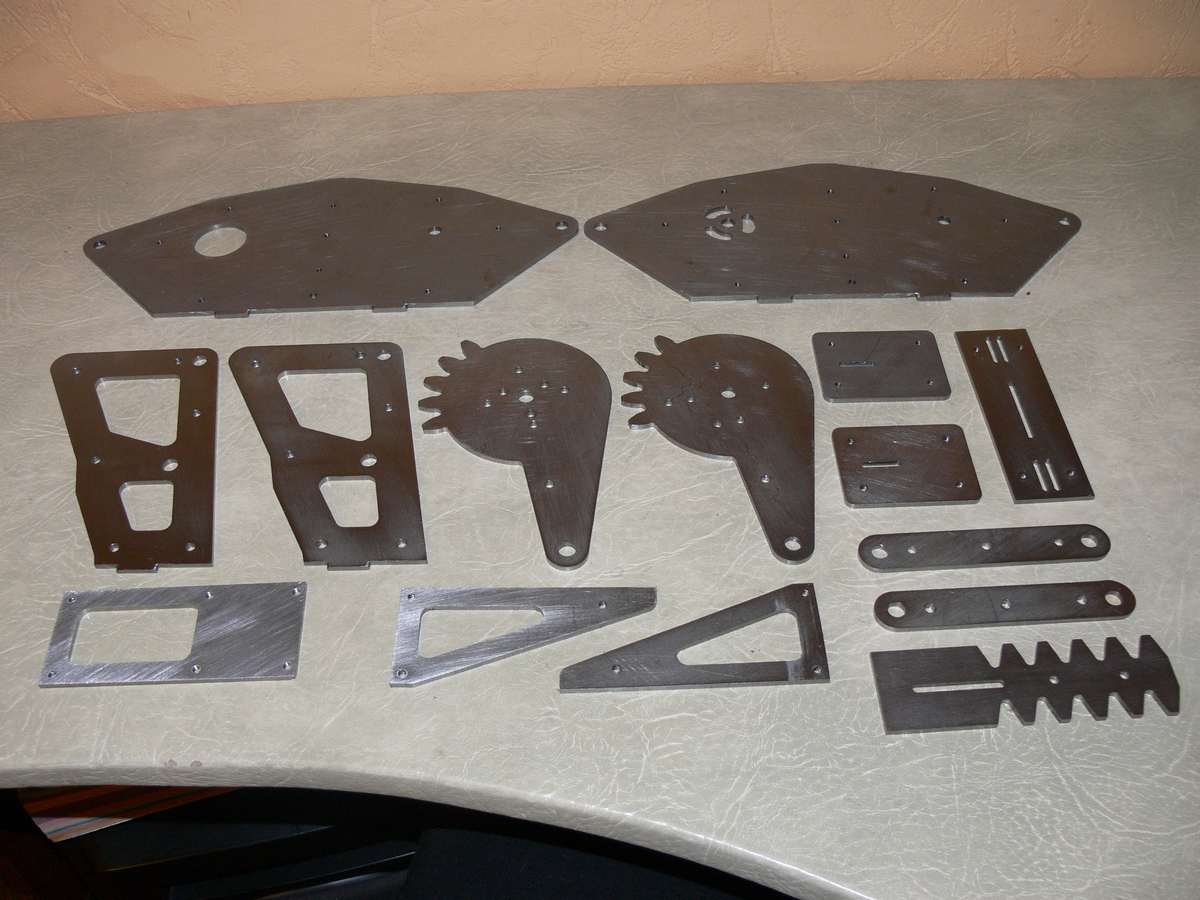

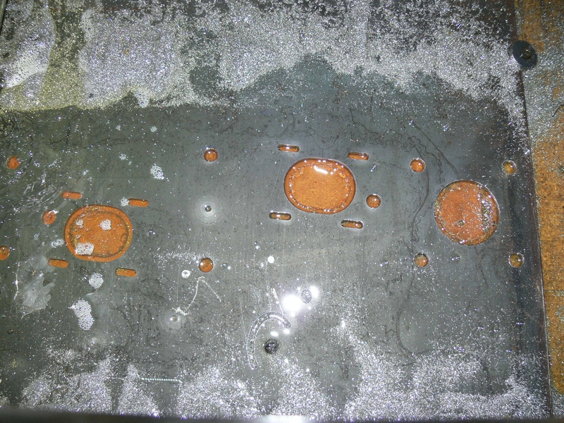

First in order to cut proper steel motors mounting plate I've made "very sophisticated" 3mm MDF plate.
Attachment 3760 Attachment 3761

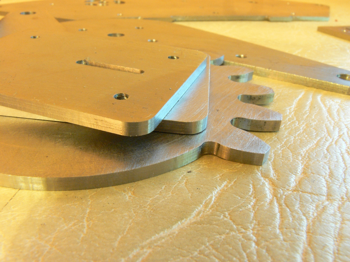

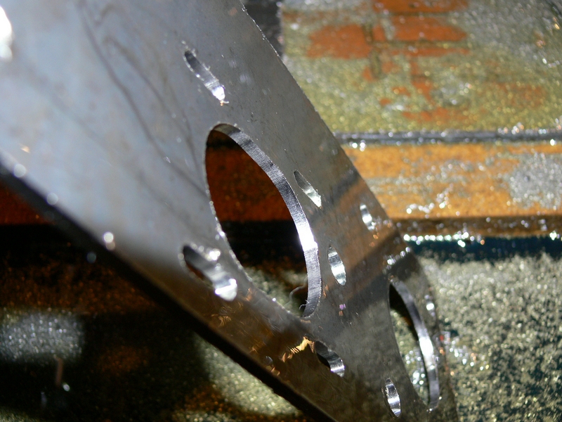

I've put some corrections and CNC cut from 3mm steel plate, so far insides only.
Attachment 3762 Attachment 3763
Some inside circle cut-outs are perfect to hold a material while machine cuts outside profile
Attachment 3764
Just waiting for end result ;)

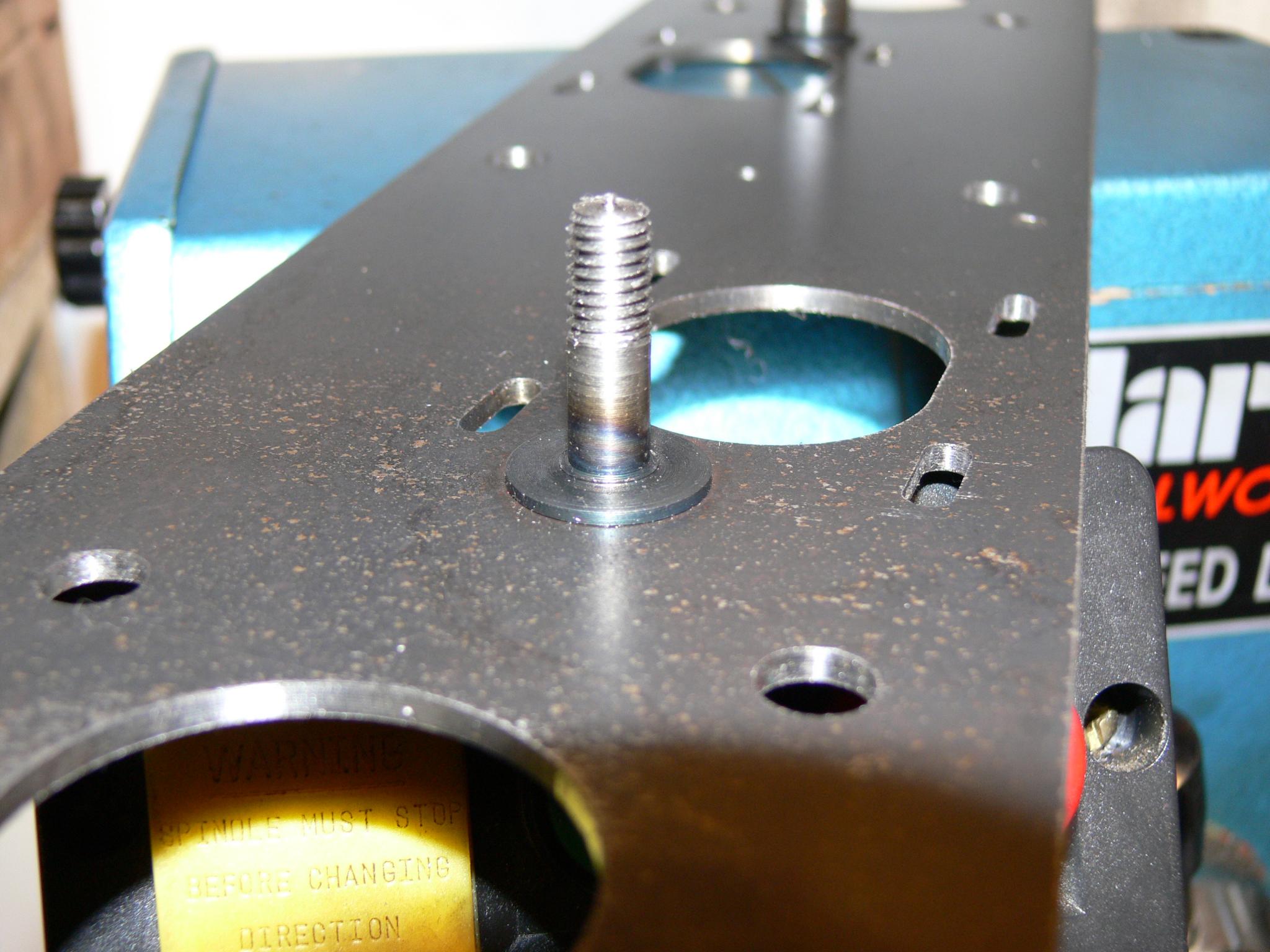

...and finished item
Attachment 3767 Attachment 3765 Attachment 3766
looks good to me mate nice to see some steel and not ally ;) and here's a thanks

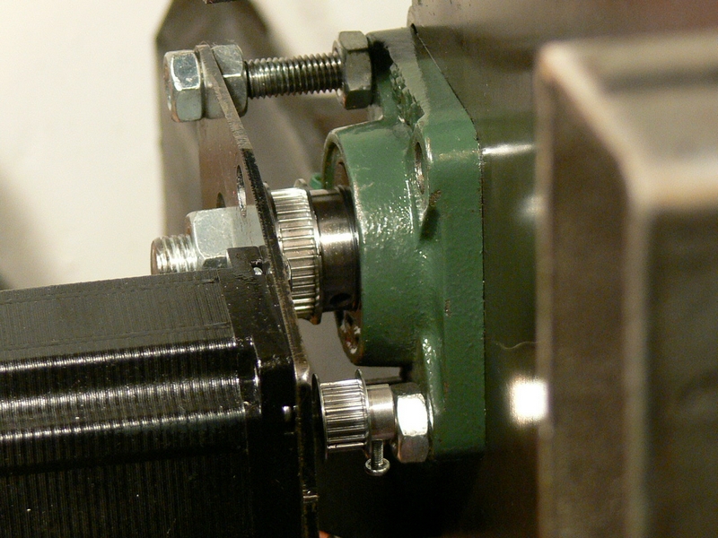

Tensioner shaft
Attachment 3778 Attachment 3777
with 3 pieces of 688z bearings each
Attachment 3779 Attachment 3780
Job finally done :)
Attachment 3781 Attachment 3782 Attachment 3776
That looks neat. I can't really think of a good reason why, but having both motors running on the same belt doesn't seem like a good idea. Why not just have one going to each ballscrew? At the very least that means shorter belts, so lower inertia (probably negligeble). I guess the only thing it gains is preventing racking occuring.
