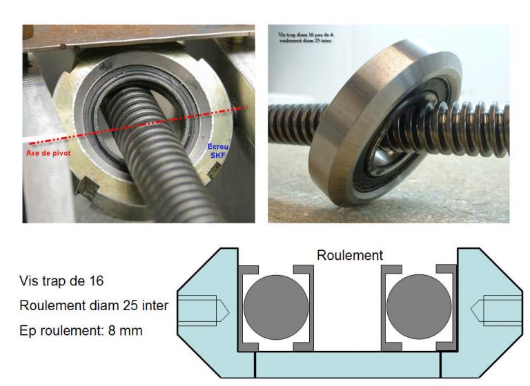

Despite some search, I haven't found anything on this forum about this technique described (in french) here: http://cncloisirs.com/Construction/E...ntVictorSendas
Here is a picture from this site which can help you to understand:
Attachment 3841
It seems very simple, a ball bearing rolling on a trapezoidal screw and quite efficient in terms of backlash reduction & transmission without friction.
Have any of you tested this technique? What are the feedbacks?
I am wondering what is this "nut" in which the ball bearing is maintained?
Thanks for your answers!

		My view is that most if not all leadscrews  are soft "Not Hardened" the profile of the leadscrew is not made to be used in the scenario you describe.
So in the standard situation the most expensive part "The Leadscrew" runs in a bronze bush/nut "The Cheap Part" so the bronze bush is replaced at minimal cost preserving the integrity of the leadscrew.
The situation you describe is a bearing is used to run down the thread. Now for the problem, the bearing "The Cheap Part" is hardened and it is gonna wear the expensive leadscrew in no time at all as its harder than the leadscrew.
Now you could use a ballscrew which is hardened but then its not much more trouble to use a ballnut and get an even better solution.

 I have done it on my Y axis as 'Chip' said it's in my thread and videos on youtube. There's a good shot of it in the long video about wind turbine blade mould if I recall correctly.
http://www.mycncuk.com/forums/showth...ding.../page11
(I've measured the backlash and recorded it somewhere in the thread - pun not intended!)
I used 16mm threaded rod with a bearing that happened to fit - can't remember the dimensions offhand but I'll check if you want. I didn't put any sort of insert on the bearing - it's just running directly on the screw. At the moment it's working perfectly well, however the screw is visibly worn. Not much, but noticeable. Initially the backlash was very very low (practically zero - clearly you're never going to actually get zero), now it's a little more but still good. Better backlash than a cheap ballscrew at least.
 Easily solved - press a brass/bronze insert into the bearing. I did this for an M12 threaded rod (was going to use it on Z) and machined the insert to fit the thread profile better. I think if you want it to work for a long time then that's the way to go. I'll do it at some point on my Y axis, but for now it's adequate - better than the X-axis nuns.

 If say you were using a bronze nut "You Don't Use Brass" that was 12mm  long that would have a contact area on the thread of (12x3.142)x12 of  452mm approx, using a bearing this way would have a contact area of  approx 20mm that's 22 times less contact area not to mention threaded  rod is low grade with a poor surface finish so will wear out the bush in  no time.
The fact that this idea is not commercially available says it all really.

			If say you were using a bronze nut "You Don't Use Brass" that was 12mm  long that would have a contact area on the thread of (12x3.142)x12 of  452mm approx, using a bearing this way would have a contact area of  approx 20mml
 True, you're not going to be able to put anywhere near as much force on it - and the pressure is much greater due to the tiny contact area. Probably only a couple of mm, not 20, since it's only contacting at two lines (in theory). Could improve this with more bearings.
 Yes it does. Except one thing - the sort of machines we're making are generally not used for heavy cutting (like commercial machines). I think this method excels when you're only cutting woods/plastics so the forces are low. ACME rod would certainly be better, but I just used stainless rod as I know that eventually I will probably buy a ballscrew.
It could be good for a PCB machine where low backlash is going to help with accuracy and the cutting forces are tiny.

Where did you find this thing on the picture, enclosing the ball bearing?
Did you get it machined?
Attachment 3857

 I cnc milled it on my machine. I can send you the drawing/Gcode/make another if you like. I made it that slightly odd shape to fit in a tight space on the Z-axis before changing the router design somewhat and using it on Y. If I did another for the Y I would leave more material there for the bolts, and put a spring/belville washers on the bolts so that it rides over imperfection in the screw,

For the moment, I think I will stick to 0 backlash nuts like the one you find on dumpster cnc.
Yet, do you think it has a real advantages on those nuts in terms of backlash or friction? Despite the Acme being worn by the roller bearing?
