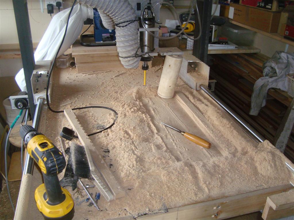

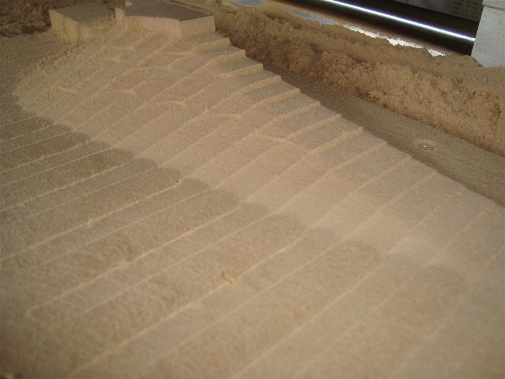

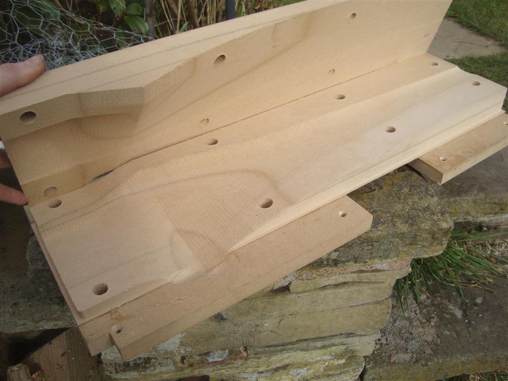

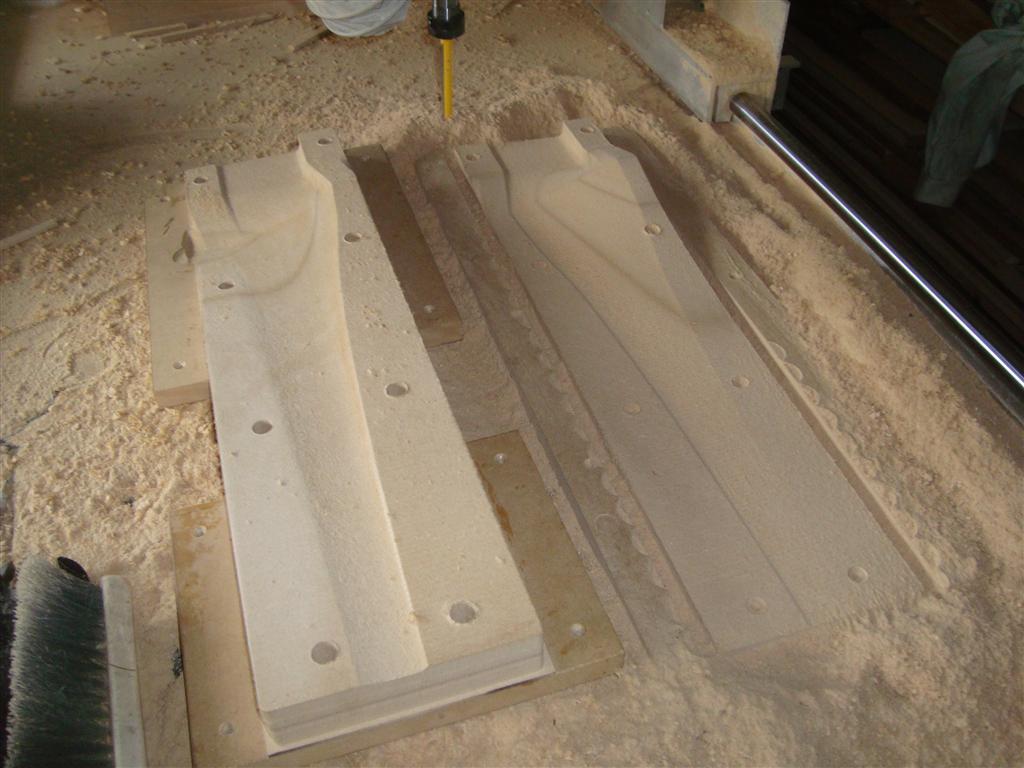

Though making the blades isn't CNC related, just the mould is, I thought I'd post this as I'm sure there will probably be people here who know more about using polyester resin / glass fibre than I do.
This is my first attempt at making anything with fiberglass, except a couple of stators for the wind turbine which is just a very simple casting, and some small sheets as a test for strength.

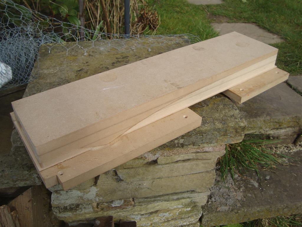

First I made these two moulds on my CNC router:
Attachment 3882
Attachment 3883
Attachment 3884
Attachment 3885
Attachment 3886
The blades are 700mm long, tip speed ratio 7.
I've coated the mould in a random tin of furniture wax we had lying around but were never going to use. Not got any pictures of that.
To be continued...

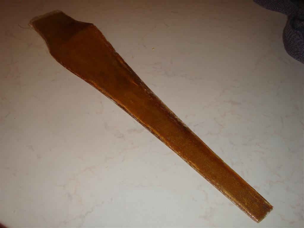

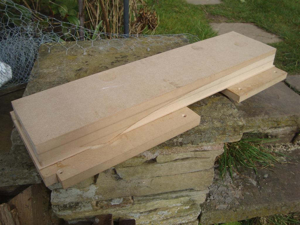

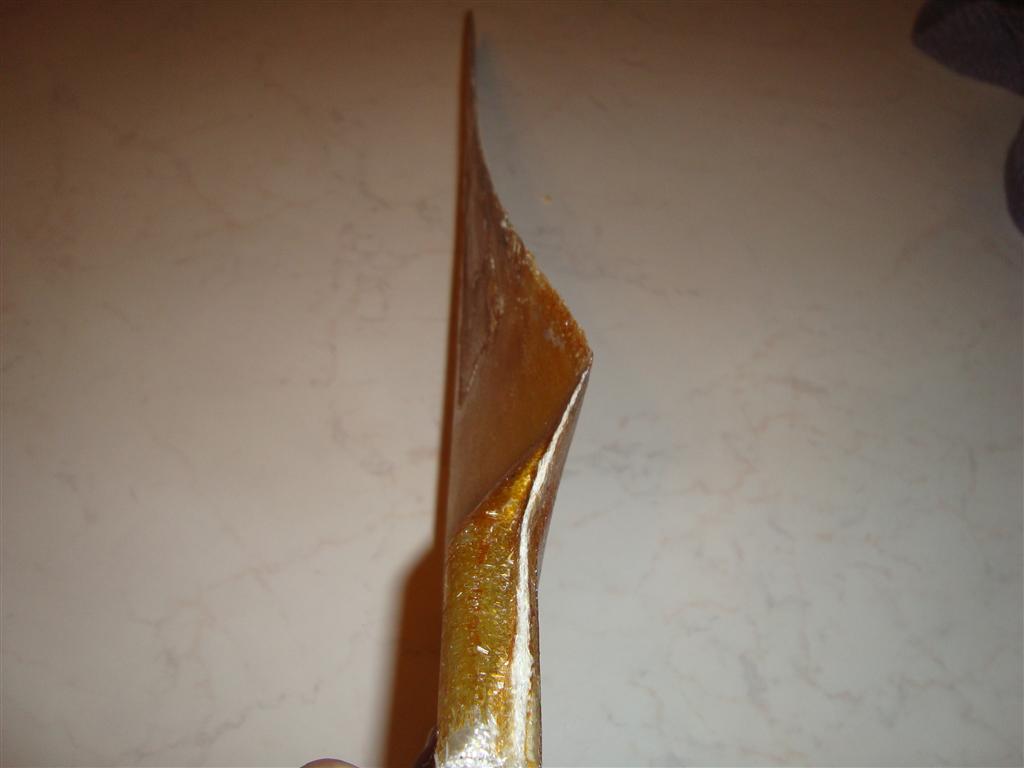

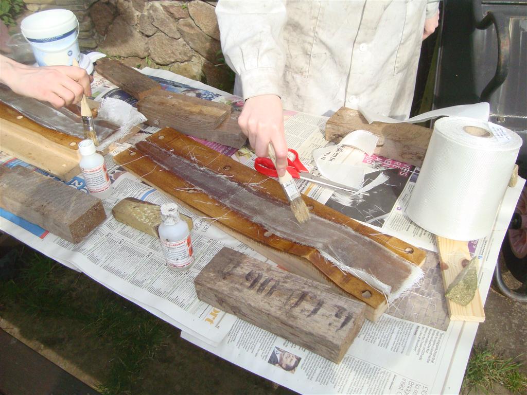

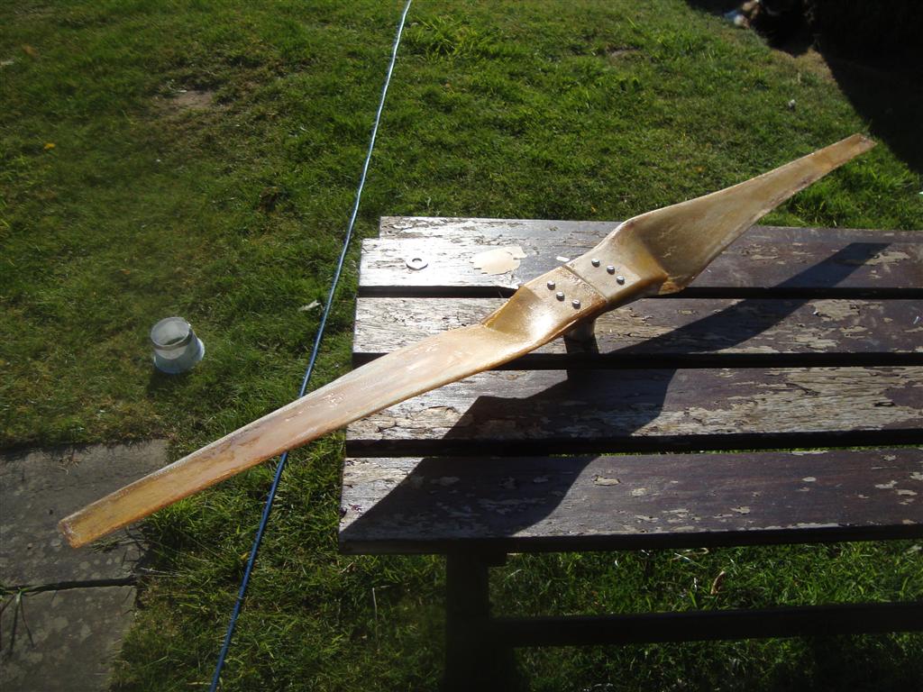

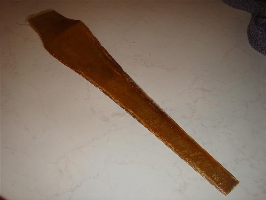

This is the blade I made a few days ago, got my sister to help with laying up the resin/glass:
Attachment 3893
Attachment 3894
Attachment 3895
It went reasonably smoothly. The blade came out of the moulds easily, however it had collapsed a little in one area. I've since built that back up with more resin/glass and sanded it a bit, so now you can't tell. A bit of wax came off the mould with the blade so I'm currently waiting to get some more before I can make the next blade.
The blade itself seems strong, it doesn't bend much except near the tip. I might fill it with polyurethane foam just to make sure.
Oh and thanks to 'Chip' for giving me some resin - I used a little of it here since it said on the container that it did not require gel coat.

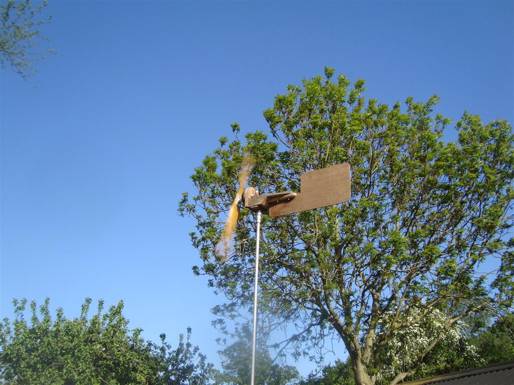

The blades work! Not that I ever doubted them :heehee:
The mass of the two blades when I made them was only 2 grams off - complete fluke that. The centre of mass however was quite a bit off. I spent a bit of time balancing them but they're by no means perfect. This caused huge vibrations.
Attachment 4000
Attachment 4001
According to the frequency meter the rotor did over 800rpm at times - that means the tips of the blades were doing over 100mph! I need to be careful... next time I'm going to balance them properly and stiffen the tower up. Might have to use guy wires at full height.
I'll upload a video soon.
