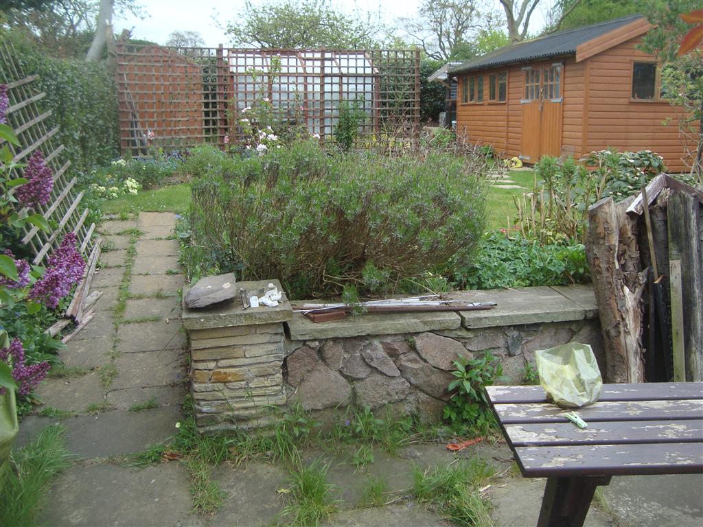

Basically my dad has said I can buy a lathe I've found, that weighs 650kg, if we can think of a way of getting it up the garden into the workshop. The seller says he will deliver it, so that's not a problem.
So any ideas as to how to negotiate my garden are most welcome. There's a couple of steps and a slope. There's slabs most of the way up.
I'm thinking use an engine hoist plus maybe a couple of sheets of 18mm plywood to provide a smooth surface to run it on. Hopefully the hoist, if I can find/borrow one, will be able to lift it high enough to place on top of the steps - about 2' high.

The man delivering it says he has got 'skates'. It looks like they need a flat surface, so I think some plywood or similar could provide that flat surface.
So the question is how thick plywood do I need to support that mass?

Lathes are very top-heavy and often the weight is biased to the front of the machine so be very careful if using rollers; if one twists under it can topple the machine.
Remove as much of the weigh from the machine as possible (e.g. tail-stock top-slide , chuck cross-slide [these usually come off quite easily] carriage handle etc. etc.)
If you're going to use a trolley, take Phil's advice make it as wide as possible (be aware that castors can swivel inwards making the actual footprint narrower and less stable) and as low as possible then strap the lathe to the trolley. Make sure no one is ever pulling on the lathe or standing on the wrong side when someone is pushing.
Last time I helped to move a heavy lathe (Churchill Cub) over a lawn , we dismantled it first into parts , the heaviest bit, the bed still weighed in at ~100kg, but we were able to move it with a sack barrow.
Above all - think before you try to move it - do things one step at a time.

I've just measured the step, it's only 400mm, patio at the top and bottom.
The lathe is a Colchester student, Mk "1.5" induction hardened bed...

This is what we've got to negotiate:
Attachment 3936
Attachment 3935

Jonathan your scenario is a lot harder than mine mine was a straight path, my path is more substantial than yours looks.
Taking the stand off will reduce the weight but i guess if you stripped every thing off you will only shave off 25% of the weight.
The lathes are shimmed & mounted to take out twist in the bed this is done by measuring not cutting that is why it is not to be attempted without the right equipment.

An engine lift will do nicely to move the lathe. I used a 2 ton lift to get my lathe into my workshop a few weeks ago. I had to cross a gravel area for around 6mts before getting to the stairs of my workshop. I used 40mm thick interlocking flooring boards at 600mm wide by 2400mm long to give a running surface. When I got to the stairs I then spanned then with 6 of 100mm x 100mm fence posts to support the weight. Then the lathe was lifted around 400mm high and placed on the posts running up the stairs. Then the lifter was moved inside the workshop and used to pull the lathe further up the ramp to get it in position for a straight lift to go to its final position. This worked very well and just required care and attention as with all lifting procedures. The thing to remember with engine lifters is that they cannot work outside their footprint.
Best of luck.
Ian
Re: Help! Moving a big lathe...
The lathes are shimmed to the bed/tray that is the last thing i would want to take off.
I think you're worrying too much: just make sure the shims (if any) go back when them came from. Those Master beds are built like a brick outhouse they'll bend the stand before twisting ;) And, if memory serves (ask Tony at lathes.co.uk for chapter and verse), the heads were dowelled after alignment so even removing the head would not be the end of the world.
In bits, the job looks safely do-able with a low trolley, plenty of wood, and an 'A' frame hoist to get you over the steps.
