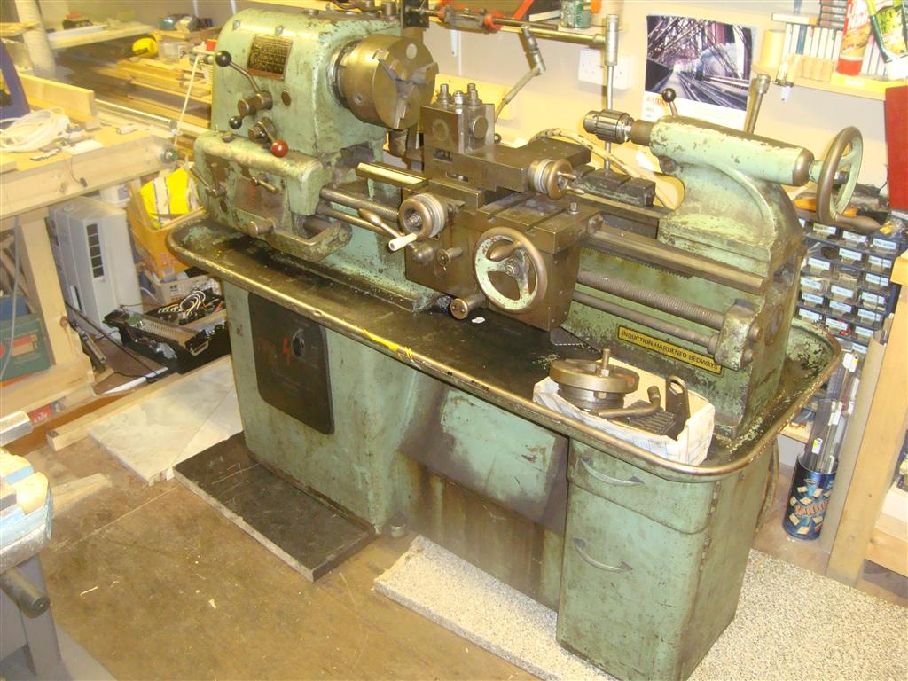

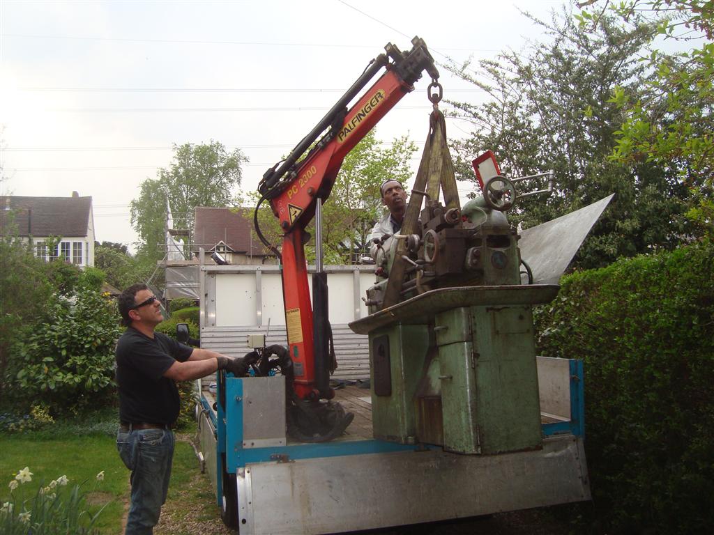

My new lathe arrived yesterday, so I've spent much of today cleaning and setting it up:
Attachment 3963
I was impressed how effortlessly that crane picked up the lathe. Getting it up the garden was completely the opposite though (I'll post that in the thread I started earlier).
Here it is in place:
Attachment 3964

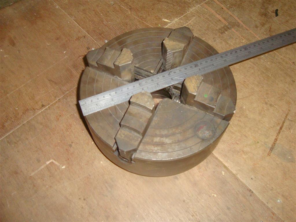

It's come with a 200mm Burned chuck. The mechanism is nice and smooth, but I cleaned it all out anyway. No chuck key, but it didn't take long to make one! There's no external jaws for it, but I can get 4" bar in without them anyway and I don't envisage needing more at all often. I can use the (free!) 10" 4 jaw chuck that came with it for bigger stuff. There's also 3 soft jaws.
Problem: The jaws on the 3 jaw seem to be worn such that it's holding bar at an angle to the axis of rotation of the spindle. When I tighten the chuck it looks like it grips the bar closer to the spindle first, then if you really tighten it the end of the jaw near the tailstock grabs. It looks like the jaws are tapered. :sad: I wondering if I should skim a bit off the jaws? 10mm from the chuck the runout is 0.22mm, 50mm away it's 0.44m, 30mm it's 0.32mm - so it looks pretty linear.

Just thought - the misalignment on the chuck could be the headstock that's out of line. I'll check it by putting the DTI on 'top' of the bar, then the 'side' to see if they're different readings.
In the manual it says 32 and 68 oil, I should have read it properly!
Re: New toy: Setting up Colchester Student lathe
Jonathan i used those machines when i was an apprentice and they were old then as the square headstock models came out so that lathe is at least 45 years old and probably older. It will have not only be used but abused so you should stand back amazed that it is in such good condition.
Re the chuck, small pieces were held and the chucks overtightened so again hardly surprising the jaws are bell mouthed.
You wont be able to SKIM them they need to be ground, obviously you can skim the soft jaws. I would check the fit of the jaw profile in the chuck body worst case a new chuck around £200
Congrats in getting it in.
Phil
M250cnc
The owner said that it had had very little use from him since they've got bigger and better lathes. I tend to believe him since the nut you undo (should be a lever) to rotate the toolpost was extremely hard to undo. I think is the slightly newer version of the old lathe as it's got the later apron and the better bearings.
M250cnc
Would they be machinable with a carbide tool any plenty of coolant? I read someone doing it on a mini lathe with a diamond tool spinning fast, and the lathe on full speed so the centripetal force pushes the jaws against the thread. That was only to remove a tiny bit though. I guess it's worth a try? Alternatively could I anneal the jaws, machine, then harden again? Just thinking aloud!
I've had the jaws out and there were some burrs on the thread.
Just checked with the indicator and it's the same runout wherever I measure, so must be the chuck at fault. With the indicator on the body of the chuck I get about 0.015mm runout.
Edit:
It's just occured to me, I removed the burrs on the back of the jaws easily enough with a needle file, and somebody's machined them else where which implies that they are machinable. I have a glanze boring bar and some new inserts for it.
Not really, they are ground when made new so there is your answer. Stop thinking out loud don't even think about annealing them
Jonathan
If the runout was repeatable at the same point on the chuck it might be worth it, but if the run out changes position then you live with it or buy a new chuck.

I've done what you said, with a couple of different bits of stock a few times and yes the high point is always in line with jaw 2.
I think the jaws that are in there are soft jaws since there are machining marks on them and when I filed off the burrs it felt like mild steel.
I put the other (definitely soft) jaws in and found that one jaw was in the wrong place. It turns out that I have to mount them in the order 2-3-1 for them to meet at the centre. They seem fine then.

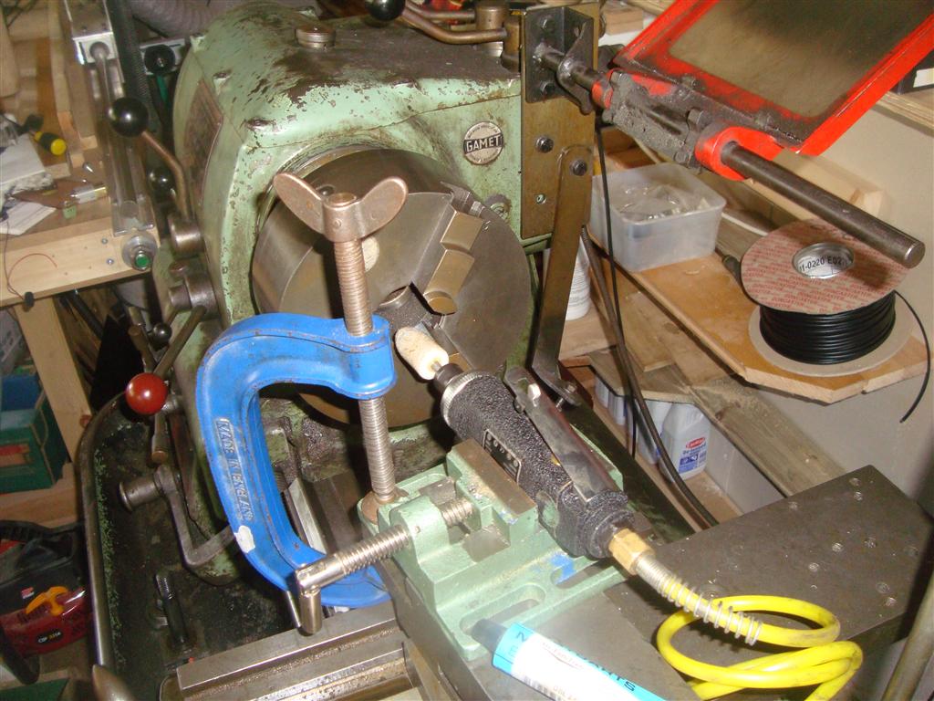

Dremel mounted on cross slide, will help rescue the existing jaws. Just make sure you clean all the grinding dust back of once you're finished.
Remember a three jaw chuck isn't good for accurate work. For accuracy you really need to be using a 4 jaw, or collets.
m_c
I've got a die grinder for the air compressor - that should do it. Mounting it is going to be a faff as it's an awkward shape. I'll need to buy a suitable grinding stone for it too.

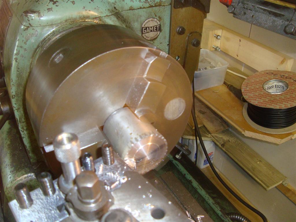

I've reground the chuck jaws using the die grinder. I found a grinding stone that looked fine however the shaft was 1/4" not the 6mm I needed. I put it in the mini lathe with the 4 jaw chuck and carefully turned it down to fit. I used the autofeed on the lathe and took off 1 thou at a time.
I measured the runout the same as before and got 0.09mm (10mm from chuck) to 0.15mm (@50mm). It was the same with smaller stock too. I've not tried anything bigger than the diameter I ground it at (50mm ish) which might be the problematic one since then the corners of the jaws will be in contact.
I'm happy with that for now. It's clearly not as good as a new chuck, but good enough for most things. It just means I'll have to use the 4 jaw a little more often.

This is how I set up to grind the jaws, except with newspaper down to protect the bed:

Just to test I faced 50mm MS & aluminium bar and chamfered the steel, here's the result:
Attachment 3970
Attachment 3969
Not the most interesting test but it got a nice shiny finish. Happy!
