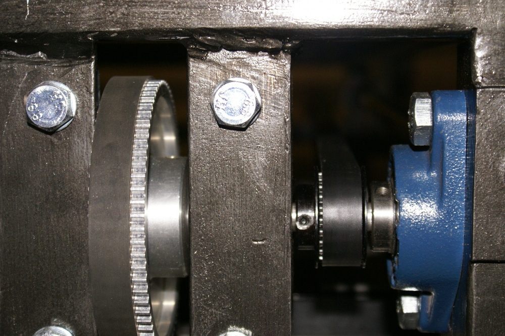

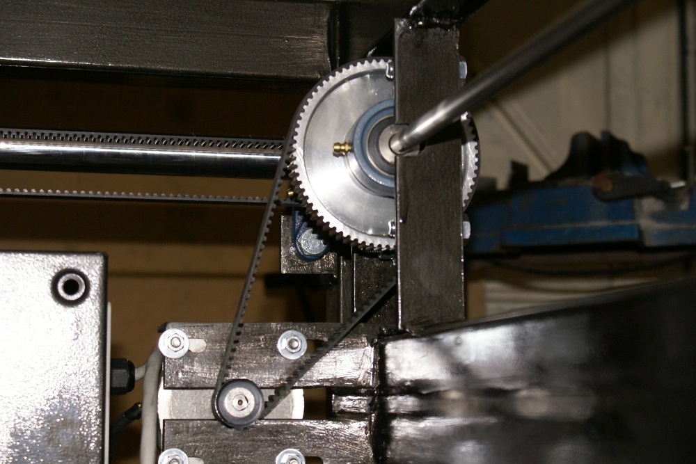

2 Attachment(s)
Re: pulley ratios on 3 pulley axis
ok a picture speaks a thousands words
Attachment 4248Attachment 4249
this should make it easier to understand

It's 16 to 72 then, which is (as JohnS said) 4.5:1 or 0.2222=2/9
The 24T pulleys just link the two screws so are irrelevant.
Right so looks to me like 16 driving 72 with a 24 on the same shaft driving another 24 ? [ not in picture ] ?
If so the two 24's cancel out at 1:1 and the 16 to 72 gives a 4.5 : 1 reduction x by 1 : 1 is still 4.5 reduction.

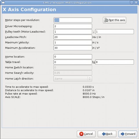

Using EMC2, not mach3 so you don't set the steps per directly... you enter motor steps per rev (so 200 is correct), microsepping (so 16 in this case), pulley ratio (4.5 as discussed) and leadscrew pitch (120mm).
It looks like at the moment you have the leadscrew pitch set to 100mm not 120mm .... so either change that or put the ratio to 5.4 and it'll be fine.

Here is an example (not my config by the way)
Attachment 4250
my config is set up in metric, it is very straight forward to use
