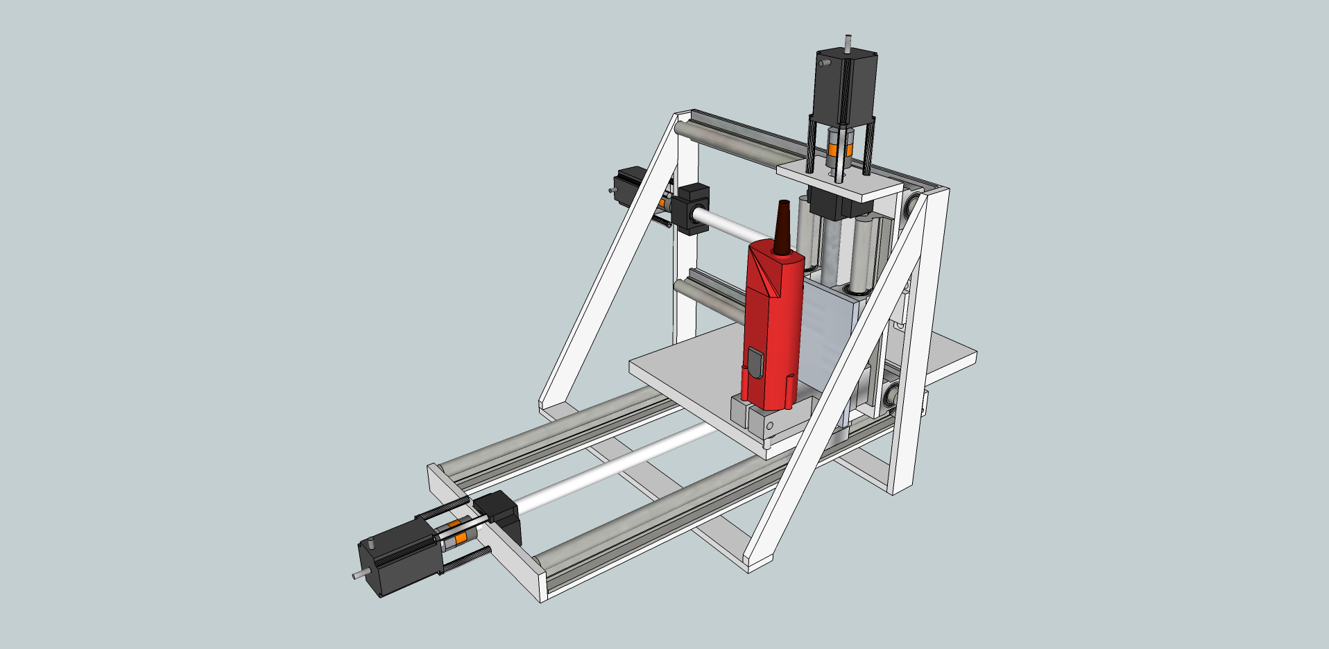

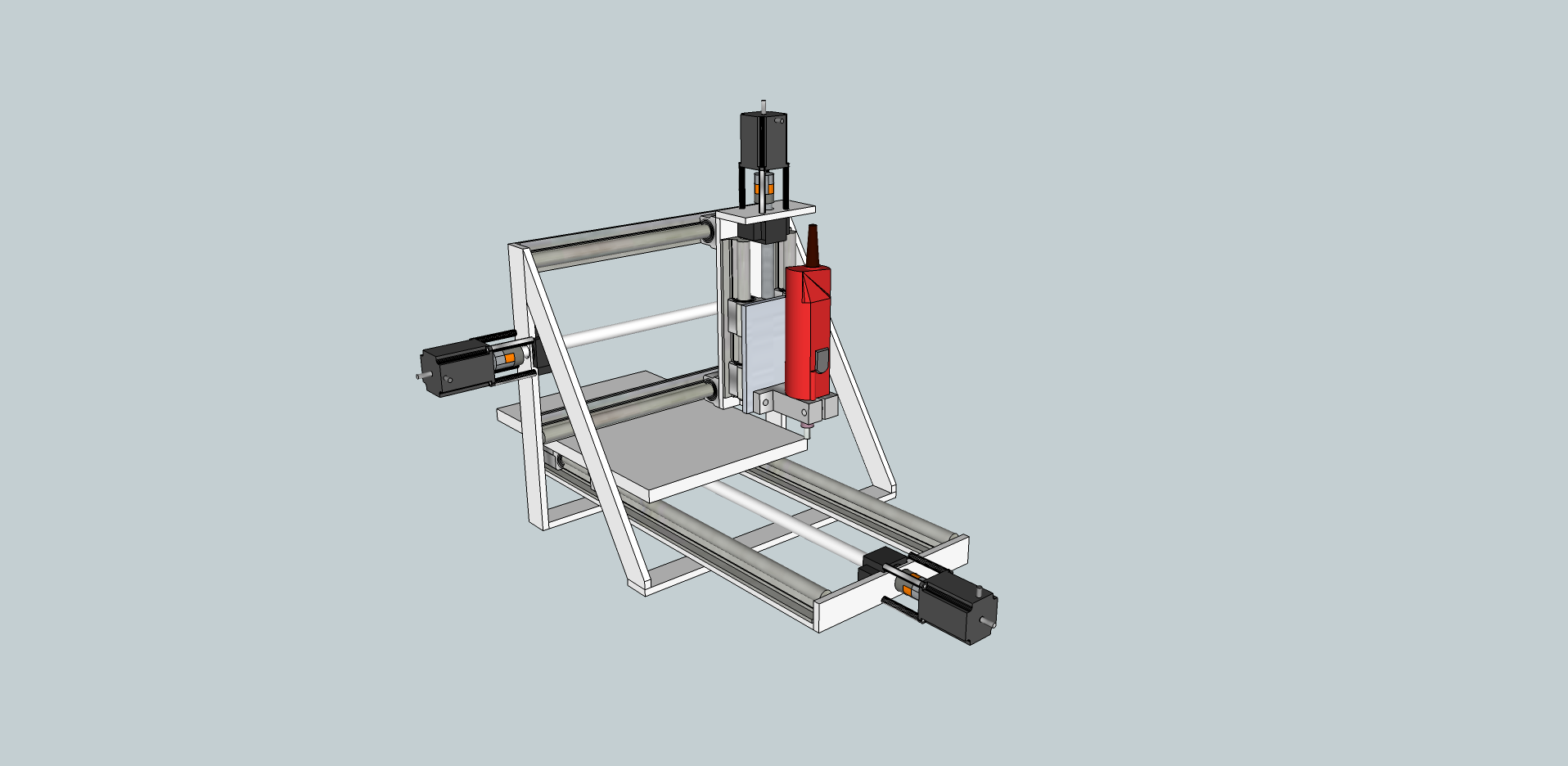

So, what do you think of this design?
as it's the one I'm probably going to make.
Attachment 4278Attachment 4277
Thoughts and constructive criticism welcome.
It's made out of 10mm thick ALu by the way and 20mm supported rails.

Hi, what do you intend to use the mill/router for? What is the cutting area?
A 1050watt Kress at the moment, Cutting Area it just over A3 and 100mm High.
I like the triangles, you get a lot of strength from a triangle.
Can I suggest 2 small changes.
The X axis rails have a lot more vertical separation than there is separation on the ball bushings. This introduces an awkward turning force on the nut which the bushings are poorly placed to resist. Suggest you lower the top rail and screw somewhat. Allow the Z rails to overhang at the top you are only going up there for tool changes, keep the strength at the bottom where you need it.
Bolt the vertical risers to the sides of the Y axis aluminium sections. Connect the diagonal braces to the vertical risers with a lap joint not a mitre. Using an offcut from the vertical riser as packing, lap joint the braces to the aluminium sections. Maximise the rigidity the diagonals have to offer.
Incidentally, 1/2" thick aluminium bar is a lot easier to find than 10mm.
I think the Y-axis rails should be mounted on something stronger, ideally both on a single piece. At the moment they're on something that will twist easily, so they will still deflect downwards...
Having them far apart is good I think, though I agree the ratio of the Y and Z rail seperations should be closer to one. Perhaps make the Z axis wider?

The supported rails in that picture were 250mm Long and the screw was 350mm, this allowed me to mount the screw supports above and below the supported bearings making it thinner.
I'm now getting 300mm supported rails, this means that the screw supports will have the be inline with the rail and that the Z axis will be wider.
would changing the ratio of Z and Y closer to 1 make it more rigid? I thought it was a bigger the better situation!
the ratio of the new design is about 2:1
the 2 being the Y axis.
I think that ratio is fine as both of the distances between rails are reasonable, so it surely can't be worse than if they were both the same as the 1.
What are you mounting the Y-axis rails on?
probably one large bit of Alu. due to the cost of this, i'll have to make the Y Axis rails closer together to make it cheaper! then it probably will be very close to 1:1

One large piece is best, otherwise the rails will twist.

Box/rectangular section would be stronger if you can find a bit the right size.
I think Chip used the 6"x1/2" for his gantry ... it was definitely something close to that.
The 6 Inch stuff will be 10mm to thin. it's either get something 10mm wider or knock 40mm off my cutting area!
That's annoying as the next size up is 10" then 12"... if you decide to get the bigger size which has to be in a 2m length (I phoned them and they said they don't sell smaller) I might buy the spare from you. For a good price :lol:.
the only way I could make it work with 6" would be to mount the supported rails on the very edge of the alu and filed down the screw supports.
I'm talking 1mm from the edge of the hole to the side of the alu.
If i went for 10" it would be silly as my Z axis would be so wide it would be worse then using the 6" with the rails mounted properly!

how is this for Z and y?
no snide remarks about it floating! :)
I'm not sure on the exact spindle size so it is mainly guess work :(
I think you should go for the wider aluminium. It's annoying, but it won't hurt to have the Z axis a bit wider/stronger. It looks like you're using the same aluminium for Z... I'd make it stronger by putting the linear rails on the bit that moves up and down and the bearing blocks on the piece fixed to the gantry. That also saves a bit of aluminium/weight.
The stepper motor mounts have poor torsional stiffness...I'd either use bigger bar or plate or something.
