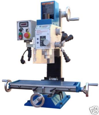

:naughty: Ok Im looking to buy another mill to convert, Ive decided my Boxford 260 vmc is almost ready to go.
Im looking for one similar to the picture below, New OR Second Hand, if you know of any similar mills on the net. please post the link, or if you have one let me know..:wink:
Attachment 4329
Im looking for Cross travel: > 150mm & Longitudinal travel: > 420mm
I would like an R8 taper (but would consider others) as I will be converting to ATC.

OK here is the pricing i Have so far...
The picture above is from SPG Tools
http://spgtools.com/
SPG 2217-lll LV Milling/Drilling MachinePrice:
£760.00 (UK Delivery £50.00)
so can anybody find better for the money....
I really do need some opinions with this..... please...:idea:
Re: Taking the plunge again!!!
out of those, spg 2217-30 or spg 9525. Preferably the 9525, but i still worry about the depth of the pillar and its strength.
i2i
I'm not sure about the pillar either, so I'm looking for peoples experiences with this type of mill and so far Ive looked at 2217-30 that has the bigger motor and drilling and end milling capability than the 2217-III LV,and HOSS from CNCzone has done a conversion of the Grizzley G0704 (Equiv To 2217-III LV) and that shows some of the limitations and fixes of that model, and Ive heard the 9525 trashes the motor controller and gearbox very easily but it does have a better X-Y i think., they both have the common plastic gears.. so im hoping people will put their thoughts in on these and indeed other models of this type..:smile:

I've not seen the machine in the flesh, but it maybe possible to "beef up" the pillar.
Well as i said there is a shed load of pictures on this site and the complete SPG 2217 (well its equiv anyhow) CNC Conversion...
http://www.g0704.com/index.html
It really is a very entertaining and detailed conversion. I suspect i will do the same on here as soon as i make the decision.
without looking fully through the pics, there isn't a lot of metal where the pillar connects to the base. I would look at adding another base below the original that extended behind the pillar, and add support plates either side of the pillar from the extended base.
Maybe even making a thick plate full length shroud around the pillar that could be fixed to the extended base.

It sounds like a great idea, im not sure if i would extend the y axis like hoss did anyhow as i may be going for the 9525 which has a better x and y anyhow, as i understand that you lose a little when you cnc it. Im thinking that re-inforcing the pillar is the way to go on either model.. it is chinese after all... It would be real nice if i could just buy the carcass as im going to rip out most of the stuff thats in it any how

I saw that earlier, i think it's a router. I have an X3 here to be overhauled, it's been cnc'ed already so i'll give you my findings in a few days.
i2i
a little work and it would be a nice cnc machine with a super x & y..
hmmmmm x3 a nice little machine but the way the head on the z is moved is a bit convoluted and full of stress and the thickness of the material on the pillar yet again begs for twisting. But ive seen some nice conversions and indeed some great work from these machines..
