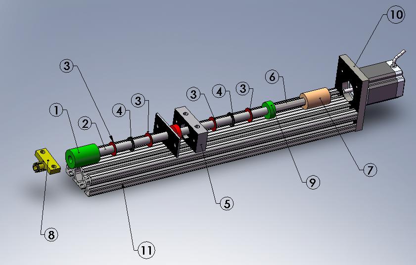

I've been looking at the following axis design:
Attachment 4384
(taken from CNCRouterParts.com)
I'm trying to understand how the thrust bearings works in that setting? As far as I can tell, when assembled they would be in contact with the front/rear of the block not the radial bearing, so what would they achieve? The shaft collar is required here in order to keep the thrust bearings in place, would that be right?

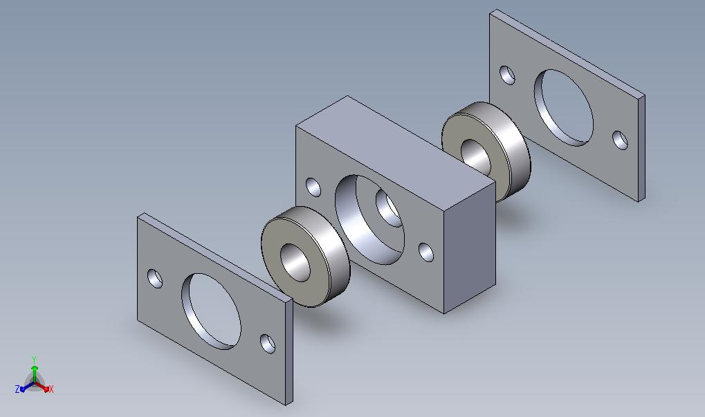

I was under the impression from reading around that a fairly solid bearing could be built using two angular contact bearings back-to-back (so the angles are directed outwards, effectively doing what I think the thrust bearings are meant to do in the picture above?), like so (cue rough and ready CAD):
Attachment 4385
If so, as the bearings are constrained by the block, the shaft collar in the first picture would not be needed, is that correct?

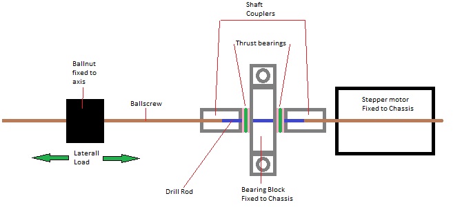

Ok well this part i can answer for you. this would appear to be the cheapest way to avoid the latteral load from the axis being transmitted into the Motor bearing. the fact that the drawing above does not show a ballscrew is a little missleading. ive just done a quick drawing in paint that may make things a little clearer notice i say "may"
....Attachment 4386
And yes the thrust bearings would "be in contact with the front/rear of the block not the radial bearing"
The radial bearing is not fixed to the drill rod but just a nice tight fit as a support for it. as you will know the shaft couplers are
fixed to the rods they couple together, the simplest way is with grub screws, in turn these are mated to the outside of the thrust bearings respectively leaving no play if at all possible, this diverts the latteral load through the trust bearing into the radial bearing block and on through the chassis it is connected to and hopefully not on to the motor!!!
there you go... Clear as mud :smile:
Please remember im no expert so my terminology may not be as it should be but only enough to be understood....Maybe lol

Actually yes, that does make it a lot clearer! I was originally thinking in terms of a load perpendicular to the shaft which was probably what threw me. I'm currently considering starting with Acme thread which is why I was looking at that particular diagram.
I was planning to just use the axis rather than introduce additional drill rod unless there is a good reason not to do so?

So one double row ACB (such as this: http://www.worldofcnc.com/products.asp?recnumber=147), or two back to back single row ACBs (such as these: http://www.worldofcnc.com/products.asp?recnumber=73) mounted in a block would perform that same function as the combination of elements discussed above?

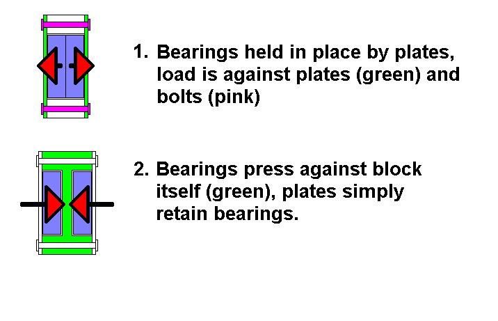

In the original block idea I posted (not the one from the website, mine) using two ACBs, would this mean that the load is being transferred into the coverplates that are holding the ACBs in place? And as they are pressing against the plates from the inside heading out, it would be the bolts holding the plates that are actually taking the strain? Number 1. in the picture below.
Attachment 4387
If that's the case, presumably Number 2 would be a better option as the bearing block then takes the strain from the bearings.

The bearings should be like in 1. i.e pressing against the plates. Fix the bearing(s) to the end of the screw by having a thread and a nut on the screw to lock it in place.

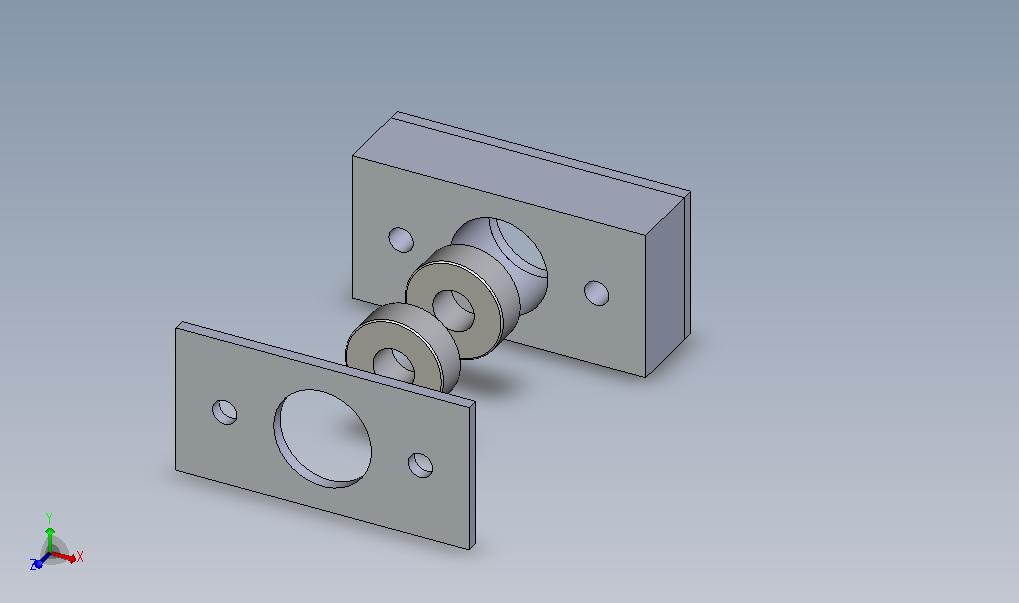

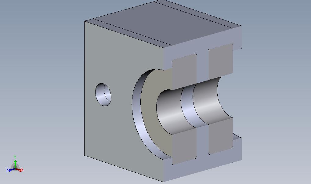

If my current thinking is on-track then I'm hoping the basic homebrew block would look something like this:
Attachment 4388Attachment 4389
Re: Understanding the bearing block
No, not like that. Move the 'wall' in the middle of the block to the edge, and have one plate on the other side to press the bearings against that. Have a look at the BK/BF blocks on eBay/Zapp if you're not sure...
The way you've drawn it makes it harder to machine concentrically. The standard way only requires one hole to be bored.

I'm surprised that No.1 would be the better option. May I ask why that is?
If the screw has been turned down by that stage then would a shaft collar be sufficient for keeping it in place?
Edited to add: and again with the fast reply! The single hole on one side was the original design idea, just like the other blocks I'd seen. The reason for trying to a different approach was because I thought they were using standard radial bearing in the block and thrust bearings on either side, and using the angular bearings would benefit from a different approach. Clearly not!
Rogue
Possibly, but it's not ideal. The problem with a collar is, similar to the thrust bearings, it may be skewed on the shaft. A collar that clamps onto the shaft (ring with slit, bolt through slit to squash it) would be better. I would stick with having a thread. It depends what you're doing with the machine. If you're only cutting PCBs then pretty much anything will work ...
