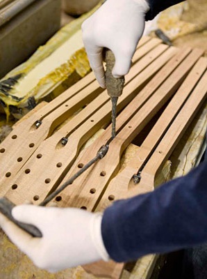

Hiya,
Long time no speakee...i have a challenge & you guys popped straight into my non engineering mind!
I seek to be able to drill a hole about 4mm diameter, very accurately (ie no divergence) all the way along a 450mm long guitar neck...
http://img98.imageshack.us/img98/5528/6512string.jpg
....so that the resulting bored hole runs just beneath the fretboard (the fretboard is the 3mm veneer dark wood on top of the neck ie where where the guitar puts his fingers)
Two problems...
1. What kind of custom rig would be in order (I'm thinking any drilling bit/rig would need to 'hang' vertical so gravity doesn't 'pull' on the bit, causing it to diverge)
2. Where on earth could I buy a drill bit just 4mm diameter and 500mm long! (or how would you approach making one?!). I have found places that sell 500m bits, but they start at 6mm diameter, which is excessive for my needs.
Things to consider....
No snappage - it would be catastrophic to have the bit snap half way along
Really accurate - it would be even more of a tragedy to see the drill bit surface out of the guitar's fretboard at the end of its travel!
repeatability - I'd like to do this to a few necks!
Many thanks,
Hank.

Perhaps you need a gun drill. You blast air through to clear the chips so they don't push you off course. (Oil or oil air mix if drilling guns)
You spin the wood. The axis of rotation defining a straight line through the part where the wood is moving slowest. IIRC the gun drill shies away from the faster cut and automatically centres itself on the axis.
I have some long gun drill bits if you want pics.
Knowlege exhausted
Robin
EDIT: PS: Suggest, drill the hole, cut the neck around it

Hi. so the picture below is what you would like to achieve but after the neck is constructed??
Attachment 4493
I did always wonder how they did it...
Re: Can I pick your brains? How would you solve this puzzle....
i allways assumed the tension rod ran down a slot that you would cut into the neck face and cover with the fret board ?
wouldnt work if your just adding a veneer as the fret board
i would s**t myself trying to drill over that distance:wink:
you have got me thinking now!!
if the standard is to bond your fret board over the slot then it would be easy .....
iv just measured one of mine.... the fret board is 5mm deap, rose wood i think

no it's not for a truss rod - it's for wires (LED fret markers).
Agreed, it's an onerous task, but believe me, I'd sh*t myself more by way of heating the fretboard with steam, prizing it off with lever, routing some wire channels, sanding the glue off the fretboard and neck, and then putting it all back together and then aligning it back up - ie aka this guy's way...
http://acapella.harmony-central.com/...-inlay-project.
....drilling a hole down the neck is the way to go!

Not understanding the question, I've not done anything yet, I'm at the preliminary stage asking for ideas/info how to drill a long thin hole :naughty:- where does the truss rod fit into this line of thinking?!
HankMcSpank
I'd guess the question relates to making use of what is already there - there might be a way of using the existing hole and extending it enough to fit the wires?
I have this mental image now of trying to thread a wiresaw down the truss hole in order to cut a small v-notch for the wires, and I'm breaking a sweat just thinking of all the horrible ways that could go wrong :confused:

You're understanding my final goal ....but I didn't understand your question about me having access to the truss rod (which suggested I already had my guitar here in pieces) ....I was talking in general - obviously there's a truss rod in every guitar neck, but not being a truss rod expert (or neck expert), I have no idea how much space there is between the top of it (assuming the guitar is lying on its back) & the fretboard rear 'face'.
Does anyone know if there's typically a 'void' there already? (ie a gap between the truss rod & the fretboard)...these would be thin wires, though quite a few of them - about 11 wires in fact)

im no expert on them myself.... my understanding has it that the slot will have been cut with a ball nose type cutter and the truss rod will be a pretty snug fit except that when you add the fret board there will be some space left in the two upper corners of that U shaped slot that the fret board now covers
the reason i asked if you could still get the truss rod out is if there is enough room you will still have the problem of threading those wires, if the rod comes out it should be possible

I thought a typical truss rod could only be removed by taking off the fretboard? (which is what I'm trying to avoid doing)

Truss rods are quite often fairly embedded in the neck,
http://www.youtube.com/watch?v=UrK-DVFFw4g (a series of 8 videos how to repair a broken one!)
but I concur, that if I can utilise any opportunities that existing channel presents, it's gotta be the way to go

Now i may be way off here but a distant memory 20yrs + (When i was the Owner/Proprieter of workhouse rehearsal and recording studio.) I saw a truss rod taken out and i remember asking why it was bent, and was told that some are as it puts a spring in it.. so maybe that is why it is hard to remove when the tension is off??
And no i dont know anything about music as i didnt need too!!

you learn something every day :) i allways assumed the truss rod was a single rod.... youve got your work cut out there trying to work around one of those in the video :(
i think i would sooner make a neck from scratch than go through all that pain of stripping one... now the drilling looks a bit less desprate:redface:
i think i would still try my best not to drill... what about removing the frets and cutting a funky (strategic) pattern in the fretboard and bonding the wiring behind an inlay ??
